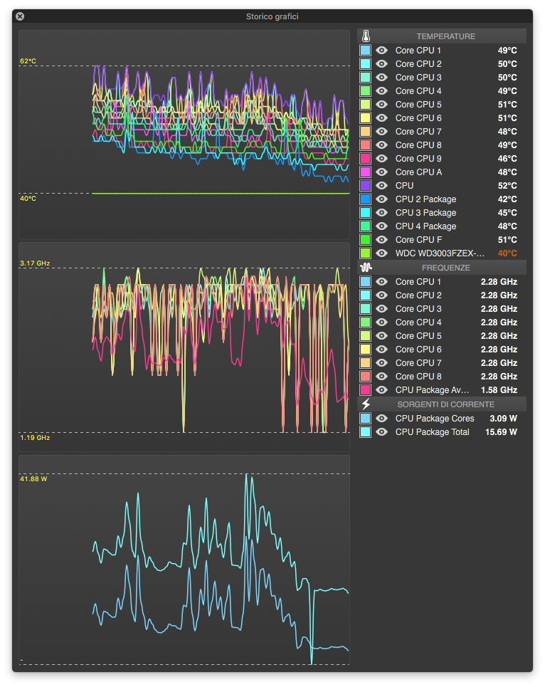

antonio.clb Posted September 22, 2018 Share Posted September 22, 2018 44 minutes ago, oliveg said: Hello Antonio! I have a Z620 with 2xE5-2670 also . 2 questions: 1- Did you install a wifi card, and if so which one? 2- Did you get your PM working? It would be great to compare our files and settings... Thank you! Olivier Hello Olivier! I've no wi-fi card hooked on the Z620 but, from a quick Google search, looks like TP-Link Archer T8e and T9E should be 100% macOS compatible. My PM works well with CPU clock changing between 1.2 and 3.3 GHz responsively: you can find a copy of my actual Clover folder in THIS POST. Let us know about your progress in this hackintosh adventure! Best regards. AC Link to comment https://www.insanelymac.com/forum/topic/333001-guide-2018-z820-sierra-the-great-guide-sucess/page/7/#findComment-2636078 Share on other sites More sharing options...
oliveg Posted September 22, 2018 Share Posted September 22, 2018 Thank you Antonio! I will try within this week-end. Best regards, Olivier Link to comment https://www.insanelymac.com/forum/topic/333001-guide-2018-z820-sierra-the-great-guide-sucess/page/7/#findComment-2636096 Share on other sites More sharing options...
oliveg Posted September 22, 2018 Share Posted September 22, 2018 6 hours ago, antonio.clb said: Hello Olivier! I've no wi-fi card hooked on the Z620 but, from a quick Google search, looks like TP-Link Archer T8e and T9E should be 100% macOS compatible. My PM works well with CPU clock changing between 1.2 and 3.3 GHz responsively: you can find a copy of my actual Clover folder in THIS POST. Let us know about your progress in this hackintosh adventure! Best regards. AC Dear Antonio, I've just replaced my CLOVER folder with yours (I kept my kexts since I'm running 10.12.6), and I got a KP on restart: "Impossible to generate P-States on this system"... Any idea? Thank you Link to comment https://www.insanelymac.com/forum/topic/333001-guide-2018-z820-sierra-the-great-guide-sucess/page/7/#findComment-2636169 Share on other sites More sharing options...

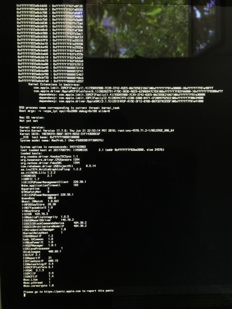

antonio.clb Posted September 22, 2018 Share Posted September 22, 2018 1 hour ago, oliveg said: Dear Antonio, I've just replaced my CLOVER folder with yours (I kept my kexts since I'm running 10.12.6), and I got a KP on restart: "Impossible to generate P-States on this system"... Any idea? Thank you I really think you should follow bilbo's procedure to create your own SSDT/DSTD and patch necessary system kexts. I usually do the following steps (from my own notes): 1) sudo perl AICPMPatch.pl /System/Library/Extensions/AppleIntelCPUPowerManagement.kext/Contents/MacOS/AppleIntelCPUPowerManagement --patch 2) sudo ./10.13\ aicpm\ patch.command 3) insert MacMini StepContextDict: macmini6,2 StepContextDict is here: /System/Library/Extensions/IOPlatformPluginFamily.kext/Contents/PlugIns/X86PlatformPlugin.kext/Contents/Resources/Mac-F65AE981FFA204ED.plist and you should insert it here (I use to tag this file with a color to see if it changes after a system update): /System/Library/Extensions/IOPlatformPluginFamily.kext/Contents/PlugIns/X86PlatformPlugin.kext/Contents/Resources/Mac-F60DEB81FF30ACF6.plist 4) copy APIC.aml e SSDT-1-CpuDef.aml renaming it in DSDT.aml on Desktop (dump it with F4 on Clover while booting) 5) recompile DSDT.AML fixing various problems as per bilbo's guide (patch 1, 2 and 3) 6) install compiled DSDT.aml on CLOVER/ACPI/patched folder 7) download Pike's ssdtPRGen: curl -o ./ssdtPRGen.sh https://raw.githubusercontent.com/Piker-Alpha/ssdtPRGen.sh/Beta/ssdtPRGen.sh 8) ./ssdtPRGen.sh -p 'E5-2670' -c 3 -x 1 -target 0 -cpus 2 -l 32 -mode custom -d 3 ./ssdtPRGen.sh -cpus 2 -p 'E5-2670' -x 1 -target 0 -turbo 3300 -c 3 -cpus 2 -l 32 -mode custom -d 3 9) install generated SSDT.aml on CLOVER/ACPI/patched folder 10) Install X79PlatformPlugin.kext in /System/Library/Extensions/ 11) sudo ./InsanelyRepairPermission -r /Volumes/macOS\ SSD If you experience boot problems, drop SSDT.AML on Clover boot screen Hope this helps, best regards! AC Link to comment https://www.insanelymac.com/forum/topic/333001-guide-2018-z820-sierra-the-great-guide-sucess/page/7/#findComment-2636187 Share on other sites More sharing options...

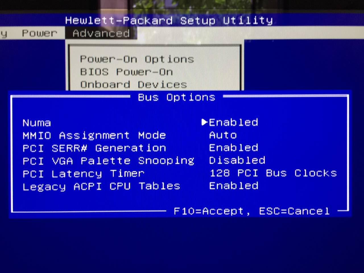

bilbo Posted September 23, 2018 Author Share Posted September 23, 2018 Hi people! Does anyone have high sierra in Hp Z820 with PM working? .... I have almost complete the new how-to for High Sierra , except PM. I don't have any error patching everything, but simply... PM doesn't work. I have figure out that the Legacy ACPI CPU tables (in bios) enabled avoid PM. This option is now mandatory to boot High Sierra, but as I said, avoid PM. I have checked it because in Sierra, where this option is not important for boot, PM only works when this option is disabled in BIOS. This is a {censored}-de-sac . Link to comment https://www.insanelymac.com/forum/topic/333001-guide-2018-z820-sierra-the-great-guide-sucess/page/7/#findComment-2636367 Share on other sites More sharing options...
antonio.clb Posted September 24, 2018 Share Posted September 24, 2018 9 hours ago, bilbo said: Hi people! Does anyone have high sierra in Hp Z820 with PM working? .... I have almost complete the new how-to for High Sierra , except PM. I don't have any error patching everything, but simply... PM doesn't work. I have figure out that the Legacy ACPI CPU tables (in bios) enabled avoid PM. This option is now mandatory to boot High Sierra, but as I said, avoid PM. I have checked it because in Sierra, where this option is not important for boot, PM only works when this option is disabled in BIOS. This is a {censored}-de-sac . Dear bilbo, could you please elaborate a bit more what you mean saying "PM working"? If you mean CPU frequency bouncing from low to high values (not stuck at CPU's stock speed), temperatures and power consumption rising and lowering according to CPU usage like the following HWMonitor screenshot (I've made some light work and closed all opened programs during this log) , I can say my Z620 (not Z820 sorry!) is working well on High Sierra 10.13.6! Please, don't hesitate to contact me if you need further informations, it would be an honor if I can contribute to your guide and maybe we can reach to have Mojave too on our Zx20 workstations! Thanks a lot for your hard work which allowed me to build my little beast! Best regards. AC Link to comment https://www.insanelymac.com/forum/topic/333001-guide-2018-z820-sierra-the-great-guide-sucess/page/7/#findComment-2636391 Share on other sites More sharing options...
bilbo Posted September 24, 2018 Author Share Posted September 24, 2018 Yes. I meant power management. Do you have “Legacy acpi cpu tables” in your bios, and is it activated? If you do, did you need enable it to install Highsierra? Link to comment https://www.insanelymac.com/forum/topic/333001-guide-2018-z820-sierra-the-great-guide-sucess/page/7/#findComment-2636395 Share on other sites More sharing options...
antonio.clb Posted September 24, 2018 Share Posted September 24, 2018 11 minutes ago, bilbo said: Yes. I meant power management. Do you have “Legacy acpi cpu tables” in your bios, and is it activated? If you do, did you need enable it to install Highsierra? Yes bilbo, looks like "Legacy ACPI CPU Tables" is mandatory for 10.13.x: I've tried to disable it and get the following KP at boot: During HS installation, I've followed THESE TIPS. Best regards. AC Link to comment https://www.insanelymac.com/forum/topic/333001-guide-2018-z820-sierra-the-great-guide-sucess/page/7/#findComment-2636396 Share on other sites More sharing options...

bilbo Posted September 26, 2018 Author Share Posted September 26, 2018 (edited) Ok, Problem solved. PM working in High Sierra A brief resume. High Sierra needs activate "Legacy acpi cpu tables" . Yes or Yes. With this option , and our ssdt from previous version, PM doesn't work Sierra doesn't mind if this option is enable or disable. I had this option disabled, so my SSDT created on days of Sierra setup, was created with this option disabled. But , testing High Sierra, with with I booted with Sierra HD, PM was gone. I have read how bios with different options activated could generate different ACPI tables (ssdt, dsdt, etc) , so I decided extracting compare the api tables again with this option enabled. And bingo, dsdt doesn't change, but the ssdt -def , is completely different. It has a different structure. The fix, is obvious. Generate a new SSDT with pikes script. And , et voilá, PM working on High Sierra. And in Sierra, with same ssdt, sure. Edited September 26, 2018 by bilbo 1 Link to comment https://www.insanelymac.com/forum/topic/333001-guide-2018-z820-sierra-the-great-guide-sucess/page/7/#findComment-2637044 Share on other sites More sharing options...
