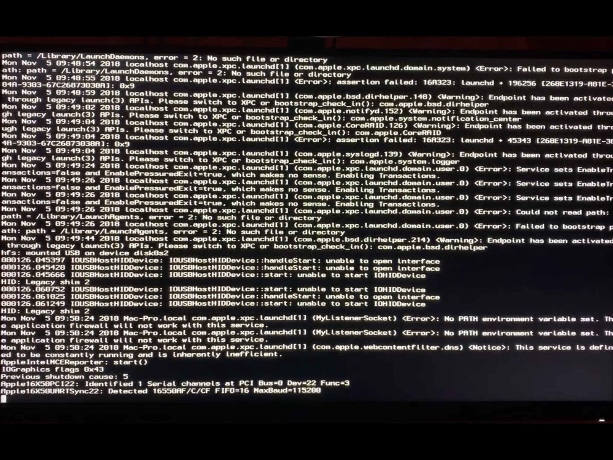

Schmudi Posted November 4, 2018 Share Posted November 4, 2018 First of all a BIG THX to bilbo. Great guide you made here! I did all settings according the guide but i got stuck with macOS utilities. Disk utility is working fine. I can format and whatever. As soon i go back and hit “Install OS” and “continue” the process hangs up. Screen remains normal, continue is greyed out and nothing happens. Has anyone an idea what could be the cause? thx for any help Link to comment https://www.insanelymac.com/forum/topic/333001-guide-2018-z820-sierra-the-great-guide-sucess/page/8/#findComment-2645413 Share on other sites More sharing options...

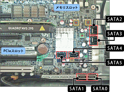

antonio.clb Posted November 4, 2018 Share Posted November 4, 2018 (edited) 8 minutes ago, Schmudi said: SSD is formatted in HFS+ Could you please post a screenshot of Disk Utility's informations about your drive? have you double-checked that it's connected to an AHCI SATA-3 port? Quote The Z620 has a 6-channel SATA interface with its first 2 ports (ports 0 and 1) having SATA III speed capacity, and the 4 added ports (ports 2-5) have SATA II speed capacity. Also take a look at macOS installation log: https://scriptingosx.com/2018/02/show-the-installer-log-during-high-sierra-installation/ Edited November 4, 2018 by antonio.clb Link to comment https://www.insanelymac.com/forum/topic/333001-guide-2018-z820-sierra-the-great-guide-sucess/page/8/#findComment-2645418 Share on other sites More sharing options...
Schmudi Posted November 5, 2018 Share Posted November 5, 2018 14 hours ago, antonio.clb said: Could you please post a screenshot of Disk Utility's informations about your drive? have you double-checked that it's connected to an AHCI SATA-3 port? Also take a look at macOS installation log: https://scriptingosx.com/2018/02/show-the-installer-log-during-high-sierra-installation/ Disk is connected on Port 0. During the initial start (verbose mode) i can see that the disk gets mounted correctly and shows also the file system type HFS+ What i can check is your suggestion to have a look on the log. Thanks for the hint! Link to comment https://www.insanelymac.com/forum/topic/333001-guide-2018-z820-sierra-the-great-guide-sucess/page/8/#findComment-2645563 Share on other sites More sharing options...
antonio.clb Posted November 5, 2018 Share Posted November 5, 2018 9 minutes ago, Schmudi said: Disk is connected on Port 0. During the initial start (verbose mode) i can see that the disk gets mounted correctly and shows also the file system type HFS+ What i can check is your suggestion to have a look on the log. Thanks for the hint! Keep us informed! Link to comment https://www.insanelymac.com/forum/topic/333001-guide-2018-z820-sierra-the-great-guide-sucess/page/8/#findComment-2645567 Share on other sites More sharing options...
Schmudi Posted November 5, 2018 Share Posted November 5, 2018 5 hours ago, antonio.clb said: Keep us informed! Seems that i found something. Can it be that the interface for USB and SATA doesn't come up properly? Link to comment https://www.insanelymac.com/forum/topic/333001-guide-2018-z820-sierra-the-great-guide-sucess/page/8/#findComment-2645634 Share on other sites More sharing options...
Schmudi Posted November 6, 2018 Share Posted November 6, 2018 Seems that i found something. Can it be that the interface for USB and SATA doesn't come up properly?installer is working. had to replace the build. first one was version 10.12.0. build 16322. now i tried 8v.... version 10.12.6Gesendet von iPad mit Tapatalk Link to comment https://www.insanelymac.com/forum/topic/333001-guide-2018-z820-sierra-the-great-guide-sucess/page/8/#findComment-2645943 Share on other sites More sharing options...

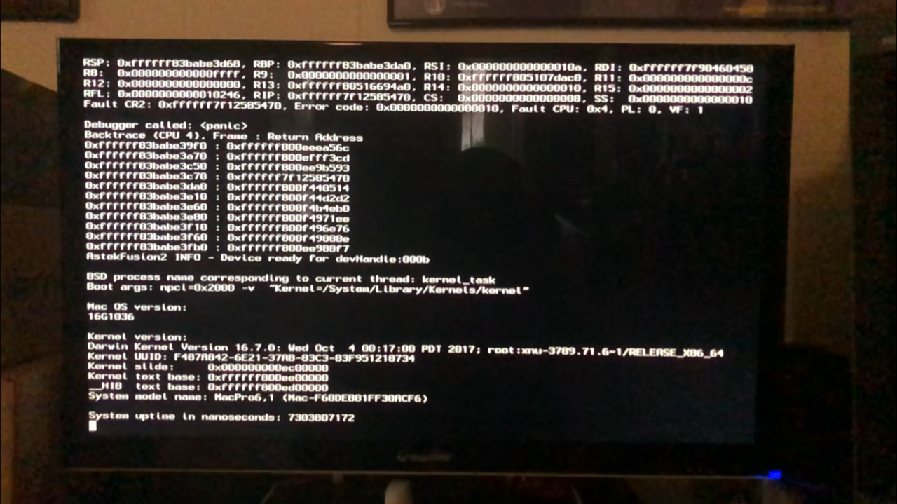

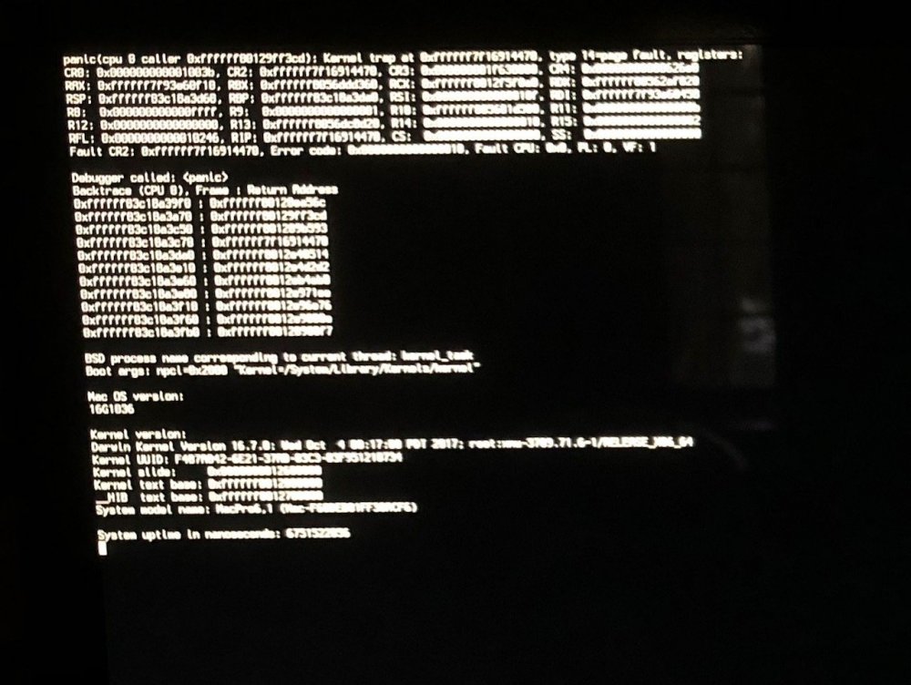

richardskrip Posted May 7, 2019 Share Posted May 7, 2019 System Version: macOS 10.12.6 (16G1036) NVIDIA Web Driver: 378.05.05.25f03 I've verified through the NVIDIA toolbar icon that it is running web drivers. I will go ahead and disable Load VBios. As for the KPs, they occur when I install NvidiaGraphicsFixup.kext into the EFI/EFI/CLOVER/kexts/other folder. For whatever reason that always triggers the KP. Link to comment https://www.insanelymac.com/forum/topic/333001-guide-2018-z820-sierra-the-great-guide-sucess/page/8/#findComment-2672857 Share on other sites More sharing options...
richardskrip Posted May 7, 2019 Share Posted May 7, 2019 So I went ahead and uninstalled both the nvidia web drivers and cuda drivers and then tried reinstalling the NvidiaGraphicsFixup.kext. Still got the same KP. I attempted to grab a screenshot of the KP so you could see what was going on there. Link to comment https://www.insanelymac.com/forum/topic/333001-guide-2018-z820-sierra-the-great-guide-sucess/page/8/#findComment-2672862 Share on other sites More sharing options...
bilbo Posted May 7, 2019 Author Share Posted May 7, 2019 (edited) Ok. That's really weird. Please, tell me: -Thats means that before "to install" NvidiaGraphicsFixup.kext, you didn't have this kext in your clover folder? (that make no sense) -When you uninstall the NvidiaGraphicsFixup.kext, do you have KP? -Why are you using "kernel=/System/Library/Kernels/kernel" bootflag in clover?. That make no sense, either. edited- I didn’t see your first post. could attach your clover folder? Edited May 7, 2019 by bilbo Link to comment https://www.insanelymac.com/forum/topic/333001-guide-2018-z820-sierra-the-great-guide-sucess/page/8/#findComment-2672880 Share on other sites More sharing options...
richardskrip Posted May 7, 2019 Share Posted May 7, 2019 I've attached the clover folder that allows me to boot without KP. If I install the NvidiaGraphicsFixup.kext I will always get a KP. As for "kernel=/System/Library/Kernels/kernel", I didn't even know that was flagged, or how it got flagged. CLOVER.zip Link to comment https://www.insanelymac.com/forum/topic/333001-guide-2018-z820-sierra-the-great-guide-sucess/page/8/#findComment-2672908 Share on other sites More sharing options...
bilbo Posted May 7, 2019 Author Share Posted May 7, 2019 (edited) I've just take a look to your clover folder. I've seen some error into drivers uefi folder ( duplicated OsxAptioFixDrv version, which is a big problem,) but I'm not sure because I'm seeing the driver folder for non uefi boot. Are you using legacy or UEFI boot? Check the dsdt is a bit more complex and I'll need more time. What is your bios version? How many patches did you apply? (Did you follow my guide to patch the dsdt, or maybe are you using one of the templates, or...) With a bit of more time, I'll try to say something more. I've been searching about kernel=/System/Library/Kernels/kernel options. No idea. It seems to be a chameleon (or Enoch bootflag) Edited May 7, 2019 by bilbo Link to comment https://www.insanelymac.com/forum/topic/333001-guide-2018-z820-sierra-the-great-guide-sucess/page/8/#findComment-2672917 Share on other sites More sharing options...
bilbo Posted May 8, 2019 Author Share Posted May 8, 2019 (edited) Ok. I think I got something. Checking your dsdt, you have a wrong fix of irq conflict. You have: Device (HPET) { Name (_HID, EisaId ("PNP0103")) // _HID: Hardware ID Name (CRS, ResourceTemplate () { IRQNoFlags () {0,8,11} IRQNoFlags () {0,8,11} Memory32Fixed (ReadWrite, 0xFED00000, // Address Base 0x00000400, // Address Length _Y32) You have duplicated IRQNoFlags line. It should be only: Device (HPET) { Name (_HID, EisaId ("PNP0103")) // _HID: Hardware ID Name (CRS, ResourceTemplate () { IRQNoFlags () {0,8,11} Memory32Fixed (ReadWrite, 0xFED00000, // Address Base 0x00000400, // Address Length _Y32) This make sense completely about random KP minutes after boot. I had exaclly same issue with this patch and the fix of HPET device (both are related) when I was finding out how fix it (in El Capitán's times). Not sure 100% but lets try fixing this. I attach the dsdt fixed. I added the extra patch to rename devices, too. It's the last of my dsdt patches. Not essential, but tidier. Also: A "drivers64" folder (for clover) with drivers for EFI boot. I don´t know if you use legacy or efi boot, yet, but I guess that you use efi boot. Delete the "drivers" folder. This fix the double foulder, (no sense) and fix the duplicate OsxAptioFixDrv-64.efi versions. It's important only use one of them. For our Z820, OsxAptioFix2Drv-64.efi works. This fix maybe solve the KP at boot. If you use legacy boot, don't use it yet. And also: A more recent version of SSDT-UIAC-ALL ssdt, for fix usb ports. It a better version we made in HighSierra Thread. It covers better the internal usb ports, if you use internal usb2 cards. Let me know, and we will see if we will be able to see what's going on with nvidiafix. DSDT-fixed-by-bilbo.zip SSDT-UIAC-ALL-new-version.zip drivers64UEFI.zip Edited May 8, 2019 by bilbo 1 Link to comment https://www.insanelymac.com/forum/topic/333001-guide-2018-z820-sierra-the-great-guide-sucess/page/8/#findComment-2673031 Share on other sites More sharing options...

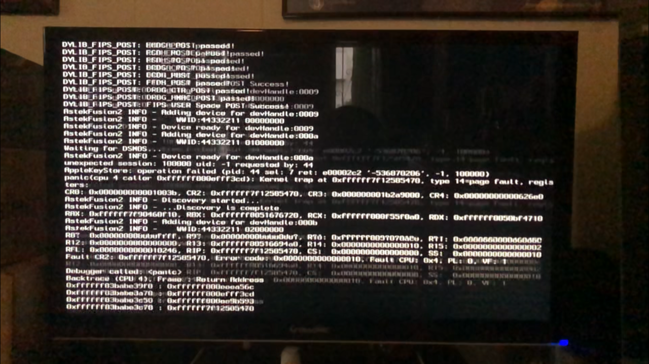

richardskrip Posted May 9, 2019 Share Posted May 9, 2019 I installed the fixed DSDT and SSDT. I also installed the drivers64UEFI folder. The system booted smoothly. However, when I installed the nvidiagraphicsfixup kext, I still got a KP. I'm attaching a photo of the KP. To answer your previous question, I have disabled legacy booting from my bios and have always been booting EFI. Link to comment https://www.insanelymac.com/forum/topic/333001-guide-2018-z820-sierra-the-great-guide-sucess/page/8/#findComment-2673138 Share on other sites More sharing options...
bilbo Posted May 9, 2019 Author Share Posted May 9, 2019 (edited) A quick answer would be "don't use it". . But before of this. Have you tested it for a while after boot? Is it stable? Are you still having random KPs? Returnig to nvidiagraphicsfixup kext, both results don't make sense. Without this kext you would get a black screen. And there is no reason for the KP using it. So, my guess is that, probably, in your tests, you applied the fix manually. This could cause a conflict. Please,go to system/library/extension. Copy AppleGraphicsControl.kext to your desktop.Go to contents of this kext (righ click) >plugins>AppleGraphicsDevicePolicy.kext/Contents/ . Open Info.plist. Search line related to SMBIOS 6.1 to see if you have this one: <key>F60DEB81FF30ACF6 </key> <string>Config2</string> or this one <key>F60DEB81FF30ACF6 </key> <string>none</string> If you fixed manually and you have the second one, you can forget the nvidiakextfix kext and be happy. If you have the first maybe your version is incompatible .We can fix that using other version, or simply, change to the highsierra fix. Anyway, the smbios in your config.plist seems a bit messy. Begin to regenerate it with clover configurator and reboot. You should see in apple system profiler "macpro 6,1" Then, tell me the result of your AppleGraphicsControl.kext test and we will see how continue. Edited May 10, 2019 by bilbo Link to comment https://www.insanelymac.com/forum/topic/333001-guide-2018-z820-sierra-the-great-guide-sucess/page/8/#findComment-2673167 Share on other sites More sharing options...
