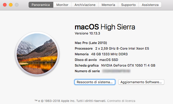

antonio.clb Posted March 12, 2018 Share Posted March 12, 2018 (edited) Hello to everybody and thanks for this great guide! I was able to run Sierra on my Z620 with dual CPU (Sandy Bridge) and now, after a bit of struggling due to InsanelyMac's downtime, I'm writing from my brand new High Sierra 10.13.3 installation! Right now I've managed to install thanks to another source of information, this one: https://github.com/NTT123/Hackintosh-HP-Z420-MacOS-High-Sierra-10.13 but I'd like to refine it a bit following bilbo's guide... Anyone could please re-share bilbo's ZIP file? I can't manage to download (0 byte archive). Edited March 12, 2018 by antonio.clb Link to comment https://www.insanelymac.com/forum/topic/333001-guide-2018-z820-sierra-the-great-guide-sucess/page/3/#findComment-2602541 Share on other sites More sharing options...

antonio.clb Posted March 12, 2018 Share Posted March 12, 2018 Thanks a lot bilbo! I confirm that, on my Z620, USB 3.0 ports are now working like a charm with your mXHCD.kext (no USB 3.0 show in system profiler but maybe it's a matter of those cosmetic fixes...)! I'll try to optimize and summarize my settings and share them with the community in the next few days. For now, I can tell you that audio is working really good with VoodooHDA.kext. Thanks again for your Link to comment https://www.insanelymac.com/forum/topic/333001-guide-2018-z820-sierra-the-great-guide-sucess/page/3/#findComment-2602547 Share on other sites More sharing options...

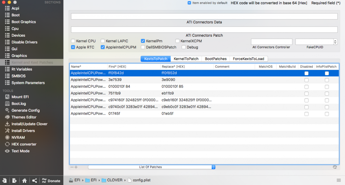

ho520726 Posted March 17, 2018 Share Posted March 17, 2018 Thanks for bilbo. I successfully transfer from 10.11 to 10.12 with dual E5-2670 v1 and bios 3.91. But I got a problem which is I can't really shutdown my computer. It is always restart instead of shut down. Anyone know how to fix this minor problem. I just directly use the file(06 CLOVER FINAL -NO-PM) provided from billbo. Of course, I fixed PM later. Link to comment https://www.insanelymac.com/forum/topic/333001-guide-2018-z820-sierra-the-great-guide-sucess/page/3/#findComment-2603784 Share on other sites More sharing options...
antonio.clb Posted March 19, 2018 Share Posted March 19, 2018 On 17/3/2018 at 9:59 PM, ho520726 said: Thanks for bilbo. I successfully transfer from 10.11 to 10.12 with dual E5-2670 v1 and bios 3.91. But I got a problem which is I can't really shutdown my computer. It is always restart instead of shut down. Anyone know how to fix this minor problem. I just directly use the file(06 CLOVER FINAL -NO-PM) provided from billbo. Of course, I fixed PM later. Same problem here with my Z620 on High Sierra: reboot or shutdown fail with a "929-Fatal MCA error". Pressing F1 will continue the boot process. Link to comment https://www.insanelymac.com/forum/topic/333001-guide-2018-z820-sierra-the-great-guide-sucess/page/3/#findComment-2604094 Share on other sites More sharing options...
bilbo Posted March 19, 2018 Author Share Posted March 19, 2018 no idea. I don't have any problem with shutdown , even in the early process, at first boot, without patches. Are you using your own dsdt patched, or you are using mine? Link to comment https://www.insanelymac.com/forum/topic/333001-guide-2018-z820-sierra-the-great-guide-sucess/page/3/#findComment-2604334 Share on other sites More sharing options...
amadeusex Posted March 21, 2018 Share Posted March 21, 2018 On 3/17/2018 at 10:59 PM, ho520726 said: Thanks for bilbo. I successfully transfer from 10.11 to 10.12 with dual E5-2670 v1 and bios 3.91. But I got a problem which is I can't really shutdown my computer. It is always restart instead of shut down. Anyone know how to fix this minor problem. I just directly use the file(06 CLOVER FINAL -NO-PM) provided from billbo. Of course, I fixed PM later. Here's my Siera EFI folder (I have the same cpu's) give it a shot (after you've adjusted everything to Your specs of course) and let us know if it works. https://drive.google.com/open?id=1uyrw0FaqrIoBa8HZlBdxRQdjpHXyj8n8 https://drive.google.com/open?id=1B1d2EfQJ213d6cQizfa8195f8RsoIHrS (Kexts in S/L/E) I patched aicpupm but used the cloverpatch Link to comment https://www.insanelymac.com/forum/topic/333001-guide-2018-z820-sierra-the-great-guide-sucess/page/3/#findComment-2604846 Share on other sites More sharing options...
wham17wham Posted March 24, 2018 Share Posted March 24, 2018 (edited) 1. ( for ho520726 ) Newest Clover configurator has a shut down patch. Try to enable it. 2. (for bilbo) About High Sierra, there are one DSDT patch to prevent quick rebooting at very beginning. Then, you can finished the installation. I believe. Edited March 24, 2018 by wham17wham Link to comment https://www.insanelymac.com/forum/topic/333001-guide-2018-z820-sierra-the-great-guide-sucess/page/3/#findComment-2605451 Share on other sites More sharing options...

ho520726 Posted March 25, 2018 Share Posted March 25, 2018 @amadeusex Thank for your help. I fixed the shutdown problem with clover configurator "shutdown" path. Actually, I fixed pm by follow the way how bilbo listed and finally put your dsdt file and it works. Thank for sharing your file. Glad I have the same cpus as you. @wham17wham Thank for your help. It did work. Another problem, I just find out a very annoying problem, I don't know is it my motherboard is going down. When I am downloading file from Internet the lan port or motherboard make some noise(especially down as high speed like 10MB/per sec, it would be more noise). I didn't realize that problem when I installed my pc with mac 10.11 in my workplace(a more noise environment), but now I moved my pc to my home. The noise is more visible. Anyone is same????? In this problem, I also find out one problem is that the IntelMausiEthernet.kext can't support two lan port even I used the dpci manager to check it can show two network controllers. I can only use the upper lan port. The bottom one can't use. so I replace it with Appleintele1000e.kext and it works. (I also dun know is it my own problem as well, just to mention what I experienced) 1 Link to comment https://www.insanelymac.com/forum/topic/333001-guide-2018-z820-sierra-the-great-guide-sucess/page/3/#findComment-2605635 Share on other sites More sharing options...
Cass67 Posted March 25, 2018 Share Posted March 25, 2018 (edited) 3 hours ago, ho520726 said: [mention=885315]amadeusex[/mention] Thank for your help. I fixed the shutdown problem with clover configurator "shutdown" path. Actually, I fixed pm by follow the way how bilbo listed and finally put your dsdt file and it works. Thank for sharing your file. Glad I have the same cpus as you. [mention=2137512]wham17wham[/mention] Thank for your help. It did work. Another problem, I just find out a very annoying problem, I don't know is it my motherboard is going down. When I am downloading file from Internet the lan port or motherboard make some noise(especially down as high speed like 10MB/per sec, it would be more noise). I didn't realize that problem when I installed my pc with mac 10.11 in my workplace(a more noise environment), but now I moved my pc to my home. The noise is more visible. Anyone is same????? In this problem, I also find out one problem is that the IntelMausiEthernet.kext can't support two lan port even I used the dpci manager to check it can show two network controllers. I can only use the upper lan port. The bottom one can't use. so I replace it with Appleintele1000e.kext and it works. (I also dun know is it my own problem as well, just to mention what I experienced) Noise i suspect is the PSU coils or chokes.. I have it also.. it's normal and often referred to as coil whine. I suspect it's due to the PSU / system not using much power. I do not get it when PM is off. I have it bad on Windows and OSX. Under Linux it's silent... Pain in the ass and prevents me using OSX. Some fixes for this online appear to be squirt hot glue on the PSU coils but it did not work for me. Edited March 25, 2018 by Cass67 cleanup double quoting from tapatalk post Link to comment https://www.insanelymac.com/forum/topic/333001-guide-2018-z820-sierra-the-great-guide-sucess/page/3/#findComment-2605638 Share on other sites More sharing options...
