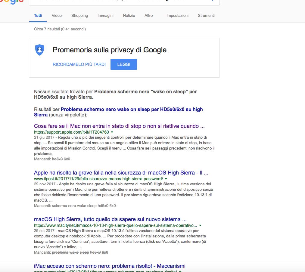

innerd Posted February 10, 2018 Author Share Posted February 10, 2018 Ho trovato questo ma non parla di config: I have fixed my same issue by fixing EDID. 1. Use Darwin Dumper to dump your EDID Values. 2.Download FixEDID from somewhere in insanelymac. Use your Darwin dumper created bin file.Select device type nearly closer to your system spec(Your SMBIOS model Probably) . 3.Make the files. 4.Now copy the vendorID-XXX folder to /System/Library/Displays/Contents/Resources/Overrides/ 5.reboot and try,If it does not fix the issue then try another device type.Probably MacBook Pro or MacBook Air.repeat the other process. Link to comment https://www.insanelymac.com/forum/topic/332383-prima-installazione-high-sierra-su-asus-n552vx-fw131t/page/7/#findComment-2588924 Share on other sites More sharing options...

innerd Posted February 10, 2018 Author Share Posted February 10, 2018 Il primo non mi sembra relativo al problema. Link to comment https://www.insanelymac.com/forum/topic/332383-prima-installazione-high-sierra-su-asus-n552vx-fw131t/page/7/#findComment-2588950 Share on other sites More sharing options...
Jolly Posted February 10, 2018 Share Posted February 10, 2018 Non so che dire, il problema mi sembrava chiaro: http://www.insanelymac.com/forum/topic/332383-prima-installazione-high-sierra-su-asus-n552vx-fw131t/page-8?do=findComment&comment=2588876 al link hai la soluzione, più di così? ti ho già detto che è una procedura che puoi fare solo tu dal tuo laptop Link to comment https://www.insanelymac.com/forum/topic/332383-prima-installazione-high-sierra-su-asus-n552vx-fw131t/page/7/#findComment-2589016 Share on other sites More sharing options...
innerd Posted February 10, 2018 Author Share Posted February 10, 2018 ok scusa, ma su tutti i browser su macos non dava risultati quella ricerca, provando sul pc con vivaldi ho trovato il link. Comunque non mi funziona, con un unico profilo non mi da lo schermo nero (apple imac display), ma in quel caso si riavvia semplicemente. Grazie comunque Link to comment https://www.insanelymac.com/forum/topic/332383-prima-installazione-high-sierra-su-asus-n552vx-fw131t/page/7/#findComment-2589134 Share on other sites More sharing options...
