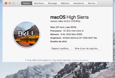

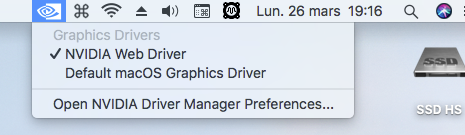

chris1111 Posted March 26, 2018 Share Posted March 26, 2018 (edited) Done Beta 7all is good here Also no issue on Dell Opiplex 790 with GeForce GT 1030 Pascal GPU WebDrivers 161 patch Easy Web Drivers Patcher Edited March 26, 2018 by chris1111 2 Link to comment https://www.insanelymac.com/forum/topic/331985-pre-release-macos-high-sierra-10134/page/18/#findComment-2605836 Share on other sites More sharing options...

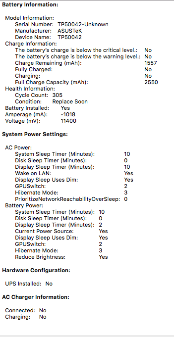

SavageAUS Posted March 26, 2018 Share Posted March 26, 2018 Beta 7 no issues on laptop except now my battery says to replace soon. Desktop however I had to block NvidiaGraphicsFixUp.kext from being injected to get to final installation stage (happening now). 1 Link to comment https://www.insanelymac.com/forum/topic/331985-pre-release-macos-high-sierra-10134/page/18/#findComment-2605843 Share on other sites More sharing options...
Fergarth Posted March 26, 2018 Share Posted March 26, 2018 (edited) Update done! As always and as expected, everything perfect here on the two boys! Nvda Web Patcher did the job and Web 160 works fine here. I think Apple gave up giving us a fight Edited March 27, 2018 by Fergarth 2 1 Link to comment https://www.insanelymac.com/forum/topic/331985-pre-release-macos-high-sierra-10134/page/18/#findComment-2605844 Share on other sites More sharing options...

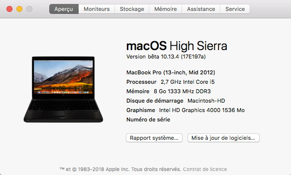

Guest ricoc90 Posted March 26, 2018 Share Posted March 26, 2018 (edited) 3 hours ago, Fergarth said: I think Apple gave up giving us a fight Ha, not today! On the Optiplex 790 the update went smooth as usual Spoiler On the Probook the update went smooth as usual Spoiler On the Optiplex 755 however, the update fails ... An error occurred while extracting files from the package “macOSUpd10.13.4.pkg” NSFilePath=/Volumes/Macintosh SSD/.PKInstallSandboxManager-SystemSoftware/BE532251-D324-4E77-9369-CCE971E4D4F6.activeSandbox/Root NSURL=macOSUpd10.13.4.pkg -- file:///Volumes/Macintosh%20SSD/Library/Updates/AtomicUpdates/091-76096/ PKInstallPackageIdentifier=com.apple.pkg.update.os.10.13.4.17E197a NSUnderlyingError=0x7f9b2c399ab0 {Error Domain=PKXARArchiveErrorDomain Code=101 "archive verify failed" Edit: re-downloaded the update (for the third time now) but again it fails. Also "archive verify failed", but this time on Extracting the EFI Payload (?) I also noticed that the download is only 1,8GB whereas it was 2,3GB on my other systems. Weird. I Downloaded the full installer now, will do a clean install of DP 7 later. Edited March 27, 2018 by ricoc90 Link to comment https://www.insanelymac.com/forum/topic/331985-pre-release-macos-high-sierra-10134/page/18/#findComment-2605845 Share on other sites More sharing options...

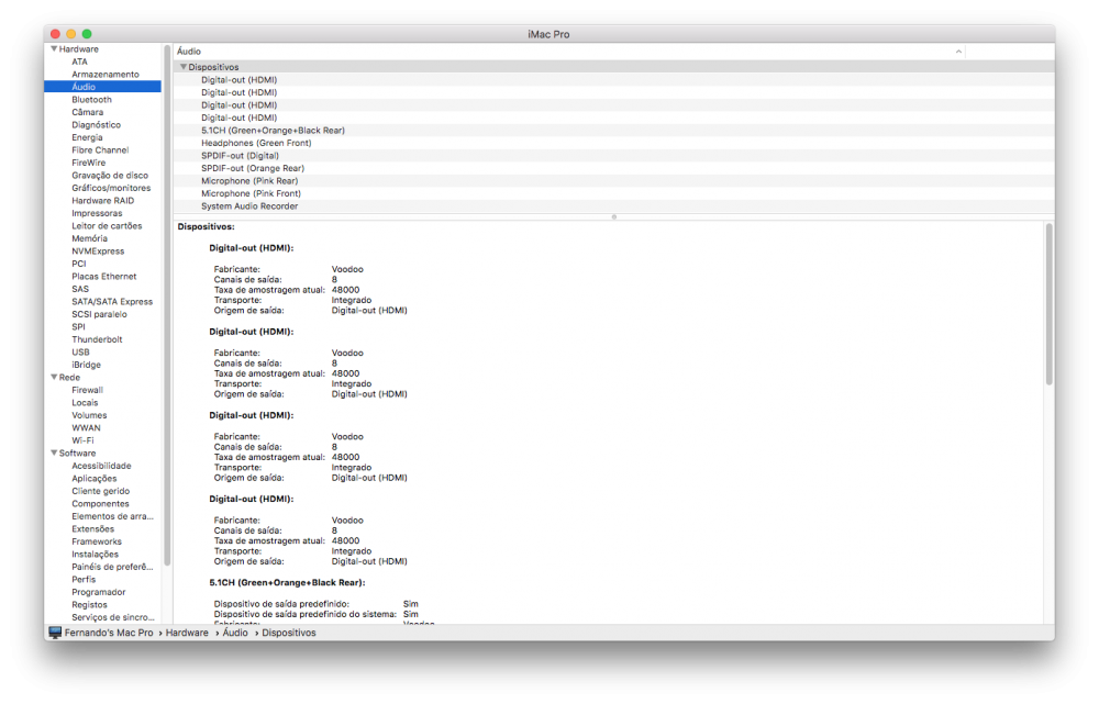

Guest Posted March 27, 2018 Share Posted March 27, 2018 (edited) All fine also here applehda need a rollback for DP audio also in this beta release Pmheart patch for USB is working Oarksit performance EIST enabled fix made for beta by Pmheart is not working Edited March 27, 2018 by Guest add some infos Link to comment https://www.insanelymac.com/forum/topic/331985-pre-release-macos-high-sierra-10134/page/18/#findComment-2605889 Share on other sites More sharing options...

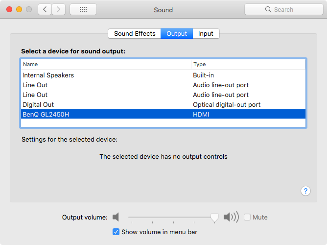

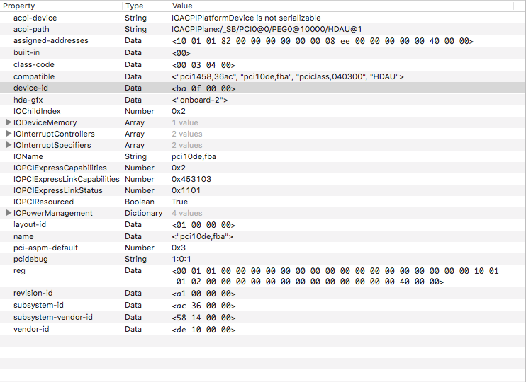

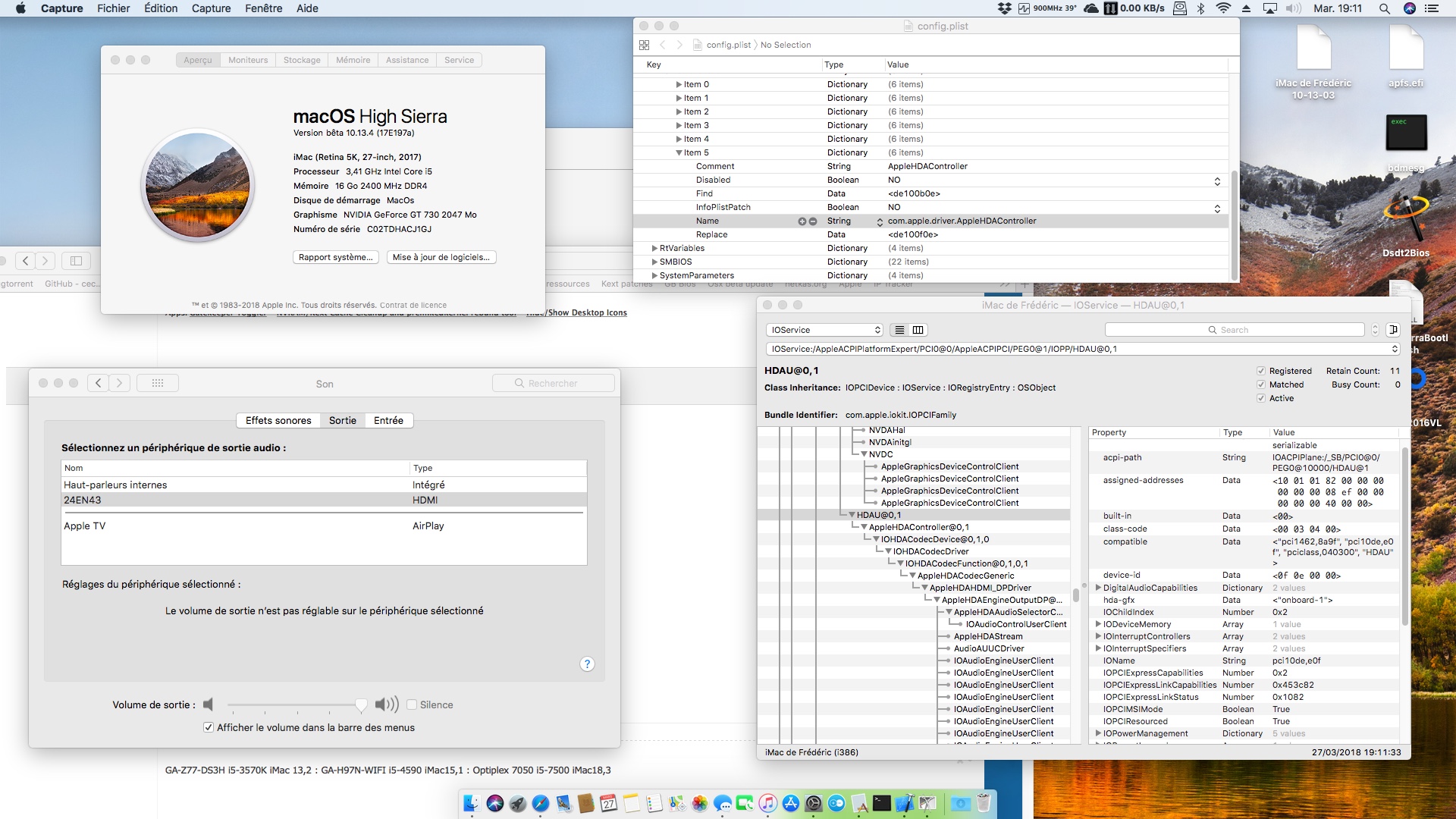

FredWst Posted March 27, 2018 Share Posted March 27, 2018 (edited) Hello, Patch NVIDIA HDMI 10.13.4 In clover find "de 10 0b 0e" -> Find HDMI id as close as mine. you can take a look in AppleHDAController -> maybe not necessary. Name com.apple.driver.AppleHDAController replace "de 10 0f 0e" -> 0f 0e is my HDAU id. Works. Edit: Also works with AppleALC Dev needs to replace on the fly with HDAU id found in devtree. Edited March 27, 2018 by FredWst 8 3 Link to comment https://www.insanelymac.com/forum/topic/331985-pre-release-macos-high-sierra-10134/page/18/#findComment-2605938 Share on other sites More sharing options...

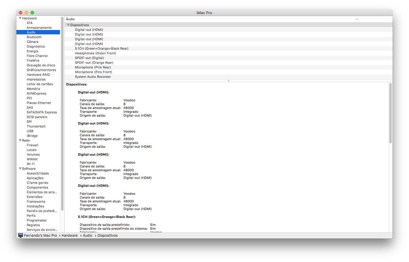

SavageAUS Posted March 28, 2018 Share Posted March 28, 2018 (edited) 16 hours ago, FredWst said: Hello, Patch NVIDIA HDMI 10.13.4 In clover find "de 10 0b 0e" -> Find HDMI id as close as mine. you can take a look in AppleHDAController -> maybe not necessary. Name com.apple.driver.AppleHDAController replace "de 10 0f 0e" -> 0f 0e is my HDAU id. Works. Edit: Also works with AppleALC Dev needs to replace on the fly with HDAU id found in devtree. Have you made a post in the AppleALC section? Maybe they can include a fix? Also @FredWst attached is an image of my ioreg for hdau can you help with find replace please. Sent from my SM-G930F using Tapatalk Pro Edited March 28, 2018 by SavageAUS 1 Link to comment https://www.insanelymac.com/forum/topic/331985-pre-release-macos-high-sierra-10134/page/18/#findComment-2605993 Share on other sites More sharing options...

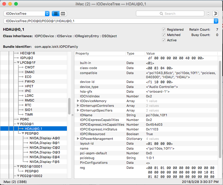

jsl2000 Posted March 28, 2018 Share Posted March 28, 2018 (edited) 20 hours ago, FredWst said: Hello, Patch NVIDIA HDMI 10.13.4 In clover find "de 10 0b 0e" -> Find HDMI id as close as mine. you can take a look in AppleHDAController -> maybe not necessary. Name com.apple.driver.AppleHDAController replace "de 10 0f 0e" -> 0f 0e is my HDAU id. Works. Edit: Also works with AppleALC Dev needs to replace on the fly with HDAU id found in devtree. Your patch not working in mine, because my IORegistryExplorer showed it's pci10de10,10f1 instead of yours. What patch should I apply to fix it ? [Edit] Sorry for my mistake! After re-edit my config.plist it worked at 10.13.4 (17E182a & 17E197a) with AppleHDA.kext (281.51), but not working at 17E170c with AppleHDA.kext (281.52) at first. Only rebuild prelinkedkernel by Kext Utility can make it working eventually ! After repeated reboot I found that this patching is not so stable or reliable, it may lose HDMI audio from GTX-1060 without any particular reason. The only way to regain it was to rebuild prelinkedkernel by Kext Utility again and reboot ! Thanks ! Edited March 28, 2018 by jsl2000 Link to comment https://www.insanelymac.com/forum/topic/331985-pre-release-macos-high-sierra-10134/page/18/#findComment-2606013 Share on other sites More sharing options...
FredWst Posted March 28, 2018 Share Posted March 28, 2018 2 hours ago, jsl2000 said: Your patch not working in mine, because my IORegistryExplorer showed it's pci10de10,10f1 instead of yours. What patch should I apply to fix it ? In your case : replace "de 10 f1 10" Now Ineed to find where ID's checked in binary to bypass it Fred 10 hours ago, SavageAUS said: Have you made a post in the AppleALC section? Maybe they can include a fix? Also @FredWst attached is an image of my ioreg for hdau can you help with find replace please. Sent from my SM-G930F using Tapatalk Pro replace "de 10 ba 0f" Fred 1 Link to comment https://www.insanelymac.com/forum/topic/331985-pre-release-macos-high-sierra-10134/page/18/#findComment-2606020 Share on other sites More sharing options...
Guest Posted March 28, 2018 Share Posted March 28, 2018 (edited) @FredWst this your finding is useful also for DP audio? I have tried to replace my device id but it is not working (I am using AppleALC kext in my efi previously working till beta 5) Thank you Edited March 28, 2018 by Guest Link to comment https://www.insanelymac.com/forum/topic/331985-pre-release-macos-high-sierra-10134/page/18/#findComment-2606021 Share on other sites More sharing options...
SavageAUS Posted March 28, 2018 Share Posted March 28, 2018 54 minutes ago, FredWst said: replace "de 10 ba 0f" Fred That worked, thank you. Have hot had HDMI for the .4 betas until now. Link to comment https://www.insanelymac.com/forum/topic/331985-pre-release-macos-high-sierra-10134/page/18/#findComment-2606024 Share on other sites More sharing options...
jsl2000 Posted March 28, 2018 Share Posted March 28, 2018 1 hour ago, FredWst said: In your case : replace "de 10 f1 10" Now Ineed to find where ID's checked in binary to bypass it Fred Thanks for your prompt reply and help. After re-edit my config.plist and reboot, HDMI audio from GTX-1060 works at 10.13.4 (17E197a) ! Link to comment https://www.insanelymac.com/forum/topic/331985-pre-release-macos-high-sierra-10134/page/18/#findComment-2606028 Share on other sites More sharing options...
FredWst Posted March 28, 2018 Share Posted March 28, 2018 5 hours ago, fabiosun said: @FredWst this your finding is useful also for DP audio? I have tried to replace my device id but it is not working (I am using AppleALC kext in my efi previously working till beta 5) Thank you I don't know but give it a try, attach your ioreg Fred 1 Link to comment https://www.insanelymac.com/forum/topic/331985-pre-release-macos-high-sierra-10134/page/18/#findComment-2606074 Share on other sites More sharing options...
