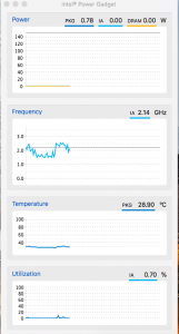

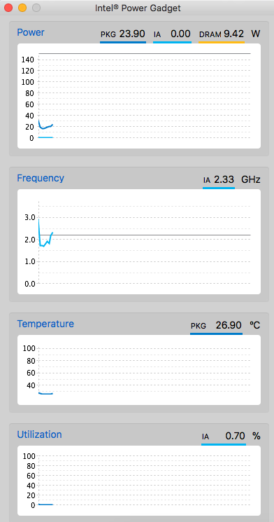

Guest Posted January 17, 2018 Share Posted January 17, 2018 how are you guys getting Dram and IA to show up? they display 0 on my skylake build. Link to comment https://www.insanelymac.com/forum/topic/331523-intel-power-gadget-370/#findComment-2570984 Share on other sites More sharing options...
Guest Posted January 17, 2018 Share Posted January 17, 2018 no during some testing I noticed graphical IPG values are influenced (in bad way) by ie KernelXCPM clover flag in my case also power wattage are influence from cpu SVID parameter on bios (auto/enabled produce different results) so you have Dram, hmmm... you xmp in the bios enabled? Link to comment https://www.insanelymac.com/forum/topic/331523-intel-power-gadget-370/#findComment-2570999 Share on other sites More sharing options...
Guest Posted January 17, 2018 Share Posted January 17, 2018 enabled in auto you should have also wattage wrong display I don't know if 3.50 3.51 IPG release have fixed this wattage visualization was a problem also in windows if auto was set in cpu svid hmm i have my bios patched. for cpu SVID, is yours set to enable, or auto? msr 0xE2 patch should not be related to your problem Link to comment https://www.insanelymac.com/forum/topic/331523-intel-power-gadget-370/#findComment-2571017 Share on other sites More sharing options...
surfcaster Posted January 17, 2018 Share Posted January 17, 2018 works perfect on my hardware (Sandy) edit: 3.5.1 Link to comment https://www.insanelymac.com/forum/topic/331523-intel-power-gadget-370/#findComment-2571019 Share on other sites More sharing options...
Guest Posted January 17, 2018 Share Posted January 17, 2018 this is with cpu SVID in auto enabled in auto you should have also wattage wrong display I don't know if 3.50 3.51 IPG release have fixed this wattage visualization was a problem also in windows if auto was set in cpu svid msr 0xE2 patch should not be related to your problem Link to comment https://www.insanelymac.com/forum/topic/331523-intel-power-gadget-370/#findComment-2571022 Share on other sites More sharing options...
