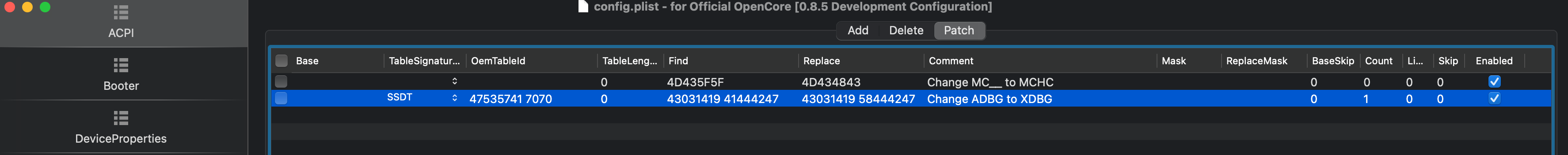

Cyberdevs Posted September 30, 2022 Share Posted September 30, 2022 @i0ntempest I have this patch enabled in my config maybe that's why it doesn't work on your rig: Link to comment https://www.insanelymac.com/forum/topic/330614-marvell-aquantia-10-gb-ethernet-support-thread/page/19/#findComment-2794228 Share on other sites More sharing options...
i0ntempest Posted September 30, 2022 Share Posted September 30, 2022 10 hours ago, Cyberdevs said: @i0ntempest I have this patch enabled in my config maybe that's why it doesn't work on your rig: I think that is for an ACPI error on Z690? I have Z390... anyway i'll try. Link to comment https://www.insanelymac.com/forum/topic/330614-marvell-aquantia-10-gb-ethernet-support-thread/page/19/#findComment-2794275 Share on other sites More sharing options...

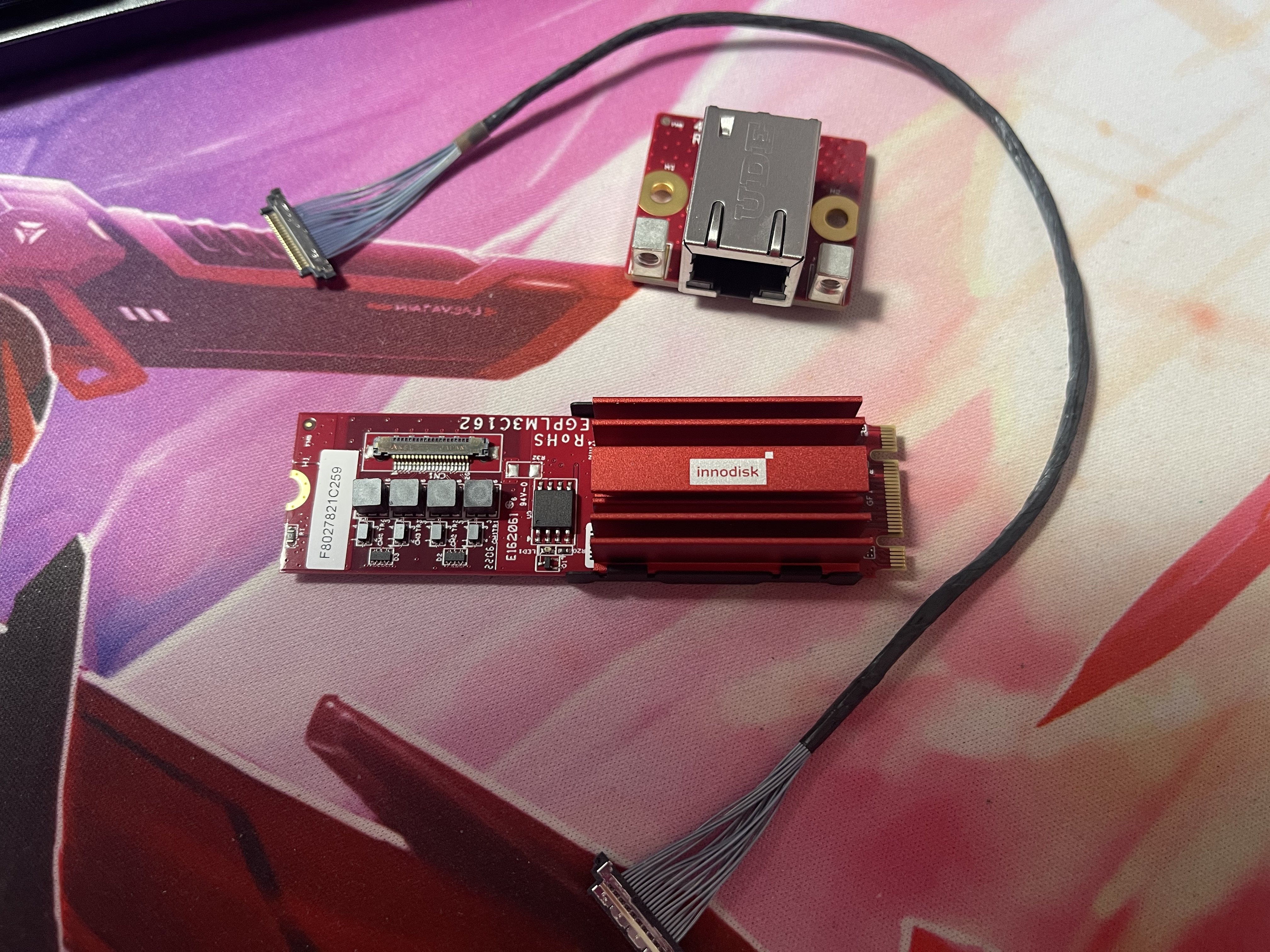

i0ntempest Posted October 4, 2022 Share Posted October 4, 2022 (edited) Anyways, I just installed a M.2 AQC113 card into my mini Hackintosh and the airplay problem is there as well. Looks like a common problem for these chips with ID 14c0. I guess worst case the next major OS upgrade should solve this. Edited October 4, 2022 by i0ntempest Link to comment https://www.insanelymac.com/forum/topic/330614-marvell-aquantia-10-gb-ethernet-support-thread/page/19/#findComment-2794405 Share on other sites More sharing options...

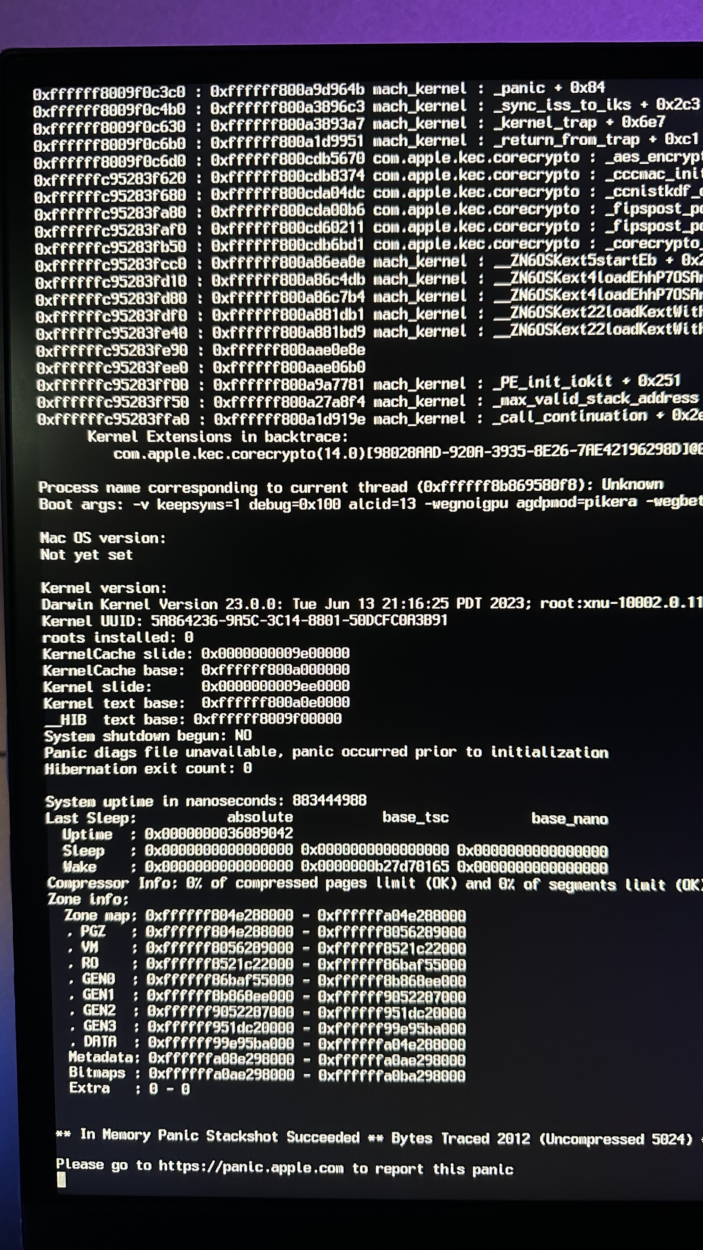

surenmunoo Posted June 26, 2023 Share Posted June 26, 2023 I get the below kernel panic when I try to enable the 10G Aquantia patch in kernel - patch section, panic is only in Sonoma and Ventura boots fine with this patch. Link to comment https://www.insanelymac.com/forum/topic/330614-marvell-aquantia-10-gb-ethernet-support-thread/page/19/#findComment-2807309 Share on other sites More sharing options...
miliuco Posted June 26, 2023 Share Posted June 26, 2023 @surenmunoo Latest 0.9.4 build? After "OcAppleKernelLib: FixForceAquantiaEthernet quirk on macOS 14 beta 2, thx @SHikumo" and "OcAppleKernelLib: FixForceAquantiaEthernet patch by @Mieze"? 2 Link to comment https://www.insanelymac.com/forum/topic/330614-marvell-aquantia-10-gb-ethernet-support-thread/page/19/#findComment-2807310 Share on other sites More sharing options...
surenmunoo Posted June 26, 2023 Share Posted June 26, 2023 31 minutes ago, miliuco said: @surenmunoo Latest 0.9.4 build? After "OcAppleKernelLib: FixForceAquantiaEthernet quirk on macOS 14 beta 2, thx @SHikumo" and "OcAppleKernelLib: FixForceAquantiaEthernet patch by @Mieze"? I am on latest nightly build, if i disable the patch i can boot Sonoma, the quirk does not work for the Asus Z790 ProArt. 2 Link to comment https://www.insanelymac.com/forum/topic/330614-marvell-aquantia-10-gb-ethernet-support-thread/page/19/#findComment-2807314 Share on other sites More sharing options...
cankiulascmnfye Posted June 26, 2023 Share Posted June 26, 2023 @surenmunoo If you are certain, the quirk is the cause for Sonoma not booting, I would create a boot log with the debug version of OpenCore and create a bug report 2 Link to comment https://www.insanelymac.com/forum/topic/330614-marvell-aquantia-10-gb-ethernet-support-thread/page/19/#findComment-2807317 Share on other sites More sharing options...
surenmunoo Posted June 26, 2023 Share Posted June 26, 2023 10 minutes ago, cankiulascmnfye said: @surenmunoo If you are certain, the quirk is the cause for Sonoma not booting, I would create a boot log with the debug version of OpenCore and create a bug report Silly question, is the boot log the debug systext file it creates when it dumps the ssdt's and dsdt's. Link to comment https://www.insanelymac.com/forum/topic/330614-marvell-aquantia-10-gb-ethernet-support-thread/page/19/#findComment-2807318 Share on other sites More sharing options...
