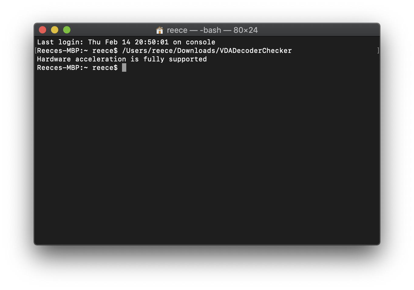

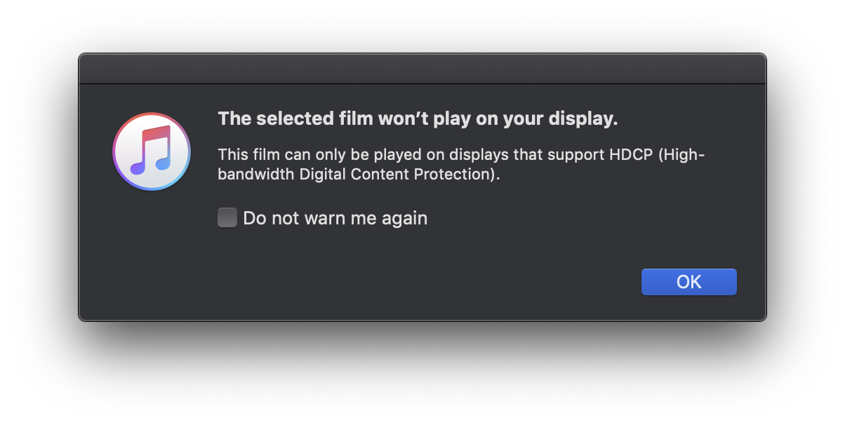

First off thanks for the information in this thread @Andrey1970 and @Pavo. When I was reading through it helped me understand Shiki a bit better. I am trying to get iTunes DRM working and I have been hitting a lot of brick walls. However with the information on this thread it is closer to working than ever. I am trying to get the DRM to work on an internal screen here. I am using an XPS 9550 with HD530 integrated graphics (Skylake). With your information with downloaded iTunes content I can now get it to display for a few seconds on iTunes before it complains that "The selected film won't play on your display." HDCP error. For main SMBIOS I am using MacBookPro13,3 as that is closest to my laptops configuration. For Shiki I set the board ID to Mac-4B682C642B45593E (iMac18,1) and used shikigva=40. Attached is my config.plist, Kexts and System report from Kext Updater, screenshots of the error and results of VDADecoderChecker. Graphics acceleration is active and working and DRM is working on the internal screen through Firefox just Safari and iTunes are the problem. I have tried different shikigva numbers etc and I am no closer to figuring out why this is happening. Any help would be greatly appreciated. Any additional attachments I will provide if required. With Hackintool I saw in Displays there is an option to inject EDID to an iMac or MacBook Air display as my screen is 16:9. Is this maybe a potential solution?
Thanks in advance
Reece
Systemreport.zip
This problem on all IGPU(Ivy Bridge and newer) in solo mode.
Edited by Andrey1970
3 minutes ago, reece394 said:
Ah okay so no fix for it. I am glad I didn’t make a stupid error thanks for the quick reply @Andrey1970
On notebooks not to solve it.
On desktops it is possible to solve it - use dGPU and IGPU for IQSV only.
  • Thanks 1
