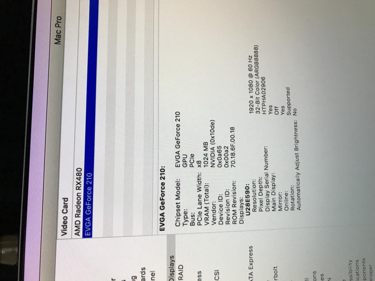

Hey it turns out you can boot with a gt210. @Gigamaxx I'm trying to boot a rx 480 with a helper card but once it loads it boots up using the gt210. Is there extra steps I need to do to enable the rx 480?

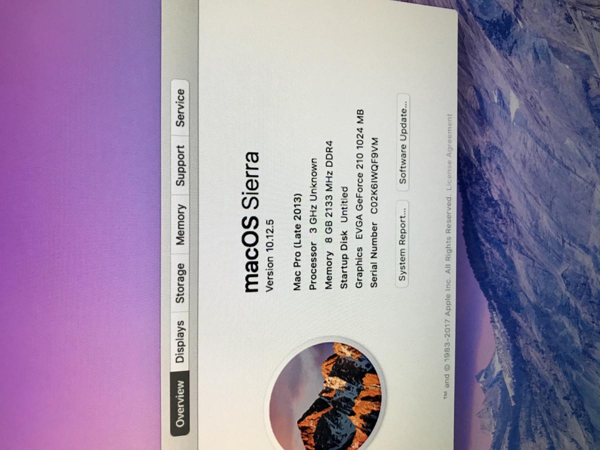

I'm in 10.12.5 it is safe to update to 10.12.6 ???
I'm currently using smbios 6,2
I saw a post where you mentioned that 10.12.6 was easier with smbios 14,2 and higher

Update to 10.6 it has all the drivers for RX to get acceleration in 10.5 you need to make edits or fake ATI ID 0x67EF1002.   Symbios not too important for RX support, I've used Mac Mini to MacBook 8.1.     Mac Pro is good.

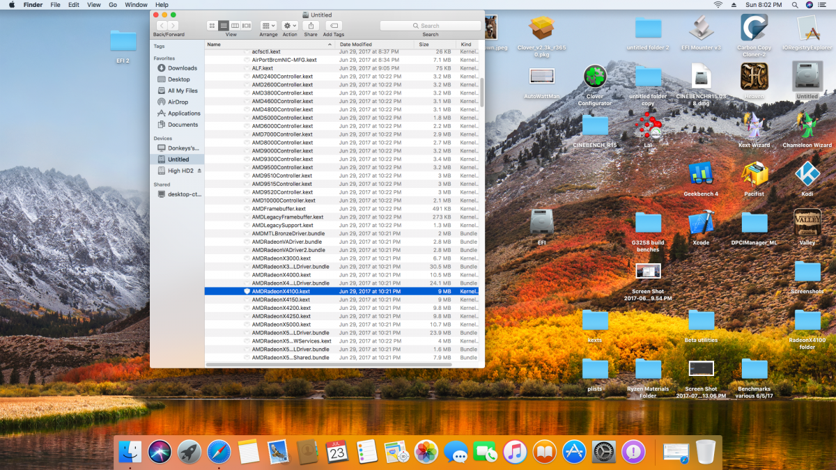

Try the fake ID first.   Then just update and do the edits again.   It should work on a clone.
If you want to do the Manual edits in 10.5 its easy, and will be quicker.    Post a screenshot of S/L/Extensions with the AMD kexts see pic.

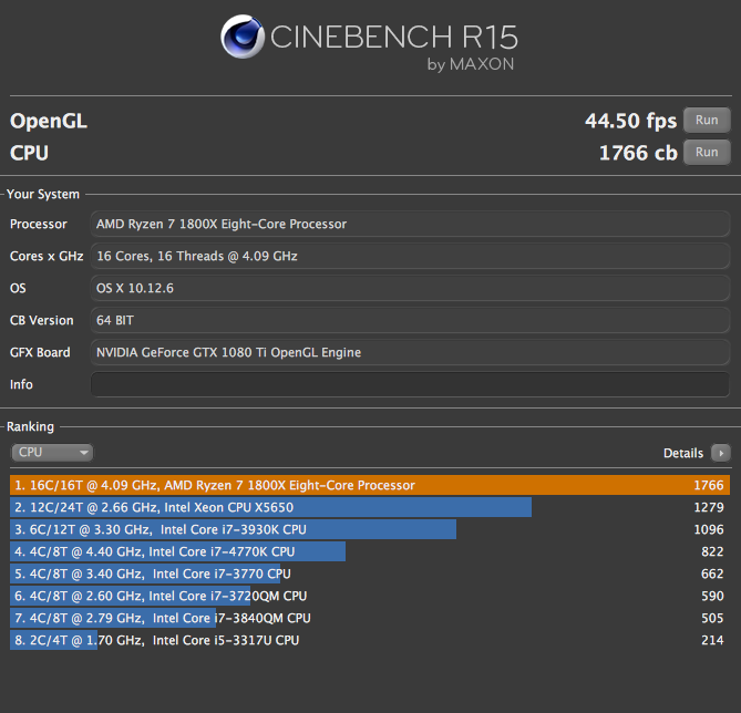

Final Updates on the system:
Specs:
Ryzen 7 1800x 4.1GHz OC
Asus ROG Crosshair VI Hero
Zotac GeForce GTX 1080Ti
32GB Corsair Dominator Platinum 3000 MHz (14,14,14,14,34 timings) . **EDIT: RAM speed actually 2933 with OC Profile that I am using. Sorry for misleading information.**
Everything works pretty well. Was able to get booted into macOS without any helper card or anything like that.
Weird items include having to be connected ONLY through HDMI to get it to boot. Once booted I can use my two displayport attached monitors without issue. Also front USB 2.0 not working but I think I just need to find the right kext file for that.
As everyone has previously stated, OpenGL scores are quite disappointing, but the CPU test scores on CB are almost as good as my windows scores. See attached screenshots for reference.
Thank you to EVERYONE who has contributed on this forum for advice! I was determined to get it working and because of you I was able to do so!!!
