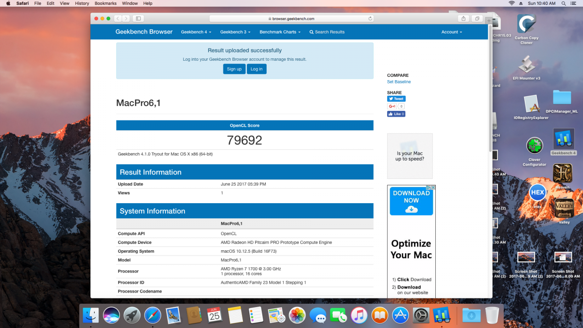

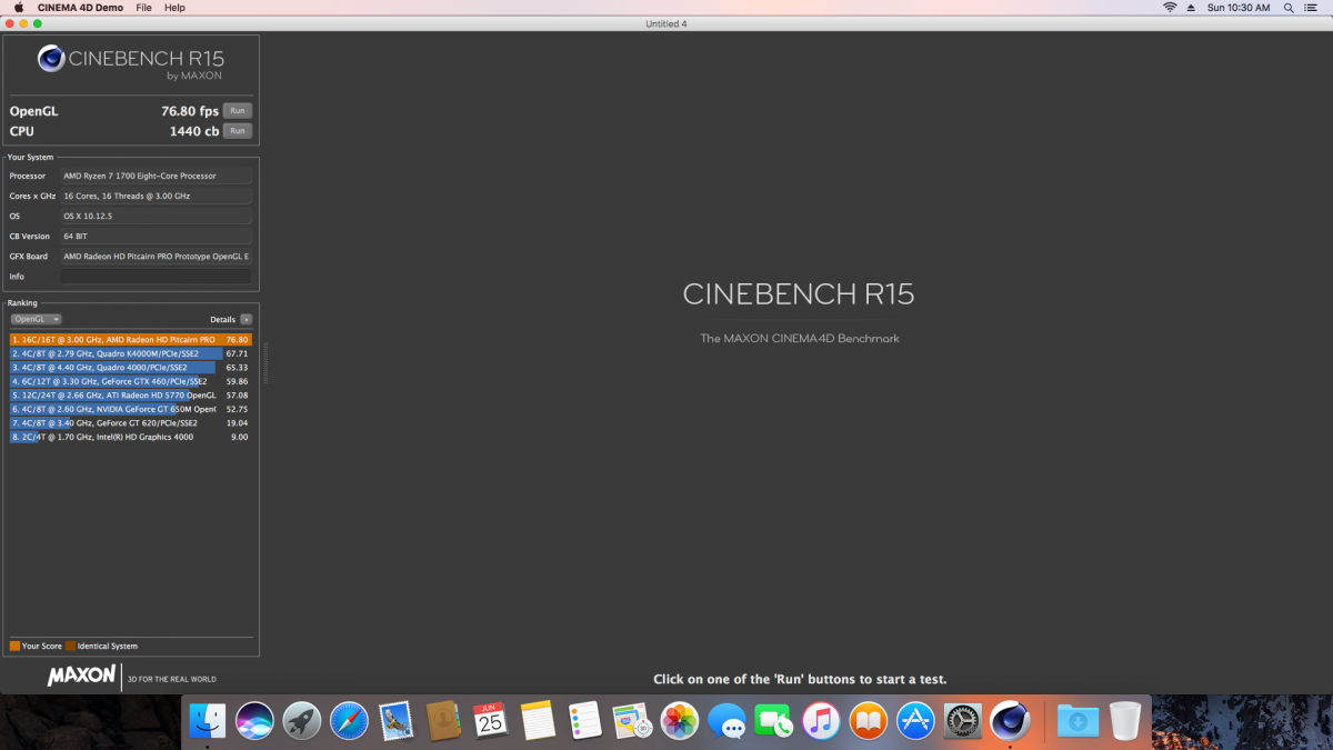

I put my R7 265 back in and ran some benches.
okay nice yeah it works that way but i'm getting better performance with the r9 270x in just going to have to wait for update on web drivers or a fix

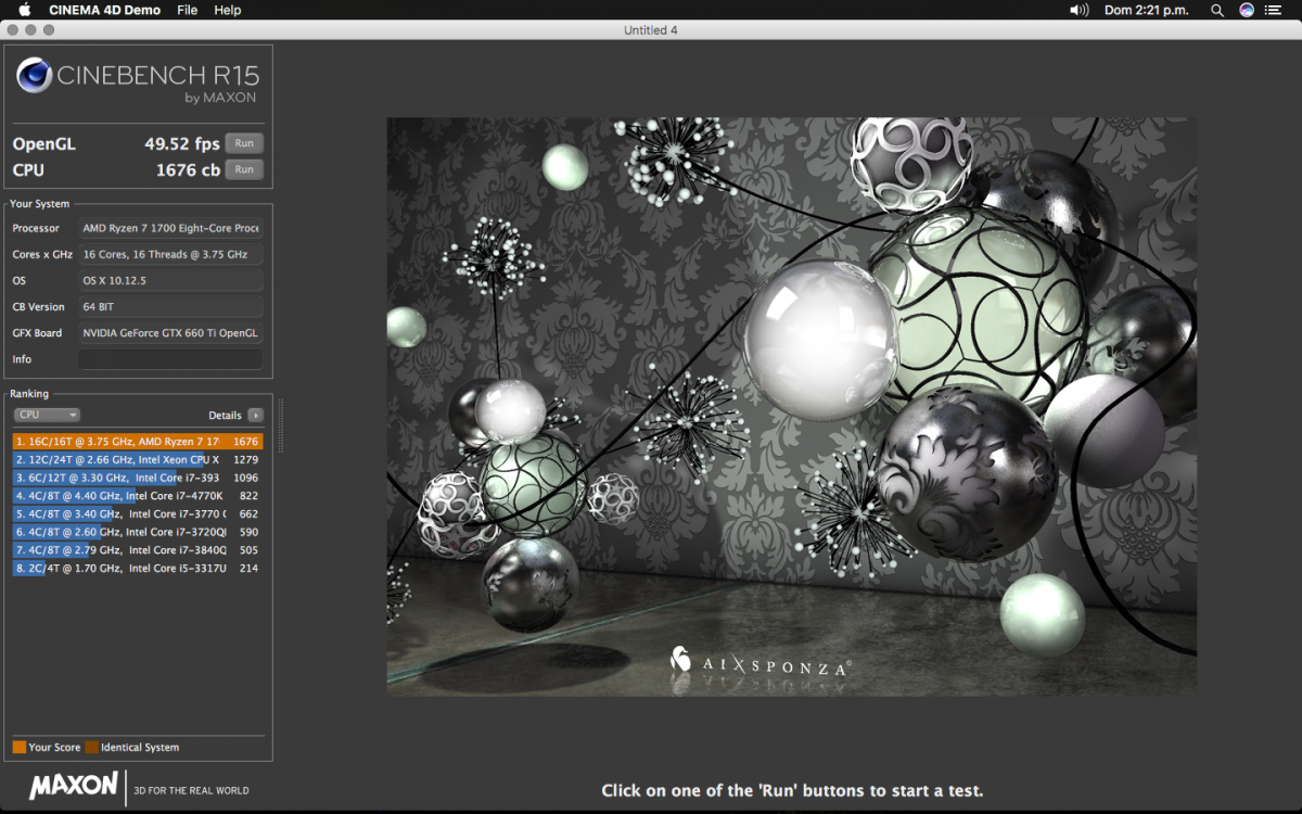

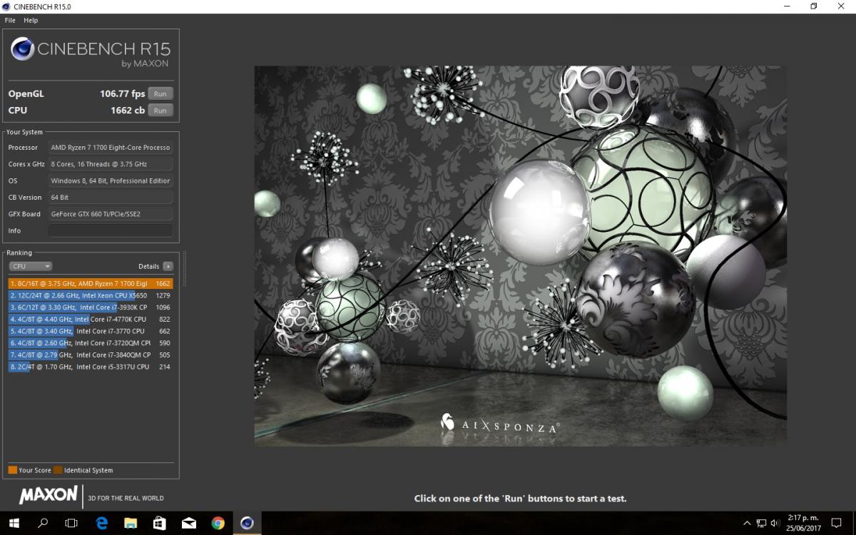

i made some tests whit my 660ti whit the included Nvidia drivers in Sierra and the difference between osx and windows its huge. I think that the problem its not the Nvidia web drivers, its something related to the mods of the kernel. if someone whit an older amd hackintosh can make some tests to compare can be awesome.

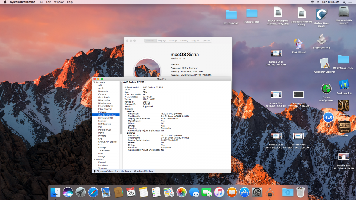

i did a fresh install lol how do i get my r9 270x to work it boots up but says only 1mb of video ram
had to hake i'd and inject ati worked out of box
Did you try not injecting ATI?    I let it roll and fix the name HD 7xxx to R7 265.     Try without injection or fake IDs, if it works and you get 30 bit color ARBG210101010 then just change the ID in Controllerkext.
