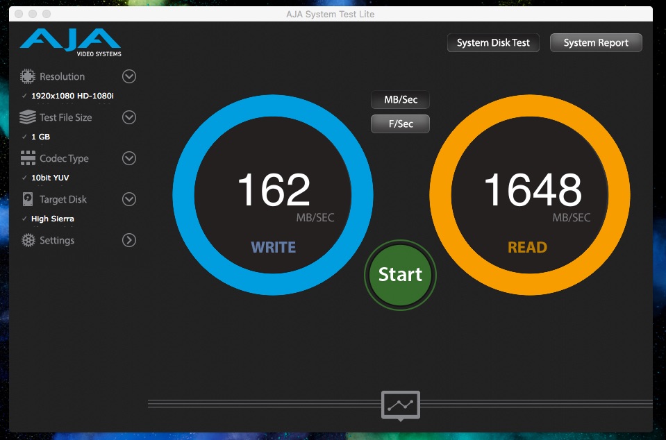

Hello High Sierra I have successfully established. My problem is that the corsair mp500 120gb NVME ssd diskin writing speed is going very low. What is the problem ?
Sistem
  • İ7 6700 3.4 Ghz Skylake
  • Gigabyte Z170M D3H
  • Nvidia GTX 1050 Ti 4 GB OC
  • Ram Ramaxel 2133 mhz 16 gigabyte
  • 250 Gb Samsung 850 Evo SSD
  • Corsair Force Mp500 120 Gb SSD M.2
  • WD 500 Gb 7200 Rpm HDD
  • Broadcom BCM43xx
