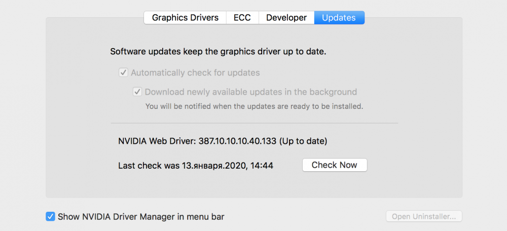

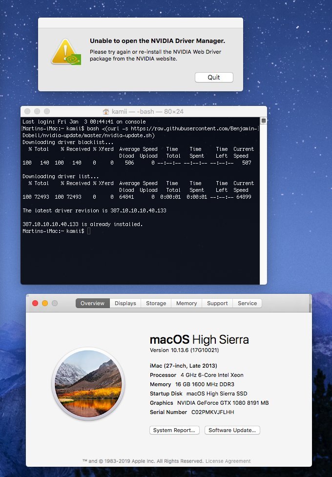

kamii Posted January 3, 2020 Share Posted January 3, 2020 anybody have a fix to the issue i am having and not having acceleration on this update? everything you need to know should be in the picture posted Link to comment https://www.insanelymac.com/forum/topic/324195-nvidia-web-driver-updates-for-macos-high-sierra-update-nov-13-2020/page/77/#findComment-2702591 Share on other sites More sharing options...

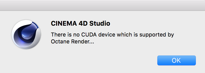

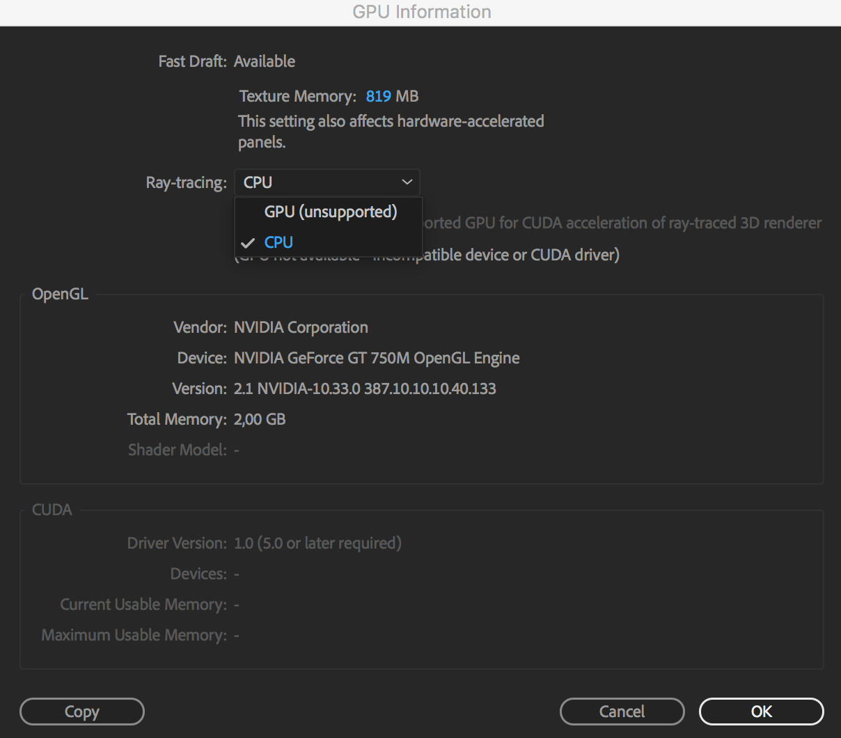

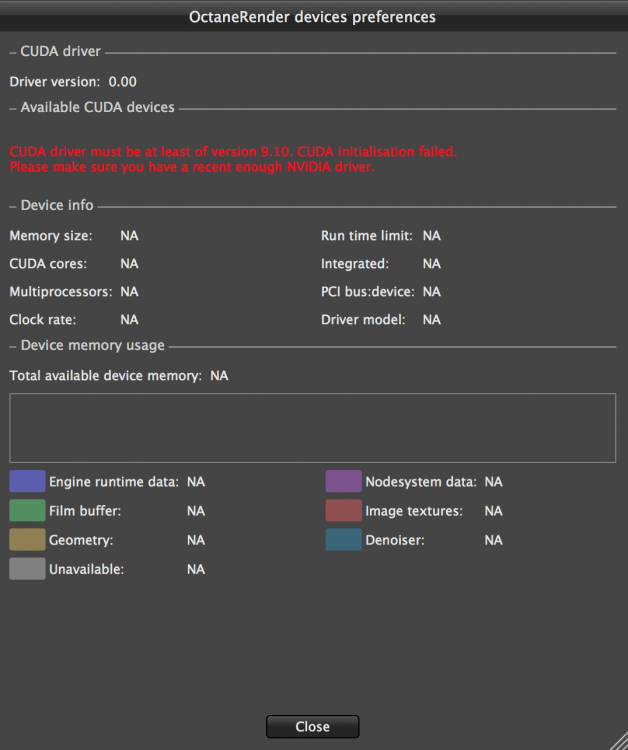

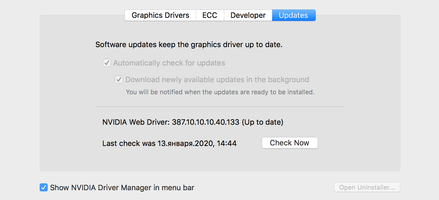

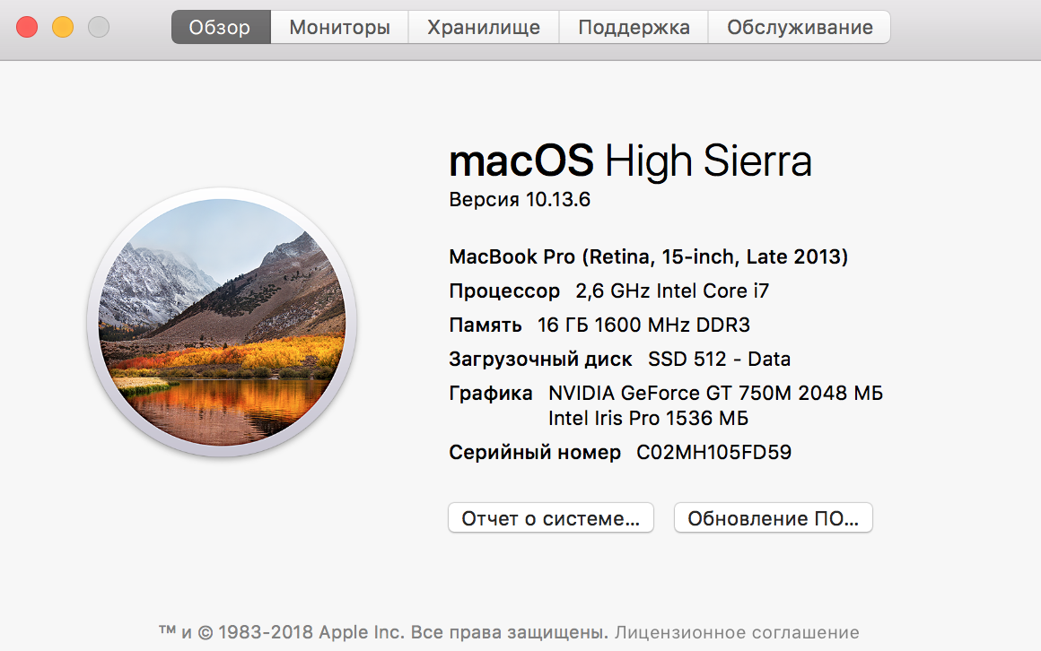

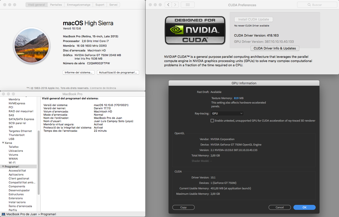

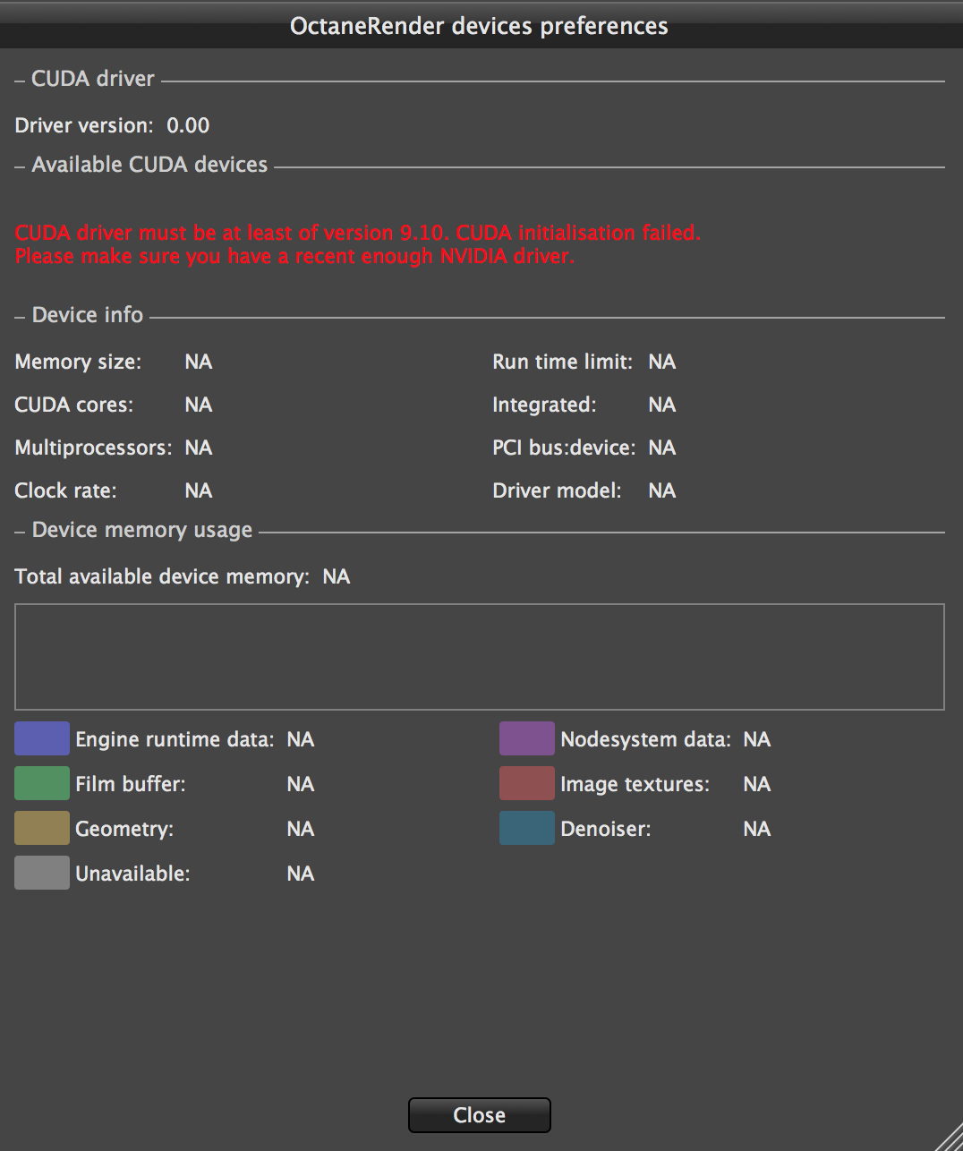

Ramchanga Posted January 13, 2020 Share Posted January 13, 2020 Hello. I have encountered a problem that after all the installations, my software does not see a CUDA-enabled device. What else does it take to make it work? Link to comment https://www.insanelymac.com/forum/topic/324195-nvidia-web-driver-updates-for-macos-high-sierra-update-nov-13-2020/page/77/#findComment-2703994 Share on other sites More sharing options...
TimeLord04 Posted January 14, 2020 Share Posted January 14, 2020 12 hours ago, Ramchanga said: Hello. I have encountered a problem that after all the installations, my software does not see a CUDA-enabled device. What else does it take to make it work? 1-13-2020 at 5:31 PM - PST This is the second person with a 750m with this issue... Are you sure that your High Sierra 10.13.6 is the LATEST Version - (17G10021)??? IF NOT, please Update your OS to the Latest Security Update and make sure you are on (17G10021). This is the First Step to take to make sure the NVIDIA Web AND CUDA Drivers are working for you on this Video Card. 387.10.10.10.40.133 IS MEANT ONLY for (17G10021). IF your System is NOT on (17G10021), this would explain why you are getting this Error. In addition, as mentioned before, the 750m is a Card that 'typically' gets the Driver assigned and attached by MacOS and the Third Party NVIDIA Web Driver is NOT necessarily needed for this Card. HOWEVER; since you have already Installed said Web Driver and proper CUDA Driver, it's best to check that you ARE on (17G10021) for these Drivers to work properly with the 750m. TimeLord04 1 Link to comment https://www.insanelymac.com/forum/topic/324195-nvidia-web-driver-updates-for-macos-high-sierra-update-nov-13-2020/page/77/#findComment-2704187 Share on other sites More sharing options...
fantomas Posted January 15, 2020 Author Share Posted January 15, 2020 On 12/31/2019 at 1:14 AM, antuanet said: ... On 1/1/2020 at 3:41 PM, kamii said: ... On 1/13/2020 at 2:22 PM, Ramchanga said: ... Guys, there'e no shortcut!!! - Especially if you are new on this. It is not something that woks just like that - Hackintosh is not an exact science!!! Which is meaning if something works for someone, it does not mean it will work for everyone. Before trying to make your own hackintosh, be aware about your config, it will be helpful later. The only secret to a successful hackintosh is to read a lot, and make a lot of mistakes. This is how you will become efficient and above all autonomous. Also be aware about forum rules - They are not there for show!!! I just removed @Chiitus post because of off-topic. Be sure you searched everywhere before asking for help. This topic is only about Nvidia Web Driver on High Sierra, if you have issue with Cuda, we also have a dedicated topic for this purposes. We also have an app called Nvidia Web Driver Updater - it will search and install the correct web driver version depending on your macOS version. Give it a try. BR fantomas 1 1 Link to comment https://www.insanelymac.com/forum/topic/324195-nvidia-web-driver-updates-for-macos-high-sierra-update-nov-13-2020/page/77/#findComment-2704382 Share on other sites More sharing options...

yoyo Posted January 22, 2020 Share Posted January 22, 2020 On 1/14/2020 at 2:31 AM, TimeLord04 said: 1-13-2020 at 5:31 PM - PST This is the second person with a 750m with this issue... Are you sure that your High Sierra 10.13.6 is the LATEST Version - (17G10021)??? IF NOT, please Update your OS to the Latest Security Update and make sure you are on (17G10021). This is the First Step to take to make sure the NVIDIA Web AND CUDA Drivers are working for you on this Video Card. 387.10.10.10.40.133 IS MEANT ONLY for (17G10021). IF your System is NOT on (17G10021), this would explain why you are getting this Error. In addition, as mentioned before, the 750m is a Card that 'typically' gets the Driver assigned and attached by MacOS and the Third Party NVIDIA Web Driver is NOT necessarily needed for this Card. HOWEVER; since you have already Installed said Web Driver and proper CUDA Driver, it's best to check that you ARE on (17G10021) for these Drivers to work properly with the 750m. TimeLord04 Web and CUDA drivers ARE necessary to get CUDA processing for this GPU on certain applications. That's why people with the 750M use these drivers. Link to comment https://www.insanelymac.com/forum/topic/324195-nvidia-web-driver-updates-for-macos-high-sierra-update-nov-13-2020/page/77/#findComment-2705259 Share on other sites More sharing options...
TimeLord04 Posted January 22, 2020 Share Posted January 22, 2020 (edited) 5 hours ago, yoyo said: Web and CUDA drivers ARE necessary to get CUDA processing for this GPU on certain applications. That's why people with the 750M use these drivers. Then people with this Card 'should ONLY' utilize the 'correct' Driver for the OS in question. That is, DON'T FORCE a Newer Driver onto an Older OS Version, NOR an Older Driver onto a Newer OS Version. ONLY utilize the CORRECT Driver for EACH OS Version. In this case, the ".133" Driver IS ONLY MEANT for OS Version - (17G10021.) (As stated by @Hervé, and myself.) The Community at large CANNOT be held responsible for those whom insist on using the OLD and FAULTY ...x.10.10.15.15.108 Driver in (17G10021), NOR anywhere else. ESPECIALLY, when it has been found that it corrupts Metal calls in games like WoW and causes Freezes and Crashes. This is why that particular Driver was pulled by NVIDIA. Likewise, to FORCE a newer Driver into an Older OS Version, the User MUST accept responsibility when the OS 'barfs up' and has issues. TimeLord04 Edited January 22, 2020 by TimeLord04 1.) Edit Punctuation... 2.) Clarification on point. Link to comment https://www.insanelymac.com/forum/topic/324195-nvidia-web-driver-updates-for-macos-high-sierra-update-nov-13-2020/page/77/#findComment-2705262 Share on other sites More sharing options...
yoyo Posted January 22, 2020 Share Posted January 22, 2020 Well, in my case I couldn't installed it because I didn't updated to the last 10.13.6 security update (the package just failed to installed). After updated IT works fine, as supposed. So maybe the problem for those people is not related to having installed the driver onto an older version. I guess the problem for them is related to CUDA driver and software version, or just not selecting the driver to use on preference panel... In my case I can confirm that ".133" driver works together with the CUDA ".481.163" driver on a Macbook Pro late 2013 with a Nvidia 750M, running Mac OS X 10.13.6 (17G10021). CUDA processing available on CC2018. Link to comment https://www.insanelymac.com/forum/topic/324195-nvidia-web-driver-updates-for-macos-high-sierra-update-nov-13-2020/page/77/#findComment-2705274 Share on other sites More sharing options...

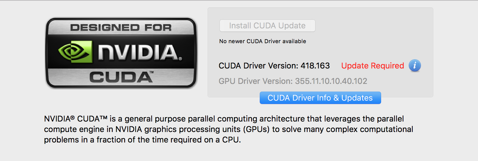

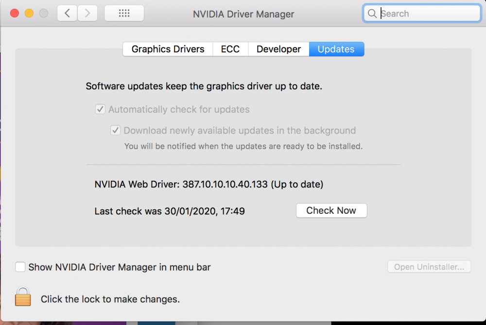

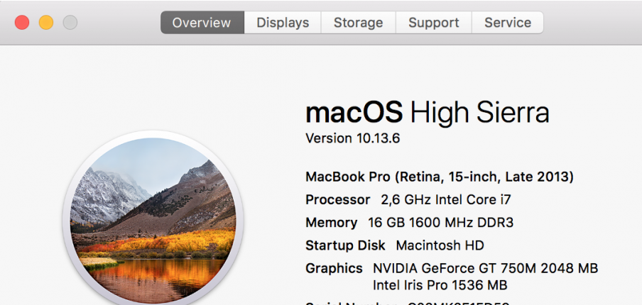

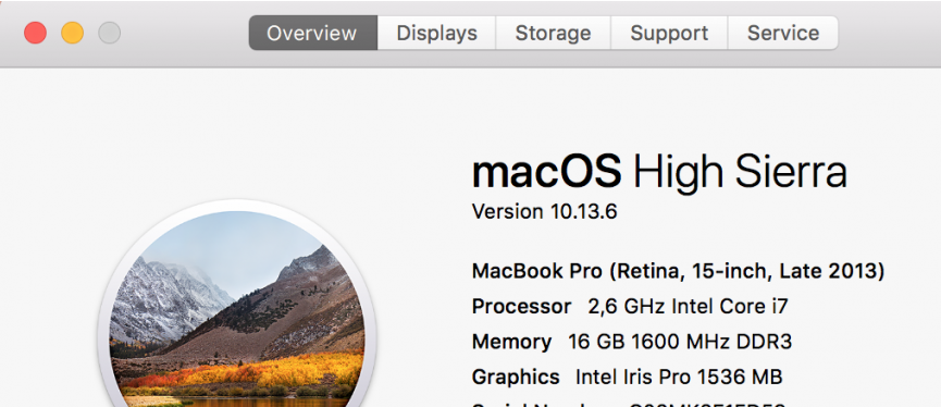

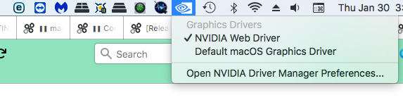

antuanet Posted January 30, 2020 Share Posted January 30, 2020 On 6/5/2017 at 2:21 PM, fantomas said: Nvidia Web Driver - 387.10.10.10.40.134 --> build 17G11023 (thanks to TimeLord04) New! Hello. I am following this drivers since a while now. For a few upgrades. all was working fine but since las 3 firmwares it all is not working. My actual Mac OS X is: 10.3.6 / C02MK2E1FD59 I am going to attach a photo about my computer and my NDIVI Card as Driver. Because it is not working and still saying I would upgrade my Operating System to 10.3.6 which is the one I have already. Of course After Effects CC 2018 Will not recognise my NVIDIA GeForce GT 750M. I went to Apple Upgrades and also download the leatest Security Update 2020-001-10.3.6 Please some help about it all. Thanks. Link to comment https://www.insanelymac.com/forum/topic/324195-nvidia-web-driver-updates-for-macos-high-sierra-update-nov-13-2020/page/77/#findComment-2706459 Share on other sites More sharing options...

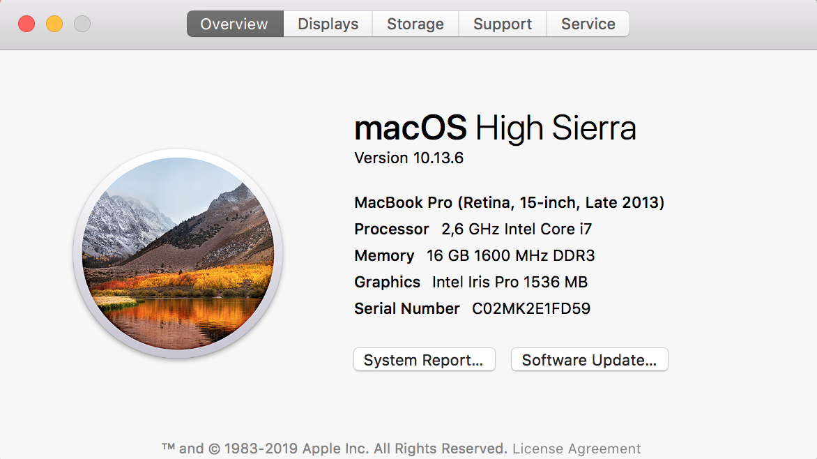

TimeLord04 Posted January 30, 2020 Share Posted January 30, 2020 (edited) 48 minutes ago, antuanet said: Hello. I am following this drivers since a while now. For a few upgrades. all was working fine but since las 3 firmwares it all is not working. My actual Mac OS X is: 10.3.6 / C02MK2E1FD59 I am going to attach a photo about my computer and my NDIVI Card as Driver. Because it is not working and still saying I would upgrade my Operating System to 10.3.6 which is the one I have already. Of course After Effects CC 2018 Will not recognise my NVIDIA GeForce GT 750M. I went to Apple Upgrades and also download the leatest Security Update 2020-001-10.3.6 Please some help about it all. Thanks. UPDATE MacOS BEFORE Updating the DAMNED DRIVER! You've been TOLD THIS BEFORE! Update MacOS to Security Update 2020-001 - (17G11023) - THEN FOLLOW the Directions IN NVIDIA Web Driver Updater! [EDIT:] TO CHECK YOUR OS ---> GO TO "About This Mac" ---> On "Version 10.13.6" Text, Left Click with your Mouse ONCE and it will EXPAND to show you YOUR CURRENT VERSION NUMBER. The WARNING MSG CLEARLY STATES YOU ARE NOT ON (17G11023)! [EDIT2:] I ALSO HIGHLY recommend that you Check The Box and have the NVIDIA Web Driver Manager placed onto the Apple Menu Bar. This helps to easily identify if the Web Driver is Running or NOT. (See new Menu Bar Pic that I've Uploaded.) TimeLord04 Edited January 30, 2020 by TimeLord04 Uploaded Pictures - .png File. Link to comment https://www.insanelymac.com/forum/topic/324195-nvidia-web-driver-updates-for-macos-high-sierra-update-nov-13-2020/page/77/#findComment-2706460 Share on other sites More sharing options...
TimeLord04 Posted January 30, 2020 Share Posted January 30, 2020 @antuanet, STEP BY STEP: 1.) When a New OS Release comes out - WAIT for New Web Driver to Release [1-A.) Sometimes it helps to DL the New Driver, that's why MOST of us Post Links to the New Driver Release. (NOTE: I've had my Mac Pro 5,1 - Daedalus' NVIDIA Web Driver Manager FREEZE and state it CANNOT connect to the Web to DL New Driver.) In an emergency, one can then use the Downloaded Driver to Install from.] 2.) Update MacOS to New Security Update 3.) On Login AFTER Successful OS Update, NVIDIA Web Driver Manager WILL PROMPT you to Update the NVIDIA Web Driver. 4.) Upon successful Install of New Web Driver, you will be Prompted to Reboot one final time. NOTE: DO NOT FORCE Install a New Driver onto an OLDER MacOS! IT DOESN'T WORK! (SEE YOUR Warning Msg.) NOTE 2: DO NOT FORCE Older Drivers onto a Newer MacOS. (Been done by many. Especially using the faulty 387.10.10.15.15.108 Driver. HIGHLY NOT RECOMMENDED!) TimeLord04 Link to comment https://www.insanelymac.com/forum/topic/324195-nvidia-web-driver-updates-for-macos-high-sierra-update-nov-13-2020/page/77/#findComment-2706465 Share on other sites More sharing options...
TimeLord04 Posted January 31, 2020 Share Posted January 31, 2020 1-30-2020 at 5:09 PM - PST Mac Pro 5,1 - Daedalus Updated to (17G11023) and NVIDIA Web Driver 387.10.10.10.40.134. NO issues to report. TimeLord04 Link to comment https://www.insanelymac.com/forum/topic/324195-nvidia-web-driver-updates-for-macos-high-sierra-update-nov-13-2020/page/77/#findComment-2706471 Share on other sites More sharing options...

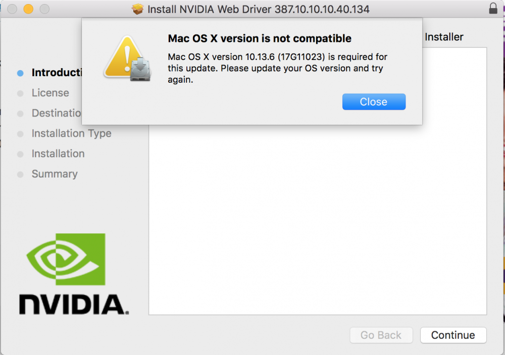

antuanet Posted January 31, 2020 Share Posted January 31, 2020 4 hours ago, TimeLord04 said: @antuanet, STEP BY STEP: 1.) When a New OS Release comes out - WAIT for New Web Driver to Release [1-A.) Sometimes it helps to DL the New Driver, that's why MOST of us Post Links to the New Driver Release. (NOTE: I've had my Mac Pro 5,1 - Daedalus' NVIDIA Web Driver Manager FREEZE and state it CANNOT connect to the Web to DL New Driver.) In an emergency, one can then use the Downloaded Driver to Install from.] 2.) Update MacOS to New Security Update 3.) On Login AFTER Successful OS Update, NVIDIA Web Driver Manager WILL PROMPT you to Update the NVIDIA Web Driver. 4.) Upon successful Install of New Web Driver, you will be Prompted to Reboot one final time. NOTE: DO NOT FORCE Install a New Driver onto an OLDER MacOS! IT DOESN'T WORK! (SEE YOUR Warning Msg.) NOTE 2: DO NOT FORCE Older Drivers onto a Newer MacOS. (Been done by many. Especially using the faulty 387.10.10.15.15.108 Driver. HIGHLY NOT RECOMMENDED!) TimeLord04 Hello. Thanks for your answer but I done all of that and still not working. As you can see already on the attached photos I sent you on the previews message. So what we do now ?. Link to comment https://www.insanelymac.com/forum/topic/324195-nvidia-web-driver-updates-for-macos-high-sierra-update-nov-13-2020/page/77/#findComment-2706477 Share on other sites More sharing options...
antuanet Posted January 31, 2020 Share Posted January 31, 2020 6 hours ago, TimeLord04 said: UPDATE MacOS BEFORE Updating the DAMNED DRIVER! You've been TOLD THIS BEFORE! Update MacOS to Security Update 2020-001 - (17G11023) - THEN FOLLOW the Directions IN NVIDIA Web Driver Updater! [EDIT:] TO CHECK YOUR OS ---> GO TO "About This Mac" ---> On "Version 10.13.6" Text, Left Click with your Mouse ONCE and it will EXPAND to show you YOUR CURRENT VERSION NUMBER. The WARNING MSG CLEARLY STATES YOU ARE NOT ON (17G11023)! [EDIT2:] I ALSO HIGHLY recommend that you Check The Box and have the NVIDIA Web Driver Manager placed onto the Apple Menu Bar. This helps to easily identify if the Web Driver is Running or NOT. (See new Menu Bar Pic that I've Uploaded.) TimeLord04 Thanks. I did upgrade and down load the latest Security Drive for my system and I could install the latest NVIDIA driver ...134 but after installed and re-start my computer I go to AE CC2018 and my GPU still not supported.. Really do not know what can be. Thanks. Link to comment https://www.insanelymac.com/forum/topic/324195-nvidia-web-driver-updates-for-macos-high-sierra-update-nov-13-2020/page/77/#findComment-2706478 Share on other sites More sharing options...

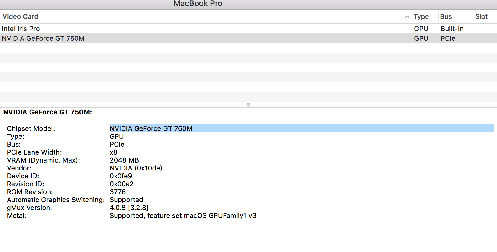

TimeLord04 Posted January 31, 2020 Share Posted January 31, 2020 @antuanet, Looking back a couple of Posts to see if I missed something, and I find that your GT-750m IS NOT even being listed as a coprocessor! It looks to have been 'Disabled', ONLY your Integrated Iris Pro GPU is showing. Something has happened to your GT-750m. TimeLord04 Link to comment https://www.insanelymac.com/forum/topic/324195-nvidia-web-driver-updates-for-macos-high-sierra-update-nov-13-2020/page/77/#findComment-2706518 Share on other sites More sharing options...
TimeLord04 Posted January 31, 2020 Share Posted January 31, 2020 (edited) @antuanet, This was BEFORE you Installed the Web Drivers: [EDIT:] I think @Hervé is right in that NOT ONLY do you NOT need the Web Drivers for your GT-750m, BUT IN FACT they are causing GREAT HARM to what you want to accomplish with your System. Installing the CUDA Driver, (418.163), is one thing, BUT the Web Drivers are truly designed for Maxwell and Pascal Cards ONLY. Your Card is no later than Kepler and is NORMALLY controlled by Driver 355.11.10.10.40.102 BUILT IN to MacOS. IF it were my System, at this point I'd HIGHLY consider Uninstalling the Web Drivers. TimeLord04 Edited January 31, 2020 by TimeLord04 Link to comment https://www.insanelymac.com/forum/topic/324195-nvidia-web-driver-updates-for-macos-high-sierra-update-nov-13-2020/page/77/#findComment-2706558 Share on other sites More sharing options...

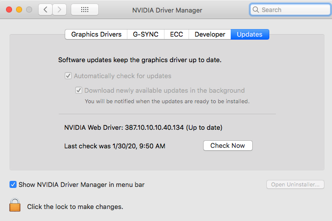

RaymondK Posted February 2, 2020 Share Posted February 2, 2020 I am on High Sierra 10.13.6 (17G10021) , I haven't done the latest update cause using the Check Now button on nVidia Driver Manager, it tells me there is no update available as my web driver 133 is the newest. I saw that 134 is the newest, just wonder if it is safe to update the security patch 2020-001 or not ? My graphic card is GTX-1080. Link to comment https://www.insanelymac.com/forum/topic/324195-nvidia-web-driver-updates-for-macos-high-sierra-update-nov-13-2020/page/77/#findComment-2706778 Share on other sites More sharing options...
TimeLord04 Posted February 2, 2020 Share Posted February 2, 2020 (edited) 55 minutes ago, RaymondK said: I am on High Sierra 10.13.6 (17G10021) , I haven't done the latest update cause using the Check Now button on nVidia Driver Manager, it tells me there is no update available as my web driver 133 is the newest. I saw that 134 is the newest, just wonder if it is safe to update the security patch 2020-001 or not ? My graphic card is GTX-1080. YES! It is NOW quite safe, (with the Release of the ".134" Driver), to Update to 2020-001 Security Update - (17G11023). You may wish to DL the Driver and have a direct copy for emergency use. However; as always, after Updating the OS, the NVIDIA Driver Manager WILL Prompt you to Update to ".134". [EDIT:] I ALSO suggest that you GO BACK several Posts to my "Step By Step" Instructions! I laid everything out for @antuanet, specifically, BUT these "Step By Step" Instructions go for EVERYONE! You should also create your Signature and put in your System Specs for more specific assistance. TimeLord04 Edited February 2, 2020 by TimeLord04 Details. Link to comment https://www.insanelymac.com/forum/topic/324195-nvidia-web-driver-updates-for-macos-high-sierra-update-nov-13-2020/page/77/#findComment-2706783 Share on other sites More sharing options...
