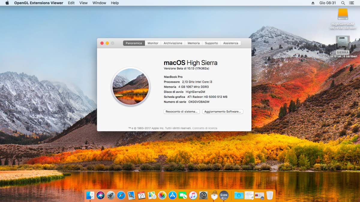

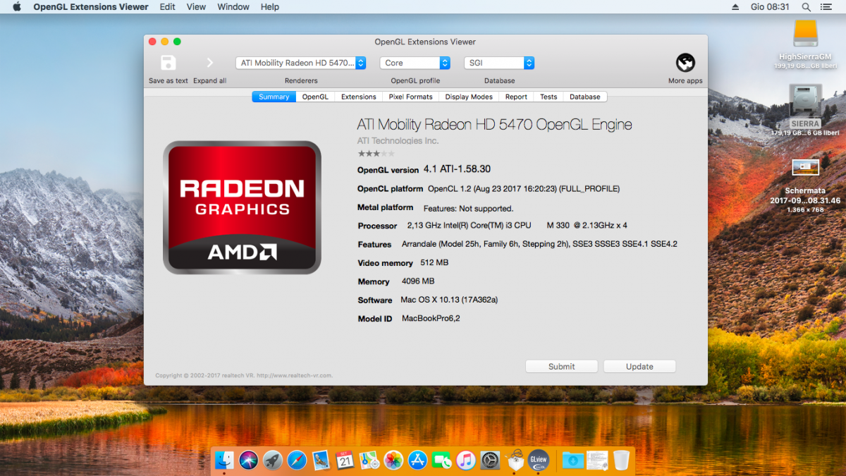

Ludox Posted September 21, 2017 Share Posted September 21, 2017 ACER ASPIRE 5741G -ATI HD 5470 FULL 6 Link to comment https://www.insanelymac.com/forum/topic/324194-pre-release-macos-high-sierra/page/149/#findComment-2498836 Share on other sites More sharing options...

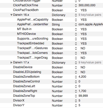

Killuminati91 Posted September 22, 2017 Share Posted September 22, 2017 Hi, After apfs gm install I have full tracked options in system preferences to configure with rehab man's vodoops2controller.kext. But after a couple of boots the trackpad pref pane show no tracked found though I have full functionality as I had configured earlier. What's the problem? I removed nvram plist, repaired permissions, reinstalled rehab mans vodoops2controller.kext but still empty, pref pane. Any suggestions Thanks. - Rightclick -> show content on VoodooPS2Controller.kext - Go to Contents -> Plugins -> VoodooPS2Trackpad.kext - Rightclick -> Show content - Edit Info.plist, replace: <key>Darwin 16.x</key> with <key>Darwin 17.x</key> 1 Link to comment https://www.insanelymac.com/forum/topic/324194-pre-release-macos-high-sierra/page/149/#findComment-2499244 Share on other sites More sharing options...
macq Posted September 22, 2017 Share Posted September 22, 2017 - Rightclick -> show content on VoodooPS2Controller.kext - Go to Contents -> Plugins -> VoodooPS2Trackpad.kext - Rightclick -> Show content - Edit Info.plist, replace: <key>Darwin 16.x</key> with <key>Darwin 17.x</key> Hi I have both Darwin 16.x and 17.x both already in the info.plist. Link to comment https://www.insanelymac.com/forum/topic/324194-pre-release-macos-high-sierra/page/149/#findComment-2499263 Share on other sites More sharing options...
Badruzeus Posted September 22, 2017 Share Posted September 22, 2017 Hi I have both Darwin 16.x and 17.x both already in the info.plist. Do we still need this method? AFAIK since VoodooPS2 v1.8.27 (latest is 1.8.28) @Rehabman has given support for 10.13 (Beta) Link to comment https://www.insanelymac.com/forum/topic/324194-pre-release-macos-high-sierra/page/149/#findComment-2499277 Share on other sites More sharing options...
macq Posted September 22, 2017 Share Posted September 22, 2017 Do we still need this method? AFAIK since VoodooPS2 v1.8.27 (latest is 1.8.28) @Rehabman has given support for 10.13 (Beta) Its by default in 1.8.28 in rehabmans version. 1 Link to comment https://www.insanelymac.com/forum/topic/324194-pre-release-macos-high-sierra/page/149/#findComment-2499281 Share on other sites More sharing options...
Badruzeus Posted September 22, 2017 Share Posted September 22, 2017 Its by default in 1.8.28 in rehabmans version. Hmmmb, OK.. let's see (maybe) after 10.13 non-Beta Public Release.. Link to comment https://www.insanelymac.com/forum/topic/324194-pre-release-macos-high-sierra/page/149/#findComment-2499290 Share on other sites More sharing options...

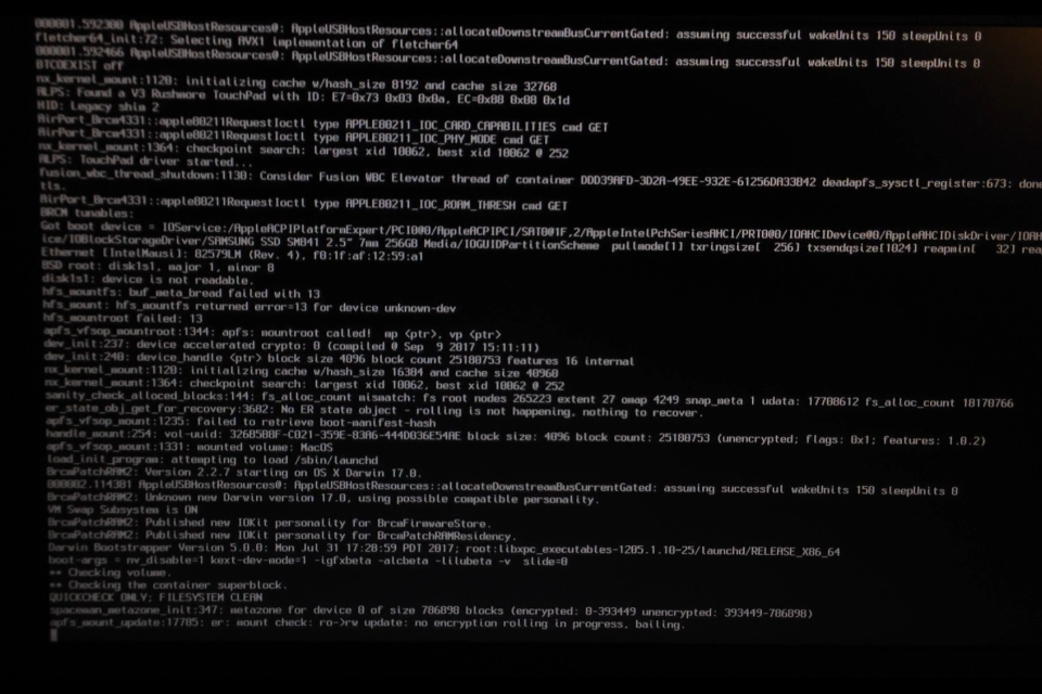

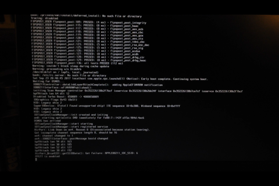

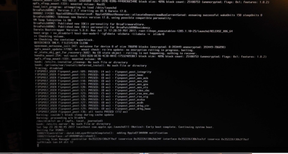

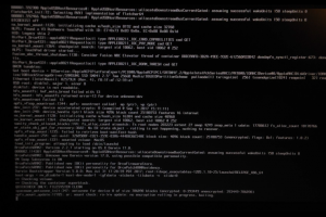

Trung_Nguyen Posted September 23, 2017 Share Posted September 23, 2017 My High Sierra GM boot slower compared to Sierra. It stop at this verbose boot screen for about 15s. Will erase this disk make it go faster through this line? Any solution? Thanks After 15s And then Link to comment https://www.insanelymac.com/forum/topic/324194-pre-release-macos-high-sierra/page/149/#findComment-2499665 Share on other sites More sharing options...
vandroiy2012 Posted September 23, 2017 Share Posted September 23, 2017 My High Sierra GM boot slower compared to Sierra. It stop at this verbose boot screen for about 15s. Will erase this disk make it go faster through this line? Any solution? Thanks Disable TRIM. It doesn't work well on apfs formatted SSD's with SandForce controllers and maybe several other old controllers... 2 Link to comment https://www.insanelymac.com/forum/topic/324194-pre-release-macos-high-sierra/page/149/#findComment-2499671 Share on other sites More sharing options...
chris1111 Posted September 23, 2017 Share Posted September 23, 2017 Crucial_CT275MX300SSD1 : Capacité : 275,06 Go (275 064 201 216 octets) Modèle : Crucial_CT275MX300SSD1 Révision : M0CR040 Works well here APFS and trim Activated Boot fast no probleme 1 Link to comment https://www.insanelymac.com/forum/topic/324194-pre-release-macos-high-sierra/page/149/#findComment-2499680 Share on other sites More sharing options...
vandroiy2012 Posted September 23, 2017 Share Posted September 23, 2017 Crucial_CT275MX300SSD1 : Capacité : 275,06 Go (275 064 201 216 octets) Modèle : Crucial_CT275MX300SSD1 Révision : M0CR040 Works well here APFS and trim Activated Boot fast no probleme Sure. Crucial MX300 uses modern Marvell 88SS1074 controller... Link to comment https://www.insanelymac.com/forum/topic/324194-pre-release-macos-high-sierra/page/149/#findComment-2499689 Share on other sites More sharing options...
Trung_Nguyen Posted September 23, 2017 Share Posted September 23, 2017 Well, I'm on SSD, Disable TRIM works great, much faster. Crucial_CT275MX300SSD1 : Capacité : 275,06 Go (275 064 201 216 octets) Modèle : Crucial_CT275MX300SSD1 Révision : M0CR040 Works well here APFS and trim Activated Boot fast no probleme Please verify the TRIM patch P/s: Is there a way to enable VGA output with Intel GFX HD4000? It will be great if that can be patch through Clover Link to comment https://www.insanelymac.com/forum/topic/324194-pre-release-macos-high-sierra/page/149/#findComment-2499691 Share on other sites More sharing options...

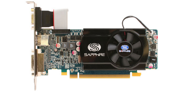

chris1111 Posted September 23, 2017 Share Posted September 23, 2017 For those who are interested I just bought a great little Graphics Card Saphire Radeon 5570 This card is native any version of OS X from 10.6 to 10.13 Working only Inject ATI with Clover; thats it! 6 Link to comment https://www.insanelymac.com/forum/topic/324194-pre-release-macos-high-sierra/page/149/#findComment-2499799 Share on other sites More sharing options...

xtddd Posted September 24, 2017 Share Posted September 24, 2017 For those who are interested I just bought a great little Graphics Card Saphire Radeon 5570 This card is native any version of OS X from 10.6 to 10.13 Working only Inject ATI with Clover; thats it! great. Link to comment https://www.insanelymac.com/forum/topic/324194-pre-release-macos-high-sierra/page/149/#findComment-2499830 Share on other sites More sharing options...

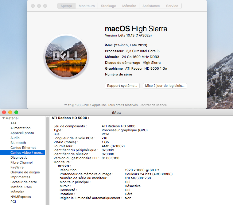

chris1111 Posted September 24, 2017 Share Posted September 24, 2017 great. I remove the <key>FBName</key> <string>Cedar</string> and now its show the exacte name ATI Radeon HD 5570 EDIT*** but to have my two screens on my two GPU I have to add the FB and sacrificing the name Link to comment https://www.insanelymac.com/forum/topic/324194-pre-release-macos-high-sierra/page/149/#findComment-2499835 Share on other sites More sharing options...
