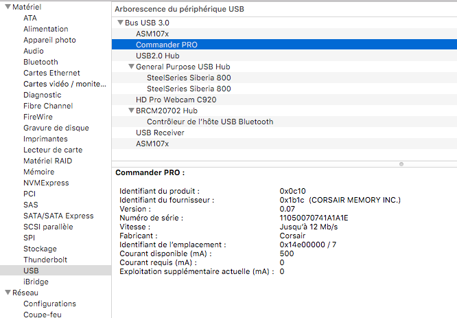

edenpulse Posted March 23, 2018 Share Posted March 23, 2018 7 minutes ago, MaLd0n said: run in terminal and paste result here log show --style syslog | fgrep "Wake reason" 2018-03-23 19:19:39.352033+0100 localhost kernel[0]: (AppleTopCaseHIDEventDriver) [HID] [ATC] AppleDeviceManagementHIDEventService::processWakeReason Wake reason: Host (0x01) 2018-03-23 19:29:19.621043+0100 localhost kernel[0]: (AppleACPIPlatform) Wake reason: XHC 2018-03-23 19:29:19.621044+0100 localhost kernel[0]: (AppleACPIPlatform) Wake reason: XHC 2018-03-23 19:29:30.879832+0100 localhost kernel[0]: (AppleTopCaseHIDEventDriver) [HID] [ATC] AppleDeviceManagementHIDEventService::processWakeReason Wake reason: Host (0x01) 2018-03-23 19:45:50.732434+0100 localhost kernel[0]: (AppleTopCaseHIDEventDriver) [HID] [ATC] AppleDeviceManagementHIDEventService::processWakeReason Wake reason: Host (0x01) 2018-03-23 19:52:41.750877+0100 localhost kernel[0]: (AppleACPIPlatform) Wake reason: XHC 2018-03-23 19:52:41.750878+0100 localhost kernel[0]: (AppleACPIPlatform) Wake reason: XHC 2018-03-23 19:52:52.924029+0100 localhost kernel[0]: (AppleTopCaseHIDEventDriver) [HID] [ATC] AppleDeviceManagementHIDEventService::processWakeReason Wake reason: Host (0x01) 2018-03-23 19:57:01.263496+0100 localhost kernel[0]: (AppleACPIPlatform) Wake reason: XHC 2018-03-23 19:57:01.263497+0100 localhost kernel[0]: (AppleACPIPlatform) Wake reason: XHC 2018-03-23 19:57:12.274629+0100 localhost kernel[0]: (AppleTopCaseHIDEventDriver) [HID] [ATC] AppleDeviceManagementHIDEventService::processWakeReason Wake reason: Host (0x01) Here it is. Link to comment Share on other sites More sharing options...
MaLd0n Posted March 23, 2018 Author Share Posted March 23, 2018 4 minutes ago, edenpulse said: 2018-03-23 19:19:39.352033+0100 localhost kernel[0]: (AppleTopCaseHIDEventDriver) [HID] [ATC] AppleDeviceManagementHIDEventService::processWakeReason Wake reason: Host (0x01) 2018-03-23 19:29:19.621043+0100 localhost kernel[0]: (AppleACPIPlatform) Wake reason: XHC 2018-03-23 19:29:19.621044+0100 localhost kernel[0]: (AppleACPIPlatform) Wake reason: XHC 2018-03-23 19:29:30.879832+0100 localhost kernel[0]: (AppleTopCaseHIDEventDriver) [HID] [ATC] AppleDeviceManagementHIDEventService::processWakeReason Wake reason: Host (0x01) 2018-03-23 19:45:50.732434+0100 localhost kernel[0]: (AppleTopCaseHIDEventDriver) [HID] [ATC] AppleDeviceManagementHIDEventService::processWakeReason Wake reason: Host (0x01) 2018-03-23 19:52:41.750877+0100 localhost kernel[0]: (AppleACPIPlatform) Wake reason: XHC 2018-03-23 19:52:41.750878+0100 localhost kernel[0]: (AppleACPIPlatform) Wake reason: XHC 2018-03-23 19:52:52.924029+0100 localhost kernel[0]: (AppleTopCaseHIDEventDriver) [HID] [ATC] AppleDeviceManagementHIDEventService::processWakeReason Wake reason: Host (0x01) 2018-03-23 19:57:01.263496+0100 localhost kernel[0]: (AppleACPIPlatform) Wake reason: XHC 2018-03-23 19:57:01.263497+0100 localhost kernel[0]: (AppleACPIPlatform) Wake reason: XHC 2018-03-23 19:57:12.274629+0100 localhost kernel[0]: (AppleTopCaseHIDEventDriver) [HID] [ATC] AppleDeviceManagementHIDEventService::processWakeReason Wake reason: Host (0x01) Here it is. have a water cooler with usb cable? Link to comment Share on other sites More sharing options...
edenpulse Posted March 23, 2018 Share Posted March 23, 2018 Nope. But I have a fan controller which uses internal usb2 motherboard header. Link to comment Share on other sites More sharing options...
MaLd0n Posted March 23, 2018 Author Share Posted March 23, 2018 2 minutes ago, edenpulse said: Nope. But I have a fan controller which uses internal usb2 motherboard header. take a test without it and use last dsdt, wake with power button Link to comment Share on other sites More sharing options...

edenpulse Posted March 24, 2018 Share Posted March 24, 2018 18 hours ago, MaLd0n said: take a test without it and use last dsdt, wake with power button Yup that works. The "Commander Pro" prevents sleep. Is there a way to do something about it? Link to comment Share on other sites More sharing options...

edenpulse Posted March 24, 2018 Share Posted March 24, 2018 49 minutes ago, MaLd0n said: check ioreg and edit UsbInjectAll, i think if u change to 255 work Hmmmm whut? How can I do that? Could you guide me? Or provide me some link that explains that... thank you Link to comment Share on other sites More sharing options...
edenpulse Posted March 24, 2018 Share Posted March 24, 2018 (edited) Ok, I made something that is working ! @MaLd0n Tell me if it's ok. (seems like it by my testing) - Opened IOreg, searched for USB port attached to my commander. (HS14) - Opened UsbInjectAll.kext > Info.plist - Searched for HS14 and changed the "3" value to "255". Sleep seems to work now. Isn't there an more elegant solution to this? I feel like changing kext values is kind of {censored} no? Edited March 24, 2018 by edenpulse 1 Link to comment Share on other sites More sharing options...
MaLd0n Posted March 24, 2018 Author Share Posted March 24, 2018 48 minutes ago, edenpulse said: Ok, I made something that is working ! @MaLd0n Tell me if it's ok. (seems like it by my testing) - Opened IOreg, searched for USB port attached to my commander. (HS14) - Opened UsbInjectAll.kext > Info.plist - Searched for HS14 and changed the "3" value to "255". Sleep seems to work now. Isn't there an more elegant solution to this? I feel like changing kext values is kind of {censored} no? this kext is for it, for edit for a good usb solution 1 Link to comment Share on other sites More sharing options...
