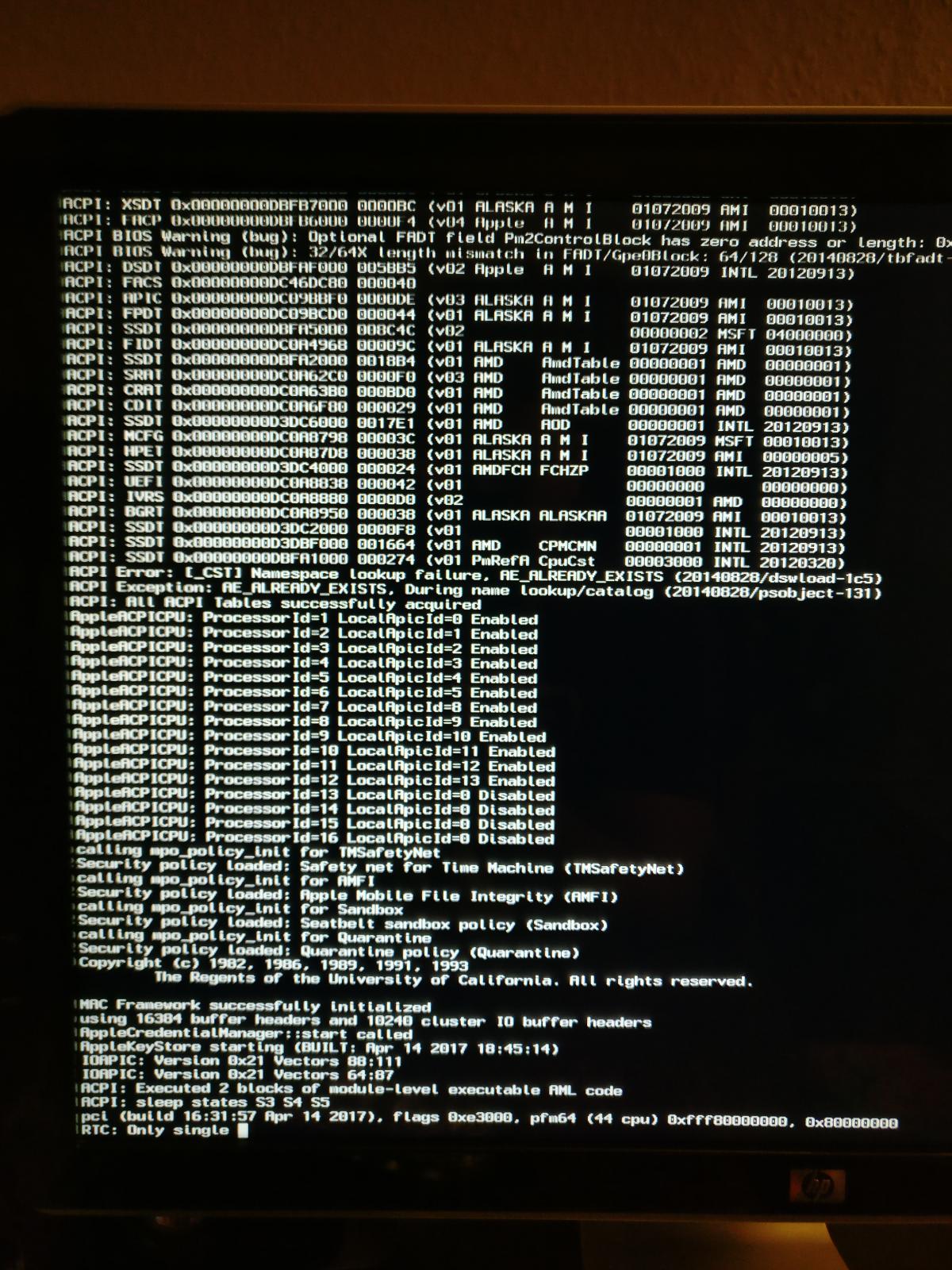

Jono4191 Posted June 7, 2017 Share Posted June 7, 2017 I just tried it with -v here the preboot log Edit: I just deactivated FixUSB in Clover Configurator. Error message on attached screenshot preboot.log.zip Link to comment https://www.insanelymac.com/forum/topic/322268-help-topic-ryzen-macos-1012x-sierra/page/13/#findComment-2438043 Share on other sites More sharing options...
Shaneee Posted June 7, 2017 Share Posted June 7, 2017 I just tried it with -v here the preboot log Edit: I just deactivated FixUSB in Clover Configurator. Error message on attached screenshot Are you using the RTC Patch in Clover? Link to comment https://www.insanelymac.com/forum/topic/322268-help-topic-ryzen-macos-1012x-sierra/page/13/#findComment-2438060 Share on other sites More sharing options...

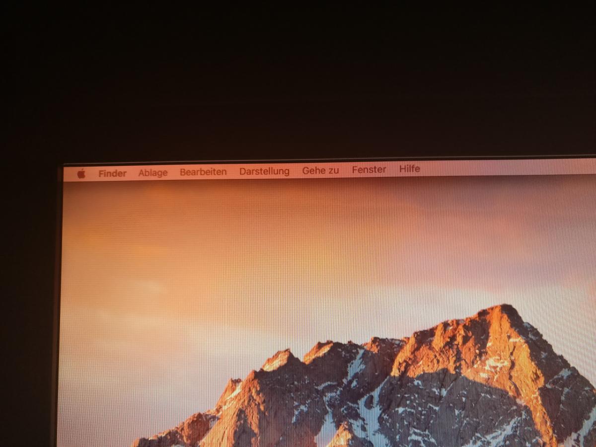

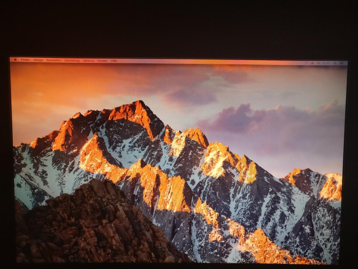

gills83 Posted June 7, 2017 Share Posted June 7, 2017 I just tried it with -v here the preboot log Edit: I just deactivated FixUSB in Clover Configurator. Error message on attached screenshot Edit2: npci=0x3000 busratio=32 -v and selecting InjectEDID and InjectATI (Futomaki) lets me boot into Sierra but I can see the Sierra Wallpaper for only a second, then my display turns into standby mode and after about a minute my pc goes into standby. Any ideas? yeah !! we are going forward 0:100 0:100 MemLog inited, TSC freq: 3194492160 0:100 0:000 CPU was calibrated without ACPI PM Timer: Intel ICH device was not found., use RTC 0:100 0:000 0:100 0:000 Now is 7.6.2017, 19:19:12 (GMT) 0:100 0:000 Starting Clover revision: 4078 on American Megatrends EFI 0:100 0:000 Build with: [Args: cleanlib | -D USE_LOW_EBDA -a X64 -b RELEASE -t XCODE5 -n 3 cleanlib | OS: 10.9.5 | XCODE: 6.2] 0:100 0:000 SelfDevicePath=PciRoot(0x0)\Pci(0x1,0x3)\Pci(0x0,0x1)\Sata(0x5,0xFFFF,0x0)\HD(1,GPT,DFC9111F-94A3-4EF1-BB8A-A114C25F903B,0x28,0x64000) @D87AD218 0:100 0:000 SelfDirPath = \EFI\BOOT 0:102 0:002 === [ Get Smbios ] ======================================== 0:102 0:000 Type 16 Index = 0 0:102 0:000 Total Memory Slots Count = 4 0:102 0:000 Type 17 Index = 0 0:102 0:000 Table has error information, checking 0:102 0:000 Found memory information in table 18/1, type=0x3, operation=0x2 syndrome=0x0 0:102 0:000 ...memory OK 0:102 0:000 SmbiosTable.Type17->Speed = 2133MHz 0:102 0:000 SmbiosTable.Type17->Size = 16384MB 0:102 0:000 SmbiosTable.Type17->Bank/Device = CHANNEL A DIMM 0 0:102 0:000 SmbiosTable.Type17->Vendor = Unknown 0:102 0:000 SmbiosTable.Type17->SerialNumber = A7105D96 0:102 0:000 SmbiosTable.Type17->PartNumber = CT16G4DFD8213.C16FAD 0:102 0:000 Type 17 Index = 1 0:102 0:000 Table has error information, checking 0:102 0:000 Found memory information in table 18/2, type=0x3, operation=0x2 syndrome=0x0 0:102 0:000 ...memory OK 0:102 0:000 SmbiosTable.Type17->Speed = 2133MHz 0:102 0:000 SmbiosTable.Type17->Size = 16384MB 0:102 0:000 SmbiosTable.Type17->Bank/Device = CHANNEL A DIMM 1 0:102 0:000 SmbiosTable.Type17->Vendor = Unknown 0:102 0:000 SmbiosTable.Type17->SerialNumber = E0139282 0:102 0:000 SmbiosTable.Type17->PartNumber = CT16G4DFD8213.C16FAD 0:102 0:000 Type 17 Index = 2 0:102 0:000 Table has error information, checking 0:102 0:000 Found memory information in table 18/3, type=0x3, operation=0x2 syndrome=0x0 0:102 0:000 ...memory OK 0:102 0:000 SmbiosTable.Type17->Speed = 2133MHz 0:102 0:000 SmbiosTable.Type17->Size = 16384MB 0:102 0:000 SmbiosTable.Type17->Bank/Device = CHANNEL B DIMM 0 0:102 0:000 SmbiosTable.Type17->Vendor = Unknown 0:102 0:000 SmbiosTable.Type17->SerialNumber = E02B5AD5 0:102 0:000 SmbiosTable.Type17->PartNumber = CT16G4DFD8213.M16FB 0:102 0:000 Type 17 Index = 3 0:102 0:000 Table has error information, checking 0:102 0:000 Found memory information in table 18/4, type=0x3, operation=0x2 syndrome=0x0 0:102 0:000 ...memory OK 0:102 0:000 SmbiosTable.Type17->Speed = 2133MHz 0:102 0:000 SmbiosTable.Type17->Size = 16384MB 0:102 0:000 SmbiosTable.Type17->Bank/Device = CHANNEL B DIMM 1 0:102 0:000 SmbiosTable.Type17->Vendor = Unknown 0:102 0:000 SmbiosTable.Type17->SerialNumber = E0139265 0:102 0:000 SmbiosTable.Type17->PartNumber = CT16G4DFD8213.C16FAD 0:102 0:000 Boot status=0 0:102 0:000 Running on: 'AB350-Gaming 3' with board 'AB350-Gaming 3-CF' 0:102 0:000 === [ GetCPUProperties ] ================================== 0:102 0:000 CPU Vendor = 68747541 Model=800F11 0:102 0:000 The CPU supported SSE4.1 0:102 0:000 Looking to disable C1E if is already enabled by the BIOS: 0:102 0:000 BrandString = AMD Ryzen 5 1600 Six-Core Processor 0:102 0:000 gCPUStructure.TSCFrequency: 3200 0:102 0:000 MaxRatio: f 0:102 0:000 busFrequency: 0 MHz , cpuMult: 64 , cpuFrequency: 3200 0:102 0:000 MaxDiv/MinDiv: 32.0/8 0:102 0:000 Turbo: 0/0/0/0 0:102 0:000 Features: 0x178BFBFF 0:102 0:000 Threads: 12 0:102 0:000 Cores: 12 0:102 0:000 FSB: 25 MHz 0:102 0:000 CPU: 0 MHz 0:102 0:000 TSC: 3200 MHz 0:102 0:000 PIS: 100 MHz 0:102 0:000 === [ GetDevices ] ======================================== 0:102 0:000 PCI (00|00:00.00) : 1022 1450 class=060000 0:102 0:000 PCI (00|00:00.02) : 1022 1451 class=080600 0:102 0:000 PCI (00|00:01.00) : 1022 1452 class=060000 0:102 0:000 PCI (00|00:01.03) : 1022 1453 class=060400 0:102 0:000 PCI (00|03:00.00) : 1022 43BB class=0C0330 0:102 0:000 PCI (00|03:00.01) : 1022 43B7 class=010601 0:102 0:000 PCI (00|03:00.02) : 1022 43B2 class=060400 0:102 0:000 PCI (00|04:00.00) : 1022 43B4 class=060400 0:102 0:000 PCI (00|05:00.00) : 10EC 8168 class=020000 0:102 0:000 - LAN: 0 Vendor=Realtek 0:102 0:000 PCI (00|04:01.00) : 1022 43B4 class=060400 0:102 0:000 PCI (00|04:04.00) : 1022 43B4 class=060400 0:102 0:000 PCI (00|00:02.00) : 1022 1452 class=060000 0:102 0:000 PCI (00|00:03.00) : 1022 1452 class=060000 0:102 0:000 PCI (00|00:03.01) : 1022 1453 class=060400 0:102 0:000 PCI (00|09:00.00) : 1002 6798 class=030000 0:102 0:000 - GFX: Model=AMD Radeon HD 7970X/8970/R9 280X (ATI/AMD) 0:102 0:000 - RADEON_BIOS_0_SCRATCH = 0x00000050 0:102 0:000 PCI (00|09:00.01) : 1002 AAA0 class=040300 0:102 0:000 - HDMI Audio: 0:102 0:000 PCI (00|00:04.00) : 1022 1452 class=060000 0:102 0:000 PCI (00|00:07.00) : 1022 1452 class=060000 0:102 0:000 PCI (00|00:07.01) : 1022 1454 class=060400 0:103 0:000 PCI (00|11:00.00) : 1022 145A class=130000 0:103 0:000 PCI (00|11:00.02) : 1022 1456 class=108000 0:103 0:000 PCI (00|11:00.03) : 1022 145C class=0C0330 0:103 0:000 PCI (00|00:08.00) : 1022 1452 class=060000 0:103 0:000 PCI (00|00:08.01) : 1022 1454 class=060400 0:103 0:000 PCI (00|12:00.00) : 1022 1455 class=130000 0:103 0:000 PCI (00|12:00.02) : 1022 7901 class=010601 0:103 0:000 PCI (00|12:00.03) : 1022 1457 class=040300 0:103 0:000 PCI (00|00:14.00) : 1022 790B class=0C0500 0:103 0:000 PCI (00|00:14.03) : 1022 790E class=060100 0:103 0:000 PCI (00|00:18.00) : 1022 1460 class=060000 0:103 0:000 PCI (00|00:18.01) : 1022 1461 class=060000 0:103 0:000 PCI (00|00:18.02) : 1022 1462 class=060000 0:103 0:000 PCI (00|00:18.03) : 1022 1463 class=060000 0:103 0:000 PCI (00|00:18.04) : 1022 1464 class=060000 0:103 0:000 PCI (00|00:18.05) : 1022 1465 class=060000 0:103 0:000 PCI (00|00:18.06) : 1022 1466 class=060000 0:103 0:000 PCI (00|00:18.07) : 1022 1467 class=060000 0:103 0:000 === [ GetDefaultSettings ] ================================ 0:103 0:000 Clover load options size = 0 bytes 0:115 0:012 EFI\CLOVER\config.plist loaded: Success 0:115 0:000 === [ GetListOfThemes ] =================================== 0:116 0:000 - [00]: BGM 0:121 0:005 - [01]: embedded 0:125 0:003 - [01]: random 0:128 0:003 - [01]: metal 0:134 0:005 === [ Found config plists ] =============================== 0:135 0:001 - config.plist 0:136 0:001 === [ GetEarlyUserSettings ] ============================== 0:136 0:000 timeout set to 5 0:136 0:000 Custom boot CUSTOM_BOOT_DISABLED (0x0) 0:136 0:000 Default theme: BGM 0:136 0:000 === [ LoadDrivers ] ======================================= 0:137 0:001 Loading AppleImageCodec-64.efi status=Success 0:144 0:006 Loading AppleKeyAggregator-64.efi status=Success 0:148 0:004 Loading AppleUITheme-64.efi status=Success 0:153 0:005 Loading DataHubDxe-64.efi status=Success 0:159 0:005 Loading FirmwareVolume-64.efi status=Success 0:163 0:004 Loading FSInject-64.efi status=Success 0:168 0:005 Loading OsxAptioFixDrv-64.efi status=Success 0:173 0:004 Loading OsxFatBinaryDrv-64.efi status=Success 0:178 0:005 Loading PartitionDxe-64.efi status=Success 0:183 0:005 - driver needs connecting 0:183 0:000 Loading SMCHelper-64.efi status=Success 0:188 0:005 Loading VBoxHfs-64.efi status=Success 0:194 0:005 - driver needs connecting 0:194 0:000 2 drivers needs connecting ... 0:194 0:000 PlatformDriverOverrideProtocol->GetDriver overriden 0:194 0:000 Partition driver loaded: 0:194 0:000 Searching for invalid DiskIo BY_DRIVER connects: not found, all ok 0:484 0:289 === [ InitScreen ] ======================================== 0:484 0:000 SetScreenResolution: 1280x1024 - setting Mode 4 0:552 0:068 Video mode change to mode #4: Success 0:552 0:000 Console modes reported: 4, available modes: 0:552 0:000 - [01]: 80x25 0:552 0:000 - [02]: 80x50 0:552 0:000 - [03]: 100x31 0:552 0:000 - [04]: 127x33 (current mode) 0:552 0:000 SetScreenResolution: 1280x1024 - already set 0:552 0:000 reinit: self device path=PciRoot(0x0)\Pci(0x1,0x3)\Pci(0x0,0x1)\Sata(0x5,0xFFFF,0x0)\HD(1,GPT,DFC9111F-94A3-4EF1-BB8A-A114C25F903B,0x28,0x64000) 0:555 0:003 Using embedded font: Success 0:957 0:401 === [ GetMacAddress ] ===================================== 0:957 0:000 get legacy LAN MAC, 1 card found 0:957 0:000 Legacy MAC address of LAN #0= 1C:1B:0D:E1:F1:A1: 0:957 0:000 === [ ScanSPD ] =========================================== 0:957 0:000 === [ GetAcpiTablesList ] ================================= 0:957 0:000 Get Acpi Tables List from RSDT: 0:957 0:000 - [00]: FACP A M I len=132 0:957 0:000 - [01]: APIC A M I len=222 0:957 0:000 - [02]: FPDT A M I len=68 0:957 0:000 - [03]: SSDT len=35916 0:957 0:000 - [04]: FIDT A M I len=156 0:957 0:000 - [05]: SSDT AmdTable len=6324 0:957 0:000 - [06]: SRAT AmdTable len=240 0:957 0:000 - [07]: CRAT AmdTable len=3024 0:957 0:000 - [08]: CDIT AmdTable len=41 0:957 0:000 - [09]: SSDT AOD len=6113 0:957 0:000 - [10]: MCFG A M I len=60 0:957 0:000 - [11]: HPET A M I len=56 0:957 0:000 - [12]: SSDT FCHZP len=36 0:957 0:000 - [13]: UEFI len=66 0:957 0:000 - [14]: IVRS len=208 0:957 0:000 - [15]: BGRT ALASKAA len=56 0:957 0:000 - [16]: SSDT len=248 0:957 0:000 - [17]: SSDT CPMCMN len=5732 0:957 0:000 Calibrated TSC frequency =3194492160 =3194MHz 0:957 0:000 === [ GetUserSettings ] =================================== 0:957 0:000 USB FixOwnership: yes 0:957 0:000 Dropping 3 tables: 0:957 0:000 - [00]: Drop table signature="DMAR" (52414D44) 0:957 0:000 - set table: 52414D44, 0 to drop: no 0:957 0:000 - [01]: Drop table signature="SSDT" (54445353) table-id="CpuPm" (0000006D50757043) 0:957 0:000 - set table: 54445353, 6D50757043 to drop: no 0:957 0:000 - [02]: Drop table signature="SSDT" (54445353) table-id="Cpu0Ist" (0074734930757043) 0:957 0:000 - set table: 54445353, 74734930757043 to drop: no 0:957 0:000 - final DSDT Fix mask=1FE6F9D7 0:961 0:003 === [ ScanVolumes ] ======================================= 0:961 0:000 Found 6 volumes with blockIO 0:961 0:000 - [00]: Volume: PciRoot(0x0)\Pci(0x1,0x3)\Pci(0x0,0x0)\USB(0xC,0x0) 0:963 0:001 USB volume 0:963 0:000 - [01]: Volume: PciRoot(0x0)\Pci(0x1,0x3)\Pci(0x0,0x0)\USB(0xC,0x0)\HD(1,MBR,0x00000000,0x2,0x3C3FFE) 0:964 0:001 Result of bootcode detection: bootable unknown (legacy) 0:964 0:000 USB volume 0:970 0:005 - [02]: Volume: PciRoot(0x0)\Pci(0x1,0x3)\Pci(0x0,0x1)\Sata(0x5,0xFFFF,0x0) 0:971 0:000 - [03]: Volume: PciRoot(0x0)\Pci(0x1,0x3)\Pci(0x0,0x1)\Sata(0x5,0xFFFF,0x0)\HD(1,GPT,DFC9111F-94A3-4EF1-BB8A-A114C25F903B,0x28,0x64000) 0:971 0:000 Result of bootcode detection: bootable unknown (legacy) 0:973 0:001 This is SelfVolume !! 0:973 0:000 - [04]: Volume: PciRoot(0x0)\Pci(0x1,0x3)\Pci(0x0,0x1)\Sata(0x5,0xFFFF,0x0)\HD(2,GPT,7ECA1F23-3573-4172-8FA6-47AF12C65177,0x64028,0x3A1EC0C0) 0:973 0:000 - [05]: Volume: PciRoot(0x0)\Pci(0x1,0x3)\Pci(0x0,0x1)\Sata(0x5,0xFFFF,0x0)\HD(3,GPT,6A00922A-4470-4110-A19B-544C0149B08C,0x3A2500E8,0x135F20) 0:974 0:000 === [ InitTheme ] ========================================= 0:980 0:006 Using theme 'BGM' (EFI\CLOVER\themes\BGM) 0:980 0:000 OS main and drive as badge 0:984 0:004 Loading font from ThemeDir: Success 0:985 0:000 Choosing theme BGM 0:986 0:001 after NVRAM boot-args= 0:986 0:000 === [ Dump SMC keys from NVRAM ] ========================== 0:986 0:000 found AppleSMC protocol 1:057 0:070 === [ ScanLoader ] ======================================== 1:057 0:000 - [01]: 'O T' 1:102 0:045 - [03]: 'EFI' 1:157 0:054 - [04]: 'macOS' 1:162 0:004 AddLoaderEntry for Volume Name=macOS 1:164 0:001 Check if volume Is Hibernated: 1:164 0:000 Check sleep image 'by signature': 1:177 0:013 read prefs \Library\Preferences\com.apple.PowerManagement.plist status=Success 1:177 0:000 using default sleep image name = \private\var\vm\sleepimage 1:182 0:005 no valid sleep image offset was found 1:182 0:000 sleepimage offset could not be acquired 1:182 0:000 hibernated: no - sign 1:185 0:003 [!] Icon 17 (icons\vol_internal_hfs.icns) not found (path: EFI\CLOVER\themes\BGM) 1:227 0:041 - [05]: 'Recovery HD' 1:228 0:001 AddLoaderEntry for Volume Name=Recovery HD 1:272 0:044 Scanning legacy ... 1:272 0:000 === [ AddCustomTool ] ===================================== 1:276 0:003 found tool \EFI\CLOVER\tools\Shell64U.efi 1:276 0:000 Checking EFI partition Volume 3 for Clover 1:279 0:003 Found Clover 1:291 0:011 === [ GetEfiBootDeviceFromNvram ] ========================= 1:293 0:002 - efi-boot-device-data: PciRoot(0x0)\Pci(0x1,0x3)\Pci(0x0,0x1)\Sata(0x5,0xFFFF,0x0)\HD(2,GPT,7ECA1F23-3573-4172-8FA6-47AF12C65177,0x64028,0x3A1EC0C0) 1:293 0:000 - Volume: 'PciRoot(0x0)\Pci(0x1,0x3)\Pci(0x0,0x1)\Sata(0x5,0xFFFF,0x0)\HD(2,GPT,7ECA1F23-3573-4172-8FA6-47AF12C65177,0x64028,0x3A1EC0C0)' 1:293 0:000 - LoaderPath: '<null string>' 1:293 0:000 - Guid = 7ECA1F23-3573-4172-8FA6-47AF12C65177 1:293 0:000 === [ FindStartupDiskVolume ] ============================= 1:293 0:000 - Volume: partition = PciRoot(0x0)\Pci(0x1,0x3)\Pci(0x0,0x1)\Sata(0x5,0xFFFF,0x0)\HD(2,GPT,7ECA1F23-3573-4172-8FA6-47AF12C65177,0x64028,0x3A1EC0C0) 1:293 0:000 - searching for that partition 1:293 0:000 - found entry 0. 'Boot macOS from macOS', Volume 'macOS' 1:293 0:000 Boot redirected to Entry 0. 'Boot macOS from macOS' 1:293 0:000 DefaultIndex=0 and MainMenu.EntryCount=8 1:615 0:322 GUI ready 22:996 21:380 ReinitSelfLib after theme change 22:996 0:000 reinit: self device path=PciRoot(0x0)\Pci(0x1,0x3)\Pci(0x0,0x1)\Sata(0x5,0xFFFF,0x0)\HD(1,GPT,DFC9111F-94A3-4EF1-BB8A-A114C25F903B,0x28,0x64000) 22:998 0:002 === [ ScanVolumes ] ======================================= 22:998 0:000 Found 6 volumes with blockIO 22:998 0:000 - [00]: Volume: PciRoot(0x0)\Pci(0x1,0x3)\Pci(0x0,0x0)\USB(0xC,0x0) 22:999 0:001 USB volume 22:999 0:000 - [01]: Volume: PciRoot(0x0)\Pci(0x1,0x3)\Pci(0x0,0x0)\USB(0xC,0x0)\HD(1,MBR,0x00000000,0x2,0x3C3FFE) 23:001 0:001 Result of bootcode detection: bootable unknown (legacy) 23:001 0:000 USB volume 23:001 0:000 - [02]: Volume: PciRoot(0x0)\Pci(0x1,0x3)\Pci(0x0,0x1)\Sata(0x5,0xFFFF,0x0) 23:001 0:000 - [03]: Volume: PciRoot(0x0)\Pci(0x1,0x3)\Pci(0x0,0x1)\Sata(0x5,0xFFFF,0x0)\HD(1,GPT,DFC9111F-94A3-4EF1-BB8A-A114C25F903B,0x28,0x64000) 23:002 0:000 Result of bootcode detection: bootable unknown (legacy) 23:003 0:001 This is SelfVolume !! 23:003 0:000 - [04]: Volume: PciRoot(0x0)\Pci(0x1,0x3)\Pci(0x0,0x1)\Sata(0x5,0xFFFF,0x0)\HD(2,GPT,7ECA1F23-3573-4172-8FA6-47AF12C65177,0x64028,0x3A1EC0C0) 23:004 0:000 - [05]: Volume: PciRoot(0x0)\Pci(0x1,0x3)\Pci(0x0,0x1)\Sata(0x5,0xFFFF,0x0)\HD(3,GPT,6A00922A-4470-4110-A19B-544C0149B08C,0x3A2500E8,0x135F20) 23:004 0:000 Choosing theme BGM 23:006 0:001 after NVRAM boot-args= 23:006 0:000 === [ ScanLoader ] ======================================== 23:006 0:000 - [01]: 'O T' 23:044 0:037 - [03]: 'EFI' 23:098 0:053 - [04]: 'macOS' 23:098 0:000 AddLoaderEntry for Volume Name=macOS 23:099 0:000 Check if volume Is Hibernated: 23:099 0:000 Check sleep image 'by signature': 23:111 0:012 read prefs \Library\Preferences\com.apple.PowerManagement.plist status=Success 23:111 0:000 using default sleep image name = \private\var\vm\sleepimage 23:116 0:004 no valid sleep image offset was found 23:116 0:000 sleepimage offset could not be acquired 23:116 0:000 hibernated: no - sign 23:156 0:040 - [05]: 'Recovery HD' 23:156 0:000 AddLoaderEntry for Volume Name=Recovery HD 23:197 0:040 Scanning legacy ... 23:197 0:000 === [ AddCustomTool ] ===================================== 23:198 0:001 found tool \EFI\CLOVER\tools\Shell64U.efi 23:198 0:000 Checking EFI partition Volume 3 for Clover 23:201 0:003 Found Clover 23:201 0:000 === [ GetEfiBootDeviceFromNvram ] ========================= 23:201 0:000 === [ FindStartupDiskVolume ] ============================= 23:201 0:000 - Volume: partition = PciRoot(0x0)\Pci(0x1,0x3)\Pci(0x0,0x1)\Sata(0x5,0xFFFF,0x0)\HD(2,GPT,7ECA1F23-3573-4172-8FA6-47AF12C65177,0x64028,0x3A1EC0C0) 23:201 0:000 - searching for that partition 23:201 0:000 - found entry 0. 'Boot macOS from macOS', Volume 'macOS' 23:201 0:000 Boot redirected to Entry 0. 'Boot macOS from macOS' 23:201 0:000 DefaultIndex=0 and MainMenu.EntryCount=8 48:332 25:131 enter menu with LoadOptions: <null string> 48:332 0:000 and with FlagsBits = 0x7 64:074 15:741 exit menu with LoadOptions: -v 64:074 0:000 boot with args: -v 64:075 0:000 ParseBootOption: invalid boot variable 64:075 0:000 BootVariable of the entry is empty 64:075 0:000 === [ StartLoader ] ======================================= 64:075 0:000 Finally: Bus=99827kHz CPU=3194MHz 64:075 0:000 Loading boot.efi status=Success 64:161 0:086 GetOSVersion: 10.12.5 (16F73) 64:162 0:000 CSR_CFG: CSR_ALLOW_UNTRUSTED_KEXTS | CSR_ALLOW_UNRESTRICTED_FS | CSR_ALLOW_TASK_FOR_PID | CSR_ALLOW_UNRESTRICTED_DTRACE | CSR_ALLOW_UNRESTRICTED_NVRAM 64:162 0:000 === [ PatchSmbios ] ======================================= 64:162 0:000 insert table 9 for dev 0:0 64:162 0:000 insert table 9 for dev 0:1 64:162 0:000 insert table 9 for dev 0:0 64:162 0:000 Trusting SMBIOS... 64:162 0:000 Detected alternating SMBIOS channel banks 64:162 0:000 Channels: 4 64:162 0:000 Interleave: 0 2 4 6 1 3 5 7 8 10 12 14 9 11 13 15 16 18 20 22 17 19 21 23 64:162 0:000 partNum=CT16G4DFD8213.C16FAD 64:162 0:000 SMBIOS Type 17 Index = 0 => 0 0: 64:162 0:000 BANK 0 DIMM0 2133MHz 16384MB 64:162 0:000 partNum=CT16G4DFD8213.C16FAD 64:162 0:000 SMBIOS Type 17 Index = 1 => 1 2: 64:162 0:000 BANK 1 DIMM0 2133MHz 16384MB 64:162 0:000 partNum=CT16G4DFD8213.M16FB 64:162 0:000 SMBIOS Type 17 Index = 2 => 2 4: 64:162 0:000 BANK 2 DIMM0 2133MHz 16384MB 64:162 0:000 partNum=CT16G4DFD8213.C16FAD 64:162 0:000 SMBIOS Type 17 Index = 3 => 3 6: 64:162 0:000 BANK 3 DIMM0 2133MHz 16384MB 64:162 0:000 mTotalSystemMemory = 65536 64:162 0:000 NumberOfMemoryDevices = 4 64:162 0:000 === [ PatchACPI ] ========================================= 64:162 0:000 RSDT 0xDC096028 64:162 0:000 FADT from RSDT: 0xDC096160 64:162 0:000 XSDT 0xDC096098 64:162 0:000 FADT from XSDT: 0xDC09BAD8 64:162 0:000 Xsdt reallocation done 64:162 0:000 old FADT length=114 64:162 0:000 Found OperationRegion(GSMM, SystemMemory, FED80000, ...) 64:162 0:000 Found OperationRegion(SSDT, SystemMemory, FFFF0000, ...) 64:162 0:000 Found OperationRegion(LUIE, SystemMemory, FEDC0020, ...) 64:162 0:000 Found OperationRegion(TMMB, SystemMemory, FED40000, ...) 64:162 0:000 Found OperationRegion(CRBD, SystemMemory, FED40000, ...) 64:162 0:000 Found OperationRegion(TPMR, SystemMemory, FFFFFFFF, ...) 64:162 0:000 Found OperationRegion(ATNV, SystemMemory, FFFF0000, ...) 64:163 0:001 Apply DsdtFixMask=0x1FE6F9D7 64:163 0:000 drop _DSM mask=0xFFFF 64:163 0:000 === [ FixBiosDsdt ] ======================================= 64:163 0:000 USBADR[0] = 0x10003 and PCIe = 0x0 64:164 0:000 VideoCard devID=0x67981002 64:164 0:000 DisplayADR1[0] = 0x30001, DisplayADR2[0] = 0x0 64:164 0:000 USBADR[1] = 0x70001 and PCIe = 0x3 64:188 0:024 first CPU found at 3AAC offset 3AB0 64:188 0:000 score candidate at 399F 64:188 0:000 score inserted in acpi_cpu_score _PR_ 64:188 0:000 Found ACPI CPU: P000 | P001 | P002 | P003 | P004 | P005 | P006 | P007 | P008 | P009 | P00A | P00B | P00C | P00D | P00E | P00F , within the score: _PR_ 64:188 0:000 Found PCIROOTUID = 0 64:188 0:000 Start RTC Fix 64:188 0:000 Start TMR Fix 64:188 0:000 Start PIC Fix 64:188 0:000 PIC size=2B at 27C3 64:188 0:000 found PIC had IRQNoFlag will move -3 bytes 64:188 0:000 Fix Device PIC size -3 64:188 0:000 Start HPET Fix 64:188 0:000 No LPCB device! Patch HPET will not be applied 64:188 0:000 Start Display0 Fix 64:188 0:000 add device GFX0 64:188 0:000 Creating Method(_DSM) for 1002 card 64:188 0:000 now inserting Video device 64:188 0:000 ... into existing bridge 64:188 0:000 patch Display #0 of Vendor=0x1002 64:188 0:000 Start NetWork Fix 64:189 0:000 found NetWork device [0x00010003:2] at 20B0 and Name is POT2 64:189 0:000 NetworkADR1=10003 NetworkADR2=2 64:189 0:000 network DSM created, size=6A 64:189 0:000 Start SBUS Fix PCI=12D0 len=59D5 64:189 0:000 device (SBUS) found at 2852 64:189 0:000 SBUS code size fix = 0x0000005E 64:189 0:000 patch HDEF in DSDT 64:189 0:000 Start HDA Fix 64:189 0:000 found HDA device NAME(_ADR,0x00080001) And Name is GP18 64:189 0:000 Name GP18 present at 0x27F1, renaming to HDEF 64:189 0:000 Name GP18 present at 0x3935, renaming to HDEF 64:189 0:000 Start HDMI6 Fix 64:189 0:000 have no HDMI device while HDMIADR2=1 64:189 0:000 HDMIADR1=30001 HDMIADR2=1 64:189 0:000 with default properties 64:189 0:000 Start USB Fix 64:189 0:000 USB bridge[10003] at 1E15, size = 529 64:189 0:000 found USB device [00010003:0] at 1E50 and Name was PTXH -> XHC1 64:189 0:000 Name PTXH present at 0x3B, renaming to XHC1 64:189 0:000 found slave _DSM, skip 64:189 0:000 USB bridge[70001] at 278F, size = CB 64:189 0:000 found USB device [00070001:3] at 27C9 and Name was XHC0 -> XHC1 64:189 0:000 Name XHC0 present at 0x3A, renaming to XHC1 64:189 0:000 Start _WAK Return Fix 64:189 0:000 _WAK Method find return data, don't need to patch. 64:189 0:000 return len=5BEC 64:189 0:000 deleting device CRT_ 64:190 0:000 deleting device DVI_ 64:190 0:000 deleting device SPKR 64:190 0:000 deleting device ECP_ 64:190 0:000 deleting device LPT_ 64:190 0:000 deleting device FDC0 64:190 0:000 deleting device ECP1 64:190 0:000 deleting device LPT1 64:190 0:000 Name APSS present at 0x3C71, renaming to OPSS 64:190 0:000 Start PNLF Fix 64:190 0:000 found PWRB at 3B2F 64:190 0:000 Start _S3D Fix 64:191 0:000 indirect name=TPMM 64:191 0:000 indirect name=FTPM 64:191 0:000 indirect name=PPIM 64:191 0:000 Start ADP1 fix 64:191 0:000 no device(AC) exists 64:191 0:000 Start Darwin Fix 64:191 0:000 Name _OSI present at 0x307, renaming to OOSI 64:191 0:000 Name _OSI present at 0x30E, renaming to OOSI 64:191 0:000 Name _OSI present at 0x329, renaming to OOSI 64:191 0:000 Name _OSI present at 0x346, renaming to OOSI 64:191 0:000 Name _OSI present at 0x35C, renaming to OOSI 64:191 0:000 Name _OSI present at 0x370, renaming to OOSI 64:191 0:000 Name _OSI present at 0x386, renaming to OOSI 64:191 0:000 Name _OSI present at 0x3A5, renaming to OOSI 64:191 0:000 Name _OSI present at 0x3C4, renaming to OOSI 64:191 0:000 Name _OSI present at 0x3E3, renaming to OOSI 64:191 0:000 Name _OSI present at 0x3FE, renaming to OOSI 64:191 0:000 Name _OSI present at 0x41D, renaming to OOSI 64:191 0:000 Name _OSI present at 0x438, renaming to OOSI 64:191 0:000 Name _OSI present at 0x453, renaming to OOSI 64:191 0:000 Name _OSI present at 0x49C7, renaming to OOSI 64:191 0:000 Name _OSI present at 0x49CE, renaming to OOSI 64:191 0:000 Name _OSI present at 0x49E9, renaming to OOSI 64:191 0:000 Name _OSI present at 0x4A04, renaming to OOSI 64:191 0:000 Start SHUTDOWN Fix len=5C9E 64:191 0:000 === [ ACPIDropTables ] ==================================== 64:191 0:000 === [ PatchAllSSDT ] ====================================== 64:191 0:000 Patch table: SSDT len=0x8C4C 64:191 0:000 Patch table: SSDT AmdTable len=0x18B4 64:191 0:000 Patch table: SSDT AOD len=0x17E1 64:191 0:000 Patch table: SSDT FCHZP len=0x24 64:191 0:000 Patch table: SSDT len=0xF8 64:191 0:000 Patch table: SSDT CPMCMN len=0x1664 64:191 0:000 Drop tables from Xsdt, SIGN=XXXX TableID= Length=0 64:191 0:000 Xsdt has tables count=18 64:191 0:000 CPUBase=0 and ApicCPUBase=1 ApicCPUNum=16 64:191 0:000 Not an Intel platform: P-States will not be generated !!! 64:191 0:000 GeneratePStates failed: Status=Not Found 64:191 0:000 SSDT with CPU C-States generated successfully 64:191 0:000 === [ RestSetup macOS ] =================================== 64:191 0:000 EdidDiscovered size=128 64:191 0:000 ------- EDID Table 64:191 0:000 000 | 00 FF FF FF FF FF FF 00 22 F0 64:191 0:000 010 | 11 28 00 00 00 80 32 12 01 03 64:191 0:000 020 | 80 30 1E 78 EE CC A5 A3 57 4A 64:191 0:000 030 | 9C 25 10 50 54 A5 6B 80 81 40 64:191 0:000 040 | 81 80 95 00 A9 00 B3 00 A9 40 64:191 0:000 050 | 01 01 01 01 21 39 90 30 62 1A 64:191 0:000 060 | 27 40 68 B0 36 00 D9 28 11 00 64:191 0:000 070 | 00 1C 00 00 00 FD 00 30 4C 18 64:191 0:000 080 | 53 11 00 0A 20 20 20 20 20 20 64:191 0:000 090 | 00 00 00 FC 00 48 50 20 77 32 64:191 0:000 100 | 32 32 38 68 0A 20 20 20 00 00 64:191 0:000 110 | 00 FF 00 43 5A 51 38 35 30 30 64:191 0:000 120 | 32 51 30 0A 20 20 00 AB 64:191 0:000 ATI injection not set 64:242 0:051 codec not detected 64:242 0:000 RCBA disabled; cannot use it 64:243 0:000 stringlength = 1540 64:243 0:000 CurrentMode: Width=1280 Height=1024 64:243 0:000 Beginning FSInjection FSInjectionInstall ... - Our FSI_SIMPLE_FILE_SYSTEM_PROTOCOL installed on handle: D87ADA58 FSInjectionInstall ... - Our FSI_SIMPLE_FILE_SYSTEM_PROTOCOL installed on handle: D87ADA58 64:265 0:022 Use origin smbios table type 1 guid. 64:277 0:011 Preparing kexts injection for arch=x86_64 from EFI\CLOVER\kexts\Other 64:277 0:000 Extra kext: EFI\CLOVER\kexts\Other\FakeSMC.kext 64:288 0:010 Extra kext: EFI\CLOVER\kexts\Other\HWInfo.kext 64:296 0:008 Preparing kexts injection for arch=x86_64 from EFI\CLOVER\kexts\10.12 64:297 0:001 SetStartupDiskVolume: 64:297 0:000 * Volume: 'macOS' 64:297 0:000 * LoaderPath: '<null string>' 64:297 0:000 * DevPath: macOS 64:297 0:000 * GUID = 7ECA1F23-3573-4172-8FA6-47AF12C65177 64:298 0:000 * efi-boot-device: <array><dict><key>IOMatch</key><dict><key>IOProviderClass</key><string>IOMedia</string><key>IOPropertyMatch</key><dict><key>UUID</key><string>7ECA1F23-3573-4172-8FA6-47AF12C65177</string></dict></dict></dict></array> 64:299 0:000 Custom boot screen not used because entry has unset use graphics 64:300 0:001 Closing log Link to comment https://www.insanelymac.com/forum/topic/322268-help-topic-ryzen-macos-1012x-sierra/page/13/#findComment-2438090 Share on other sites More sharing options...
Jono4191 Posted June 7, 2017 Share Posted June 7, 2017 npci=0x3000 busratio=32 -v and selecting InjectEDID and InjectATI (Futomaki) lets me boot into Sierra but I only can see the Sierra Wallpaper. If I don't press any key, the display will turn into standby after about 3 seconds. I can wake it up by pressing a key, but there is nothing to see except the Sierra wallpaper. I can't see the login screen. Then I entered my password blind, pressed Enter, then I see a part of the desktop (see attached screenshot). There it seems to stop. No cursor, no dock. Only the clock is running, too fast but thats not my biggest problem right now Are you using the RTC Patch in Clover? FixRTC is enabled in Clover menu. Link to comment https://www.insanelymac.com/forum/topic/322268-help-topic-ryzen-macos-1012x-sierra/page/13/#findComment-2438096 Share on other sites More sharing options...

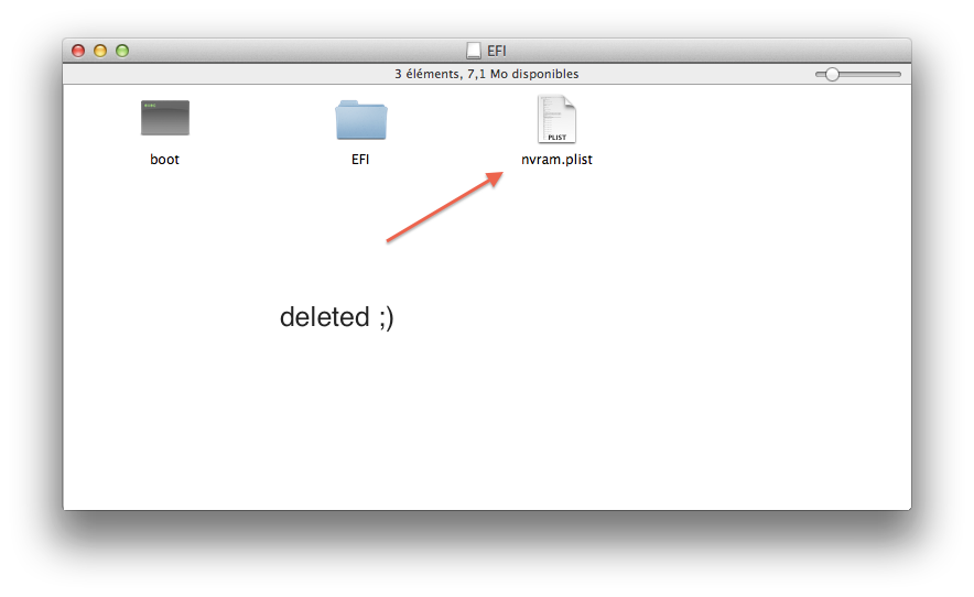

gills83 Posted June 7, 2017 Share Posted June 7, 2017 deleted all dsdt in EFI/ACPI/origin and deleted nvram Link to comment https://www.insanelymac.com/forum/topic/322268-help-topic-ryzen-macos-1012x-sierra/page/13/#findComment-2438102 Share on other sites More sharing options...

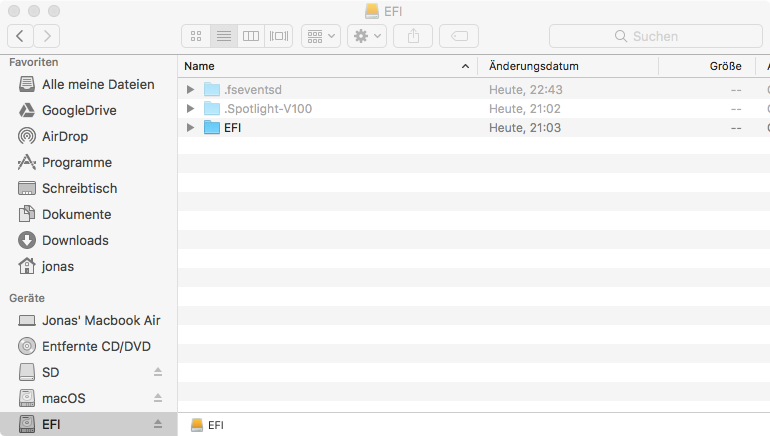

Jono4191 Posted June 7, 2017 Share Posted June 7, 2017 deleted all dsdt in EFI/ACPI/origin and deleted nvram EFI/CLOVER/ACPI/origin is empty How do I delete nvram? Link to comment https://www.insanelymac.com/forum/topic/322268-help-topic-ryzen-macos-1012x-sierra/page/13/#findComment-2438106 Share on other sites More sharing options...
gills83 Posted June 7, 2017 Share Posted June 7, 2017 and select debug dsdt Link to comment https://www.insanelymac.com/forum/topic/322268-help-topic-ryzen-macos-1012x-sierra/page/13/#findComment-2438111 Share on other sites More sharing options...
Jono4191 Posted June 7, 2017 Share Posted June 7, 2017 This is what my EFI partition looks like... no nvram.plist Strange thing is that I can see the upper menu bar just random. Often I only see the blurred wallpaper, then it seems to stop debug DSDT attached dsdt.zip Link to comment https://www.insanelymac.com/forum/topic/322268-help-topic-ryzen-macos-1012x-sierra/page/13/#findComment-2438117 Share on other sites More sharing options...
Gigamaxx Posted June 7, 2017 Share Posted June 7, 2017 npci=0x3000 busratio=32 -v and selecting InjectEDID and InjectATI (Futomaki) lets me boot into Sierra but I only can see the Sierra Wallpaper. If I don't press any key, the display will turn into standby after about 3 seconds. I can wake it up by pressing a key, but there is nothing to see except the Sierra wallpaper. I can't see the login screen. Then I entered my password blind, pressed Enter, then I see a part of the desktop (see attached screenshot). There it seems to stop. No cursor, no dock. Only the clock is running, too fast but thats not my biggest problem right nowFixRTC is enabled in Clover menu. Don't use inject EDID and inject ATI together, try just ATI and add fake ID 0x????1002 or whatever your card ID is. 0x68101002. Using both EDID and ATI inject is probably an issue. Link to comment https://www.insanelymac.com/forum/topic/322268-help-topic-ryzen-macos-1012x-sierra/page/13/#findComment-2438139 Share on other sites More sharing options...
Jono4191 Posted June 7, 2017 Share Posted June 7, 2017 Don't use inject EDID and inject ATI together, try just ATI and add fake ID 0x????1002 or whatever your card ID is. 0x68101002. Using both EDID and ATI inject is probably an issue. Gigamaxx, you are a hero! This was the solution! I only selected InjectATI now and it works. But now I have the next problem. My wireless mouse isn't working 1 Link to comment https://www.insanelymac.com/forum/topic/322268-help-topic-ryzen-macos-1012x-sierra/page/13/#findComment-2438144 Share on other sites More sharing options...

Nameless One Posted June 8, 2017 Share Posted June 8, 2017 Having struggled to find anything useful, what exactly is happening when booting via Clover UEFI, it prints its line of "++++" and then drops monitor sync and reboots? Link to comment https://www.insanelymac.com/forum/topic/322268-help-topic-ryzen-macos-1012x-sierra/page/13/#findComment-2438372 Share on other sites More sharing options...
Gigamaxx Posted June 8, 2017 Share Posted June 8, 2017 Having struggled to find anything useful, what exactly is happening when booting via Clover UEFI, it prints its line of "++++" and then drops monitor sync and reboots? Kernel almost loading, reboot panic. Post your System info in your signature please it makes it a little easier to help diagnose. It also gives someone following with similar build specs to find or give solutions. Boot Arg.=? Link to comment https://www.insanelymac.com/forum/topic/322268-help-topic-ryzen-macos-1012x-sierra/page/13/#findComment-2438385 Share on other sites More sharing options...
