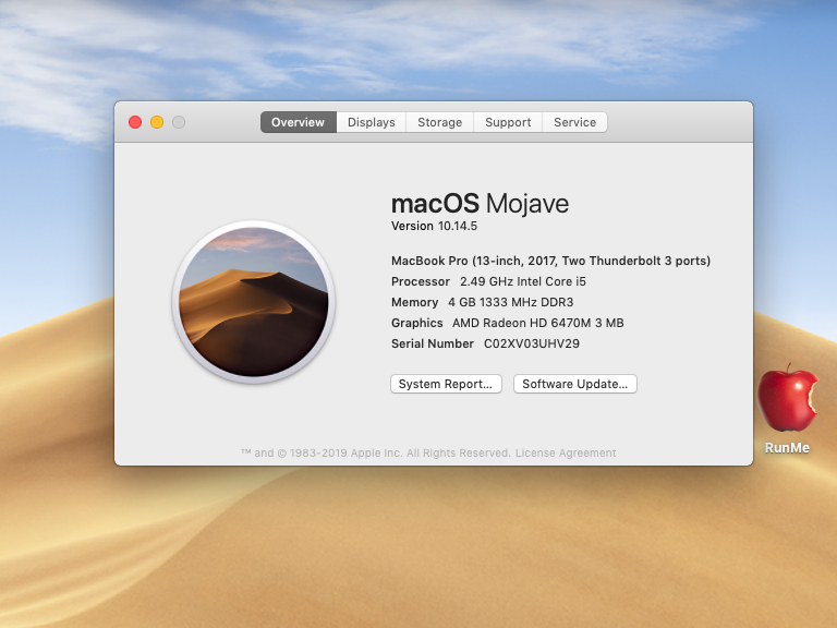

On 4/23/2020 at 6:11 PM, ajarillo said:
Finally I have got Mojave working in my laptop. I have tried kexts and clover patches to fix issues and almost everything works.
The only things that I wasn’t able to fix:
-Backlight screen control doesn’t appear.
-When it is connected to HDMI and I close the lid and reopen it, the laptop screen appears almost black, with really low brightness
-Sometimes in the boot, I receive a message saying “Error allocating  …. pages at ….” and I have to reboot.
I have been reading many guides and posts to patch DSDT and SSDTs but I am a bit lost. I have got disassembly DSDT and SSDTs but I don’t know how to get it compiles and what patches to apply.
My laptop features:
ASUS X554L
Intel i5 5200u 2500Mhz (Broadwell)
Motherboard: X555LDB
Graphics: Intel HD Graphics 5500 + Nvidia (disabled)
Ram: 4Gb in the motherboard + 8Gb Crucial
Wifi: Ateros AR956x
Ethernet: Realtek PCIe GBE Family Controller
Bios X555LDB.306
Audio Realtek ALC233
I have attached my config.plist and my DSDT.dsl. Could you please help me in the patching process?
config.plist
DSDT.aml
DSDT.dsl
I have fixed 2 of the issues that I had after including "change GFX0 to IGPU" in config.plist with clover configurator.
Now, I have backlight screen control working properly and I can close the lid of the laptop and reopen it being HDMI connected.
For the last issue, I have included OsxAptioFix2Drv-free2000.efi in CLOVER/drivers64UEFI folder and now I received less frequently the  “Error allocating  …. pages at ….” , but it still appears some times.
I am using a patched DSDT that I have downloaded from internet for a similar laptop than mine and now I see the battery level. But I have read that it is not recommended to use DSDT of other computers in yours.
Maldon, Could please you help me to patch my DSDT?
Also, if you have have any idea about how to solve the "Error allocating ... pages at ...", let me know and I will test it.
