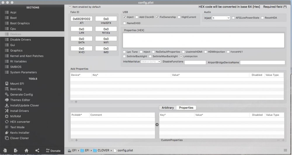

As AMD has done a lot of rebranding your card might not work OTB in OSX. While kexts like WhateverGreen offer solution for most but they don't cover all the cards. In my opinion it's much cleaner to use Apple native support by telling OSX which exactly chip you’re using.
You only need to input correct fake ID for ATI in Clover Devices section. Here is example for mine R7 250 based on Oland XT chip. You must remove Inject ATI in the graphics section.

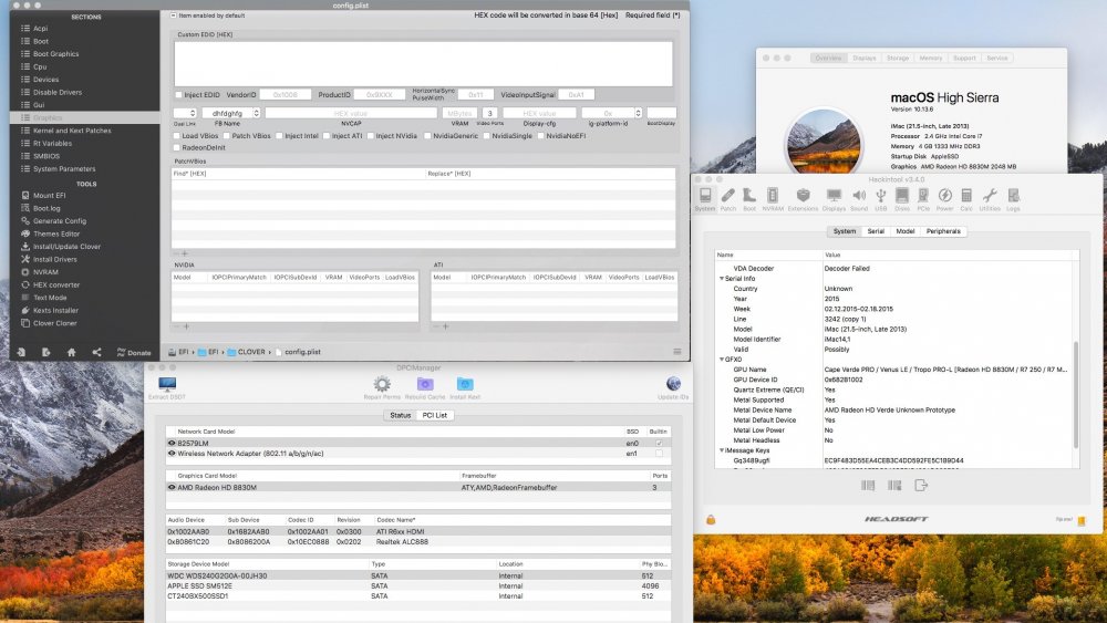

Here is my "unsupported" XFX R7 250A 2GB DDR3 based on Oland XT with full QE/CI and Metal:
Note that I've input garbage as a Framebuffer name that tells OSX to use AMD Framebuffer. Let me know if this method works for you.

Good to hear @STLVNUB This method is so much better than adding your card ID to controller kext as there is much more nitty gritty for each different AMD chipset even in the same family.  For example even when I added my card’s original ID to 7000 controller resolution was there but no acceleration but when I tell OSX this is that very chipset card works like a dream including fan and temps.
