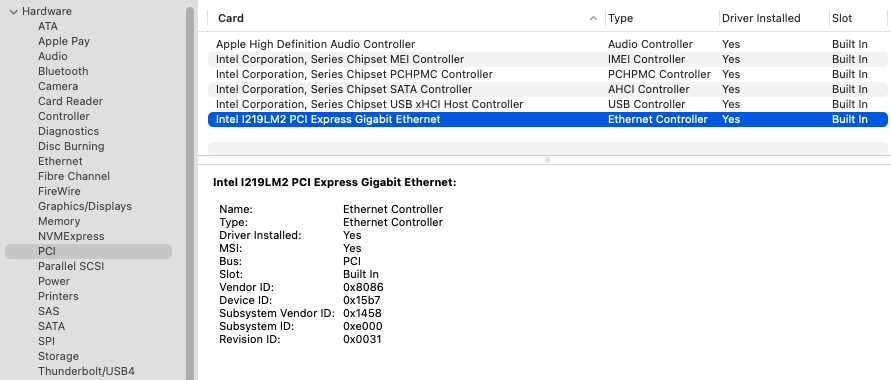

...in system info...the pci listing is now populated

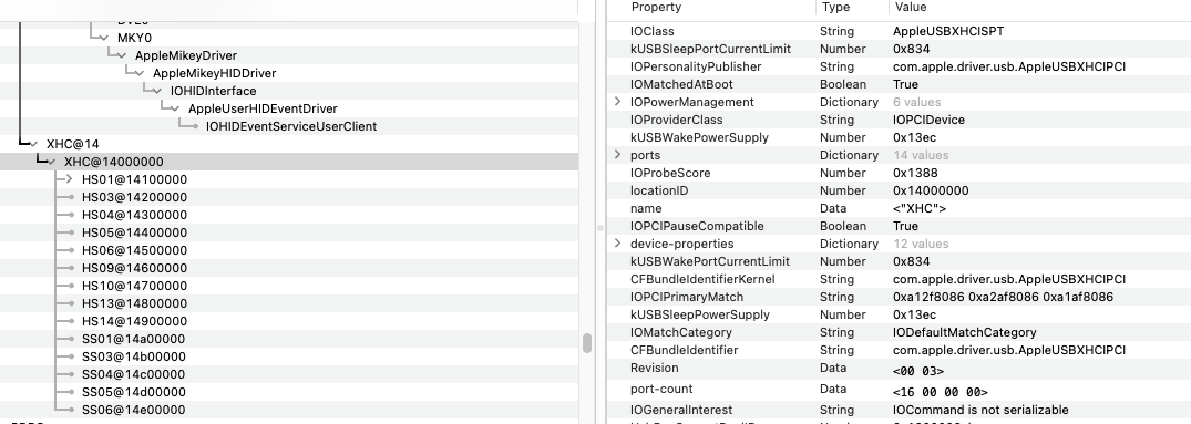

u need remap ur usb for usb3 start work
....I know, 🤔 but I have no USB 3 devices to map with...could I do it with only USB 2 flash stick?...I know which physical ports(back and front) are USB 3 and USB 2...
need one usb3 device for discovery SSxx ports
... well, I've shaved a few ports off...using hackintool, and  😇 visual inspection/guesstimate not the way to go...but, until a usb3 device appears before me..

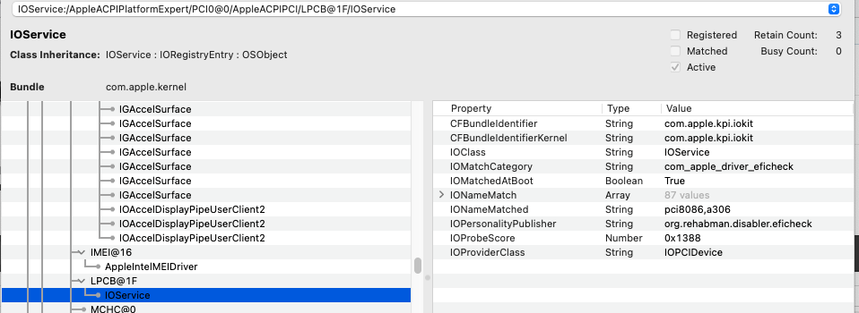

...I think related to your DSDT, I'm now using EFICheckDisabler.kext to prevent the cursed eficheck.kext from loading, which had become attached to the LPC on my board after loading your DSDT...sound familiar?

with dsdt our hack stay like one real mac.
in this case above just use Restrict Events kext
