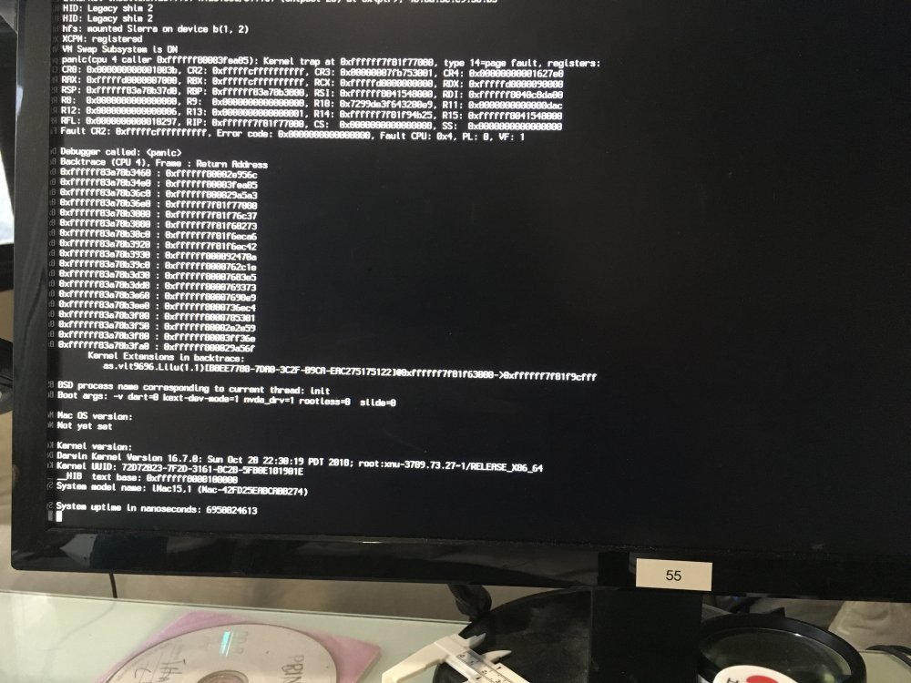

barleyjuice Posted January 14, 2019 Share Posted January 14, 2019 Hi Badruzeus I did run sudo rm -f /System/Library/Caches/com.apple.kext.caches/Startup/kernelcache && sudo touch /System/Library/Extensions && sudo kextcache -u / && sudo update_dyld_shared_cache -force it ran without any errors or failures.. then restarted but getting the same error pointing to lilu ( 1.1) version. Link to comment https://www.insanelymac.com/forum/topic/321371-lilu-%E2%80%94-kext-and-process-patcher/page/13/#findComment-2658870 Share on other sites More sharing options...
Badruzeus Posted January 14, 2019 Share Posted January 14, 2019 23 minutes ago, barleyjuice said: It ran without any errors or failures.. then restarted but getting the same error pointing to lilu ( 1.1) version. Yeah, weird.. where did you previously get Lilu 1.1 and it was installed using which method? Link to comment https://www.insanelymac.com/forum/topic/321371-lilu-%E2%80%94-kext-and-process-patcher/page/13/#findComment-2658874 Share on other sites More sharing options...
barleyjuice Posted January 14, 2019 Share Posted January 14, 2019 17 minutes ago, Badruzeus said: Yeah, weird.. where did you previously get Lilu 1.1 and it was installed using which method? I honestly never heard of lilu until 1 week ago when my system started crashing. I used vanilla sierra/clover on h97m-d3h to install over 1.5 years ago. ( i think it was the VioletDragons instructions) It was running like a dream until last week when it wouldnt boot. I cant remember updating anything meaningful ( to avoid situations like this) especially OS so not sure what happened or what i did wrong. Once i was pointed towards lilu.kext as being the culprit i downloaded the most recent one and copied the 1.3.1 to "Other" folder in EFI I should note there was no lilu.kext in the "other" directory in EFI until i copied/installed 1.3.1 ( this is probably the mysterious kext that cant be found) Really odd that i cant find V1.1 anywhere and have tried clearing/rebuilding multiple times with no success. Link to comment https://www.insanelymac.com/forum/topic/321371-lilu-%E2%80%94-kext-and-process-patcher/page/13/#findComment-2658878 Share on other sites More sharing options...
Matgen84 Posted January 14, 2019 Share Posted January 14, 2019 (edited) 2 hours ago, barleyjuice said: Hi Thanks i think i did the log correctly. This is what it shows. Also please note this is using -liluoff as im unable to boot without that flag. 0:100 0:100 MemLog inited, TSC freq: 3990761294 0:100 0:000 CPU was calibrated with ACPI PM Timer 0:100 0:000 0:100 0:000 Now is 14.1.2019, 4:34:16 (GMT) 0:100 0:000 Starting Clover revision: 4844 on American Megatrends EFI 0:100 0:000 Build with: [Args: -nb -mc --no-usb -D NO_GRUB_DRIVERS_EMBEDDED | -D DISABLE_USB_SUPPORT -D NO_GRUB_DRIVERS_EMBEDDED -D USE_BIOS_BLOCKIO -D USE_LOW_EBDA -a X64 -b RELEASE -t XCODE8 -n 5 | OS: 10.13.6 | XCODE: 10.1] 0:100 0:000 SelfDevicePath=PciRoot(0x0)\Pci(0x1F,0x2)\Sata(0x2,0xFFFF,0x0)\HD(1,GPT,A658A4FE-BED1-4E65-AB16-7CCB75017D7C,0x28,0x64000) @BC134518 0:100 0:000 SelfDirPath = \EFI\BOOT 0:100 0:000 === [ Get Smbios ] ======================================== 0:100 0:000 Type 16 Index = 0 0:100 0:000 Total Memory Slots Count = 4 0:100 0:000 Type 17 Index = 0 0:100 0:000 SmbiosTable.Type17->Speed = 1600MHz 0:100 0:000 SmbiosTable.Type17->Size = 8192MB 0:100 0:000 SmbiosTable.Type17->Bank/Device = BANK 0 ChannelA-DIMM0 0:100 0:000 SmbiosTable.Type17->Vendor = 1315 0:100 0:000 SmbiosTable.Type17->SerialNumber = 524903325 0:100 0:000 SmbiosTable.Type17->PartNumber = BLS8G3D1609DS1S001. 0:100 0:000 Type 17 Index = 1 0:100 0:000 SmbiosTable.Type17->Speed = 1600MHz 0:100 0:000 SmbiosTable.Type17->Size = 8192MB 0:100 0:000 SmbiosTable.Type17->Bank/Device = BANK 1 ChannelA-DIMM1 0:100 0:000 SmbiosTable.Type17->Vendor = 1315 0:100 0:000 SmbiosTable.Type17->SerialNumber = 524900617 0:100 0:000 SmbiosTable.Type17->PartNumber = BLS8G3D1609DS1S00. 0:100 0:000 Type 17 Index = 2 0:100 0:000 SmbiosTable.Type17->Speed = 1600MHz 0:100 0:000 SmbiosTable.Type17->Size = 8192MB 0:100 0:000 SmbiosTable.Type17->Bank/Device = BANK 2 ChannelB-DIMM0 0:100 0:000 SmbiosTable.Type17->Vendor = 1315 0:100 0:000 SmbiosTable.Type17->SerialNumber = 52490068 0:100 0:000 SmbiosTable.Type17->PartNumber = BLS8G3D1609DS1S001. 0:100 0:000 Type 17 Index = 3 0:100 0:000 SmbiosTable.Type17->Speed = 1600MHz 0:100 0:000 SmbiosTable.Type17->Size = 8192MB 0:100 0:000 SmbiosTable.Type17->Bank/Device = BANK 3 ChannelB-DIMM1 0:100 0:000 SmbiosTable.Type17->Vendor = 1315 0:100 0:000 SmbiosTable.Type17->SerialNumber = 52490210 0:100 0:000 SmbiosTable.Type17->PartNumber = BLS8G3D1609DS1S00. 0:100 0:000 Boot status=0 0:100 0:000 Running on: 'H97M-D3H' with board 'H97M-D3H' 0:100 0:000 === [ GetCPUProperties ] ================================== 0:100 0:000 CPU Vendor = 756E6547 Model=306C3 0:100 0:000 The CPU supported SSE4.1 0:100 0:000 BrandString = Intel(R) Core(TM) i7-4790K CPU @ 4.00GHz 0:100 0:000 The CPU supported turbo 0:100 0:000 MSR 0x35 40008 0:100 0:000 MSR 0xE2 before patch 1E000404 0:100 0:000 MSR 0xCE 00080838_F3012800 0:100 0:000 corrected FLEX_RATIO = E0000 0:100 0:000 FSBFrequency = 100 MHz, DMI FSBFrequency = 100 MHz, Corrected FSBFrequency = 100 MHz 0:100 0:000 MaxDiv/MinDiv: 40.0/8 0:100 0:000 Turbo: 42/43/44/44 0:100 0:000 Features: 0xBFEBFBFF 0:100 0:000 Threads: 8 0:100 0:000 Cores: 4 0:100 0:000 FSB: 100 MHz 0:100 0:000 CPU: 4000 MHz 0:100 0:000 TSC: 4000 MHz 0:100 0:000 PIS: 100 MHz 0:100 0:000 ExternalClock: 25 MHz 0:100 0:000 === [ GetDevices ] ======================================== 0:100 0:000 PCI (00|00:00.00) : 8086 0C00 class=060000 0:100 0:000 PCI (00|00:01.00) : 8086 0C01 class=060400 0:100 0:000 PCI (00|01:00.00) : 10DE 1187 class=030000 0:100 0:000 - GFX: Model=nVidia GeForce GTX 760 family 1FF (Nvidia) 0:100 0:000 PCI (00|01:00.01) : 10DE 0E0A class=040300 0:100 0:000 - HDMI Audio: 0:100 0:000 PCI (00|00:02.00) : 8086 0412 class=030000 0:100 0:000 - GFX: Model=Intel HD Graphics 4600 (Intel) 0:100 0:000 PCI (00|00:03.00) : 8086 0C0C class=040300 0:100 0:000 PCI (00|00:14.00) : 8086 8CB1 class=0C0330 0:100 0:000 PCI (00|00:16.00) : 8086 8CBA class=078000 0:100 0:000 PCI (00|00:1A.00) : 8086 8CAD class=0C0320 0:100 0:000 PCI (00|00:1B.00) : 8086 8CA0 class=040300 0:100 0:000 PCI (00|00:1C.00) : 8086 8C90 class=060400 0:100 0:000 PCI (00|00:1C.02) : 8086 8C94 class=060400 0:100 0:000 PCI (00|03:00.00) : 10EC 8168 class=020000 0:100 0:000 - LAN: 0 Vendor=Realtek 0:100 0:000 PCI (00|00:1C.03) : 8086 8C96 class=060400 0:100 0:000 PCI (00|04:00.00) : 8086 244E class=060401 0:100 0:000 PCI (00|00:1C.04) : 8086 8C98 class=060400 0:100 0:000 PCI (00|06:00.00) : 168C 0030 class=028000 0:100 0:000 - WIFI: Vendor=Atheros 0:100 0:000 PCI (00|00:1D.00) : 8086 8CA6 class=0C0320 0:100 0:000 PCI (00|00:1F.00) : 8086 8CC6 class=060100 0:100 0:000 PCI (00|00:1F.02) : 8086 8C82 class=010601 0:100 0:000 PCI (00|00:1F.03) : 8086 8CA2 class=0C0500 0:100 0:000 === [ GetDefaultSettings ] ================================ 0:100 0:000 Clover load options size = 0 bytes 0:103 0:003 EFI\CLOVER\config.plist loaded: Success 0:103 0:000 === [ GetListOfThemes ] =================================== 0:104 0:000 - [00]: EMBEDDED 0:105 0:001 - [00]: RANDOM 0:106 0:001 === [ Found config plists ] =============================== 0:106 0:000 - config.plist 0:106 0:000 === [ GetEarlyUserSettings ] ============================== 0:106 0:000 timeout set to 5 0:106 0:000 Custom boot CUSTOM_BOOT_DISABLED (0x0) 0:106 0:000 KextsToPatch: 2 requested 0:106 0:000 - [00]: com.apple.driver.usb.AppleUSBXHCIPCI (change 15 port limit to 20 in XHCI kext (9-series)) :: MatchOS: 10.11.x :: BinPatch :: data len: 7 0:106 0:000 - [01]: com.apple.driver.usb.AppleUSBXHCIPCI (change 15 port limit to 20 in XHCI kext (9-series)) :: MatchOS: 10.12.x :: BinPatch :: data len: 7 0:106 0:000 Default theme: embedded 0:106 0:000 Hiding entries with string BOOTX64.EFI 0:106 0:000 Hiding entries with string Windows 0:106 0:000 === [ LoadDrivers ] ======================================= 0:109 0:003 Loading AudioDxe-64.efi status=Success 0:112 0:002 - driver needs connecting 0:112 0:000 Loading DataHubDxe-64.efi status=Success 0:117 0:005 Loading FSInject-64.efi status=Success 0:119 0:001 Loading SMCHelper-64.efi status=Success 0:120 0:001 Loading HFSPlus.efi status=Success 0:122 0:002 - driver needs connecting 0:122 0:000 Loading AppleImageCodec-64.efi status=Success 0:123 0:001 Loading AppleKeyAggregator-64.efi status=Success 0:125 0:001 Loading AppleUITheme-64.efi status=Success 0:126 0:001 Loading EmuVariableUefi-64.efi status=Success 0:127 0:001 EmuVariableUefi Initialize: VariableCommonInitialize = Success, orig services stored, install gEmuVariableControlProtocolGuid = Success 0:127 0:000 Loading FirmwareVolume-64.efi status=Success 0:128 0:001 Loading OsxAptioFixDrv-64.efi status=Success 0:130 0:001 Loading OsxFatBinaryDrv-64.efi status=Success 0:131 0:001 Loading PartitionDxe-64.efi status=Success 0:133 0:001 - driver needs connecting 0:133 0:000 Loading VBoxHfs-64.efi status=Success 0:134 0:001 - driver needs connecting 0:134 0:000 4 drivers needs connecting ... 0:134 0:000 PlatformDriverOverrideProtocol->GetDriver overriden 0:134 0:000 Partition driver loaded: 0:134 0:000 HFS+ driver loaded 0:134 0:000 Searching for invalid DiskIo BY_DRIVER connects: not found, all ok 6:518 6:384 EmuVariable InstallEmulation: orig vars copied, emu.var.services installed, CreateEvent VirtualAddressChange = Success, CreateEvent ExitBootServices = Success, set Status=Success 6:587 0:068 === [ InitScreen ] ======================================== 6:587 0:000 SetMaxResolution: found best mode 4: 1920x1080 6:755 0:168 Video mode change to mode #4: Success 6:755 0:000 - set 6:755 0:000 Console modes reported: 6, available modes: 6:755 0:000 - [01]: 80x25 (current mode) 6:755 0:000 - [02]: 80x50 6:755 0:000 - [03]: 100x31 6:755 0:000 - [04]: 128x30 6:755 0:000 - [06]: 120x50 6:755 0:000 reinit: self device path=PciRoot(0x0)\Pci(0x1F,0x2)\Sata(0x2,0xFFFF,0x0)\HD(1,GPT,A658A4FE-BED1-4E65-AB16-7CCB75017D7C,0x28,0x64000) 6:756 0:000 Using embedded font: Success 6:843 0:086 === [ GetMacAddress ] ===================================== 6:843 0:000 MAC address of LAN #0= 40:8D:5C:C9:58:B5: 6:843 0:000 === [ ScanSPD ] =========================================== 6:843 0:000 Scanning SMBus [8086:8CA2], mmio: 0xF7A18004, ioport: 0xF040, hostc: 0x11 6:862 0:018 Slot: 0 Type 24 8192MB 1600MHz Vendor=Crucial Technology PartNo=BLS8G3D1609DS1S00. SerialNo=05020409000302015 6:880 0:018 Slot: 1 Type 24 8192MB 1600MHz Vendor=Crucial Technology PartNo=BLS8G3D1609DS1S00. SerialNo=05020409000006017 6:899 0:018 Slot: 2 Type 24 8192MB 1600MHz Vendor=Crucial Technology PartNo=BLS8G3D1609DS1S00. SerialNo=05020409000006018 6:918 0:018 Slot: 3 Type 24 8192MB 1600MHz Vendor=Crucial Technology PartNo=BLS8G3D1609DS1S00. SerialNo=05020409000201010 6:918 0:000 === [ GetAcpiTablesList ] ================================= 6:918 0:000 Get Acpi Tables List from RSDT: 6:918 0:000 - [00]: FACP A M I len=132 6:918 0:000 - [01]: APIC A M I len=146 6:918 0:000 - [02]: FPDT A M I len=68 6:918 0:000 - [03]: SSDT Ther_Rvp len=3054 6:918 0:000 - [04]: SSDT Cpu0Ist len=1337 6:918 0:000 - [05]: SSDT CpuSsdt len=2932 6:918 0:000 - [06]: MCFG A M I len=60 6:918 0:000 - [07]: HPET A M I len=56 6:918 0:000 - [08]: SSDT SataTabl len=877 6:918 0:000 - [09]: SSDT SaSsdt len=23390 6:918 0:000 - [10]: BGRT A M I len=56 6:918 0:000 - [11]: DMAR BDW len=184 6:918 0:000 Calibrated TSC Frequency = 3990761294 = 3990MHz 6:918 0:000 === [ GetUserSettings ] =================================== 6:918 0:000 USB FixOwnership: yes 6:918 0:000 Dropping 3 tables: 6:918 0:000 - [00]: Drop table signature="SSDT" (54445353) table-id="CpuPm" (0000006D50757043) 6:918 0:000 - set table: 54445353, 6D50757043 to drop: no 6:918 0:000 - [01]: Drop table signature="SSDT" (54445353) table-id="Cpu0Ist" (0074734930757043) 6:918 0:000 - set table: 54445353, 74734930757043 to drop: yes 6:918 0:000 - [02]: Drop table signature="DMAR" (52414D44) 6:918 0:000 - set table: 52414D44, 0 to drop: yes 6:918 0:000 - final DSDT Fix mask=00000000 6:918 0:000 EnableC6: yes 6:918 0:000 Using ProductName from config: iMac15,1 6:918 0:000 Using latest BiosVersion from clover 6:918 0:000 BiosVersion: IM151.88Z.0219.B00.1809190740 6:918 0:000 BiosReleaseDate: 09/19/2018 6:918 0:000 Using EfiVersion from clover: 222.0.0.0.0 6:918 0:000 Using FirmwareFeatures from clover: 0xF80FE137 6:918 0:000 Using FirmwareFeaturesMask from clover: 0xFF1FFF3F 6:918 0:000 Using PlatformFeature from clover: 0x1 6:918 0:000 Board-ID set from config as Mac-42FD25EABCABB2714 6:918 0:000 BoardType: 0xA 6:918 0:000 ChassisType: 0x13 6:918 0:000 Converted CustomUUID 19318076-A102-5D39-9B41-4212150510091 6:925 0:006 === [ Found DSDT tables ] ================================= 6:981 0:055 === [ ScanVolumes ] ======================================= 6:981 0:000 Found 13 volumes with blockIO 6:981 0:000 - [00]: Volume: PciRoot(0x0)\Pci(0x1F,0x2)\Sata(0x1,0xFFFF,0x0) 6:982 0:001 - [01]: Volume: PciRoot(0x0)\Pci(0x1F,0x2)\Sata(0x2,0xFFFF,0x0) 6:983 0:000 - [02]: Volume: PciRoot(0x0)\Pci(0x1F,0x2)\Sata(0x3,0xFFFF,0x0) 6:985 0:002 - [03]: Volume: PciRoot(0x0)\Pci(0x1F,0x2)\Sata(0x4,0xFFFF,0x0) 6:985 0:000 - [04]: Volume: PciRoot(0x0)\Pci(0x1F,0x2)\Sata(0x1,0xFFFF,0x0)\HD(1,GPT,DFE85A06-586C-4A82-AF33-28C226F20A4E,0x28,0x64000) 6:986 0:000 Result of bootcode detection: bootable unknown (legacy) 6:991 0:004 - [05]: Volume: PciRoot(0x0)\Pci(0x1F,0x2)\Sata(0x1,0xFFFF,0x0)\HD(2,GPT,959E644F-0C18-4C89-83D1-4D0F13BD8970,0x64028,0x1BE80460) 6:991 0:000 - [06]: Volume: PciRoot(0x0)\Pci(0x1F,0x2)\Sata(0x2,0xFFFF,0x0)\HD(1,GPT,A658A4FE-BED1-4E65-AB16-7CCB75017D7C,0x28,0x64000) 6:992 0:000 Result of bootcode detection: bootable unknown (legacy) 7:002 0:010 This is SelfVolume !! 7:002 0:000 - [07]: Volume: PciRoot(0x0)\Pci(0x1F,0x2)\Sata(0x2,0xFFFF,0x0)\HD(2,GPT,F69E56F1-3E8B-43D9-9B59-B34A05352DA5,0x64028,0x37CA9740) 7:003 0:000 - [08]: Volume: PciRoot(0x0)\Pci(0x1F,0x2)\Sata(0x2,0xFFFF,0x0)\HD(3,GPT,E0589854-A446-4574-A6EF-5BB51B592B3E,0x37D0D768,0x135F20) 7:003 0:000 - [09]: Volume: PciRoot(0x0)\Pci(0x1F,0x2)\Sata(0x3,0xFFFF,0x0)\HD(1,GPT,0ED45EAB-600C-4561-BF07-44F02BD6262C,0x28,0x64000) 7:004 0:000 Result of bootcode detection: bootable unknown (legacy) 7:008 0:004 - [10]: Volume: PciRoot(0x0)\Pci(0x1F,0x2)\Sata(0x3,0xFFFF,0x0)\HD(2,GPT,D1C306E8-66DD-4C1E-9EE9-59D38BAEA89E,0x64028,0x3A2E1FE0) 7:009 0:000 - [11]: Volume: PciRoot(0x0)\Pci(0x1F,0x2)\Sata(0x4,0xFFFF,0x0)\HD(1,GPT,F6F95B83-FDF3-497C-ABF1-EB7222B6F4C4,0x28,0x64000) 7:009 0:000 Result of bootcode detection: bootable unknown (legacy) 7:019 0:009 - [12]: Volume: PciRoot(0x0)\Pci(0x1F,0x2)\Sata(0x4,0xFFFF,0x0)\HD(2,GPT,D893CF8D-690E-4027-B965-75A17FFF45E8,0x64028,0x74662D60) 7:020 0:000 PutNvramPlistToRtVars: nvram.plist not found 7:020 0:000 === [ InitTheme ] ========================================= 7:020 0:000 use night theme 7:020 0:000 using embedded theme 7:020 0:000 Using embedded font: Success 7:020 0:000 theme inited 7:020 0:000 Chosen embedded theme 7:020 0:000 after NVRAM boot-args=-v dart=0 kext-dev-mode=1 7:020 0:000 === [ Dump SMC keys from NVRAM ] ========================== 7:020 0:000 found AppleSMC protocol 7:020 0:000 Registered 0 SMC keys 7:020 0:000 === [ ScanLoader ] ======================================== 7:020 0:000 - [04]: 'EFI' 7:020 0:000 - [05]: 'vmfarm-ssd-240' 7:020 0:000 - [06]: 'EFI' 7:022 0:002 AddLoaderEntry for Volume Name=EFI 7:022 0:000 skipped because entry is hidden 7:022 0:000 - [07]: 'Sierra' 7:026 0:003 AddLoaderEntry for Volume Name=Sierra 7:029 0:002 Check if volume Is Hibernated: 7:029 0:000 Check sleep image 'by signature': 7:034 0:004 read prefs \Library\Preferences\com.apple.PowerManagement.plist status=Success 7:034 0:000 using default sleep image name = \private\var\vm\sleepimage 7:037 0:003 no valid sleep image offset was found 7:037 0:000 no valid sleep image offset was found 7:038 0:000 no valid sleep image offset was found 7:038 0:000 sleepimage offset could not be acquired 7:038 0:000 hibernated: no - sign 7:038 0:000 - [08]: 'Recovery HD' 7:039 0:000 AddLoaderEntry for Volume Name=Recovery HD 7:040 0:000 - [09]: 'EFI' 7:040 0:000 - [10]: 'Samsung-500GB' 7:040 0:000 - [11]: 'EFI' 7:040 0:000 - [12]: 'VMFARMZ' 7:040 0:000 Scanning legacy ... 7:040 0:000 === [ AddCustomTool ] ===================================== 7:041 0:001 found tool \EFI\CLOVER\tools\Shell64U.efi 7:041 0:000 Checking EFI partition Volume 4 for Clover 7:041 0:000 Checking EFI partition Volume 6 for Clover 7:042 0:000 Found Clover 7:042 0:000 EmuVariable UninstallEmulation: CloseEvent = Success, original var services restored 7:042 0:000 EmuVariable InstallEmulation: orig vars copied, emu.var.services installed, CreateEvent VirtualAddressChange = Success, CreateEvent ExitBootServices = Success, set Status=Success 7:111 0:068 === [ GetEfiBootDeviceFromNvram ] ========================= 7:111 0:000 - found entry 0. 'Boot macOS from Sierra', Volume 'Sierra', DevicePath 'PciRoot(0x0)\Pci(0x1F,0x2)\Sata(0x2,0xFFFF,0x0)\HD(2,GPT,F69E56F1-3E8B-43D9-9B59-B34A05352DA5,0x64028,0x37CA9740)\System\Library\CoreServices\boot.efii' 7:111 0:000 EmuVariable UninstallEmulation: CloseEvent = Success, original var services restored 7:111 0:000 DefaultIndex=0 and MainMenu.EntryCount=8 7:111 0:000 not run anime 7:175 0:063 GUI ready 14:930 7:754 not run anime 17:417 2:487 not run anime 23:601 6:183 not run anime 25:017 1:416 not run anime 27:793 2:775 not run anime 33:257 5:463 not run anime 101:425 68:167 not run anime 103:201 1:776 not run anime 106:257 3:055 not run anime 111:825 5:568 Boot options: ------------- 111:825 0:000 BootOrder: 5: Boot0002, Boot0005, Boot0006, Boot0007, Boot0003 111:827 0:001 0) Boot0002: UEFI: ST1000DM010-2EP102, Attr: 0x1 111:827 0:000 PciRoot(0x0)\Pci(0x1F,0x2)\Sata(0x4,0xFFFF,0x0)\HD(1,GPT,F6F95B83-FDF3-497C-ABF1-EB7222B6F4C4,0x28,0x64000) 111:827 0:000 Size: 200 (Attr:4 + FPl:2 + Desc:50 + FP:140 + Opt:4 = 200 -> OK) 111:827 0:000 1) Boot0005: UEFI OS, Attr: 0x1 111:827 0:000 HD(1,GPT,A658A4FE-BED1-4E65-AB16-7CCB75017D7C,0x28,0x64000)\EFI\BOOT\BOOTX64.EFII 111:827 0:000 Size: 116 (Attr:4 + FPl:2 + Desc:16 + FP:94 + Opt:0 = 116 -> OK) 111:828 0:000 2) Boot0006: UEFI: Samsung SSD 860 EVO 500GB, Attr: 0x1 111:828 0:000 PciRoot(0x0)\Pci(0x1F,0x2)\Sata(0x3,0xFFFF,0x0)\HD(1,GPT,0ED45EAB-600C-4561-BF07-44F02BD6262C,0x28,0x64000) 111:828 0:000 Size: 214 (Attr:4 + FPl:2 + Desc:64 + FP:140 + Opt:4 = 214 -> OK) 111:828 0:000 3) Boot0007: UEFI: MSI REFLEX RX-240, Attr: 0x1 111:828 0:000 PciRoot(0x0)\Pci(0x1F,0x2)\Sata(0x1,0xFFFF,0x0)\HD(1,GPT,DFE85A06-586C-4A82-AF33-28C226F20A4E,0x28,0x64000) 111:828 0:000 Size: 198 (Attr:4 + FPl:2 + Desc:48 + FP:140 + Opt:4 = 198 -> OK) 111:829 0:000 4) Boot0003: Hard Drive , Attr: 0x1 111:829 0:000 BBS(HD,) 111:829 0:000 Size: 735 (Attr:4 + FPl:2 + Desc:24 + FP:13 + Opt:692 = 735 -> OK) 111:829 0:000 Boot options not in BootOrder list: 132:469 20:640 not found 132:469 0:000 ------------- 132:503 0:033 ReinitSelfLib after theme change 132:503 0:000 reinit: self device path=PciRoot(0x0)\Pci(0x1F,0x2)\Sata(0x2,0xFFFF,0x0)\HD(1,GPT,A658A4FE-BED1-4E65-AB16-7CCB75017D7C,0x28,0x64000) 132:503 0:000 === [ ScanVolumes ] ======================================= 132:503 0:000 Found 13 volumes with blockIO 132:503 0:000 - [00]: Volume: PciRoot(0x0)\Pci(0x1F,0x2)\Sata(0x1,0xFFFF,0x0) 132:503 0:000 - [01]: Volume: PciRoot(0x0)\Pci(0x1F,0x2)\Sata(0x2,0xFFFF,0x0) 132:510 0:006 - [02]: Volume: PciRoot(0x0)\Pci(0x1F,0x2)\Sata(0x3,0xFFFF,0x0) 132:510 0:000 This is SelfVolume !! 132:510 0:000 - [03]: Volume: PciRoot(0x0)\Pci(0x1F,0x2)\Sata(0x4,0xFFFF,0x0) 132:518 0:008 - [04]: Volume: PciRoot(0x0)\Pci(0x1F,0x2)\Sata(0x1,0xFFFF,0x0)\HD(1,GPT,DFE85A06-586C-4A82-AF33-28C226F20A4E,0x28,0x64000) 132:519 0:000 Result of bootcode detection: bootable unknown (legacy) 132:519 0:000 - [05]: Volume: PciRoot(0x0)\Pci(0x1F,0x2)\Sata(0x1,0xFFFF,0x0)\HD(2,GPT,959E644F-0C18-4C89-83D1-4D0F13BD8970,0x64028,0x1BE80460) 132:519 0:000 - [06]: Volume: PciRoot(0x0)\Pci(0x1F,0x2)\Sata(0x2,0xFFFF,0x0)\HD(1,GPT,A658A4FE-BED1-4E65-AB16-7CCB75017D7C,0x28,0x64000) 132:521 0:001 Result of bootcode detection: bootable unknown (legacy) 132:521 0:000 This is SelfVolume !! 132:521 0:000 - [07]: Volume: PciRoot(0x0)\Pci(0x1F,0x2)\Sata(0x2,0xFFFF,0x0)\HD(2,GPT,F69E56F1-3E8B-43D9-9B59-B34A05352DA5,0x64028,0x37CA9740) 132:521 0:000 - [08]: Volume: PciRoot(0x0)\Pci(0x1F,0x2)\Sata(0x2,0xFFFF,0x0)\HD(3,GPT,E0589854-A446-4574-A6EF-5BB51B592B3E,0x37D0D768,0x135F20) 132:522 0:000 - [09]: Volume: PciRoot(0x0)\Pci(0x1F,0x2)\Sata(0x3,0xFFFF,0x0)\HD(1,GPT,0ED45EAB-600C-4561-BF07-44F02BD6262C,0x28,0x64000) 132:522 0:000 Result of bootcode detection: bootable unknown (legacy) 132:522 0:000 - [10]: Volume: PciRoot(0x0)\Pci(0x1F,0x2)\Sata(0x3,0xFFFF,0x0)\HD(2,GPT,D1C306E8-66DD-4C1E-9EE9-59D38BAEA89E,0x64028,0x3A2E1FE0) 132:523 0:000 - [11]: Volume: PciRoot(0x0)\Pci(0x1F,0x2)\Sata(0x4,0xFFFF,0x0)\HD(1,GPT,F6F95B83-FDF3-497C-ABF1-EB7222B6F4C4,0x28,0x64000) 132:543 0:020 Result of bootcode detection: bootable unknown (legacy) 132:543 0:000 - [12]: Volume: PciRoot(0x0)\Pci(0x1F,0x2)\Sata(0x4,0xFFFF,0x0)\HD(2,GPT,D893CF8D-690E-4027-B965-75A17FFF45E8,0x64028,0x74662D60) 132:544 0:000 theme inited 132:544 0:000 Chosen embedded theme 132:544 0:000 after NVRAM boot-args=-v dart=0 kext-dev-mode=1 132:544 0:000 === [ ScanLoader ] ======================================== 132:544 0:000 - [04]: 'EFI' 132:544 0:000 - [05]: 'vmfarm-ssd-240' 132:544 0:000 - [06]: 'EFI' 132:544 0:000 AddLoaderEntry for Volume Name=EFI 132:544 0:000 skipped because entry is hidden 132:544 0:000 - [07]: 'Sierra' 132:545 0:000 AddLoaderEntry for Volume Name=Sierra 132:545 0:000 Check if volume Is Hibernated: 132:545 0:000 Check sleep image 'by signature': 132:545 0:000 read prefs \Library\Preferences\com.apple.PowerManagement.plist status=Success 132:545 0:000 using default sleep image name = \private\var\vm\sleepimage 132:545 0:000 sleepimage offset could not be acquired 132:545 0:000 hibernated: no - sign 132:545 0:000 - [08]: 'Recovery HD' 132:545 0:000 AddLoaderEntry for Volume Name=Recovery HD 132:545 0:000 - [09]: 'EFI' 132:545 0:000 - [10]: 'Samsung-500GB' 132:546 0:000 - [11]: 'EFI' 132:546 0:000 - [12]: 'VMFARMZ' 132:546 0:000 Scanning legacy ... 132:546 0:000 === [ AddCustomTool ] ===================================== 132:546 0:000 found tool \EFI\CLOVER\tools\Shell64U.efi 132:546 0:000 Checking EFI partition Volume 4 for Clover 132:546 0:000 Checking EFI partition Volume 6 for Clover 132:546 0:000 Found Clover 132:546 0:000 EmuVariable UninstallEmulation: CloseEvent = Invalid Parameter, original var services restored 132:546 0:000 EmuVariable InstallEmulation: orig vars copied, emu.var.services installed, CreateEvent VirtualAddressChange = Success, CreateEvent ExitBootServices = Success, set Status=Success 132:614 0:068 === [ GetEfiBootDeviceFromNvram ] ========================= 132:614 0:000 - found entry 0. 'Boot macOS from Sierra', Volume 'Sierra', DevicePath 'PciRoot(0x0)\Pci(0x1F,0x2)\Sata(0x2,0xFFFF,0x0)\HD(2,GPT,F69E56F1-3E8B-43D9-9B59-B34A05352DA5,0x64028,0x37CA9740)\System\Library\CoreServices\boot.efii' 132:614 0:000 EmuVariable UninstallEmulation: CloseEvent = Success, original var services restored 132:614 0:000 DefaultIndex=0 and MainMenu.EntryCount=8 132:614 0:000 not run anime 136:057 3:443 not run anime 139:577 3:520 Boot options: ------------- 139:577 0:000 BootOrder: 5: Boot0002, Boot0005, Boot0006, Boot0007, Boot0003 139:579 0:001 0) Boot0002: UEFI: ST1000DM010-2EP102, Attr: 0x1 139:579 0:000 PciRoot(0x0)\Pci(0x1F,0x2)\Sata(0x4,0xFFFF,0x0)\HD(1,GPT,F6F95B83-FDF3-497C-ABF1-EB7222B6F4C4,0x28,0x64000) 139:579 0:000 Size: 200 (Attr:4 + FPl:2 + Desc:50 + FP:140 + Opt:4 = 200 -> OK) 139:579 0:000 1) Boot0005: UEFI OS, Attr: 0x1 139:579 0:000 HD(1,GPT,A658A4FE-BED1-4E65-AB16-7CCB75017D7C,0x28,0x64000)\EFI\BOOT\BOOTX64.EFII 139:579 0:000 Size: 116 (Attr:4 + FPl:2 + Desc:16 + FP:94 + Opt:0 = 116 -> OK) 139:580 0:000 2) Boot0006: UEFI: Samsung SSD 860 EVO 500GB, Attr: 0x1 139:580 0:000 PciRoot(0x0)\Pci(0x1F,0x2)\Sata(0x3,0xFFFF,0x0)\HD(1,GPT,0ED45EAB-600C-4561-BF07-44F02BD6262C,0x28,0x64000) 139:580 0:000 Size: 214 (Attr:4 + FPl:2 + Desc:64 + FP:140 + Opt:4 = 214 -> OK) 139:580 0:000 3) Boot0007: UEFI: MSI REFLEX RX-240, Attr: 0x1 139:581 0:000 PciRoot(0x0)\Pci(0x1F,0x2)\Sata(0x1,0xFFFF,0x0)\HD(1,GPT,DFE85A06-586C-4A82-AF33-28C226F20A4E,0x28,0x64000) 139:581 0:000 Size: 198 (Attr:4 + FPl:2 + Desc:48 + FP:140 + Opt:4 = 198 -> OK) 139:581 0:000 4) Boot0003: Hard Drive , Attr: 0x1 139:581 0:000 BBS(HD,) 139:581 0:000 Size: 735 (Attr:4 + FPl:2 + Desc:24 + FP:13 + Opt:692 = 735 -> OK) 139:581 0:000 Boot options not in BootOrder list: 160:221 20:640 not found 160:221 0:000 ------------- 160:221 0:000 ReinitSelfLib after theme change 160:221 0:000 reinit: self device path=PciRoot(0x0)\Pci(0x1F,0x2)\Sata(0x2,0xFFFF,0x0)\HD(1,GPT,A658A4FE-BED1-4E65-AB16-7CCB75017D7C,0x28,0x64000) 160:221 0:000 === [ ScanVolumes ] ======================================= 160:221 0:000 Found 13 volumes with blockIO 160:221 0:000 - [00]: Volume: PciRoot(0x0)\Pci(0x1F,0x2)\Sata(0x1,0xFFFF,0x0) 160:224 0:002 - [01]: Volume: PciRoot(0x0)\Pci(0x1F,0x2)\Sata(0x2,0xFFFF,0x0) 160:230 0:006 - [02]: Volume: PciRoot(0x0)\Pci(0x1F,0x2)\Sata(0x3,0xFFFF,0x0) 160:233 0:002 This is SelfVolume !! 160:233 0:000 - [03]: Volume: PciRoot(0x0)\Pci(0x1F,0x2)\Sata(0x4,0xFFFF,0x0) 160:233 0:000 - [04]: Volume: PciRoot(0x0)\Pci(0x1F,0x2)\Sata(0x1,0xFFFF,0x0)\HD(1,GPT,DFE85A06-586C-4A82-AF33-28C226F20A4E,0x28,0x64000) 160:234 0:000 Result of bootcode detection: bootable unknown (legacy) 160:234 0:000 - [05]: Volume: PciRoot(0x0)\Pci(0x1F,0x2)\Sata(0x1,0xFFFF,0x0)\HD(2,GPT,959E644F-0C18-4C89-83D1-4D0F13BD8970,0x64028,0x1BE80460) 160:234 0:000 - [06]: Volume: PciRoot(0x0)\Pci(0x1F,0x2)\Sata(0x2,0xFFFF,0x0)\HD(1,GPT,A658A4FE-BED1-4E65-AB16-7CCB75017D7C,0x28,0x64000) 160:235 0:000 Result of bootcode detection: bootable unknown (legacy) 160:235 0:000 This is SelfVolume !! 160:235 0:000 - [07]: Volume: PciRoot(0x0)\Pci(0x1F,0x2)\Sata(0x2,0xFFFF,0x0)\HD(2,GPT,F69E56F1-3E8B-43D9-9B59-B34A05352DA5,0x64028,0x37CA9740) 160:235 0:000 - [08]: Volume: PciRoot(0x0)\Pci(0x1F,0x2)\Sata(0x2,0xFFFF,0x0)\HD(3,GPT,E0589854-A446-4574-A6EF-5BB51B592B3E,0x37D0D768,0x135F20) 160:236 0:000 - [09]: Volume: PciRoot(0x0)\Pci(0x1F,0x2)\Sata(0x3,0xFFFF,0x0)\HD(1,GPT,0ED45EAB-600C-4561-BF07-44F02BD6262C,0x28,0x64000) 160:236 0:000 Result of bootcode detection: bootable unknown (legacy) 160:236 0:000 - [10]: Volume: PciRoot(0x0)\Pci(0x1F,0x2)\Sata(0x3,0xFFFF,0x0)\HD(2,GPT,D1C306E8-66DD-4C1E-9EE9-59D38BAEA89E,0x64028,0x3A2E1FE0) 160:237 0:000 - [11]: Volume: PciRoot(0x0)\Pci(0x1F,0x2)\Sata(0x4,0xFFFF,0x0)\HD(1,GPT,F6F95B83-FDF3-497C-ABF1-EB7222B6F4C4,0x28,0x64000) 160:237 0:000 Result of bootcode detection: bootable unknown (legacy) 160:237 0:000 - [12]: Volume: PciRoot(0x0)\Pci(0x1F,0x2)\Sata(0x4,0xFFFF,0x0)\HD(2,GPT,D893CF8D-690E-4027-B965-75A17FFF45E8,0x64028,0x74662D60) 160:238 0:000 theme inited 160:238 0:000 Chosen embedded theme 160:239 0:000 after NVRAM boot-args=-v dart=0 kext-dev-mode=1 160:239 0:000 === [ ScanLoader ] ======================================== 160:239 0:000 - [04]: 'EFI' 160:239 0:000 - [05]: 'vmfarm-ssd-240' 160:239 0:000 - [06]: 'EFI' 160:239 0:000 AddLoaderEntry for Volume Name=EFI 160:239 0:000 skipped because entry is hidden 160:239 0:000 - [07]: 'Sierra' 160:239 0:000 AddLoaderEntry for Volume Name=Sierra 160:239 0:000 Check if volume Is Hibernated: 160:239 0:000 Check sleep image 'by signature': 160:239 0:000 read prefs \Library\Preferences\com.apple.PowerManagement.plist status=Success 160:239 0:000 using default sleep image name = \private\var\vm\sleepimage 160:239 0:000 sleepimage offset could not be acquired 160:239 0:000 hibernated: no - sign 160:240 0:000 - [08]: 'Recovery HD' 160:240 0:000 AddLoaderEntry for Volume Name=Recovery HD 160:240 0:000 - [09]: 'EFI' 160:240 0:000 - [10]: 'Samsung-500GB' 160:240 0:000 - [11]: 'EFI' 160:240 0:000 - [12]: 'VMFARMZ' 160:240 0:000 Scanning legacy ... 160:240 0:000 === [ AddCustomTool ] ===================================== 160:240 0:000 found tool \EFI\CLOVER\tools\Shell64U.efi 160:240 0:000 Checking EFI partition Volume 4 for Clover 160:240 0:000 Checking EFI partition Volume 6 for Clover 160:240 0:000 Found Clover 160:240 0:000 EmuVariable UninstallEmulation: CloseEvent = Invalid Parameter, original var services restored 160:240 0:000 EmuVariable InstallEmulation: orig vars copied, emu.var.services installed, CreateEvent VirtualAddressChange = Success, CreateEvent ExitBootServices = Success, set Status=Success 160:308 0:068 === [ GetEfiBootDeviceFromNvram ] ========================= 160:308 0:000 - found entry 0. 'Boot macOS from Sierra', Volume 'Sierra', DevicePath 'PciRoot(0x0)\Pci(0x1F,0x2)\Sata(0x2,0xFFFF,0x0)\HD(2,GPT,F69E56F1-3E8B-43D9-9B59-B34A05352DA5,0x64028,0x37CA9740)\System\Library\CoreServices\boot.efii' 160:308 0:000 EmuVariable UninstallEmulation: CloseEvent = Success, original var services restored 160:308 0:000 DefaultIndex=0 and MainMenu.EntryCount=8 160:308 0:000 not run anime 163:954 3:645 not run anime 169:003 5:049 EDITED: -v dart=0 kext-dev-mode=1 -liluoff 171:737 2:734 ReinitSelfLib after theme change 171:737 0:000 reinit: self device path=PciRoot(0x0)\Pci(0x1F,0x2)\Sata(0x2,0xFFFF,0x0)\HD(1,GPT,A658A4FE-BED1-4E65-AB16-7CCB75017D7C,0x28,0x64000) 171:737 0:000 === [ ScanVolumes ] ======================================= 171:737 0:000 Found 13 volumes with blockIO 171:737 0:000 - [00]: Volume: PciRoot(0x0)\Pci(0x1F,0x2)\Sata(0x1,0xFFFF,0x0) 171:740 0:002 - [01]: Volume: PciRoot(0x0)\Pci(0x1F,0x2)\Sata(0x2,0xFFFF,0x0) 171:747 0:006 - [02]: Volume: PciRoot(0x0)\Pci(0x1F,0x2)\Sata(0x3,0xFFFF,0x0) 171:749 0:002 This is SelfVolume !! 171:749 0:000 - [03]: Volume: PciRoot(0x0)\Pci(0x1F,0x2)\Sata(0x4,0xFFFF,0x0) 171:749 0:000 - [04]: Volume: PciRoot(0x0)\Pci(0x1F,0x2)\Sata(0x1,0xFFFF,0x0)\HD(1,GPT,DFE85A06-586C-4A82-AF33-28C226F20A4E,0x28,0x64000) 171:750 0:000 Result of bootcode detection: bootable unknown (legacy) 171:750 0:000 - [05]: Volume: PciRoot(0x0)\Pci(0x1F,0x2)\Sata(0x1,0xFFFF,0x0)\HD(2,GPT,959E644F-0C18-4C89-83D1-4D0F13BD8970,0x64028,0x1BE80460) 171:750 0:000 - [06]: Volume: PciRoot(0x0)\Pci(0x1F,0x2)\Sata(0x2,0xFFFF,0x0)\HD(1,GPT,A658A4FE-BED1-4E65-AB16-7CCB75017D7C,0x28,0x64000) 171:751 0:000 Result of bootcode detection: bootable unknown (legacy) 171:751 0:000 This is SelfVolume !! 171:751 0:000 - [07]: Volume: PciRoot(0x0)\Pci(0x1F,0x2)\Sata(0x2,0xFFFF,0x0)\HD(2,GPT,F69E56F1-3E8B-43D9-9B59-B34A05352DA5,0x64028,0x37CA9740) 171:751 0:000 - [08]: Volume: PciRoot(0x0)\Pci(0x1F,0x2)\Sata(0x2,0xFFFF,0x0)\HD(3,GPT,E0589854-A446-4574-A6EF-5BB51B592B3E,0x37D0D768,0x135F20) 171:752 0:000 - [09]: Volume: PciRoot(0x0)\Pci(0x1F,0x2)\Sata(0x3,0xFFFF,0x0)\HD(1,GPT,0ED45EAB-600C-4561-BF07-44F02BD6262C,0x28,0x64000) 171:752 0:000 Result of bootcode detection: bootable unknown (legacy) 171:752 0:000 - [10]: Volume: PciRoot(0x0)\Pci(0x1F,0x2)\Sata(0x3,0xFFFF,0x0)\HD(2,GPT,D1C306E8-66DD-4C1E-9EE9-59D38BAEA89E,0x64028,0x3A2E1FE0) 171:753 0:000 - [11]: Volume: PciRoot(0x0)\Pci(0x1F,0x2)\Sata(0x4,0xFFFF,0x0)\HD(1,GPT,F6F95B83-FDF3-497C-ABF1-EB7222B6F4C4,0x28,0x64000) 171:753 0:000 Result of bootcode detection: bootable unknown (legacy) 171:753 0:000 - [12]: Volume: PciRoot(0x0)\Pci(0x1F,0x2)\Sata(0x4,0xFFFF,0x0)\HD(2,GPT,D893CF8D-690E-4027-B965-75A17FFF45E8,0x64028,0x74662D60) 171:754 0:000 theme inited 171:754 0:000 Chosen embedded theme 171:755 0:000 after NVRAM boot-args=-v dart=0 kext-dev-mode=1 -liluoff 171:755 0:000 === [ ScanLoader ] ======================================== 171:755 0:000 - [04]: 'EFI' 171:755 0:000 - [05]: 'vmfarm-ssd-240' 171:755 0:000 - [06]: 'EFI' 171:755 0:000 AddLoaderEntry for Volume Name=EFI 171:755 0:000 skipped because entry is hidden 171:755 0:000 - [07]: 'Sierra' 171:755 0:000 AddLoaderEntry for Volume Name=Sierra 171:755 0:000 Check if volume Is Hibernated: 171:755 0:000 Check sleep image 'by signature': 171:755 0:000 read prefs \Library\Preferences\com.apple.PowerManagement.plist status=Success 171:755 0:000 using default sleep image name = \private\var\vm\sleepimage 171:756 0:000 sleepimage offset could not be acquired 171:756 0:000 hibernated: no - sign 171:756 0:000 - [08]: 'Recovery HD' 171:756 0:000 AddLoaderEntry for Volume Name=Recovery HD 171:756 0:000 - [09]: 'EFI' 171:756 0:000 - [10]: 'Samsung-500GB' 171:756 0:000 - [11]: 'EFI' 171:756 0:000 - [12]: 'VMFARMZ' 171:756 0:000 Scanning legacy ... 171:756 0:000 === [ AddCustomTool ] ===================================== 171:756 0:000 found tool \EFI\CLOVER\tools\Shell64U.efi 171:756 0:000 Checking EFI partition Volume 4 for Clover 171:756 0:000 Checking EFI partition Volume 6 for Clover 171:756 0:000 Found Clover 171:756 0:000 EmuVariable UninstallEmulation: CloseEvent = Invalid Parameter, original var services restored 171:756 0:000 EmuVariable InstallEmulation: orig vars copied, emu.var.services installed, CreateEvent VirtualAddressChange = Success, CreateEvent ExitBootServices = Success, set Status=Success 171:825 0:068 === [ GetEfiBootDeviceFromNvram ] ========================= 171:825 0:000 - found entry 0. 'Boot macOS from Sierra', Volume 'Sierra', DevicePath 'PciRoot(0x0)\Pci(0x1F,0x2)\Sata(0x2,0xFFFF,0x0)\HD(2,GPT,F69E56F1-3E8B-43D9-9B59-B34A05352DA5,0x64028,0x37CA9740)\System\Library\CoreServices\boot.efii' 171:825 0:000 EmuVariable UninstallEmulation: CloseEvent = Success, original var services restored 171:825 0:000 DefaultIndex=0 and MainMenu.EntryCount=8 171:825 0:000 not run anime 172:650 0:824 Boot option Boot0000 not found 172:650 0:000 === [ StartLoader ] ======================================= 172:650 0:000 Finally: ExternalClock=25MHz BusSpeed=99770kHz CPUFreq=3991MHz PIS: hw.busfrequency=100000000Hz 172:650 0:000 Loading boot.efi status=Success 172:716 0:066 GetOSVersion: 10.12.6 (16G1710) 172:716 0:000 CSR_CFG: CSR_ALLOW_UNTRUSTED_KEXTS | CSR_ALLOW_UNRESTRICTED_FS | CSR_ALLOW_TASK_FOR_PID | CSR_ALLOW_UNRESTRICTED_DTRACE | CSR_ALLOW_UNRESTRICTED_NVRAM 172:716 0:000 Filtering KextPatches: 172:716 0:000 - [00]: com.apple.driver.usb.AppleUSBXHCIPCI (change 15 port limit to 20 in XHCI kext (9-series)) :: BinPatch :: [OS: 10.12.6 | MatchOS: 10.11.x | MatchBuild: All] ==> not allowed 172:716 0:000 - [01]: com.apple.driver.usb.AppleUSBXHCIPCI (change 15 port limit to 20 in XHCI kext (9-series)) :: BinPatch :: [OS: 10.12.6 | MatchOS: 10.12.x | MatchBuild: All] ==> allowed 172:716 0:000 Will not patch boot.efi 172:716 0:000 EmuVariable InstallEmulation: orig vars copied, emu.var.services installed, CreateEvent VirtualAddressChange = Success, CreateEvent ExitBootServices = Success, set Status=Success 172:785 0:068 === [ PatchSmbios ] ======================================= 172:785 0:000 insert table 9 for dev 0:0 172:785 0:000 insert table 9 for dev 0:1 172:785 0:000 insert table 9 for dev 0:0 172:785 0:000 insert table 9 for dev 0:0 172:786 0:000 Trusting SMBIOS... 172:786 0:000 Channels: 2 172:786 0:000 Interleave: 0 2 1 3 4 6 5 7 8 10 9 11 12 14 13 15 16 18 17 19 20 22 21 23 172:786 0:000 partNum=BLS8G3D1609DS1S00. 172:786 0:000 SMBIOS Type 17 Index = 0 => 0 0: 172:786 0:000 BANK 0 DIMM0 1600MHz 8192MB 172:786 0:000 partNum=BLS8G3D1609DS1S00. 172:786 0:000 SMBIOS Type 17 Index = 1 => 2 2: 172:786 0:000 BANK 1 DIMM0 1600MHz 8192MB 172:786 0:000 partNum=BLS8G3D1609DS1S00. 172:786 0:000 SMBIOS Type 17 Index = 2 => 1 1: 172:786 0:000 BANK 0 DIMM1 1600MHz 8192MB 172:786 0:000 partNum=BLS8G3D1609DS1S00. 172:786 0:000 SMBIOS Type 17 Index = 3 => 3 3: 172:786 0:000 BANK 1 DIMM1 1600MHz 8192MB 172:786 0:000 mTotalSystemMemory = 32768 172:786 0:000 NumberOfMemoryDevices = 4 172:786 0:000 Type20[0]->End = 0x7FFFFF, Type17[0] = 0x2000 172:786 0:000 Type20[1]->End = 0x17FFFFF, Type17[2] = 0x8000 172:786 0:000 Type20[2]->End = 0xFFFFFF, Type17[1] = 0xC000 172:786 0:000 Type20[3]->End = 0x1FFFFFF, Type17[3] = 0x14000 172:786 0:000 Table 131 is present, CPUType=31 172:786 0:000 Change to: 705 172:786 0:000 === [ PatchACPI ] ========================================= 172:786 0:000 Xsdt reallocation done 172:786 0:000 old FADT length=10C 172:786 0:000 SignatureFixup: 0x2 -> 0x0 172:787 0:001 Apply DsdtFixMask=0x00000000 172:787 0:000 drop _DSM mask=0x0000 172:787 0:000 === [ FixBiosDsdt ] ======================================= 172:899 0:112 0 replacements 172:900 0:000 PreCleanup XSDT: count=12, length=132 172:900 0:000 PreCleanup XSDT, corrected XSDT: count=12, length=132 172:900 0:000 === [ ACPIDropTables ] ==================================== 172:900 0:000 Drop tables from XSDT, SIGN=DMAR TableID=BDW Length=184 172:900 0:000 Table[11]: DMAR BDW 184 dropped 172:900 0:000 Drop tables from XSDT, SIGN=SSDT TableID=Cpu0Ist Length=1337 172:900 0:000 Table[4]: SSDT Cpu0Ist 1337 dropped 172:900 0:000 0 replacements 172:900 0:000 0 replacements 172:900 0:000 Found OperationRegion(PNVS, SystemMemory, C85E0F18, ...) 172:900 0:000 0 replacements 172:900 0:000 0 replacements 172:900 0:000 Found OperationRegion(SANV, SystemMemory, C85DDE18, ...) 172:900 0:000 Found OperationRegion(CCDC, SystemMemory, 80000000, ...) 172:900 0:000 === [ ACPIPatchedAML ] ==================================== 172:900 0:000 Unsorted 172:900 0:000 Inserting SSDT-UIAC.aml from EFI\CLOVER\ACPI\patched: size=660 ... Success 172:900 0:000 Inserting SSDT.AML from EFI\CLOVER\ACPI\patched: size=2614 ... Success 172:901 0:001 CPUBase=0 and ApicCPUBase=1 ApicCPUNum=8 172:901 0:000 Maximum control=0x28 172:901 0:000 Turbo control=0x2C 172:901 0:000 P-States: min 0x8, max 0x2C 172:901 0:000 SSDT with CPU P-States and plugin-type generated successfully 172:901 0:000 SSDT with CPU C-States generated successfully 172:901 0:000 Cleanup XSDT: count=16, length=164 172:901 0:000 corrected XSDT count=14, length=148 172:901 0:000 === [ RestSetup macOS ] =================================== 172:901 0:000 EdidDiscovered size=128 172:901 0:000 --- Discovered EDID Table size:128 172:901 0:000 000 | 00 FF FF FF FF FF FF 00 04 72 172:901 0:000 010 | E3 03 8F D3 60 63 24 1A 01 03 172:901 0:000 020 | 80 35 1E 78 CA 39 B0 A5 54 50 172:901 0:000 030 | 9E 26 11 50 54 BF EF 80 71 4F 172:901 0:000 040 | 81 40 81 80 81 C0 81 00 95 00 172:901 0:000 050 | B3 00 D1 C0 02 3A 80 18 71 38 172:901 0:000 060 | 2D 40 58 2C 45 00 13 2B 21 00 172:901 0:000 070 | 00 1E 00 00 00 FD 00 37 4C 1E 172:901 0:000 080 | 50 11 00 0A 20 20 20 20 20 20 172:901 0:000 090 | 00 00 00 FC 00 4B 32 34 32 48 172:901 0:000 100 | 4C 0A 20 20 20 20 20 20 00 00 172:901 0:000 110 | 00 FF 00 54 30 46 53 53 30 30 172:901 0:000 120 | 31 38 35 30 33 0A 00 28 172:901 0:000 NVidia GFX injection not set 172:901 0:000 Intel GFX injection not set 172:902 0:000 stringlength = 1878 172:902 0:000 CurrentMode: Width=1920 Height=1080 172:902 0:000 Beginning FSInjection FSInjectionInstall ... - Our FSI_SIMPLE_FILE_SYSTEM_PROTOCOL installed on handle: BC134298 FSInjectionInstall ... - Our FSI_SIMPLE_FILE_SYSTEM_PROTOCOL installed on handle: BC134298 172:902 0:000 Use origin smbios table type 1 guid. 172:902 0:000 Preparing kexts injection for arch=x86_64 from EFI\CLOVER\kexts\Other 172:902 0:000 Extra kext: EFI\CLOVER\kexts\Other\FakeSMC_GPUSensors.kext (v.1800) 172:907 0:004 Extra kext: EFI\CLOVER\kexts\Other\AppleALC.kext (v.1.3.4) 172:930 0:022 Extra kext: EFI\CLOVER\kexts\Other\SMCSuperIO.kext (v.1.0.2) 172:932 0:002 Extra kext: EFI\CLOVER\kexts\Other\SMCProcessor.kext (v.1.0.2) 172:935 0:002 Extra kext: EFI\CLOVER\kexts\Other\SMCLightSensor.kext (v.1) 172:937 0:002 Extra kext: EFI\CLOVER\kexts\Other\VirtualSMC.kext (v.1.0.2) 172:941 0:004 Extra kext: EFI\CLOVER\kexts\Other\Lilu.kext (v.1.3.1) 172:945 0:003 Extra kext: EFI\CLOVER\kexts\Other\WhateverGreen.kext (v.1.2.6) 172:956 0:011 Extra kext: EFI\CLOVER\kexts\Other\USBInjectAll.kext (v.0.7.1) 173:002 0:045 Extra kext: EFI\CLOVER\kexts\Other\FakeSMC_CPUSensors.kext (v.1800) 173:006 0:003 Extra kext: EFI\CLOVER\kexts\Other\RealtekRTL81xx.kext (v.0.0.90) 173:017 0:010 Extra kext: EFI\CLOVER\kexts\Other\NullCPUPowerManagement.kext (v.1.0.0d2) 173:022 0:005 Extra kext: EFI\CLOVER\kexts\Other\FakeSMC.kext (v.1800) 173:029 0:006 Preparing kexts injection for arch=x86_64 from EFI\CLOVER\kexts\10.12 173:029 0:000 Custom boot screen not used because entry has unset use graphics Your Preboot.Log: there is virtualsmc and fakesmc. If you want to use VirtualSMC, remove FakeSMC. I think you must also remove his plugin FakeSMC* Edited January 14, 2019 by Matgen84 Link to comment https://www.insanelymac.com/forum/topic/321371-lilu-%E2%80%94-kext-and-process-patcher/page/13/#findComment-2658886 Share on other sites More sharing options...
barleyjuice Posted January 14, 2019 Share Posted January 14, 2019 (edited) 5 hours ago, Matgen84 said: Your Preboot.Log: there is virtualsmc and fakesmc. If you want to use VirtualSMC, remove FakeSMC. I think you must also remove his plugin FakeSMC* SUCCESS!! I kept VirtualSMC and deleted fakesmc + fakesmc* from EFI then in singleusermode removed fakesmc.kext from S/L/E rebuilt/clear cache and it booted normally using lilu v 1.3.1 Thank you @Matgen84 @Badruzeus @ellaosx @AkimoA @Andrey1970 and @vit9696 for your valuable time and assistance in getting this sorted Edited January 14, 2019 by barleyjuice VirtualSMC 2 Link to comment https://www.insanelymac.com/forum/topic/321371-lilu-%E2%80%94-kext-and-process-patcher/page/13/#findComment-2658949 Share on other sites More sharing options...

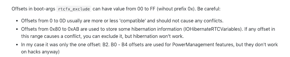

vit9696 Posted January 29, 2019 Author Share Posted January 29, 2019 Somebody needs to write this manual. Finding problematic offset is manual via (sleep or hibernation depending on the machine)/wake/reboot → check BIOS preferences reset cycle. You could always use https://en.wikipedia.org/wiki/Binary_search_algorithm to reduce the number of reboots. @lvs1974 can comment a bit more if absolutely necessary. 1 Link to comment https://www.insanelymac.com/forum/topic/321371-lilu-%E2%80%94-kext-and-process-patcher/page/13/#findComment-2661887 Share on other sites More sharing options...
lvs1974 Posted January 30, 2019 Share Posted January 30, 2019 14 hours ago, Andres ZeroCross said: Any specific thread thread/topic for this?? How can we track a problematic offset?? And what offset should i exclude?? Sorry for bad english You can start with rtcfx_exclude=10-FF for example. Reboot and repeat sleep/wake/shutdown cycles (probably enter into hibernate). If cmos reset issue is not observed any more, you can try rtcfx_exclude=80-FF, the idea is to detect a bank (0D-7F or 80-FF), in the worst case writing into both can cause issues. After you can try to use binary search to reveal an address/range of addresses as small as possible. 2 Link to comment https://www.insanelymac.com/forum/topic/321371-lilu-%E2%80%94-kext-and-process-patcher/page/13/#findComment-2661972 Share on other sites More sharing options...
