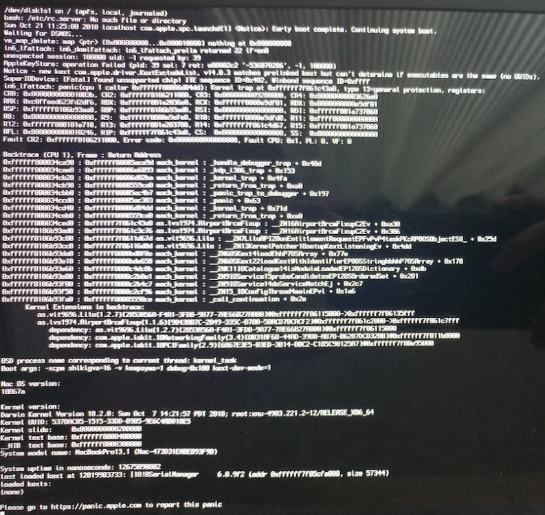

Sherlocks Posted October 21, 2018 Share Posted October 21, 2018 (edited) @lvs1974 hi. today. i got very rare kernel panic of AirportBrcmFixup. here is screenshot. thanks in advance Edited October 21, 2018 by Sherlocks Link to comment https://www.insanelymac.com/forum/topic/321371-lilu-%E2%80%94-kext-and-process-patcher/page/11/#findComment-2642184 Share on other sites More sharing options...
lvs1974 Posted October 21, 2018 Share Posted October 21, 2018 (edited) @Sherlocks, I don't think I can help: __ZN16AirportBrcmFixupC2Ev it is a constructor: __int64 __fastcall AirportBrcmFixup::AirportBrcmFixup(AirportBrcmFixup *this) { IOService::IOService(this, (const OSMetaClass *)&AirportBrcmFixup::gMetaClass); *(_QWORD *)this = off_39F0; return OSMetaClass::instanceConstructed((OSMetaClass *)&AirportBrcmFixup::gMetaClass); } And this constructor is auto-generated, and I have no idea about any reason (except bad kernel/kext cache). One more strange thing: method LiluAPI::onEntitlementRequest is not supposed to create instance of AirportBrcmFixup, it had to only store arguments in entitlementRequestedCallbacks, so backtrace in kernel panic does not look correct. You can try to reproduce this panic using Debug versions of Lilu and AirportBrcmFixu. Edited October 21, 2018 by lvs1974 1 Link to comment https://www.insanelymac.com/forum/topic/321371-lilu-%E2%80%94-kext-and-process-patcher/page/11/#findComment-2642195 Share on other sites More sharing options...
Sherlocks Posted October 21, 2018 Share Posted October 21, 2018 [mention=980913]Sherlocks[/mention], I don't think I can help: __ZN16AirportBrcmFixupC2Ev it is a constructor:__int64 __fastcall AirportBrcmFixup::AirportBrcmFixup(AirportBrcmFixup *this){ IOService::IOService(this, (const OSMetaClass *)&AirportBrcmFixup::gMetaClass); *(_QWORD *)this = off_39F0; return OSMetaClass::instanceConstructed((OSMetaClass *)&AirportBrcmFixup::gMetaClass);} And this constructor is auto-generated, and I have no idea about any reason (except bad kernel/kext cache). One more strange thing: method LiluAPI::onEntitlementRequest is not supposed to create instance of AirportBrcmFixup, it had to only store arguments in entitlementRequestedCallbacks, so backtrace in kernel panic does not look correct. i don't know why kernel panic happen. since i use your driver for long time, i first experienced this issue today. i just got it and report if you improve your driver from it.. also i want to report virtualsmc's battery plugin.battery cycle is not shown properly compare to acpibattery.kext 나의 LG-F800S 의 Tapatalk에서 보냄 Link to comment https://www.insanelymac.com/forum/topic/321371-lilu-%E2%80%94-kext-and-process-patcher/page/11/#findComment-2642196 Share on other sites More sharing options...

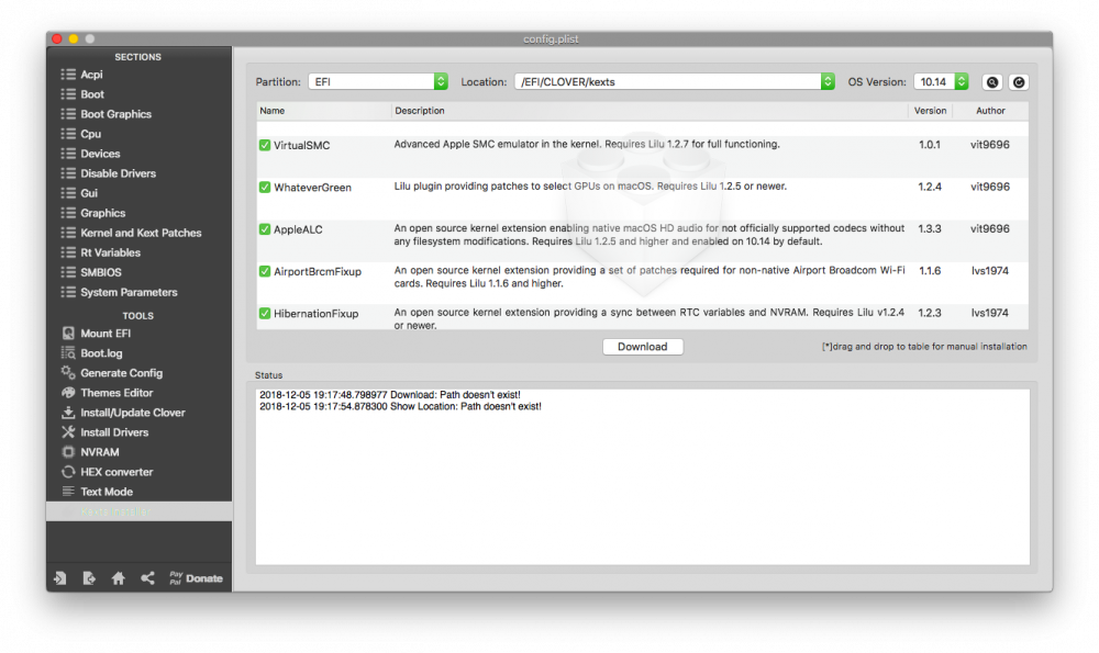

poctox Posted December 5, 2018 Share Posted December 5, 2018 (edited) On 10/4/2018 at 7:07 PM, Kyvaith said: All on ESD partiton: /Volumes/EFI/EFI/CLOVER/kexts/Other/ Clover Configurator has a function to automatically download and put newest kext in there. Like I said, I've tried also downloading Lilu and AppleALC from github releases, and building them from surce, master branch. Hello bro. Can you help me with this issue I've putted lilu.kext and WhateverGreen.kext in /EFI/EFI/CLOVER/Kexts/Others folder. I'm newbie with hackintosh. edit: Solved. Just changing in OS Version to Other. Edited December 5, 2018 by poctox Link to comment https://www.insanelymac.com/forum/topic/321371-lilu-%E2%80%94-kext-and-process-patcher/page/11/#findComment-2652093 Share on other sites More sharing options...

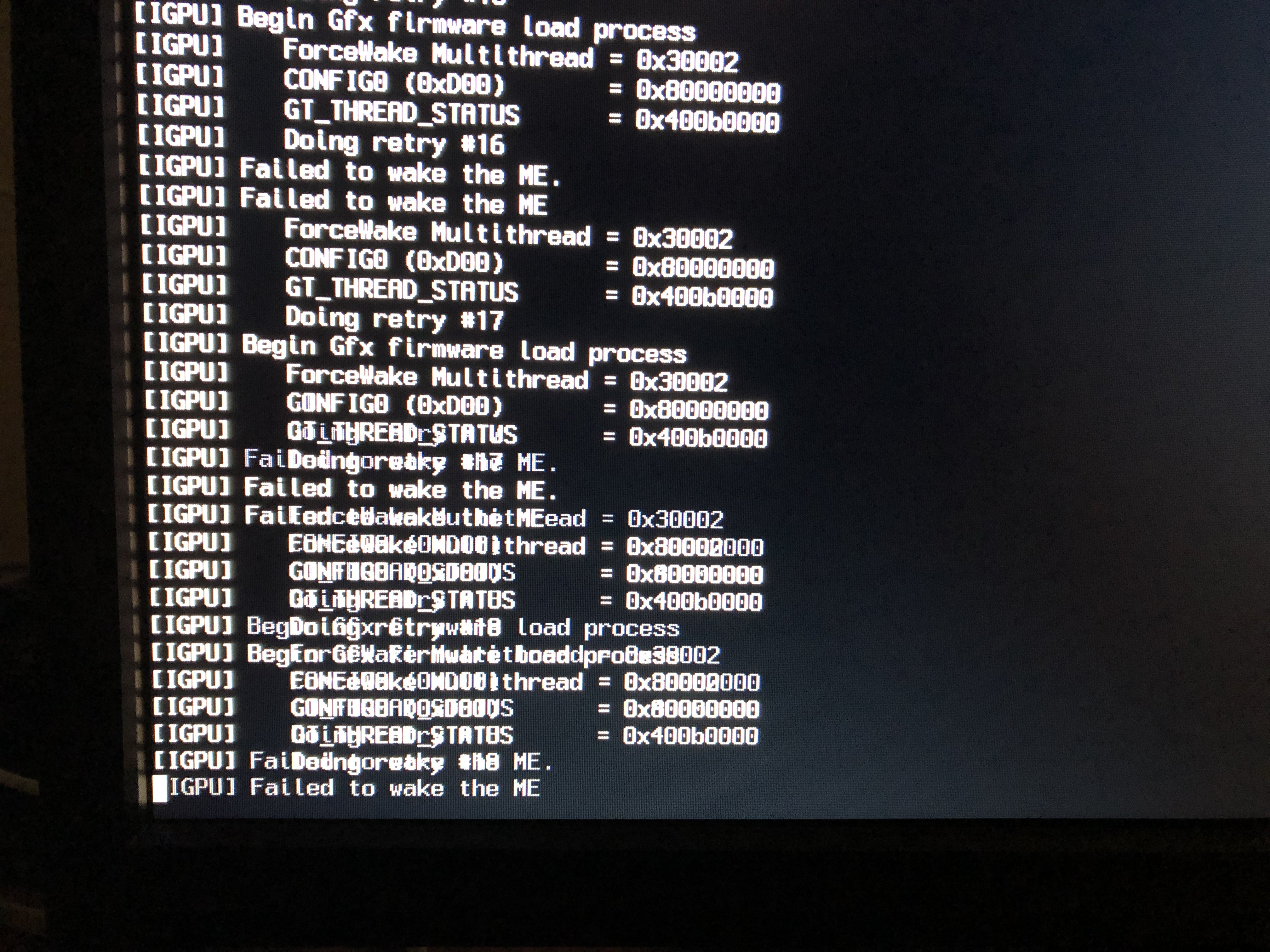

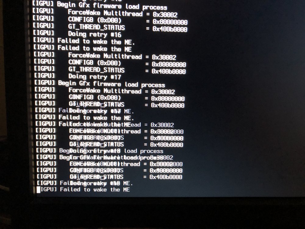

the_gael Posted December 29, 2018 Share Posted December 29, 2018 (edited) Lilu_1.3.0_18.2.txtI am experiencing an issue with Lilu.kext v1.3.0 on my Gigabyte Brix BKi3HA-7100. Using Lilu.kext v1.2.9 all works well When I upgrade to Lilu.kext v1.3.0 the Brix will not boot - am attaching a screenshot of the errors I see when I boot verbose. Edited to add - I am using WhateverGreen v1.2.6 The issue is repeatable and no other change takes place. output from debug log attached. Edited December 29, 2018 by the_gael Additional info Link to comment https://www.insanelymac.com/forum/topic/321371-lilu-%E2%80%94-kext-and-process-patcher/page/11/#findComment-2656336 Share on other sites More sharing options...
vit9696 Posted December 29, 2018 Author Share Posted December 29, 2018 (edited) On the screenshot I would say that WhateverGreen failed to load. You could try to boot into your system with -x or -disablegfxfirmware boot arguments and check the kernel logs why it may be the case. From the top of my head I would suggest file system corruption of the EFI partition or some corrupted download of the latest WhateverGreen. Edited December 29, 2018 by vit9696 Link to comment https://www.insanelymac.com/forum/topic/321371-lilu-%E2%80%94-kext-and-process-patcher/page/11/#findComment-2656367 Share on other sites More sharing options...
the_gael Posted December 29, 2018 Share Posted December 29, 2018 (edited) 3 hours ago, vit9696 said: On the screenshot I would say that WhateverGreen failed to load. You could try to boot into your system with -x or -disablegfxfirmware boot arguments and check the kernel logs why it may be the case. From the top of my head I would suggest file system corruption of the EFI partition or some corrupted download of the latest WhateverGreen. Thank you @vit9696 I updated 3 kexts this morning so will download all again directly from your Github repository and try again. I suspect that a corrupted download may be more likely than a corruption of the EFI partition as the issue is stable, repeatable and reversible i.e. reverting to an earlier version of Lilu.kext fixes the issue. The kexts in question were AirportBrcmFixup, Lilu and WhateverGreen - I will report back on how I get on. Thanks again. Edited To Add: I have downloaded the 3 kexts directly from your Github but the result was the same - using Lilu.kext v1.3.0 with either the latest or previous versions of AirportBrcmFixup.kext or WhateverGreen.kext cause my machine to not boot. I inserted a different SSD which was using Lilu.kext v1.2.8, and previous versions of the other two kexts - it works perfectly but if I update to latest version of Lilu.kext v1.3.0 I get the same failure to boot. I tried booting in safe mode and also with -disablegfxfirmware but neither option will allow me to boot. I do however have Lilu.kext v1.2.9 in EFI/Clover/Kexts/Other and so I booted using the option to boot with injected Kexts after pressing spacebar. Edited December 29, 2018 by the_gael Link to comment https://www.insanelymac.com/forum/topic/321371-lilu-%E2%80%94-kext-and-process-patcher/page/11/#findComment-2656376 Share on other sites More sharing options...
