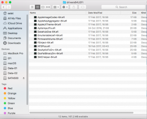

  3. Reboot back into the System, mount the EFI partition, copied the AptioInputFix.efi to the drivers folder (see Pic1), reboot again

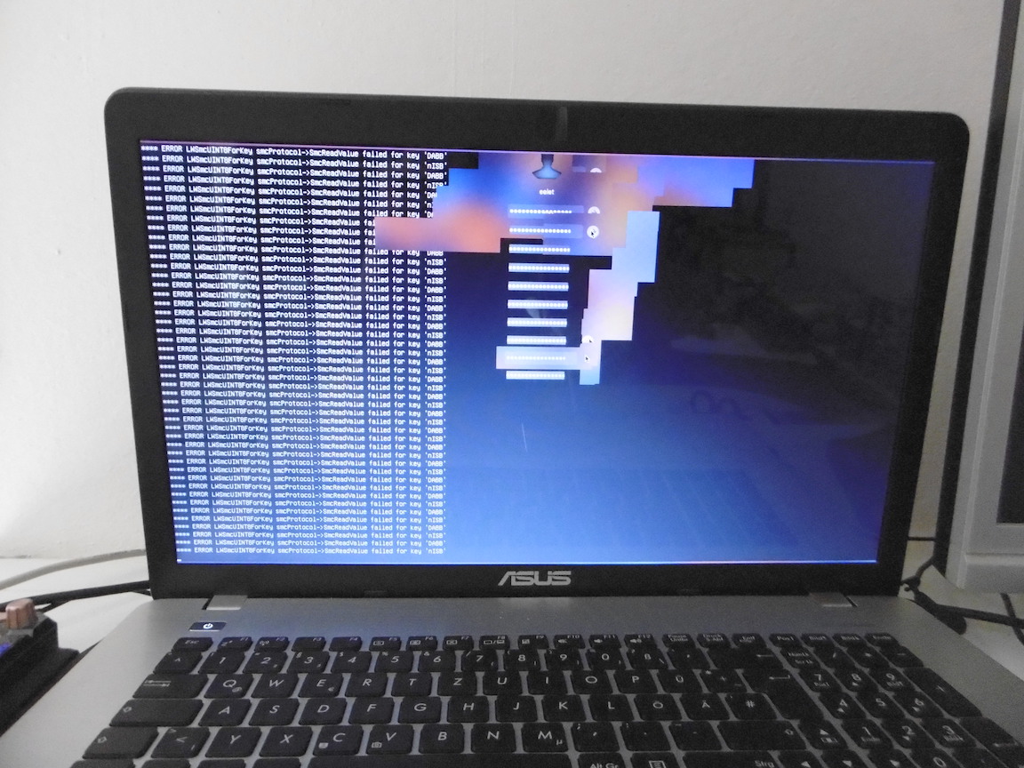

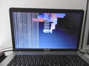

  4. Enable Filevault2, system goes for a reboot but then it crashes and get this stop sign thingy.... (i booted with -v for log) (see Pic2 + 3)
From googling i think it is some typ of USB issue. I tried booting with the keyboard (Original Apple USB Keyboard) in different USB ports and always rebooted, but nothing worked.
Any ideas?

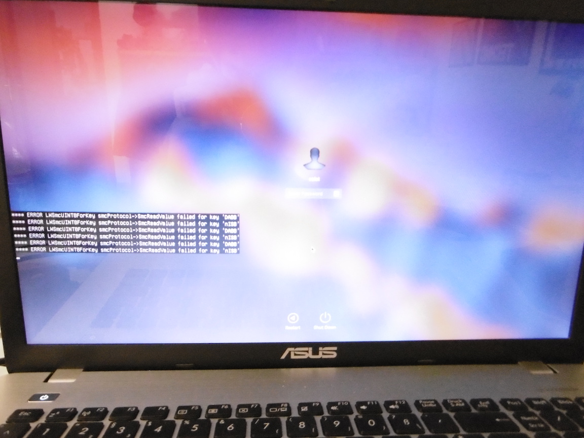

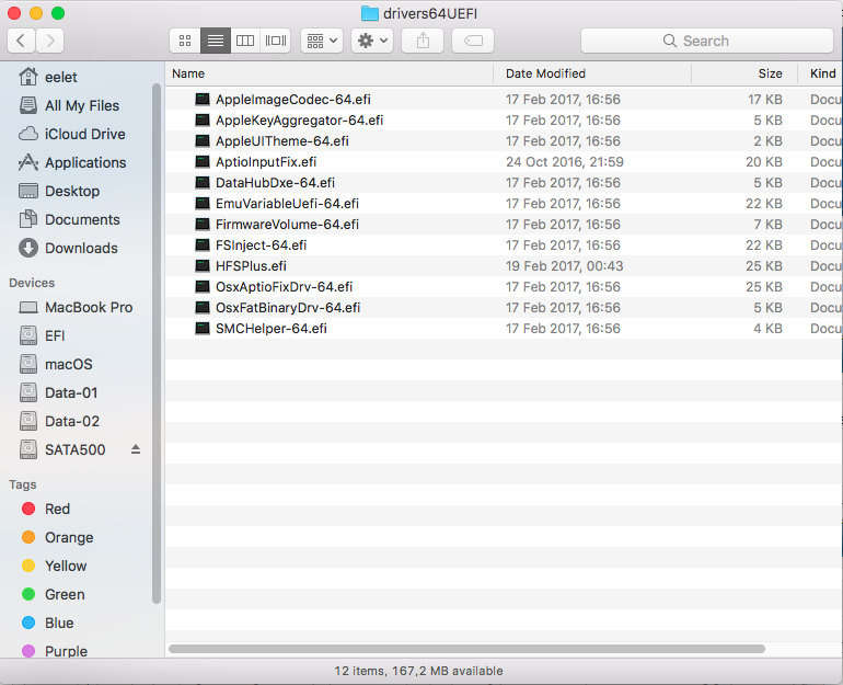

Hi everyone, i succesfully enabled FV2 on my Asus F750LN Notebook (from Signature), I'm currently running Clover 2.4k r4012, i post also a screenshot of my drivers64UEFI folder. It works all pretty good, except i get some graphical issues (e.g. debug code) into the Login Screen. Can you help me to solve it please? I can currently access to macOS, however i found some bugs in AptioInputFix (Inverted CMD button, when i insert my password i have to Release Shift Key to get Upper-Case chars and i have to insert it very slowly because double-letters don't works if i do it fast). So i can accept this bugs, but what means is to solve these Graphical Issues on Login Screen. Secure boot is enabled in uefi and works with no problem. You made a very good work! Congrats guys :D
Is there any chance to fix the issue?
Try to boot without verbose and without KextPatches debug.
I don't remember why the messages was appeared and I have no more testing machine.
Ok with no verbose on boot i don't get this messages on FV2 Login Screen, hovewer is there a Graphical Issue after i insert my password, but i can accept this as compromise. You know if the KextPatches for IntelFrameBufferAzul are the same between El Capitan and Sierra? Maybe it can depends from it?
That graphical issue exists on real Macs too IMHO.
You could use following kext patch, which helped me in Sierra:
<dict>
	<key>Comment</key>
	<string>Boot screen fix</string>
	<key>Find</key>
	<data>AQAAdSU=</data>
	<key>Name</key>
	<string>IOGraphicsFamily</string>
	<key>Replace</key>
	<data>AQAA6yU=</data>
</dict>
Thanks smolderas, i try it now and i come back to report! :D
EDIT: Always same graphical issue after password insert, no debug codes but the background of Sierra become like a mosaic, however when it loads and i enter on macOS no problems!
