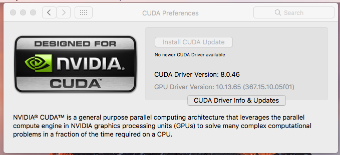

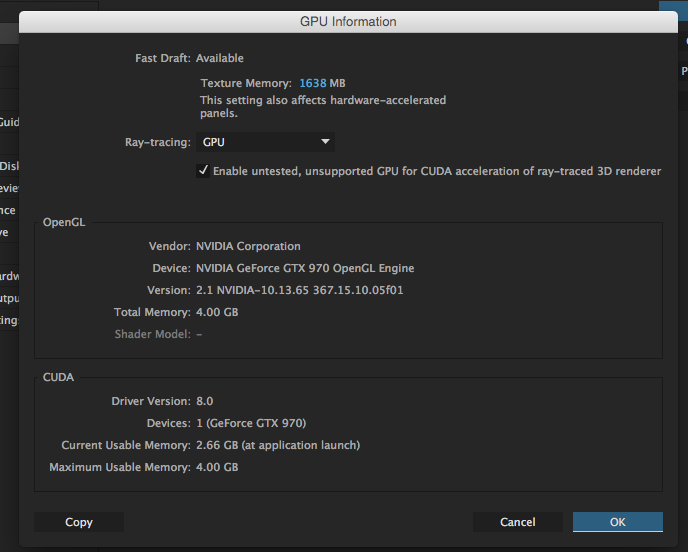

Fixed unsupported GPU Error After Effects with CUDA
1-Install Cuda
2-Edit  to raytracer_supported_cards.txt
Just add your device on top

Fast Draft: Available
 Texture Memory: 1638.00 MB
Ray-tracing: GPU
OpenGL
Vendor: NVIDIA Corporation
Device: NVIDIA GeForce GTX 970 OpenGL Engine
Version: 2.1 NVIDIA-10.13.65 367.15.10.05f01
Total Memory: 4.00 GB
Shader Model: -
CUDA
Driver Version: 8.0
Devices: 1 (GeForce GTX 970)
Current Usable Memory: 2.66 GB (at application launch)
Maximum Usable Memory: 4.00 GB

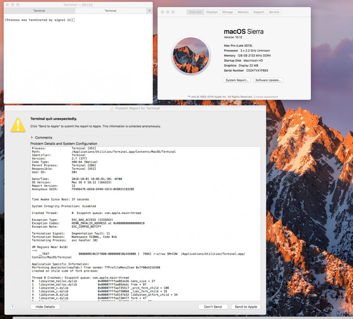

I was wondering if you can take a look at mine too, for dual CPU?
I keep getting kernel panic with 121 CPUS but when i shut off hyper treading I got 120 and can pass on to installation screen. I've tried playing with the DSDT and found SCK0-04 and not sure if thats responsible for passing wrong information to the kernel.
Thanks a lot,
Here is the original ACPI dump from clover.
origin.zip
Gimme a few min I'll test it out
Same thing.
Panic with hyper on:
And without:
What really confuses me is that between those two the first one have the double amount of processor ids, but what's funny is that I think os thinks we are in 2040 with 120 core cpus.
Can this be the dsdt issue?

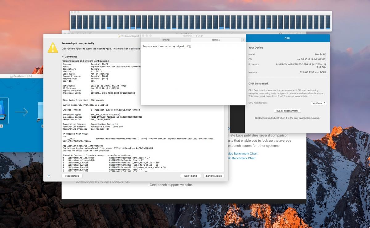

on the side note, after I've managed to install, i get this, Terminal failes to open and GeekBench doesn't know what architecture it is running on.
Oh and on this board I have to specify the amount of memory I've got in the SMBIOS section otherwise it only detects 32gb out of 128.
when you boot without hyper threading
What is displayed in "About This Mac"?
It show 2x the cpu but unknown, I'm working on installing it again, will have the screen shot the moment I'm on the system, but the problem is even with the hyper threading off, the system is unworkable, can't access terminal, and gets some random kernel crashes time to time. I've tried tweaking DSDT with the X99 patches and removing extra CPU stuff from it, but no luck.
