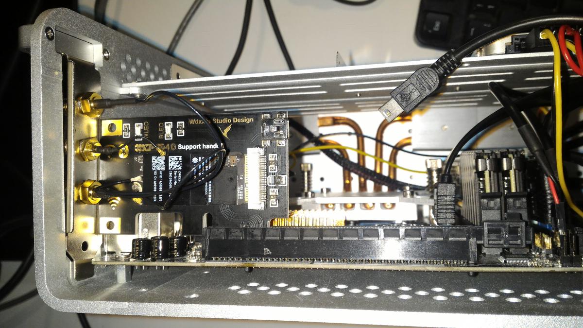

bakerman1971 Posted December 16, 2016 Share Posted December 16, 2016 Hi Denicio Yes OOB is what we got it for many thanks for your help the wifi on the card is working fine, just the Bluetooth so I shall go and see what I can organise As for fitting it on the board, with the streacom case there is one pack plane for a single half heigh pci-e card, the 1x card fits in the 16x slot just fine, have done this lots in the past with smaller cards in different configurations of pc's. Will post here if it is anything related to the ASRock setup Cheers Bakerman 1 Link to comment https://www.insanelymac.com/forum/topic/312085-guide-macos-sierra-1012x-on-asrock-h170m-itxac/page/8/#findComment-2335332 Share on other sites More sharing options...
Denicio Posted December 16, 2016 Author Share Posted December 16, 2016 Hi Denicio Yes OOB is what we got it for many thanks for your help the wifi on the card is working fine, just the Bluetooth so I shall go and see what I can organise As for fitting it on the board, with the streacom case there is one pack plane for a single half heigh pci-e card, the 1x card fits in the 16x slot just fine, have done this lots in the past with smaller cards in different configurations of pc's. Will post here if it is anything related to the ASRock setup Cheers Bakerman Sounds very interesting, would love to see photos at some point. Link to comment https://www.insanelymac.com/forum/topic/312085-guide-macos-sierra-1012x-on-asrock-h170m-itxac/page/8/#findComment-2335335 Share on other sites More sharing options...

bakerman1971 Posted December 16, 2016 Share Posted December 16, 2016 Hi Denicio Quick update your comments prompted me to think that maybe there was an issue with the internal USB header, routed a cable outside the case to one of the other usb ports and BAM Bluetooth up and running. Now I got to work out why the internal ports suddenly stopped being picked up. Cheers for all the help and of course seasons greetings all Bakerman 1 Link to comment https://www.insanelymac.com/forum/topic/312085-guide-macos-sierra-1012x-on-asrock-h170m-itxac/page/8/#findComment-2335350 Share on other sites More sharing options...
Denicio Posted December 16, 2016 Author Share Posted December 16, 2016 Hi Denicio Quick update your comments prompted me to think that maybe there was an issue with the internal USB header, routed a cable outside the case to one of the other usb ports and BAM Bluetooth up and running. Now I got to work out why the internal ports suddenly stopped being picked up. Cheers for all the help and of course seasons greetings all Bakerman That's the spirit of hackintosh right there! Link to comment https://www.insanelymac.com/forum/topic/312085-guide-macos-sierra-1012x-on-asrock-h170m-itxac/page/8/#findComment-2335352 Share on other sites More sharing options...

bakerman1971 Posted December 22, 2016 Share Posted December 22, 2016 Hi Denicio as requested here is a picture of the card sitting in the x16 slot it's a bit of a hack-job because the backplate that comes with the card is full-size, so we had to modify the blanking plate with three antenna holes, I use stickypads to hold it in place only because the rear bracket is not attached oh and the USB cable supply is no that cable that's not yet connected, this goes to the internal usb front panel connector on the motherboard, keeping things tidy. I also fixed the no Bluetooth issue, I tried connecting an external USB port to the card and it showed up, then when reconnecting the internal ports it carried on working. Very strange. Link to comment https://www.insanelymac.com/forum/topic/312085-guide-macos-sierra-1012x-on-asrock-h170m-itxac/page/8/#findComment-2338367 Share on other sites More sharing options...
Denicio Posted December 22, 2016 Author Share Posted December 22, 2016 Hi Denicio as requested here is a picture of the card sitting in the x16 slot it's a bit of a hack-job because the backplate that comes with the card is full-size, so we had to modify the blanking plate with three antenna holes, I use stickypads to hold it in place only because the rear bracket is not attached oh and the USB cable supply is no that cable that's not yet connected, this goes to the internal usb front panel connector on the motherboard, keeping things tidy. I also fixed the no Bluetooth issue, I tried connecting an external USB port to the card and it showed up, then when reconnecting the internal ports it carried on working. Very strange. Very hacky, that's some build you got there, keep it up! Link to comment https://www.insanelymac.com/forum/topic/312085-guide-macos-sierra-1012x-on-asrock-h170m-itxac/page/8/#findComment-2338385 Share on other sites More sharing options...
