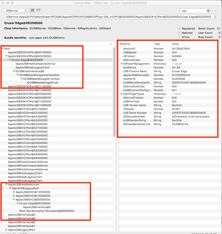

I had a few minutes to poke and play around with El Capo 10.11.2 USB kext.   For those with USB loop hell, could you try the attached kext and replace the same kext in S/L/E to see if it makes any difference?  Remove all USB related patched kexts (if any) and your USB kexts should be as Vanilla as possible.  As usual, you'll need to repair permission and rebuild kext caches after applying the attached kext.  Please report your findings.
IOUSBHostFamily.kext.zip
  • Like 3

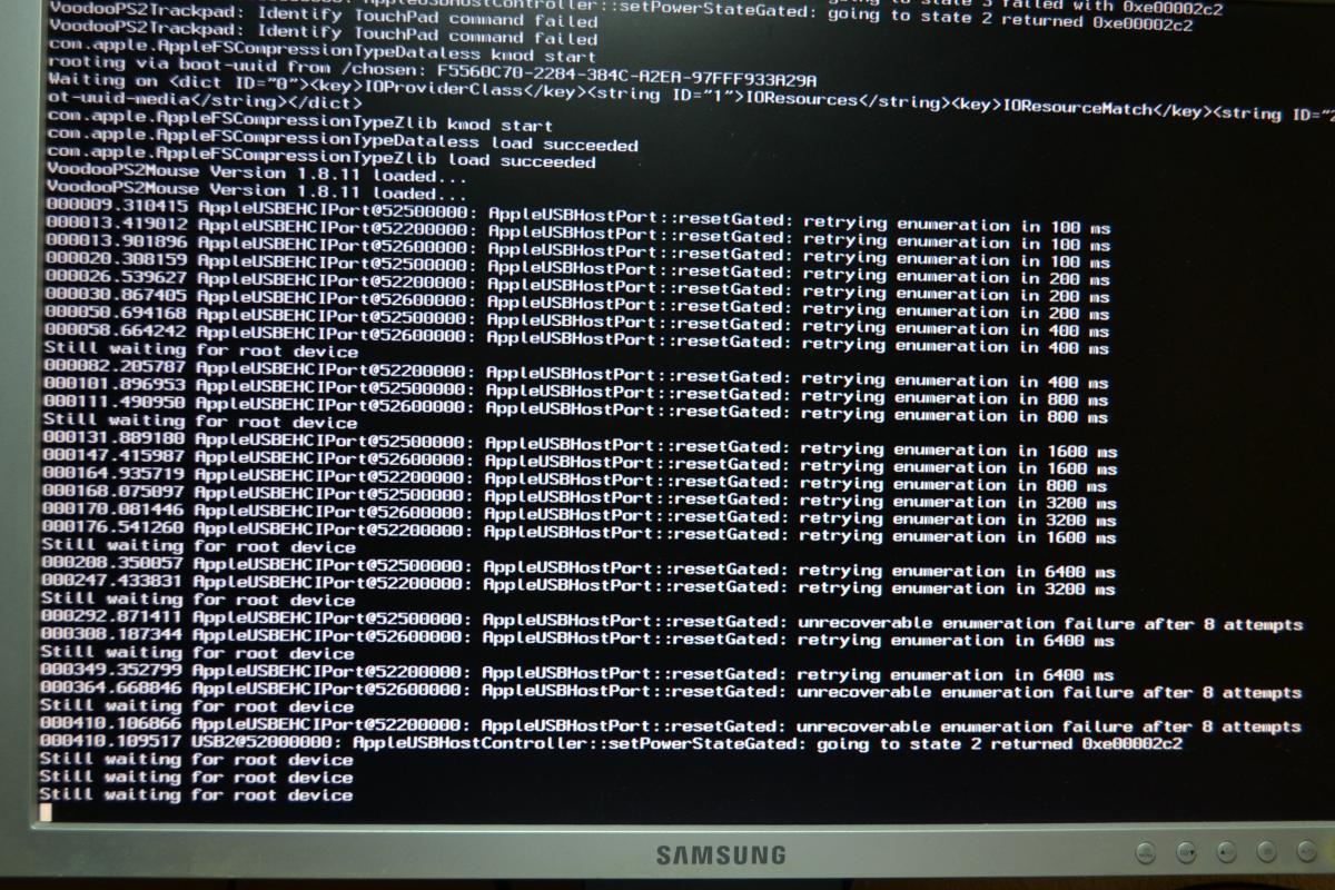

The error messages are partially suppressed at boot time. :)
  However, the USB problems remain. Only Mouse and keyboard are active. ^_^
Edited by spakk
Still USB boot loop or not?  All available USB2/3 not working?
Hope to come!  :D

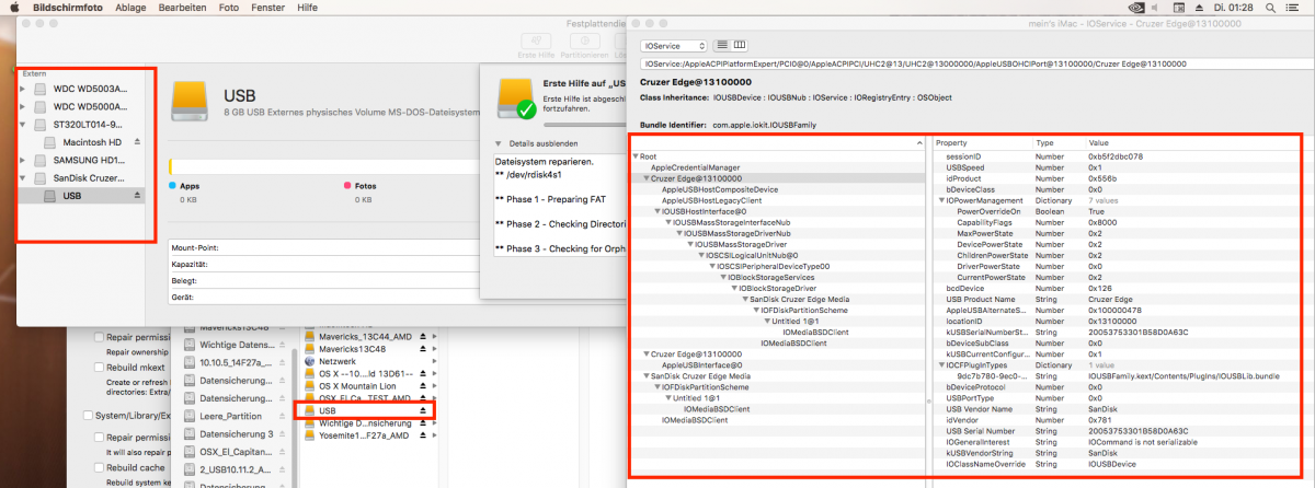

But this is the first time that, I recognize my USB Stick (Cruzer ScanDisk) in ioreg-file,  see iojones reg file
I wanted to upload a few pictures, then my system crashed.
