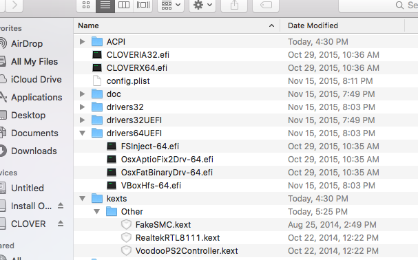

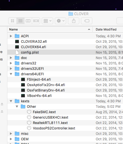

I have succesfully removed GenericUSBXHCI.kext from my usb stick and it's still booting fine!
So now the only thing I have different from your installation is the config.plist file.
I think there's some entry in your config.plist for 1366x768 that are not needed. Also, when I removed xcpm from the boot option, it booted to a kernel panic.
Edit 2 : Here's my working config without useless kexts

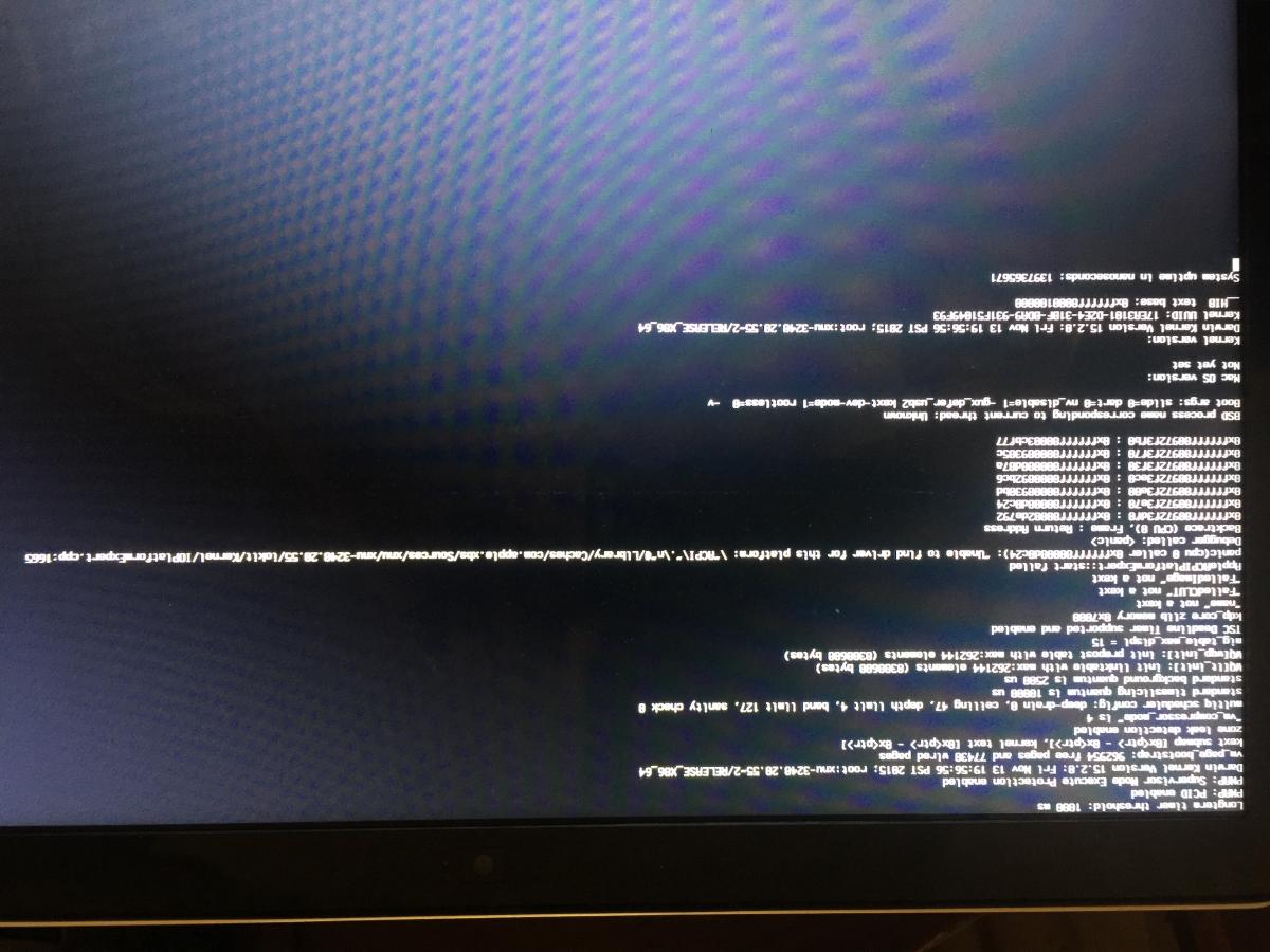

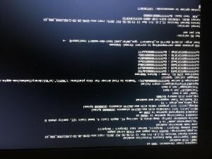

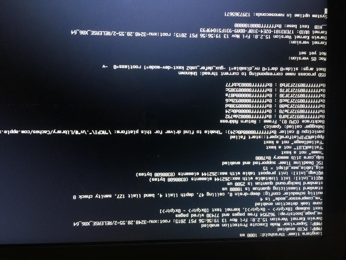

Hi, Ive got a Sony Vaio SVF15212CXW (full specs are here http://www.cnet.com/products/sony-vaio-fit-15e-svf15212cxw-15-5-core-i3-3227u-windows-8-64-bit-4-gb-ram-500-gb-hdd-qwerty/specs/)
I did everything as you told and got a kernel panic until I deleted the patched folder from the EFI. Screenshots of the verbose bootleg with kernel panic are attached.
What shall I do with my DSDT and SSDT then?

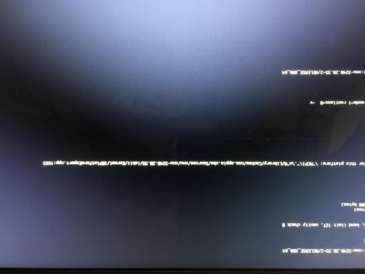

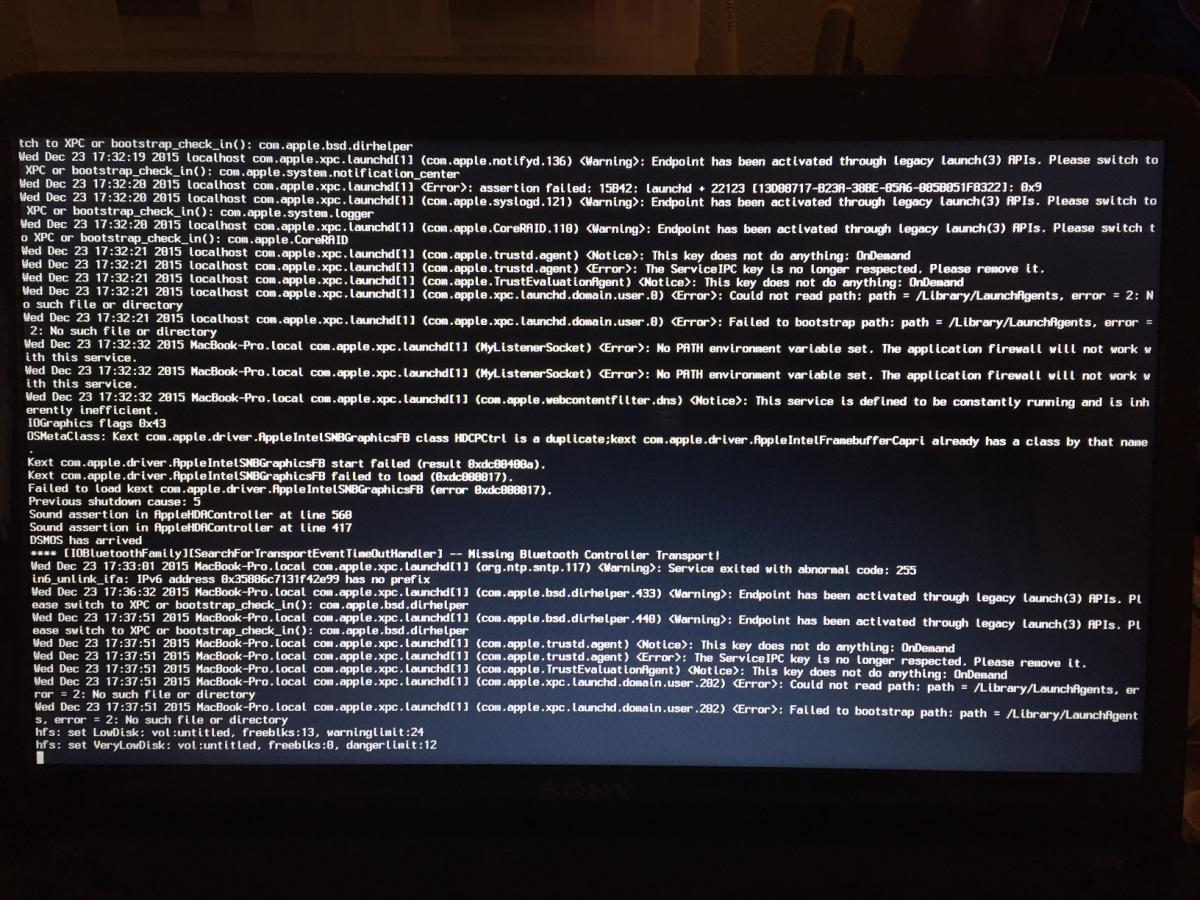

Hi everyone. I have tried with Sony Vaio SVE1512C6EW but it stuck in the apple load screen with bar complete. USB 32 gb following this method. When I tried in verbose mode it stuck in:
hfs: set VeryLowDisk: vol:untitled, freeblks:0, dangerlimit:12
I followed the instructions very carefully, but it stucks there. I used the screen resolution 1366x768 config.plist.
Any ideas?
Thanx in advance.
That happens to me too, just leave it for a while, it will spin down, it's not harmful or anything, I've had it on windows too.
@riffrico something weird there is SNB driver (gpu driver for intel 1st gen), either your specs are old (cuz this guide is mostly for 3rd gen cpus) or your config.plist is misleading the os, or your installer is corrupted (remake it as the guide states exactly, if still the same, redownload the installer again).
Other than that, make sure there is no ssdt/dsdt in patched folder

Hi midi, thanx for reply. Specs stuff: Pentium B980 / 2.4 GHz, Graphic Integrated Intel (2nd Generation Core Processor Family Integrated Graphics Controller), network AR9485 Wireless Network Adapter Atheros. Maybe cpu is too old for El Capitan. Anyway, and happy Xmas.
As I expected, Pentium's GPUs wont work on OS X, you have to patch the graphic kexts (donno if there are and donno if it works), or the best thing is to buy a whole new laptop with at lease i3 for a compatible GPU.
