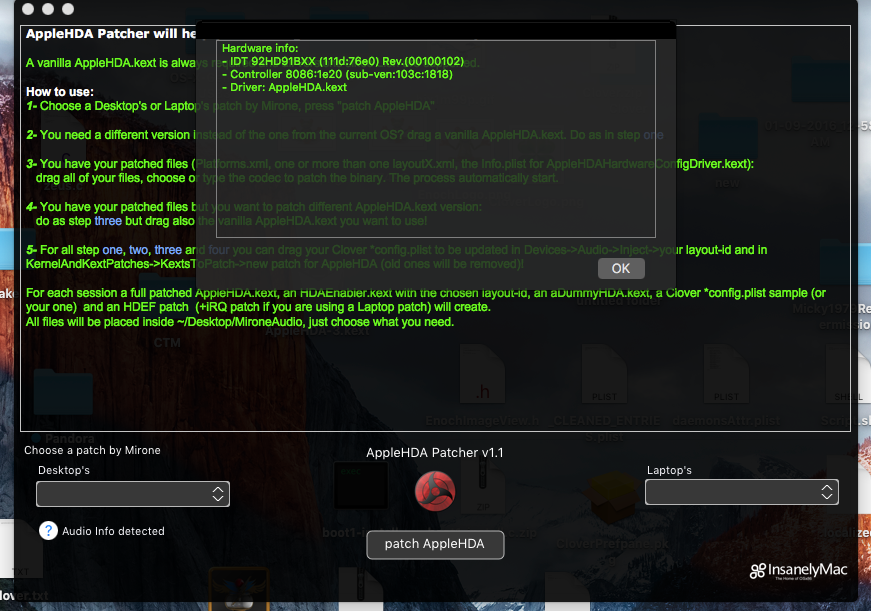

I do not want to insist, but the same happen on a HP ENVY dv6-7200sl with the codec IDT92HD91BXX. Working fine with the kext renamed Dummy. Tried to install the aDummy and performed:
sudo kextcache -system-prelinked-kernel
sudo kextcache -system-caches
without success. Can you point to what we are doing wrong?

Mee too I don't want insist, but I have the same exactly laptop  :P (mine is a DV7 but same motherboard):
103c:1818 same identical motherboard, same identical codec
My lappy lose audio after each update because I use CsrActiveConfig= 0x00, so when the cache is rebuilt by the Apple update untrusted kexts (like aDummyHDA.kext) is not allowed.
So I need to change  CsrActiveConfig to 0x03 and reboot, then rebuild a new prelinkedcache, than reboot again and the audio works again. This does not happen if I leave SIP disabled, but me I want security fully enabled.

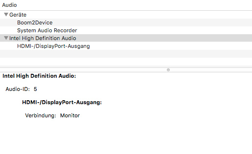

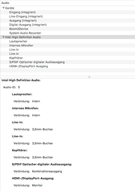

I managed to get everything working with my ALC662 codec, thank you so much for that!
I am using a DSDT edit to inject layout-id 5 in HDEF, the KextsToPatch section in Clover and the aDummy file,
unfortunately I do have the problem that audio is only available approximately every second boot
system profiler when audio is unavailable:
system profiler when audio is available:
this seems to be random between reboots to be working or not working,
do you have any advices or hints?
Cheers!

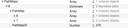

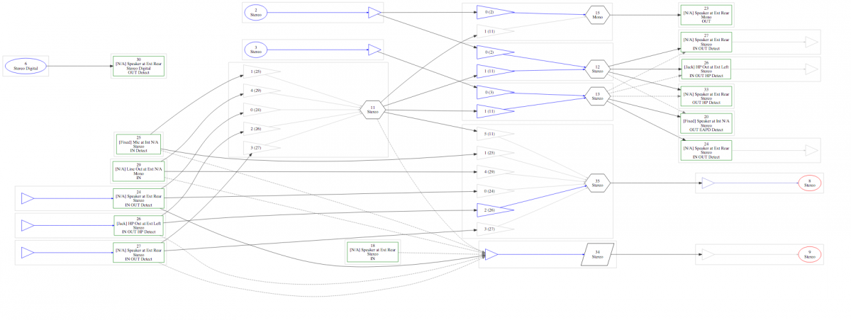

Hello Mirone, I have Alc270, I tried the patcher in 10.11.3. Headphones are not working anymore. I tried to modify PathMaps and was able to make them work but then internal mic disappeared and I have speaker as input (?). This was done by modifying the pathc 33-12-2 to 26-12-2.
I don't understand something regarding the Platforms.xml and pathmaps. Could you explain?
In this pictures we have two arrays 0 and 1
under 0 I can see the path for internal speaker output 9-34-18.
Under 1 I can see paths for speaker out EAPD 20-13-3 and Speaker Out HP Detect 33-12-2
So as far as I can understand headphones should be recognized when plugging but that doesn't happen.
Also what is the role in those speaker paths of MuteInputAmp (NO) and VolumeInputAmp (NO)? In the speaker output (9-34-18) they are both set to YES, why?
Should I add some paths given this structure? Where? What should I set for MuteInputAmp and VolumeInputAmp?
Is there anybody that can explain apart Mirone?
Thanks
For Those insterested, I managed to have the headphones working again with the conf in the picture above. ComboJack mic still not working, I don't know how.
What I did was remove the 33-12-2 pathmap and replace it with 26-12-2
