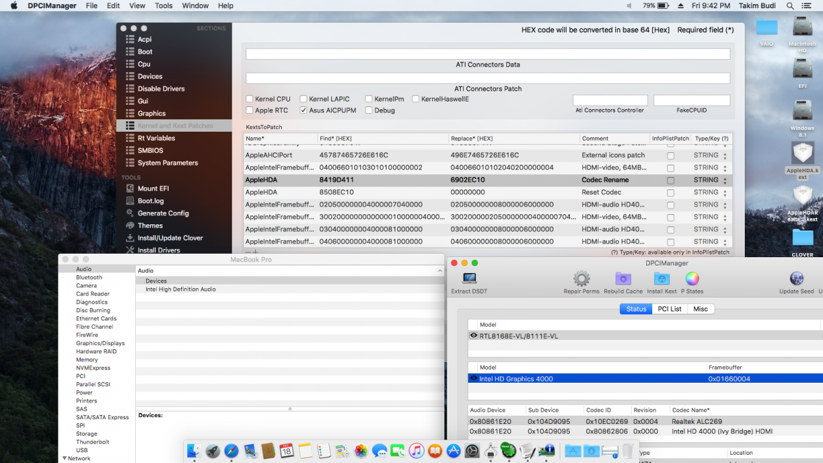

Andres ZeroCross Posted December 18, 2015 Share Posted December 18, 2015 Hi mirone,, I have this codec audio with Sony Vaio,, i try using AppleHD Patcher.app and select ALC269 AIO. Then i try layout id from 1 to 7 but no result.Does appleHDA Patcher.app support this codec revision???Thanks before Link to comment https://www.insanelymac.com/forum/topic/309441-new-applehda-patcher/page/7/#findComment-2198561 Share on other sites More sharing options...
Mirone Posted December 18, 2015 Author Share Posted December 18, 2015 Have you tried other versions? has DSDT with patch Applied IRQs? Link to comment https://www.insanelymac.com/forum/topic/309441-new-applehda-patcher/page/7/#findComment-2198564 Share on other sites More sharing options...
Andres ZeroCross Posted December 18, 2015 Share Posted December 18, 2015 Yes, i have patch my DSDT with IRQ from Your AppleHDA Patcher.app. It looks same like rehabman patcher right???I tried only with ALC269 AIO, ALC269VC and ALC269VB are for Desktop right??? I get the info from your Apple HDA Patcher.app Correct me if i was wrong Link to comment https://www.insanelymac.com/forum/topic/309441-new-applehda-patcher/page/7/#findComment-2198565 Share on other sites More sharing options...
Mirone Posted December 18, 2015 Author Share Posted December 18, 2015 Yes, i have patch my DSDT with IRQ from Your AppleHDA Patcher.app. It looks same like rehabman patcher right??? I tried only with ALC269 AIO, ALC269VC and ALC269VB are for Desktop right??? I get the info from your Apple HDA Patcher.app Correct me if i was wrong ALC269 only for Laptops. Link to comment https://www.insanelymac.com/forum/topic/309441-new-applehda-patcher/page/7/#findComment-2198577 Share on other sites More sharing options...
mendietinha Posted December 18, 2015 Share Posted December 18, 2015 Yes, i have patch my DSDT with IRQ from Your AppleHDA Patcher.app. It looks same like rehabman patcher right??? I tried only with ALC269 AIO, ALC269VC and ALC269VB are for Desktop right??? I get the info from your Apple HDA Patcher.app Correct me if i was wrong hi. try this dummy with layout id 3 on dsdt and copy the info about applehda, Expect 2 matches... to your config.plist in the correct section. first install the vanilla applehda. install dummy in s/l/e. repair permitions and caches... tell me if it works. D.rar Link to comment https://www.insanelymac.com/forum/topic/309441-new-applehda-patcher/page/7/#findComment-2198584 Share on other sites More sharing options...
Andres ZeroCross Posted December 18, 2015 Share Posted December 18, 2015 Thanks,, i am trying. hi. try this dummy with layout id 3 on dsdt and copy the info about applehda, Expect 2 matches... to your config.plist in the correct section. first install the vanilla applehda. install dummy in s/l/e. repair permitions and caches... tell me if it works. Can you zip it please Sorry for trouble,, I just need to downloard archiver from App Store,, i am installing right now No device output totally at System Report Link to comment https://www.insanelymac.com/forum/topic/309441-new-applehda-patcher/page/7/#findComment-2198586 Share on other sites More sharing options...
mendietinha Posted December 18, 2015 Share Posted December 18, 2015 if you did all right, then it must be another variant from the 269. mine was very hard to find a fully working one. please check if the dummy is indeed in the kernelcache along with the original untouched applehda from the system. if one step is not done properly, the dummy will not work. Link to comment https://www.insanelymac.com/forum/topic/309441-new-applehda-patcher/page/7/#findComment-2198629 Share on other sites More sharing options...

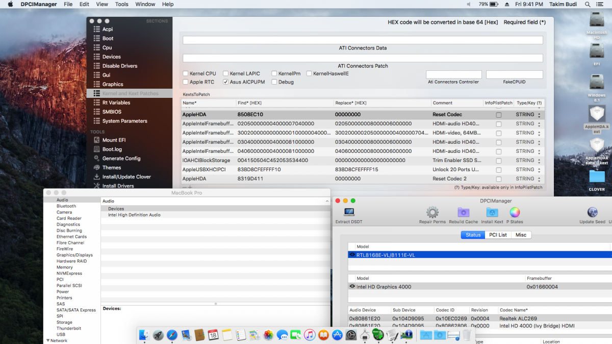

Andres ZeroCross Posted December 19, 2015 Share Posted December 19, 2015 And #106 Off course At my DSDT there is no OEM DSM for HDEF,, so i don't need to drop OEM DSM of HDEF I try with Ineject Layout id from Config.plist and DSDT too. voilat: #79 Can I have a complete dump of all your ACPI tables, original and patched (if any)? ..just to take a look Sorry for late reply,, at last i can activate internal speaker with file from @Mendietinha, but no Input Devices hi. try this dummy with layout id 3 on dsdt and copy the info about applehda, Expect 2 matches... to your config.plist in the correct section. first install the vanilla applehda. install dummy in s/l/e. repair permitions and caches... tell me if it works. Thank for you file, after make some change i can activate my internal speaker but no input Devices All, this is what i do to Mendietinha's file 1. I make "DummyKext" but only contain info.plist that contain "HDAConfigDefault / PinConfig" and i get this values from Mendietinha's file 2. I make manual patch on the fly at Clover 3. I took Layout3.xml.zlib and Platform.xml.zlib from Mendietinha's file and change into Layout3.zml.zlib and Platforms.zml.zlib then i put in this file to "AppleHDA.kext/Contents/Resources" and reinstall this kext. 4. Take a reboot, and my internal speaker work. But no input Devices. I always do this thing for all Mirone's file at "AppleHDA for Yosemite" so i can keep S\LE\ vanilla. (just AppleHDA that contain patched Layout and platform with different extension). Credit to Miron, Axbite, and other. So, for ALC269 revision 0x0004 is use different node, my i ask Mirone or Mickey to input this revision to your AppleHDAPatcher.app?? And can i ask Codec_dump.txt from you @Mendietinha?? I need to check Internal Mic Sorry all for my bad english,, This is my file ALC269 Revison 0x0004.zip Link to comment https://www.insanelymac.com/forum/topic/309441-new-applehda-patcher/page/7/#findComment-2198969 Share on other sites More sharing options...
