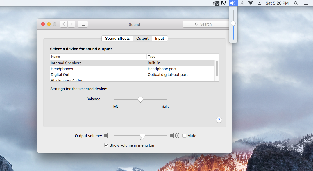

nmano Posted February 27, 2016 Share Posted February 27, 2016 I don't this version still make crackling sound at high bass music Edit : Ok,, i found temporary solution. I need to decrease volume from System Preference 1/3 bars. And it give me good quality bass music. But you can see,, Volume Icon bar and System Preference are not synchronize I upload my config.plist check yours.. Volume Icon bar and System Preference worked well for me. 1.zip Link to comment https://www.insanelymac.com/forum/topic/309283-creative-ca0132-g1sniper-m3-patch-for-applehda-or-voodoohda/page/8/#findComment-2219016 Share on other sites More sharing options...

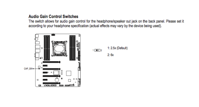

nmano Posted February 28, 2016 Share Posted February 28, 2016 Anybody try this switch Link to comment https://www.insanelymac.com/forum/topic/309283-creative-ca0132-g1sniper-m3-patch-for-applehda-or-voodoohda/page/8/#findComment-2219231 Share on other sites More sharing options...

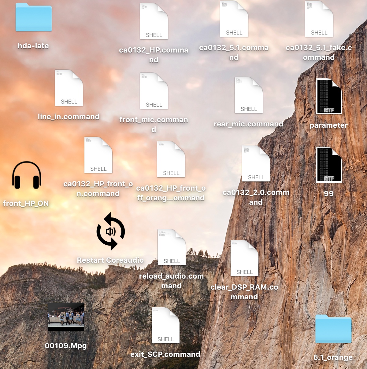

wern apfel Posted March 12, 2016 Author Share Posted March 12, 2016 Someone with working sound after wakeup from sleep, without codeccommander ? Because of lack of time i've not doing any tests last weeks, but after the last researches it seems to work properly with 6 discrete channels. We can do a lot of things, such as enable and disable the amplifiers, switch from front HP to rear orange jack (also with amplifier on the orange jack), remap the DACs, fake surround (2 channel files gives you output on 6 channels), front microphone, but is not fully tested. All this can be done on the fly without a restart. Also went away from soft volume for better sound quality. But i'm not sure if you want to control a simply codec in this way. So i will try to make a little app to do that, unfortunately i've never programmed something from scratch, i'm afraid i need some help from the programmers here. AppleHDA.kext_6ch_no_fr_HP.zip Set layout-id to 0, remove voodoohda, applehdadisabler, ca0132 kexts, clover on the fly patch for the codec-id (x99 users should use toleda's HDA controller patch), repair permissions, rebuild cache. This kext has working output on the green rear jack auto switch with rear HP, rear black and orange jacks, no front HP. If you don't use 5.1 and need front HP i will upload another kext with working front HP jack Link to comment https://www.insanelymac.com/forum/topic/309283-creative-ca0132-g1sniper-m3-patch-for-applehda-or-voodoohda/page/8/#findComment-2222960 Share on other sites More sharing options...

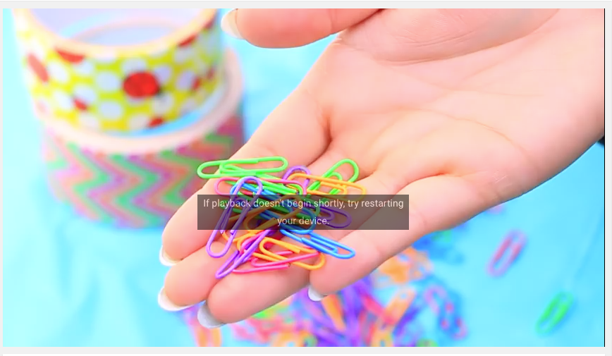

nmano Posted March 26, 2016 Share Posted March 26, 2016 youtube not work 10.11.4 Anybody have this issue? if playback doesn't begin shortly try restarting your device Link to comment https://www.insanelymac.com/forum/topic/309283-creative-ca0132-g1sniper-m3-patch-for-applehda-or-voodoohda/page/8/#findComment-2227510 Share on other sites More sharing options...
