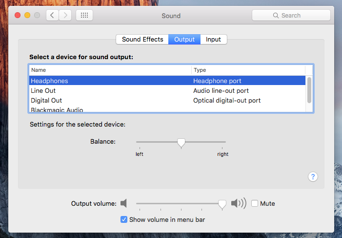

wern apfel Posted February 3, 2016 Author Share Posted February 3, 2016 my audio and volume control are working but when I connect a headphone, the headphone is not detected Does it switch to headphone @audio PrefPane?, have you tried the old kext ?, there are two headphone nodes we have to try both Creative Sound Blaster does it work with appleHDA Is the device-ID the same, can we see a codec dump ?, does it work with voodooHDA ? Link to comment https://www.insanelymac.com/forum/topic/309283-creative-ca0132-g1sniper-m3-patch-for-applehda-or-voodoohda/page/7/#findComment-2212940 Share on other sites More sharing options...
Luminadevapps Posted February 3, 2016 Share Posted February 3, 2016 3 Ports worked 2CH with VC Microphone Headphone Output CA0132.zip 1 Link to comment https://www.insanelymac.com/forum/topic/309283-creative-ca0132-g1sniper-m3-patch-for-applehda-or-voodoohda/page/7/#findComment-2212984 Share on other sites More sharing options...
Rocky12 Posted February 3, 2016 Share Posted February 3, 2016 i don,t know about device id but it has the same chip CA0132 Link to comment https://www.insanelymac.com/forum/topic/309283-creative-ca0132-g1sniper-m3-patch-for-applehda-or-voodoohda/page/7/#findComment-2213051 Share on other sites More sharing options...
abdouoi Posted February 3, 2016 Share Posted February 3, 2016 Does it switch to headphone @audio PrefPane?, have you tried the old kext ?, there are two headphone nodes we have to try both After installing the second 2channels kext (the one with sound quality) it's working! thanks! Link to comment https://www.insanelymac.com/forum/topic/309283-creative-ca0132-g1sniper-m3-patch-for-applehda-or-voodoohda/page/7/#findComment-2213112 Share on other sites More sharing options...

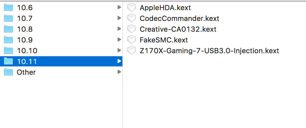

sssteve Posted February 20, 2016 Share Posted February 20, 2016 Ok, So I followed all the instructions and tried the id:9 and got no sound. Everything works if my id is 2 except for volume. My motherboard is a Z170X-gaming7 Any ideas ? Thanks! Link to comment https://www.insanelymac.com/forum/topic/309283-creative-ca0132-g1sniper-m3-patch-for-applehda-or-voodoohda/page/7/#findComment-2216765 Share on other sites More sharing options...
wern apfel Posted February 22, 2016 Author Share Posted February 22, 2016 Ok, So I followed all the instructions and tried the id:9 and got no sound. Everything works if my id is 2 except for volume. My motherboard is a Z170X-gaming7 Any ideas ? Thanks! Have you tried a kext from the 1st post ?, install the kext to /S/L/E Link to comment https://www.insanelymac.com/forum/topic/309283-creative-ca0132-g1sniper-m3-patch-for-applehda-or-voodoohda/page/7/#findComment-2217344 Share on other sites More sharing options...

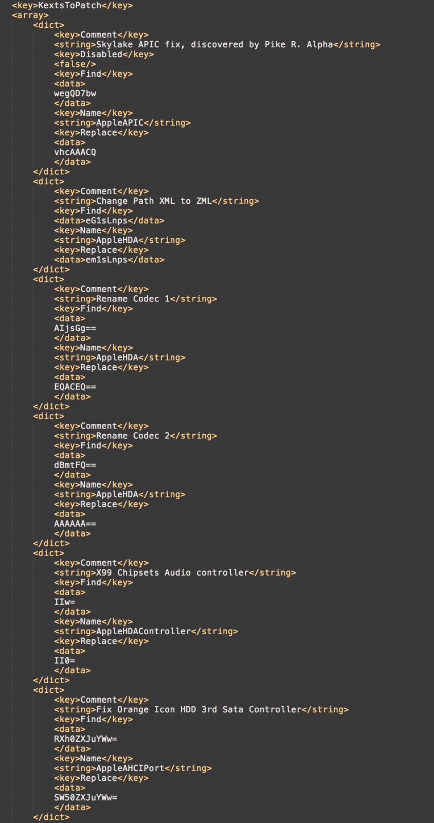

Andres ZeroCross Posted February 24, 2016 Share Posted February 24, 2016 HDMI worked.If i use your Pin Config Data and my layout9.xml.zlib then sound is good, no cracking at HIGH BASS MUSIC but fake "VOLUME CONTROL", if i use your layout9.xml.zlib then sound will crack at HIGH BASS MUSIC. Can you check your layout9.xml.zlib or my layout9.xml.zlib. I attach my Layout9.xml.zliblayout9.xml.zlib.zip Link to comment https://www.insanelymac.com/forum/topic/309283-creative-ca0132-g1sniper-m3-patch-for-applehda-or-voodoohda/page/7/#findComment-2217925 Share on other sites More sharing options...
Luminadevapps Posted February 24, 2016 Share Posted February 24, 2016 If i use your Pin Config Data and may layout ID then sound is good but no cracking at HIGH BASS MUSIC. But fake "VOLUME CONTROL", if i use your layout9.xml.zlib then sound will crack at HIGH BASS MUSIC. Can you check your layout9.xml.zlib or my layout9.xml.zlib Try this set ID 9 AppleHDA.kext.zip Link to comment https://www.insanelymac.com/forum/topic/309283-creative-ca0132-g1sniper-m3-patch-for-applehda-or-voodoohda/page/7/#findComment-2218078 Share on other sites More sharing options...

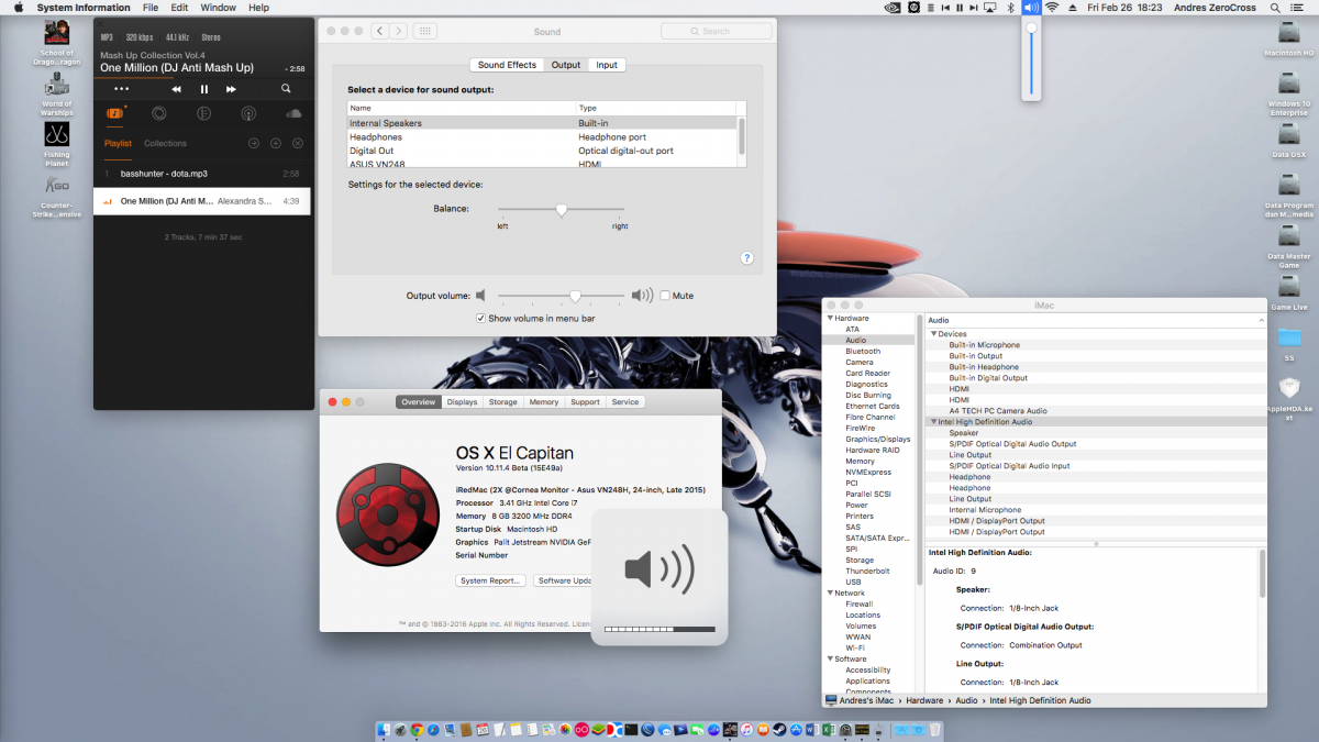

Andres ZeroCross Posted February 26, 2016 Share Posted February 26, 2016 set ID 9 4 ports worked. I don't this version still make crackling sound at high bass music Edit : Ok,, i found temporary solution. I need to decrease volume from System Preference 1/3 bars. And it give me good quality bass music. But you can see,, Volume Icon bar and System Preference are not synchronize 1 Link to comment https://www.insanelymac.com/forum/topic/309283-creative-ca0132-g1sniper-m3-patch-for-applehda-or-voodoohda/page/7/#findComment-2218484 Share on other sites More sharing options...
