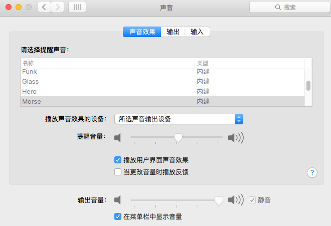

wern apfel Posted August 1, 2016 Author Share Posted August 1, 2016 AppleHDA.kext_default.zip not work, the sound down. 屏幕快照 2016-08-01 08.47.33.png script_dump.txt tested with AppleHDA.diff_switch.zip only built-in speaker not work(not test mic volume ) script_dump_1.txt I guess you've tried the kext @10.11, they only work @Sierra. Here a 10.11 kext AppleHDA.kext_10.11.zip 1 Link to comment https://www.insanelymac.com/forum/topic/309283-creative-ca0132-g1sniper-m3-patch-for-applehda-or-voodoohda/page/12/#findComment-2260732 Share on other sites More sharing options...

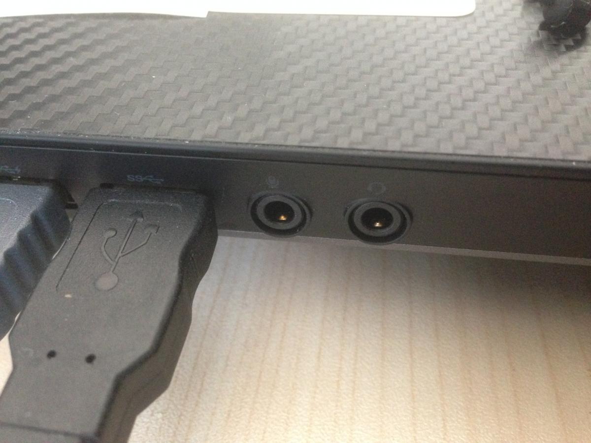

wern apfel Posted August 7, 2016 Author Share Posted August 7, 2016 no,there are 3 usb 3.0 port, 1 usb type-c port, 1 HDMI port, 1 headphone port and 1 mic port. IMG_3585.JPG You've not understood me right, but it does not matter. As expected you have a headset jack, what means that you can use headphone and the microphone at the same time, for example a iPhone headset. What i need is the pin sense result with a plugged in headset. If you look closer, you will see the difference, on the left: mic/line-in, in the middle: headphone, on the right: headset. Hi can you help how to get_pinsense command not found X99Gaming G1 Thank you. So far i know, the pin-config for desktops are known. Link to comment https://www.insanelymac.com/forum/topic/309283-creative-ca0132-g1sniper-m3-patch-for-applehda-or-voodoohda/page/12/#findComment-2262871 Share on other sites More sharing options...
abdouoi Posted August 7, 2016 Share Posted August 7, 2016 You've not understood me right, but it does not matter. As expected you have a headset jack, what means that you can use headphone and the microphone at the same time, for example a iPhone headset. What i need is the pin sense result with a plugged in headset. If you look closer, you will see the difference, on the left: mic/line-in, in the middle: headphone, on the right: headset. jack symbols.jpg So far i know, the pin-config for desktops are known. I also have 1 headset port and 1 mic port. Which kext should be used for running the script getpinsense.sh ? Link to comment https://www.insanelymac.com/forum/topic/309283-creative-ca0132-g1sniper-m3-patch-for-applehda-or-voodoohda/page/12/#findComment-2262904 Share on other sites More sharing options...
wern apfel Posted August 7, 2016 Author Share Posted August 7, 2016 I also have 1 headset port and 1 mic port. Which kext should be used for running the script getpinsense.sh ? You can try it with the kext which you use currently, if the result is 0xFFFFFFFF you should use one of the last i've uploaded. 1 Link to comment https://www.insanelymac.com/forum/topic/309283-creative-ca0132-g1sniper-m3-patch-for-applehda-or-voodoohda/page/12/#findComment-2262939 Share on other sites More sharing options...
