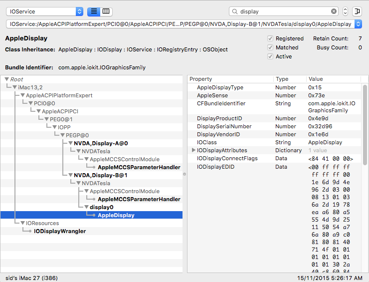

Mrengles Posted November 9, 2015 Share Posted November 9, 2015 If you would like to avoid having to patch your DSDT ever time your change your monitor setup or default you can use this DSM method, Device (GFX0) { Name (_ADR, Zero) Method (_DSM, 4, NotSerialized) { If (LEqual (Arg2, Zero)) { Return (Buffer (One) { 0x03 }) } Return (Package (0x12) { "@0,AAPL,boot-display", Buffer (Zero) {}, "@0,connector-type", Buffer (0x04) { 0x00, 0x08, 0x00, 0x00 }, "@1,AAPL,boot-display", Buffer (Zero) {}, "@1,connector-type", Buffer (0x04) { 0x00, 0x08, 0x00, 0x00 }, "@2,AAPL,boot-display", Buffer (Zero) {}, "@2,connector-type", Buffer (0x04) { 0x00, 0x08, 0x00, 0x00 }, "@3,AAPL,boot-display", Buffer (Zero) {}, "@3,connector-type", Buffer (0x04) { 0x00, 0x08, 0x00, 0x00 }, "hda-gfx", Buffer (0x0A) { "onboard-2" } }) Link to comment https://www.insanelymac.com/forum/topic/308449-how-to-fix-second-stage-boot-logo-and-loading-bar-for-some-dedicated-desktop-video-cards/page/7/#findComment-2187000 Share on other sites More sharing options...
arsradu Posted November 9, 2015 Author Share Posted November 9, 2015 If you would like to avoid having to patch your DSDT ever time your change your monitor setup or default you can use this DSM method, Device (GFX0) { Name (_ADR, Zero) Method (_DSM, 4, NotSerialized) { If (LEqual (Arg2, Zero)) { Return (Buffer (One) { 0x03 }) } Return (Package (0x12) { "@0,AAPL,boot-display", Buffer (Zero) {}, "@0,connector-type", Buffer (0x04) { 0x00, 0x08, 0x00, 0x00 }, "@1,AAPL,boot-display", Buffer (Zero) {}, "@1,connector-type", Buffer (0x04) { 0x00, 0x08, 0x00, 0x00 }, "@2,AAPL,boot-display", Buffer (Zero) {}, "@2,connector-type", Buffer (0x04) { 0x00, 0x08, 0x00, 0x00 }, "@3,AAPL,boot-display", Buffer (Zero) {}, "@3,connector-type", Buffer (0x04) { 0x00, 0x08, 0x00, 0x00 }, "hda-gfx", Buffer (0x0A) { "onboard-2" } }) So..basically setting the same boot-display property for all ports? Did I get that part right? Link to comment https://www.insanelymac.com/forum/topic/308449-how-to-fix-second-stage-boot-logo-and-loading-bar-for-some-dedicated-desktop-video-cards/page/7/#findComment-2187015 Share on other sites More sharing options...
Ramalama Posted November 9, 2015 Share Posted November 9, 2015 So..basically setting the same boot-display property for all ports? Did I get that part right? @asradu This above seems for me like boot display for every frame buffer... dunno if this is useless or not... But, there must be some registers, which changes, based where your display is connected, just need to read in the Nvidia/Amd Specification sheet... Like Rehab found the BAR1 register in the Intel Graphics specification sheet... (different thing, because BAR1 is for brightness) But theoretically i think its possible... If we find the register it should be very easy to make an ACPI Method for this... PS: i don't have here Nvidia/Amd Graphics, since i have on my laptop only Iris5100... So i can't test... Im Sry... Cheers :-) Link to comment https://www.insanelymac.com/forum/topic/308449-how-to-fix-second-stage-boot-logo-and-loading-bar-for-some-dedicated-desktop-video-cards/page/7/#findComment-2187122 Share on other sites More sharing options...
frankiee Posted November 10, 2015 Share Posted November 10, 2015 This above seems for me like boot display for every frame buffer... dunno if this is useless or not... Imho, it is. When I do this, I get the Apple Logo, but also a second loading bar bottom-left, just like without the patch. Link to comment https://www.insanelymac.com/forum/topic/308449-how-to-fix-second-stage-boot-logo-and-loading-bar-for-some-dedicated-desktop-video-cards/page/7/#findComment-2187133 Share on other sites More sharing options...

Mrengles Posted November 10, 2015 Share Posted November 10, 2015 So..basically setting the same boot-display property for all ports? Did I get that part right? Yes that's all I did... Makes not difference on my end with multi-monitors or single monitor switched to a different port... I guess OS X thinks the displays are mirrored for the boot process maybe? Link to comment https://www.insanelymac.com/forum/topic/308449-how-to-fix-second-stage-boot-logo-and-loading-bar-for-some-dedicated-desktop-video-cards/page/7/#findComment-2187329 Share on other sites More sharing options...
arsradu Posted November 10, 2015 Author Share Posted November 10, 2015 Yes that's all I did... Makes not difference on my end with multi-monitors or single monitor switched to a different port... I guess OS X thinks the displays are mirrored for the boot process maybe? That is really interesting. I wonder if it works with the device-properties method. Should work..I guess. I just can't test this. ) Link to comment https://www.insanelymac.com/forum/topic/308449-how-to-fix-second-stage-boot-logo-and-loading-bar-for-some-dedicated-desktop-video-cards/page/7/#findComment-2187335 Share on other sites More sharing options...
