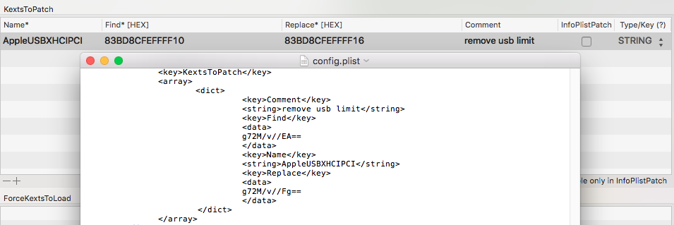

arix98 Posted October 7, 2015 Share Posted October 7, 2015 So the main problem is the 15 ports limit, and one USB3 port takes 2 ports -- one for usb2 devices one for usb3. For a system with 8 USB2+6 USB3 that's 20 ports total....that's why we need to remove unused ports or even sacrifice some real one. Is there anyway to remove the 15 limit in the XHCI driver -- perhaps a directly kext patch or clover patch so we can just let the OS grab all ports from DSDT? or at least is it technically possible? Update: Finally got it, and I use Windows instead of Yosemite to find port mapping. My MB is a MSI Z87, the DSDT looks very much like OP's, with HS01-HS15(HS15 is a dummy port) and SSP1-SSP6 under XHC, so thats 21 ports total. Under Windows, use aida64 or the free MS usbviewer, and I got 21 ports listed. In my case, port 1-15 map to HS01-HS15 and port16-21 map to SSP1-SSP6. So with a USB2 and a USB3 flash drive, I was able to map all ports correctly. 1 Link to comment https://www.insanelymac.com/forum/topic/308325-guide-1011-full-speed-usb-series-89-keeping-vanilla-sle/page/6/#findComment-2174458 Share on other sites More sharing options...

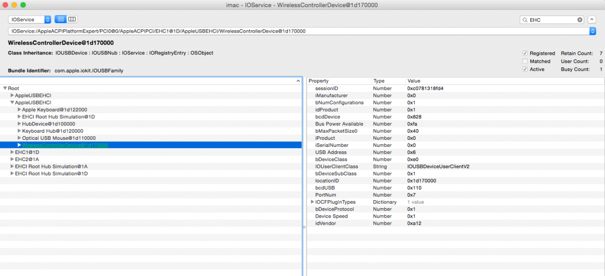

arix98 Posted October 7, 2015 Share Posted October 7, 2015 when i searched for EHCI i see nothing can anyone help? Its normal since for 8/9 series MB, all ports, even USB2 ones, are under XHCI now. Are you saying you were able to map the ports such that ALL the USB2 and USB3 ports are working correctly (i.e. more than the 15 port XHC limit), or did you have to sacrifice some USB2 ports to get all of the USB3 ports working correctly? Have to sacrifice one port to fit the limit Link to comment https://www.insanelymac.com/forum/topic/308325-guide-1011-full-speed-usb-series-89-keeping-vanilla-sle/page/6/#findComment-2174823 Share on other sites More sharing options...

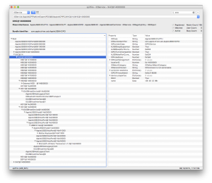

StrangeNoises Posted October 8, 2015 Share Posted October 8, 2015 Typo fixed thanks. If i could have a euro for every time i made that typo, i would be a rich man. Try looking in IOJones in the IOACPIPlane section see if you see the HSXX or SSPX section. Dont worry about being confused, its a pretty confusing thing Aha. Well, in IOACPIPlane I see Root -> acpi -> _SB -> PCI0@0 -> XHC@140000 -> RHUB@0 and under there is HS01@1 thru HS15@f, SPP1@10 thru SPP6@15 None currently have any subsections indicating devices, although keyboard/mouse are plugged in on a USB2 port... ... and nothing changes in that view when I do plug stuff in. (except a refresh/expand-all in response to the event, but no new device showing.) Link to comment https://www.insanelymac.com/forum/topic/308325-guide-1011-full-speed-usb-series-89-keeping-vanilla-sle/page/6/#findComment-2175086 Share on other sites More sharing options...
wegface Posted October 8, 2015 Author Share Posted October 8, 2015 Aha. Well, in IOACPIPlane I see Root -> acpi -> _SB -> PCI0@0 -> XHC@140000 -> RHUB@0 and under there is HS01@1 thru HS15@f, SPP1@10 thru SPP6@15 None currently have any subsections indicating devices, although keyboard/mouse are plugged in on a USB2 port... ... and nothing changes in that view when I do plug stuff in. (except a refresh/expand-all in response to the event, but no new device showing.) Unfortunately, in that view you dont see when things are plugged in. I never understood why the IOJones does not show those HSXX etc for all systems, except for there. I wonder if IOReg would do. Link to comment https://www.insanelymac.com/forum/topic/308325-guide-1011-full-speed-usb-series-89-keeping-vanilla-sle/page/6/#findComment-2175092 Share on other sites More sharing options...
arix98 Posted October 8, 2015 Share Posted October 8, 2015 Injector no longer needed if using 10.11.1 Beta 3, simply edit DSDT and remove EHC1/EHC2 and under XHC > RHUB remove any ports not needed to keep limit to 15. May work on earlier OSX but have not tested. * This is only for Series 8/9. Do not remove EHC1/EHC2 on other chipsets. I think this should work on 10.11, but I don't understand why removing EHC1/EHC2 in DSDT, since for 8/9 series MB these two are actually unused? Edit: Tested myself on Z87 MB. No need to remove EHC1/EHC2, just removing unwanted ports for XHC and it works without the kext injection. Link to comment https://www.insanelymac.com/forum/topic/308325-guide-1011-full-speed-usb-series-89-keeping-vanilla-sle/page/6/#findComment-2175095 Share on other sites More sharing options...

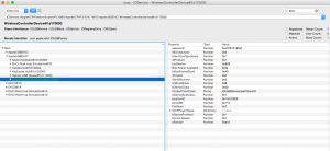

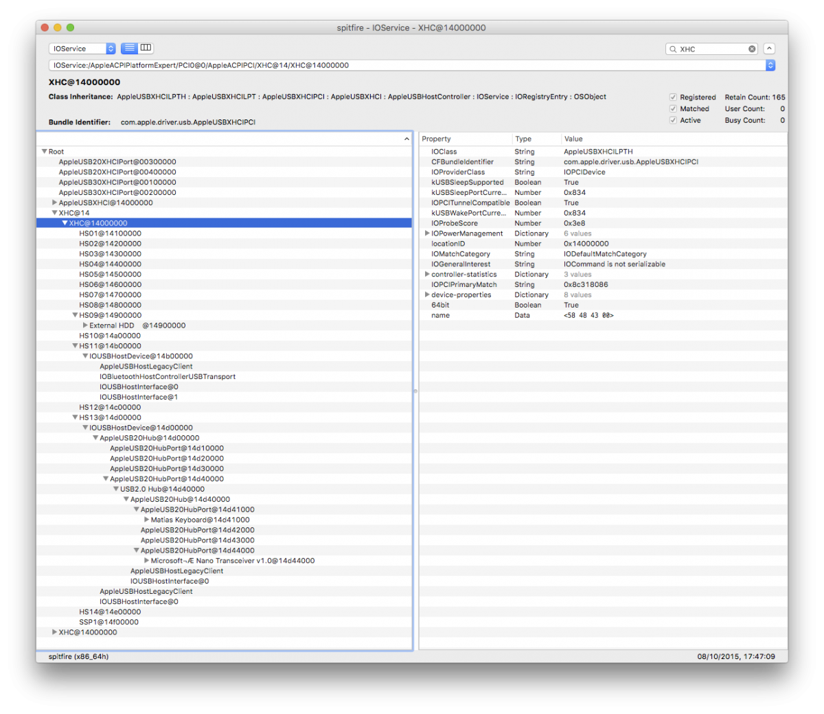

StrangeNoises Posted October 8, 2015 Share Posted October 8, 2015 Unfortunately, in that view you dont see when things are plugged in. I never understood why the IOJones does not show those HSXX etc for all systems, except for there. I wonder if IOReg would do. I booted back to El Cap and ran IOJones. This is what I'm seeing, which may be useful: Root -> XHC@14 -> XHC@14000000 and under that is HS01@14100000 thru HS14@14e00000, and a single lonely SSP1@14f00000 Screenshot: As this was taken, a Matias keyboard was plugged into one of the four USB sockets on the back, which appear to be on an internal hub behind HS13@14d00000, and a mouse RF receiver into the keyboard's integrated hub. A USB 2 external drive is plugged into one of the two USB3 front-panel sockets. A USB 3 external drive is plugged into the second USB3 front panel socket. Only the USB2 drive is showing up, anywhere, on desktop, in disk utility, in system report, in IOJones. My guess would be that my allotment of 15 USB interfaces is being filled up with USB2 entries, pushing all the USB3 ones but one (which one? even a real one?) off the table. I wonder if all I really need to do is to make some of those USB2 entries disappear. As IOJones *is* showing me this information in El Cap, but not in Yosemite, it looks like I would be able to at least map the USB2 entries to real sockets. And then I wonder, without the help of Yosemite, if I could do something to make some of them disappear -- those that appear to be not-real, the unused mid-board usb2 header (no usb2 sockets on case), i can decide I'll never need to plug USB2 devices into the six USB3 sockets on the back (as there are 4 perfectly serviceable USB2 sockets there too)... then I wonder if the other USB3 sockets will start to come into the table at the bottom by themselves? Link to comment https://www.insanelymac.com/forum/topic/308325-guide-1011-full-speed-usb-series-89-keeping-vanilla-sle/page/6/#findComment-2175117 Share on other sites More sharing options...
StrangeNoises Posted October 8, 2015 Share Posted October 8, 2015 OK, I seem to have three functioning USB3 ports. Luckier than some! One seems to be the single SSP15 that showed up in my previous post, which I identified. Curiously IOJones didn't show it in that place, but it did show up elsewhere, and the location id shown in system report pointed to it being in that same interface 0x14f00000. And the USB3 drive works there. It also works in what I believe to be the two ASMedia ports on the back, which therefore seem to be supported out of the box. That actually shows a location id of 0x00200000 and in IOJones only shows up in IODeviceTree. in either place, it seems to transfer data at the same speed as when plugged into a recent real mac also running El Cap. Speed was somewhat slower than some reviews suggest for that drive, but faster than the USB2 theoretical maximum. And as it's the same on the real mac I declare that whatever issues the drive may have the USB ports seem to be working. Be nice to have more of them working though! Link to comment https://www.insanelymac.com/forum/topic/308325-guide-1011-full-speed-usb-series-89-keeping-vanilla-sle/page/6/#findComment-2175152 Share on other sites More sharing options...

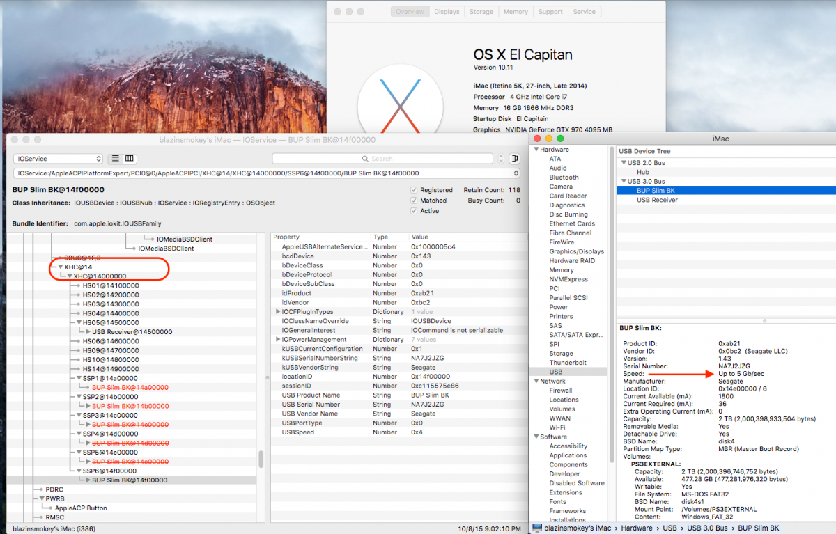

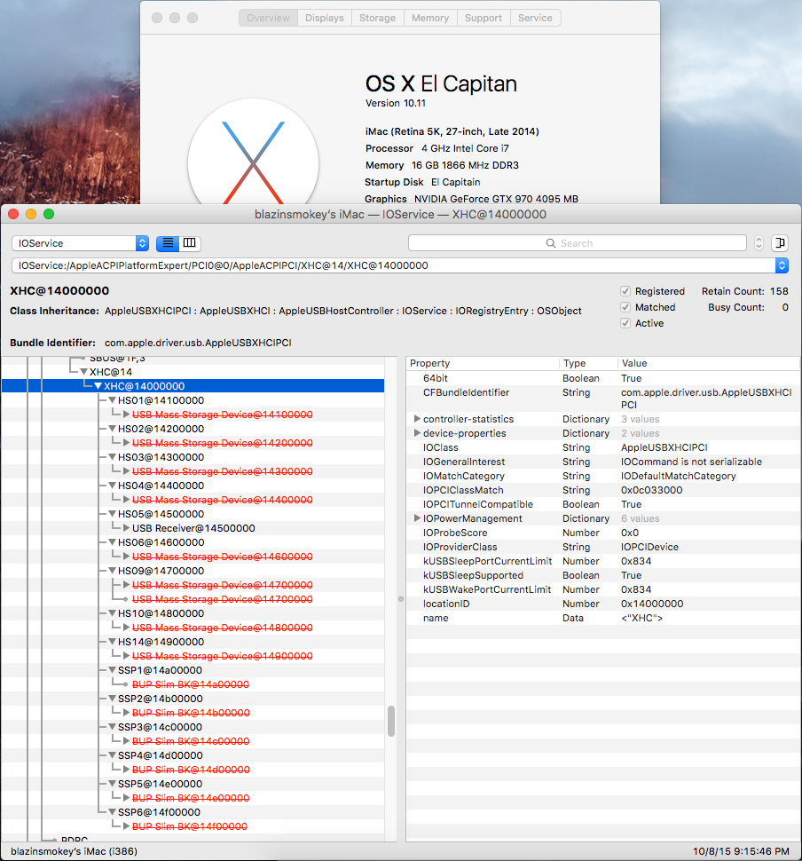

blazinsmokey Posted October 9, 2015 Share Posted October 9, 2015 Before reading all of my post!! Whatever is at top is pretty much the latest info regarding this situation but the rest of the thread may be useful depending on your situation. The Ultimate Solution quoted here by arix98. This is the solution I'm currently using. No DSDT needed, no injection, and no dummy kexts. So far, so good for me, no KP all ports addressed and read properly. My screen shot and confirmation of this method can be found here. This method will circumvent the the 15 port limit of El Capitan. Port as in the port addresses. Here's the patch for your clover config.plist <key>KextsToPatch</key> <array> <dict> <key>Comment</key> <string>remove usb limit</string> <key>Find</key> <data> g72M/v//EA== </data> <key>Name</key> <string>AppleUSBXHCIPCI</string> <key>Replace</key> <data> g72M/v//Fg== </data> </dict> </array> Here it is to type in Clover Configurator. Previous usage... So the main problem is the 15 ports limit, and one USB3 port takes 2 ports -- one for usb2 devices one for usb3. For a system with 8 USB2+6 USB3 that's 20 ports total....that's why we need to remove unused ports or even sacrifice some real one. Is there anyway to remove the 15 limit in the XHCI driver -- perhaps a directly kext patch or clover patch so we can just let the OS grab all ports from DSDT? or at least is it technically possible? Update: Finally got it, and I use Windows instead of Yosemite to find port mapping. My MB is a MSI Z87, the DSDT looks very much like OP's, with HS01-HS15(HS15 is a dummy port) and SSP1-SSP6 under XHC, so thats 21 ports total. Under Windows, use aida64 or the free MS usbviewer, and I got 21 ports listed. In my case, port 1-15 map to HS01-HS15 and port16-21 map to SSP1-SSP6. So with a USB2 and a USB3 flash drive, I was able to map all ports correctly. Confirmed with Asus Maximus VII Hero Z97 on 10.11. Still currently dual booting Yosemite and El Cap. No kext injection and vanilla SLE. DSDT edit required removing unnecessary USB 2.0 ports and sacrificed one to get all my USB 3.0 running (6x). Ports were already named EHC1,EHC2 and XHC. Using Yosemite to figure out ports works but not in the way portrayed in the 1st post. USB 3.0 ports I couldn't even get a definite port address as my DSDT for SSP1-6 all said ADR 0. Guide for my board and possibly others with 9 series / z97 chipset. Requirements Yosemite installed Using DSDT IOReg 2.1 or IOJones macIASL Some patience A Bit Of Understanding Below you can see no HSxx and SSPx. I noted the locationID and PortNum in IOreg. Notice how in my DSDT the HS02 address matches. The locationID may be useless but noting them down in your diagram will help you see the bigger picture. You can see here that we can't find a definite way to address USB 3.0. The first screen was of a USB 2.0 flash drive in a USB 3.0 port. This screen shot is that of a USB 3.0 hard drive in the same port. However the location ID is different. My DSDT showing SSP addresses as zero below. In the end we are really just going to hunt for HSxx we don't need to stay within the 15 limit. Plug, Note, Unplug... Repeat! Quoted below, this is clutch to for those who don't have Yosemite installed and are dual booting Windows. Under Windows, use aida64 or the free MS usbviewer, and I got 21 ports listed. In my case, port 1-15 map to HS01-HS15 and port16-21 map to SSP1-SSP6. So with a USB2 and a USB3 flash drive, I was able to map all ports correctly. So now that you can kind of see what is going on. While in Yosemite with IORegistry 2.1, your plugging a USB 2.0 device in all of your ports one port at a time. Each time you plug it in, IOReg will show the device in the tree. Referring to my first screenshot also posted below, you can see it on the left side light up green, red when it's unplugged. Don't worry if it is not under HSxx or SSPx. Record the port address and locationID. Preferably in a some sort of drawn out diagram of your port locations. This will give us all the HSxx we are using when finding them in our DSDT later. Although I did this, it may be a waste of time. For only the USB 3.0 ports I tested with a USB 3.0 device and noted the locationIDs for them. Their port number would be the same as what we did for the USB 2.0 device. It did give me a sense of how the SSP were being numbered so you may want to consider that. It doesn't hurt. Editing your DSDT Your DSDT must be fixed and error free for your specific motherboard. Ports for the USB already named EHC1,EHC2 and XHC. I didn't even bother to touch EHC1 or EHC2. Everything on my system was in XHC or XHC hub inside the DSDT. Assuming yours will be too. You can see this in the screenshot below outlined in red on the left side. See how I initially had HS01-HS14. My system has 10 ports total. 6 are USB 3.0, each count as 2. (6x2) = 12 leaving me capable of assigning 3 USB 2.0 ports and losing one. Now that the math is out the way, apply this to your situation. Look through your DSDT, to find all your HSxx and SSPx devices. From your noted diagram look through all the HSxx in your DSDT, deleting the ones that have a ADR that is not on your diagram. Deleting is easy, you just delete the whole method, example is shown in the screen shot below as it's highlighted in blue. Again the SSPx was useless for as the address all said zero. Edit: Some nice advice from arix98. And fwiw, you can sacrifice the HS port associated with USB3 port, in this way, that USB3 port still works but only accepts USB3 devices with no response to USB2 devices. You can also sacrifice the SS port and making the USB3 port USB2-only. Save your DSDT drop it in the appropriate folder, for me Clover, in the EFI/Clover/ACPI/patched. Used Clover Configurator to add "DSDT.aml" to the ACPI tab in the DSDT name box. Confirmation Verify USB 3.0 and speed. Boot into El Capitain and open IOReg. Also open About this Mac and System Reports pointing at your USB under hardware. Plug in a USB 3.0 device one by one. After each plug-in you should see it pop up now all as SSPx under XHC. In your System report Window you should see the Speed as Up to 5Gb/sec. Use the screen shot below for guidance. Here is my proof of all ports working as should minus the one USB 2.0 I sacrificed. My Files Someone has requested my DSDT and Clover config. I really recommend making your own DSDT, it took me literally 10 minutes to do my own and fix it. Consider that you may have different BIOS version and most likely different BIOS settings as I'm a regular Windows user and I have my system adjusted for quick overclocks. The zip below includes DSDT untouched only fixed of errors with minimal patches and the one I'm currently using. As always create your own SMBIOS with the config file. I'm using iMac15,1 and letting Clover generate my states. It's about as plain as it gets. I also have a GTX970, 16GB 1866 Ram. Archive.zip 4 Link to comment https://www.insanelymac.com/forum/topic/308325-guide-1011-full-speed-usb-series-89-keeping-vanilla-sle/page/6/#findComment-2175319 Share on other sites More sharing options...

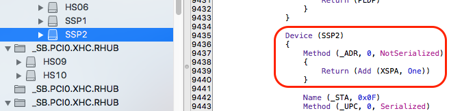

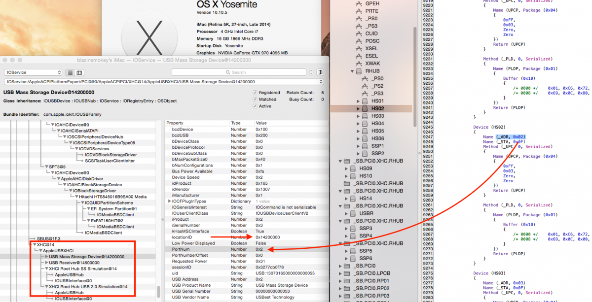

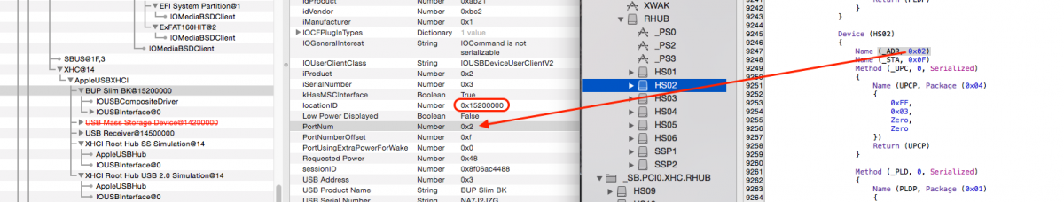

arix98 Posted October 9, 2015 Share Posted October 9, 2015 Your ADR address is not zero, its a function with return value ADD(XSPA, one), or XSPA+1. To get the ADR, another way is to use IORegistryExplorer, check IOACPIPlane...but ADR is completely unnecessary if we go through the DSDT port removal route. And fwiw, you can sacrifice the HS port associated with USB3 port, in this way, that USB3 port still works but only accepts USB3 devices with no response to USB2 devices. You can also sacrifice the SS port and making the USB3 port USB2-only. 1 Link to comment https://www.insanelymac.com/forum/topic/308325-guide-1011-full-speed-usb-series-89-keeping-vanilla-sle/page/6/#findComment-2175328 Share on other sites More sharing options...
blazinsmokey Posted October 9, 2015 Share Posted October 9, 2015 Your ADR address is not zero, its a function with return value ADD(XSPA, one), or XSPA+1. To get the ADR, another way is to use IORegistryExplorer, check IOACPIPlane...but ADR is completely unnecessary if we go through the DSDT port removal route. And fwiw, you can sacrifice the HS port associated with USB3 port, in this way, that USB3 port still works but only accepts USB3 devices with no response to USB2 devices. You can also sacrifice the SS port and making the USB3 port USB2-only. If you don't have the ADR how do you know which HSxx to delete? I had 14 of them, now only using 9 due to 6 SS ports. Ahh I didn't think of that, but I don't have much USB 3.0 peripherals. The one disabled is in the back, never gets used. I'll keep that in mind though and add it to my post. 1 Link to comment https://www.insanelymac.com/forum/topic/308325-guide-1011-full-speed-usb-series-89-keeping-vanilla-sle/page/6/#findComment-2175334 Share on other sites More sharing options...
