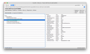

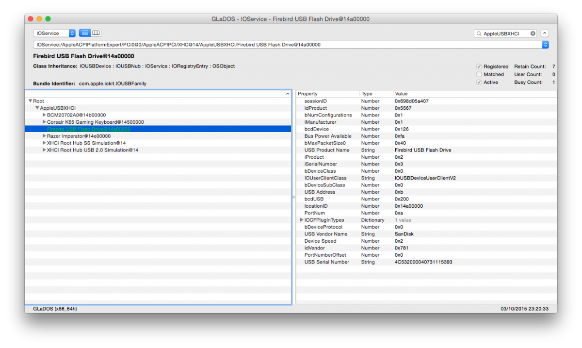

buoo Posted October 3, 2015 Share Posted October 3, 2015 Impossible to me! (GA-H97M-D3H) I don't get anything under EHCI with any USB device and under XHC I don't get the list HS01@14000000 ,HS02....SSP1..., so when I connect a usb pen drive I can't say : DT microDuo 3.0@1550000 is SSP3 or something else. Link to comment https://www.insanelymac.com/forum/topic/308325-guide-1011-full-speed-usb-series-89-keeping-vanilla-sle/page/3/#findComment-2172784 Share on other sites More sharing options...

kignon Posted October 3, 2015 Share Posted October 3, 2015 Good evening gentlemen ! First : Thank you for the DSDT wegface, I'll have few questions for you about it, but later, when I'll successfully pass step 01. So I came back on Yosemite to get my SSPXX and HSXX. Unfortunately I don't have the same kind of "view" on IOJones. I've noticed it is only when I'm on Yosemite : on El Capitan, I got all the HS and SSP... So, I've understood that I can get HSXX and SSPXX according to their adresse. SO I plug a USB 2.0 key in my USB 3.0 port, a green line appeared on IOJones, but now I don't really know which information I should copy on my paper. I thought at the start I should copy USB Address, but every time I plug and unplug my USB key on the SAME USB port, the value is been incremented. Do I have to copy the value right after the @ on the title ? For example, for my USB key, is the usb address "14a00000" ? If yes how do I translate it to a "XX XX XX XX" value ? It seems to be an hexadecimal value, but I'm not sure. Thank you in advance for your help, and I'm still sorry for my English. Link to comment https://www.insanelymac.com/forum/topic/308325-guide-1011-full-speed-usb-series-89-keeping-vanilla-sle/page/3/#findComment-2172866 Share on other sites More sharing options...
wegface Posted October 3, 2015 Author Share Posted October 3, 2015 You make your map so you know which physical usb is SSP1 etc etc. Link to comment https://www.insanelymac.com/forum/topic/308325-guide-1011-full-speed-usb-series-89-keeping-vanilla-sle/page/3/#findComment-2172873 Share on other sites More sharing options...
kignon Posted October 3, 2015 Share Posted October 3, 2015 (edited) You make your map so you know which physical usb is SSP1 etc etc. I don't really understand what you mean... Would you please be a little bit more explicit ? I understand from your answer that I making my own map : I decide myself which port is HS01, which port is SSP01 etc etc... But if that's the case, I don't understand why I needed Yosemite :/ In facts, I don't understand how to make the map... It is probably obvious... Edited October 3, 2015 by kignon Link to comment https://www.insanelymac.com/forum/topic/308325-guide-1011-full-speed-usb-series-89-keeping-vanilla-sle/page/3/#findComment-2172878 Share on other sites More sharing options...
wegface Posted October 3, 2015 Author Share Posted October 3, 2015 I don't really understand what you mean... Would you please be a little bit more explicit ? I understand from your answer that I making my own map : I decide myself which port is HS01, which port is SSP01 etc etc... But if that's the case, I don't understand why I needed Yosemite :/ In facts, I don't understand how to make the map... It is probably obvious... You do not decide, you plug a device, on IOJones it goes green. On your map you note which port was which number. etc. This makes your map, so you can choose which to not use incase you have more than the 15 allowed. Link to comment https://www.insanelymac.com/forum/topic/308325-guide-1011-full-speed-usb-series-89-keeping-vanilla-sle/page/3/#findComment-2172879 Share on other sites More sharing options...
kignon Posted October 3, 2015 Share Posted October 3, 2015 You do not decide, you plug a device, on IOJones it goes green. On your map you note which port was which number. etc. This makes your map, so you can choose which to not use incase you have more than the 15 allowed. Okay, so that's what I understood the first time, HSXX / SSPXX are not written anywhere. So my question was how do I identify HSXX and SSPXX. If I consider my last attachment page 4, my green line is a USB2.0 key on a USB3.0 port and the value is 14a00000, so "a" is 10 in hexadecimal, so can I conclude my port is HS10 ? I just want to know if I have the good method to make my map. Thank for your answer by the way. 1 Link to comment https://www.insanelymac.com/forum/topic/308325-guide-1011-full-speed-usb-series-89-keeping-vanilla-sle/page/3/#findComment-2172883 Share on other sites More sharing options...

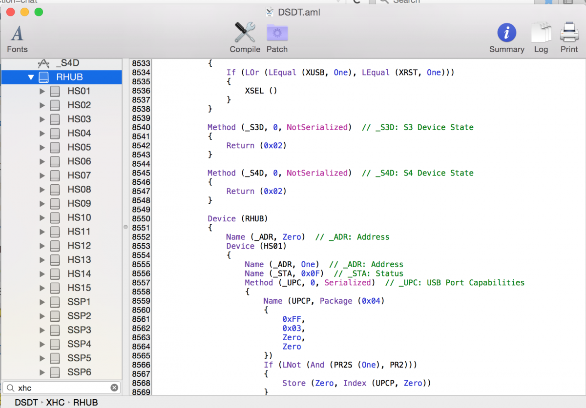

wegface Posted October 3, 2015 Author Share Posted October 3, 2015 Look at this dsdt for example: Link to comment https://www.insanelymac.com/forum/topic/308325-guide-1011-full-speed-usb-series-89-keeping-vanilla-sle/page/3/#findComment-2172885 Share on other sites More sharing options...
buoo Posted October 3, 2015 Share Posted October 3, 2015 Okay, so that's what I understood the first time, HSXX / SSPXX are not written anywhere. So my question was how do I identify HSXX and SSPXX. If I consider my last attachment page 4, my green line is a USB2.0 key on a USB3.0 port and the value is 14a00000, so "a" is 10 in hexadecimal, so can I conclude my port is HS10 ? I just want to know if I have the good method to make my map. Same problem here. I'm not at home right now but I think you should convert the *number to get one of adr numbers that you get with IoJones to map the ports. Device (HS01) Name (_adr, *number) Link to comment https://www.insanelymac.com/forum/topic/308325-guide-1011-full-speed-usb-series-89-keeping-vanilla-sle/page/3/#findComment-2172905 Share on other sites More sharing options...
kignon Posted October 3, 2015 Share Posted October 3, 2015 Thank you so much for your help wegface, I still don't have a DSDT but : I finally got everything working or almost, I have 17 ports, I know now how to edit my Injector to make it work like I want : 4 USB 2.0 (4 HSXX) 6 USB 3.0 (6 HSXX + 6 SSPXX) BCM20702A0 (1 HSXX) Considering the facts that everything was working on Yosemite, is there a solution to make 17 ports work instead of 15 ? If there isn't for the moment I will simply wait for the moment (sacrificing 1 USB 3.0 or my Bluetooth) or go back under Windows 7 (I'm a little bit tired to make "miracles"). Link to comment https://www.insanelymac.com/forum/topic/308325-guide-1011-full-speed-usb-series-89-keeping-vanilla-sle/page/3/#findComment-2172914 Share on other sites More sharing options...
