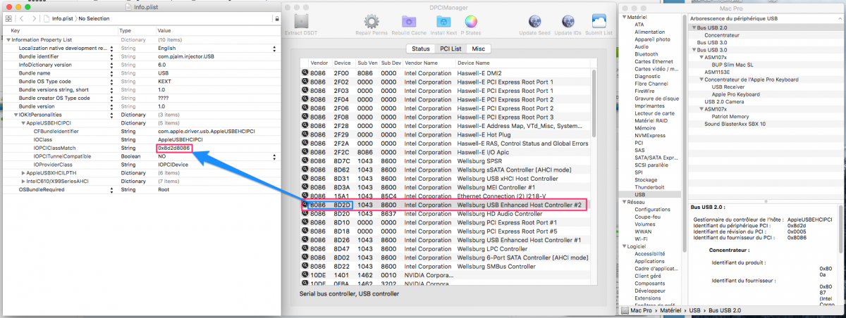

Fljagd Posted February 25, 2016 Share Posted February 25, 2016 The nobody has experienced in Asus X99 chipset ? After several tests, this is what makes the most sense for my X99-A 1- breaking the limit on the number of USB port in the config.plist 2- make injections in the info.plist of kexts as shown in the picture config.plist.zip X99_Injector.kext.zip 2 Link to comment https://www.insanelymac.com/forum/topic/308325-guide-1011-full-speed-usb-series-89-keeping-vanilla-sle/page/19/#findComment-2218221 Share on other sites More sharing options...

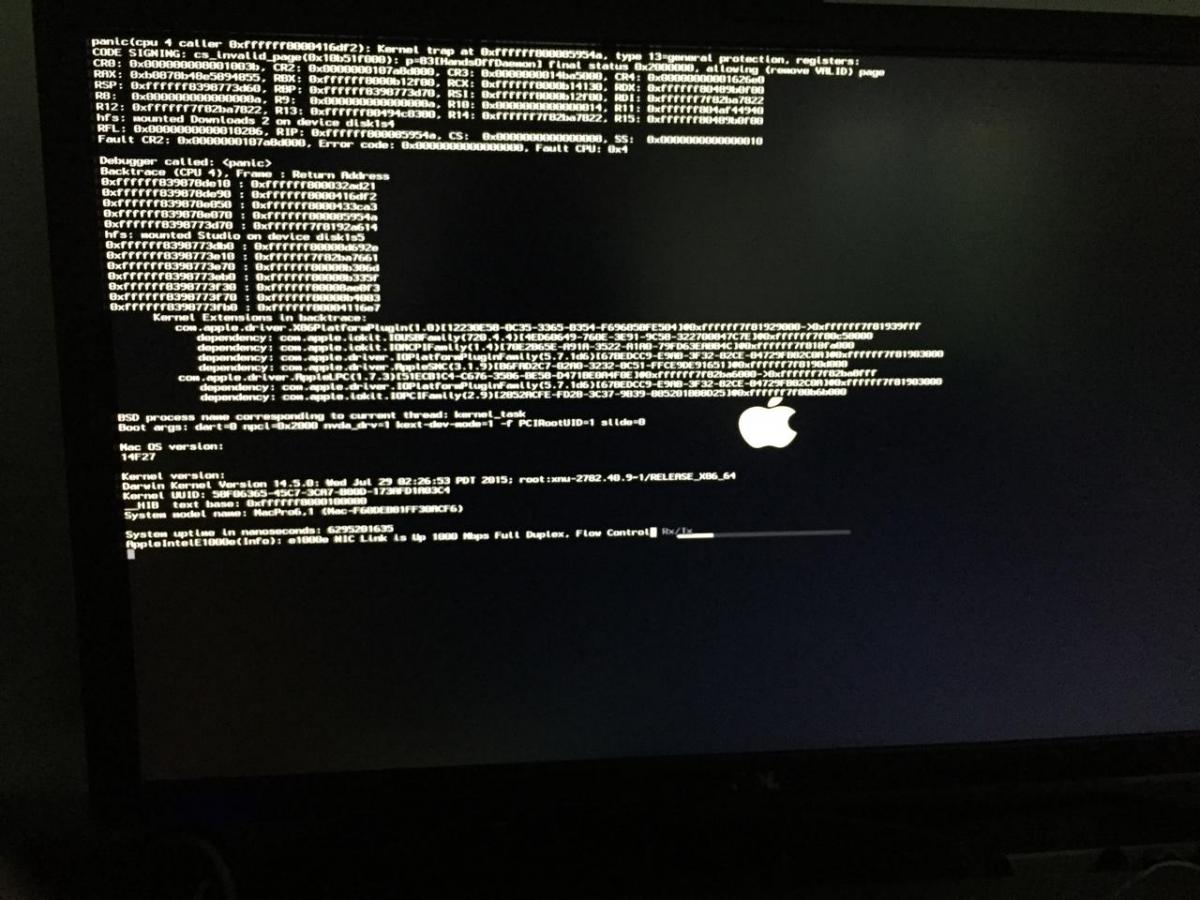

Anonym323 Posted June 8, 2016 Share Posted June 8, 2016 So no chance to get it fixed without apples power management for x99? I'm on Yosemite and did not add the x99 injector since I get an kernel panic with it so I only removed the USB limit. Link to comment https://www.insanelymac.com/forum/topic/308325-guide-1011-full-speed-usb-series-89-keeping-vanilla-sle/page/19/#findComment-2241805 Share on other sites More sharing options...

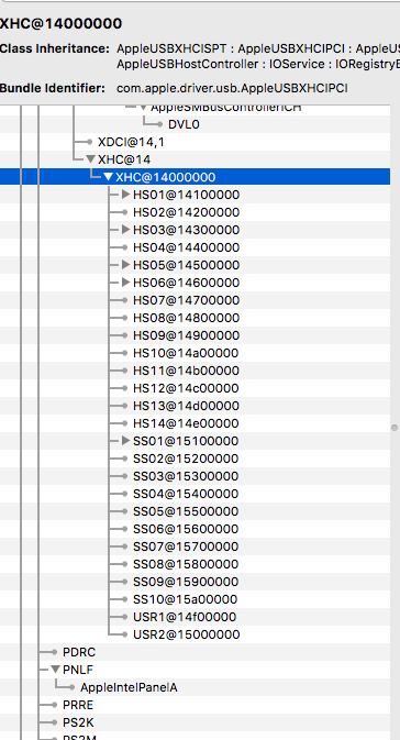

Andres ZeroCross Posted June 20, 2016 Share Posted June 20, 2016 To unlock 31 Ports at Intel 100 Series Chipset at macOS Sierra use this patchFind : 00837D94100F835AReplace : 00837D941F0F835AName : AppleUSBXHCIPCILook at my IOREG 5 Link to comment https://www.insanelymac.com/forum/topic/308325-guide-1011-full-speed-usb-series-89-keeping-vanilla-sle/page/19/#findComment-2244709 Share on other sites More sharing options...
prcmelo Posted June 20, 2016 Share Posted June 20, 2016 To unlock 31 Ports at Intel 100 Series Chipset at macOS Sierra use this patch Find : 00837D94100F835A Replace : 00837D941F0F835A Name : AppleUSBXHCIPCI Look at my IOREG I'm thinking about if it works on G97 Series... I'll try... Edited: Patch working at macOS Sierra!!! Thank you, Andres! Link to comment https://www.insanelymac.com/forum/topic/308325-guide-1011-full-speed-usb-series-89-keeping-vanilla-sle/page/19/#findComment-2244809 Share on other sites More sharing options...
Gogeta5026 Posted June 20, 2016 Share Posted June 20, 2016 To unlock 31 Ports at Intel 100 Series Chipset at macOS Sierra use this patch Find : 00837D94100F835A Replace : 00837D941F0F835A Name : AppleUSBXHCIPCI Look at my IOREG Do I apply this in my Clover Configurator for this to work? Link to comment https://www.insanelymac.com/forum/topic/308325-guide-1011-full-speed-usb-series-89-keeping-vanilla-sle/page/19/#findComment-2244854 Share on other sites More sharing options...
nmano Posted June 22, 2016 Share Posted June 22, 2016 To unlock 31 Ports at Intel 100 Series Chipset at macOS Sierra use this patch Find : 00837D94100F835A Replace : 00837D941F0F835A Name : AppleUSBXHCIPCI Look at my IOREG I tested x99 with 10.12 This patched worked. Thank you. Link to comment https://www.insanelymac.com/forum/topic/308325-guide-1011-full-speed-usb-series-89-keeping-vanilla-sle/page/19/#findComment-2245186 Share on other sites More sharing options...
