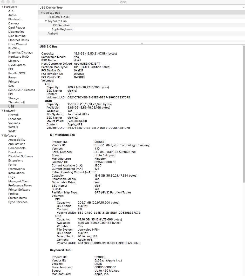

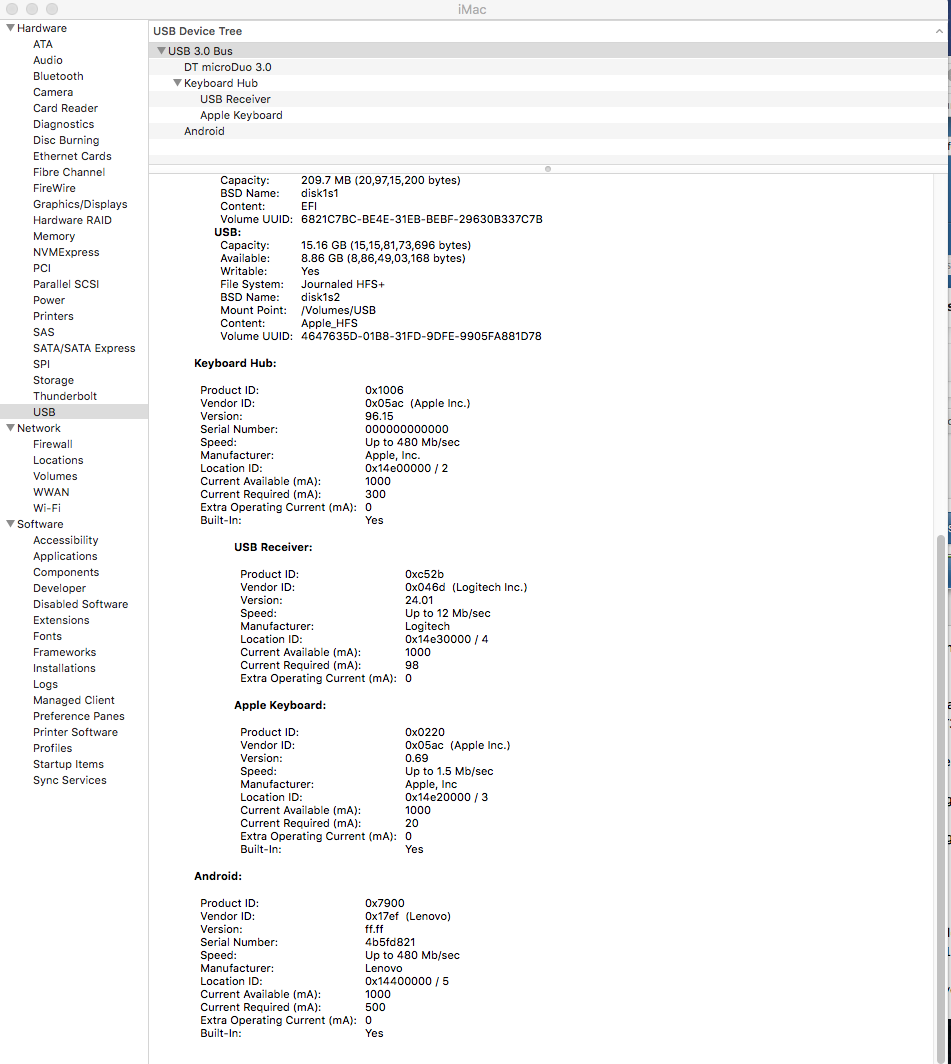

William Parker Posted April 27, 2016 Author Share Posted April 27, 2016 Attaching Screenshots of my Z170 6700K under build, with just the port limit patch applied in clover plist under kext patches. The Keyboard is connected to the USB 2.0 port on the motherboard back panel. System information USB part shows the grabs. Is this okay? Suggestions and ideas anyone? Also you will see that USB 3.0 drive Kingston micro-duo is at SuperSpeed, Link to comment https://www.insanelymac.com/forum/topic/311983-gigabyte-z170m-d3h-usb-30-10114/#findComment-2234877 Share on other sites More sharing options...

William Parker Posted April 29, 2016 Author Share Posted April 29, 2016 Whoa! What miracle brother? I have no injectors yet and all I've done is the 15 port limit extended to 21 and USB 3.0 works at 3.0 speeds. Keyboard (Apple Aluminium wired one) presents itself to the system as a "keyboard hub" & I wouldn't mind it strutting its stuff as long as it is in the right places, which unfortunately appears not to be. It is connected to one of the 2 USB 2 ports on the rear panel as you see in the screenshot shown above. Thank you for pointing out the strange 10.11 and other folder behaviour anomalies. Really appreciate it when people share strange quirks. These really help. But I believe USBInjectall is for injecting all ports which is not really ideal. Might work for now & the first route I will take. People have talked of board-specific injectors which I am hoping to arrive at if some bright kind soul steps in here and helps me make. Thanks again. Link to comment https://www.insanelymac.com/forum/topic/311983-gigabyte-z170m-d3h-usb-30-10114/#findComment-2235160 Share on other sites More sharing options...
