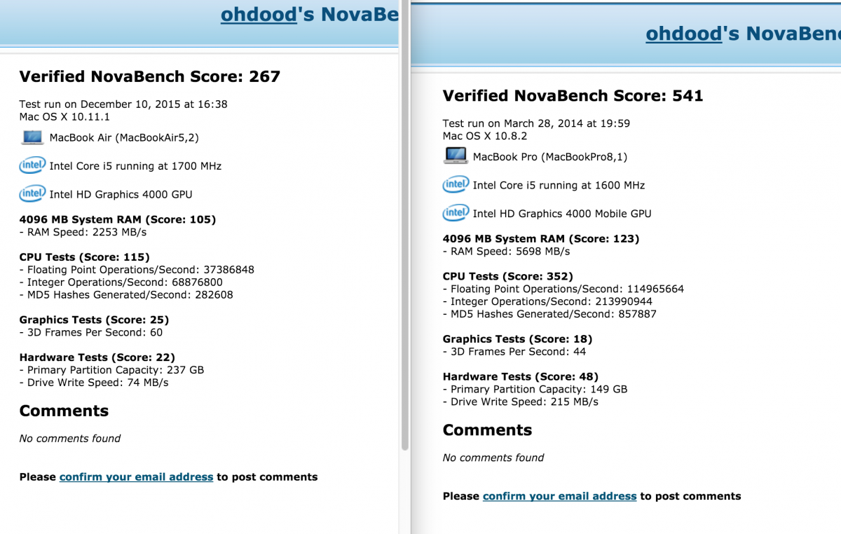

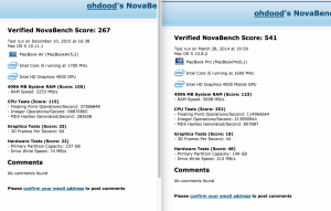

ohdood Posted December 10, 2015 Share Posted December 10, 2015 @duduclx I followed post #20 to do my install. Although now after running Novabench several times and comparing my results to my previous install of ML it seems I may have something wrong with my current install overall.  Has anyone else here used Novabench at all to benchmark their Ativ? Here is a screenshot showing my current install with 10.11.1 on the left and 10.8.2 on the right. It looks like only one of my cores is being used? My SSD write speed is way down. The only improvement that I can see is the GPU operations are now better.  I ran Novabench on my  old Mac Mini and it had a higher score than my latest install of El Capitan on my Ativ! Link to comment https://www.insanelymac.com/forum/topic/307911-guide-samsung-ativ-smart-pro-xe700t1c-1010x-and-10110-100/page/9/#findComment-2195731 Share on other sites More sharing options...
midi-sama Posted December 10, 2015 Share Posted December 10, 2015 for cpu: do you use an ssdt? did you change your thermal paste? did you patch your bios with pmpatch? do you use KernelPM or ACPUPMPatch? for ssd: have you enabled trim with trimforce or clover patching? there maybe other factors like heat, hot reboot from windows or another os, the components are getting old or may be altered. i'll run a benchmark one I get os x on this device again Link to comment https://www.insanelymac.com/forum/topic/307911-guide-samsung-ativ-smart-pro-xe700t1c-1010x-and-10110-100/page/9/#findComment-2195737 Share on other sites More sharing options...
ohdood Posted December 10, 2015 Share Posted December 10, 2015 @midi I believe I'm using an SSDT. I just followed the instructions from post #20. I have never opened up my case so no to the thermal paste. I haven't patched the bios. I think the bios is P08AAT? Not sure on KernelPM or ACPUPMPatch. I believe it's ACPUPMPatch. For my SSD i do have TRIM enabled and I just did it through the terminal. Â When I ran Novabench on my Ativ with ML installed I think I had Windows 8 still installed on another partition. Now I only have El Capitan installed and only one partition on it. Â Thanks for your response and insight! Link to comment https://www.insanelymac.com/forum/topic/307911-guide-samsung-ativ-smart-pro-xe700t1c-1010x-and-10110-100/page/9/#findComment-2195744 Share on other sites More sharing options...
midi-sama Posted December 10, 2015 Share Posted December 10, 2015 Hmmm, your firmware is outdated, the latest one is P10AAT, if you update it, remake dsdt and ssdts (crucial). And for now, remove you ssdt, do a cold boot (power off then power it on after a while) and redo the benchmarks, try with and without XCPM (KernelPM + -xcpm) with and without ssdt. And make sure you close all apps, disable autostart of apps and do a cold boot for each benchmark. This will show you where is the problem. Link to comment https://www.insanelymac.com/forum/topic/307911-guide-samsung-ativ-smart-pro-xe700t1c-1010x-and-10110-100/page/9/#findComment-2195750 Share on other sites More sharing options...

ohdood Posted December 10, 2015 Share Posted December 10, 2015 @midi I no longer have Windows 8 at all on this computer or a back up. I never used it and never thought I would again. I think I have a Windows 7 install DVD laying around. Is there any way to update the bios manually without having to re-install windows? Link to comment https://www.insanelymac.com/forum/topic/307911-guide-samsung-ativ-smart-pro-xe700t1c-1010x-and-10110-100/page/9/#findComment-2195797 Share on other sites More sharing options...
midi-sama Posted December 10, 2015 Share Posted December 10, 2015 You can use the guide above that have windows install guide and removing it, it should take you one hour in total! (Use windows 8 or 8.1 not 7) it's easy and hassle free Link to comment https://www.insanelymac.com/forum/topic/307911-guide-samsung-ativ-smart-pro-xe700t1c-1010x-and-10110-100/page/9/#findComment-2195799 Share on other sites More sharing options...

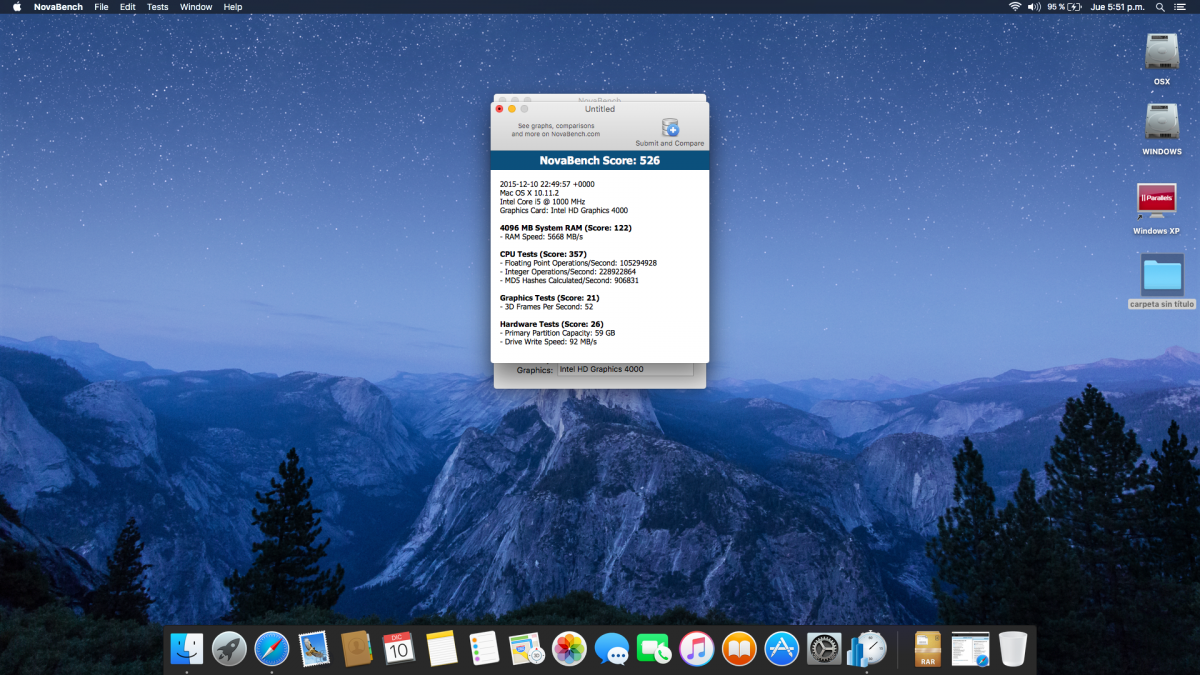

CEGOCAP Posted December 10, 2015 Share Posted December 10, 2015 @ohdood i ran the nova bench test and i attach my results. i follow the guide in post #20 strictly Link to comment https://www.insanelymac.com/forum/topic/307911-guide-samsung-ativ-smart-pro-xe700t1c-1010x-and-10110-100/page/9/#findComment-2195828 Share on other sites More sharing options...
ohdood Posted December 10, 2015 Share Posted December 10, 2015 @edwinvarelas thanks for giving me comparison to base my build from! I am now in the process of trying out the suggestions midi had given me. Your numbers look way closer to what my old install of ML had. I followed your guide to the letter. I didn't do the screen rotation or ADB remapping yet though. Thanks for all your great work and guide. I will report back with my findings Link to comment https://www.insanelymac.com/forum/topic/307911-guide-samsung-ativ-smart-pro-xe700t1c-1010x-and-10110-100/page/9/#findComment-2195830 Share on other sites More sharing options...
