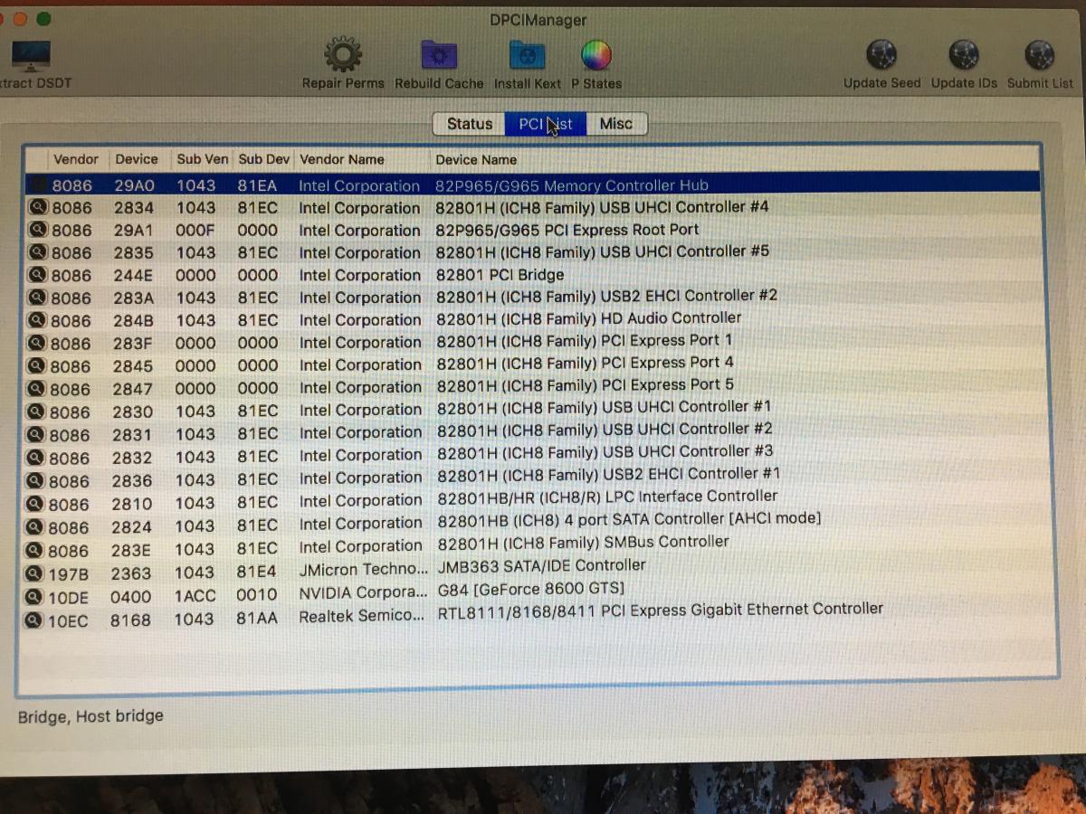

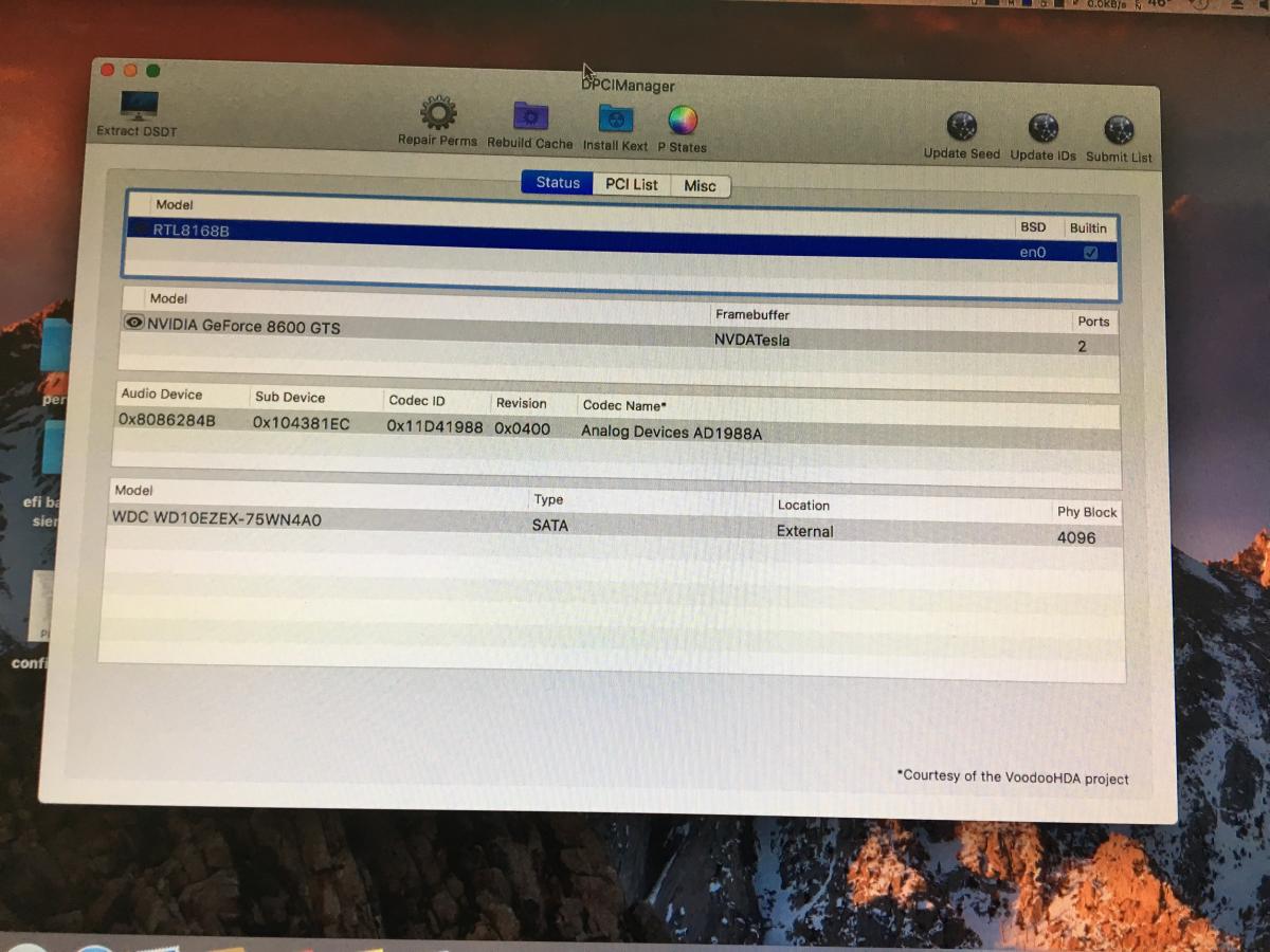

gengik84 Posted December 14, 2017 Author Share Posted December 14, 2017 Scarica DPCIManager.zip fai foto a status e pci list...postale entrambe Link to comment https://www.insanelymac.com/forum/topic/306828-guida-installazione-mac_os-_x-101x-clover-usb/page/53/#findComment-2550608 Share on other sites More sharing options...
skizzato871 Posted December 14, 2017 Share Posted December 14, 2017 si ecco... Link to comment https://www.insanelymac.com/forum/topic/306828-guida-installazione-mac_os-_x-101x-clover-usb/page/53/#findComment-2550619 Share on other sites More sharing options...
