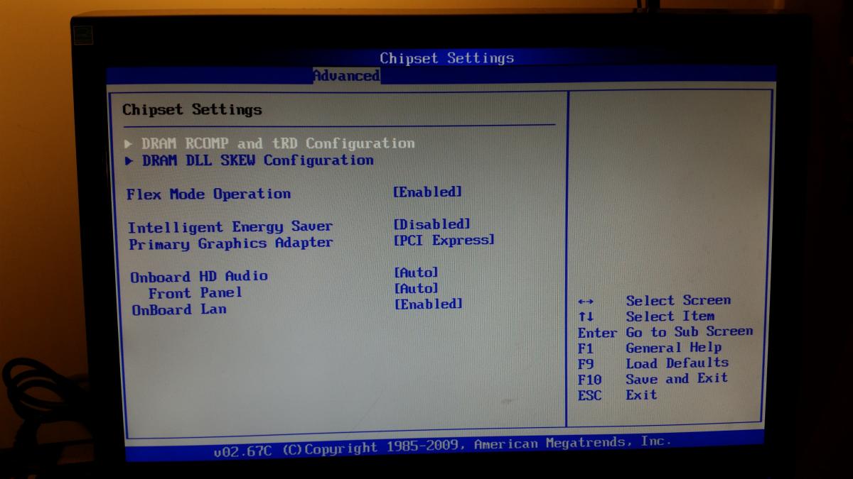

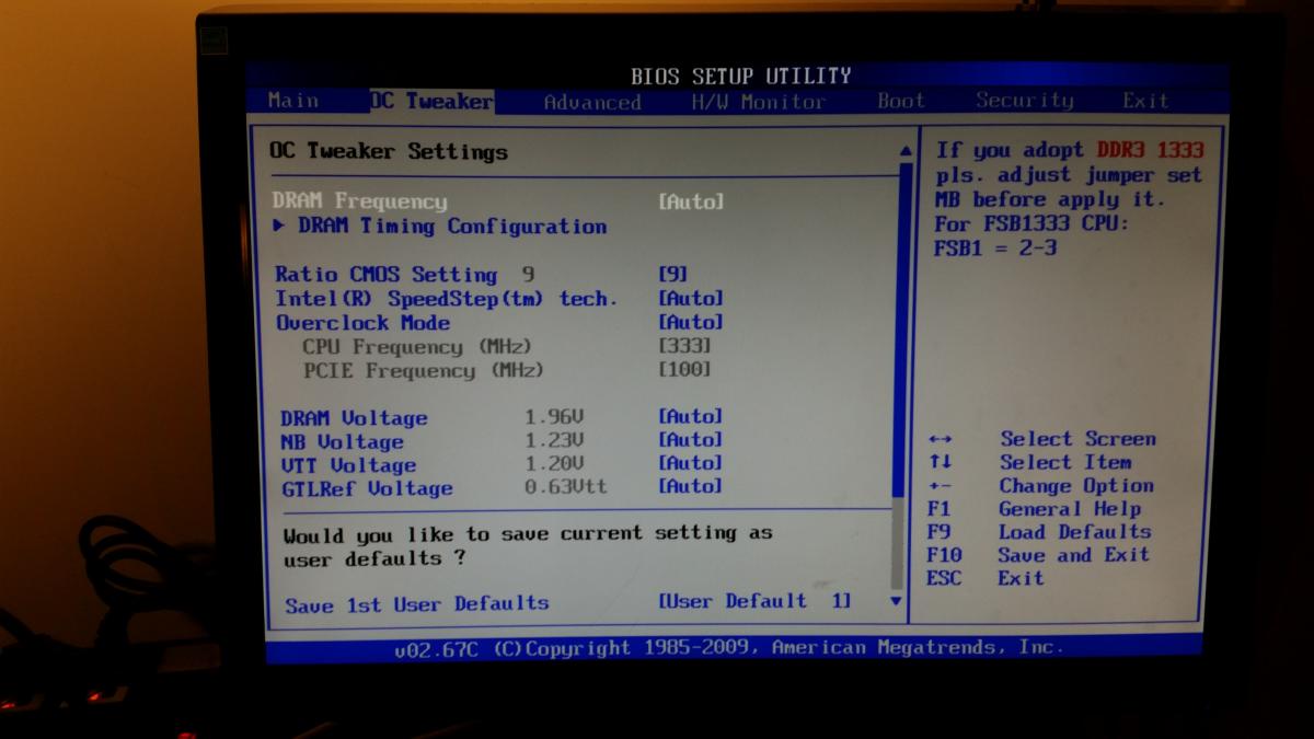

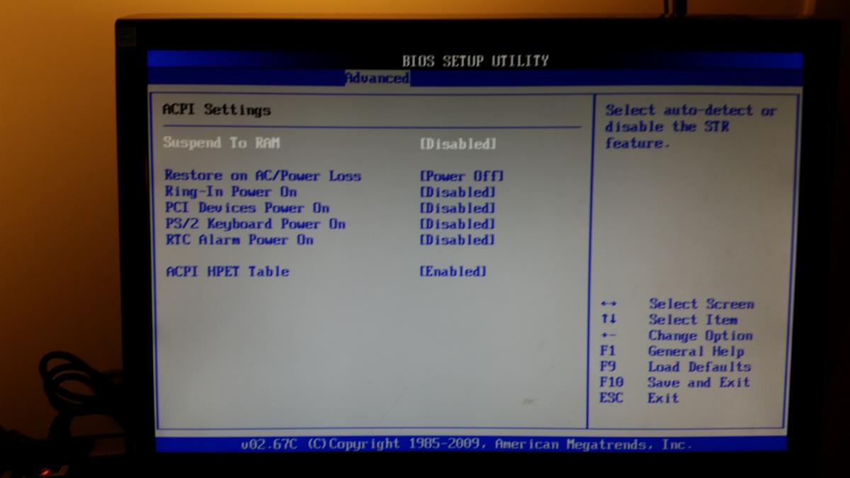

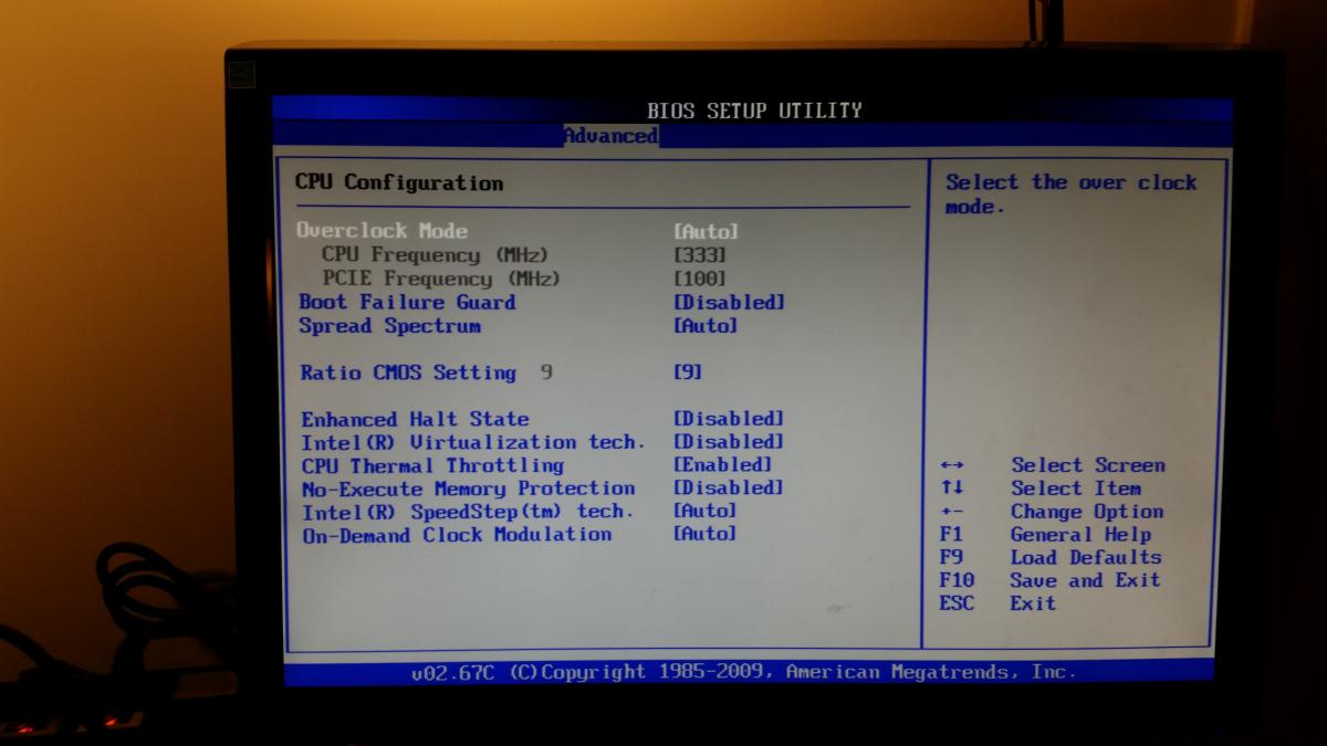

gengik84 Posted January 13, 2018 Author Share Posted January 13, 2018 ok, fai foto al bios,varie voci fai una cartella ed allegala domani guardo Link to comment https://www.insanelymac.com/forum/topic/306828-guida-installazione-mac_os-_x-101x-clover-usb/page/58/#findComment-2568788 Share on other sites More sharing options...
fabio8v Posted January 13, 2018 Share Posted January 13, 2018 ok, grazie Link to comment https://www.insanelymac.com/forum/topic/306828-guida-installazione-mac_os-_x-101x-clover-usb/page/58/#findComment-2568794 Share on other sites More sharing options...
