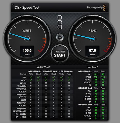

Hallo Mieze (äh sorry, I mean hello :D  )
your driver (v2.0.0d2) runs perfect with Mavericks 10.9.5 and Intel i217 onboard on GA Z87MX-D3H. Here a screen shot of a 5GB test to a Synology DS1010+ NAS with SynologyRaid (similar Raid5 - with the "slow" WD green drives) over gigabit-ethernet.
