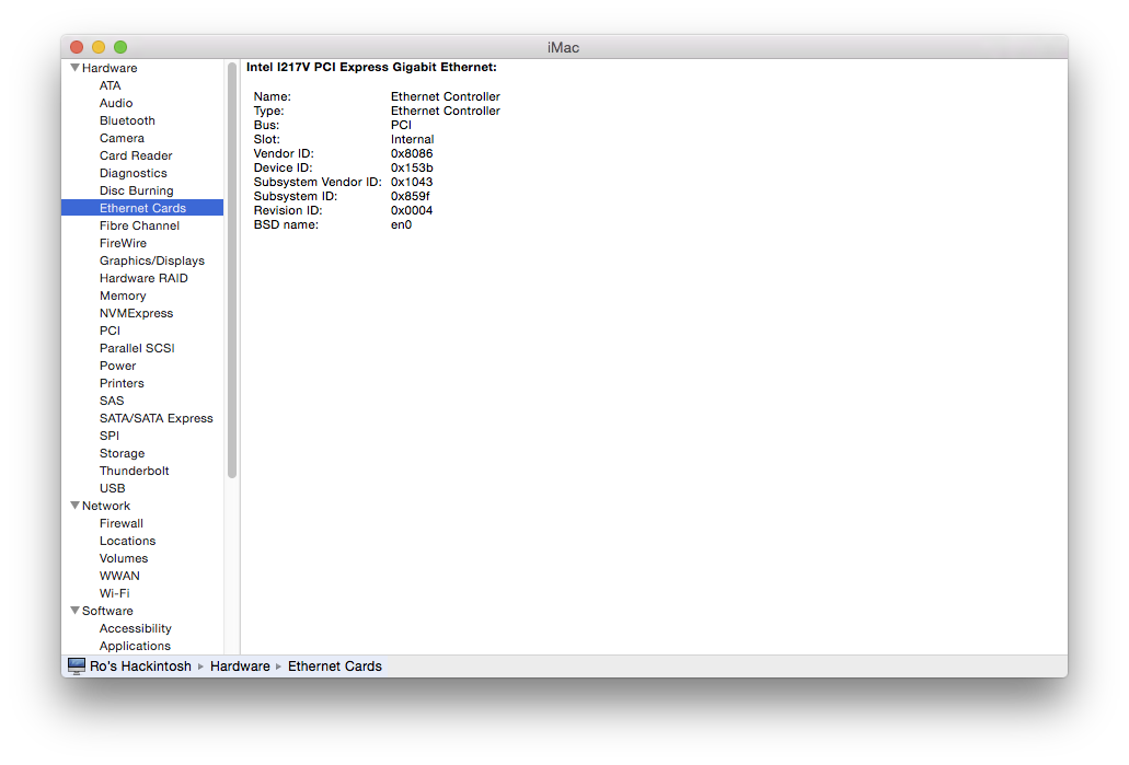

KariNeko Posted May 7, 2015 Share Posted May 7, 2015 Working fine here too Asus Maximus VI Gene ( Z87 ) + Intel I217V PS: Does anybody know why my System Profiler doesn't show the Kext loaded and it's version like anybody else? Link to comment https://www.insanelymac.com/forum/topic/304235-intelmausiethernetkext-for-intel-onboard-lan/page/7/#findComment-2133793 Share on other sites More sharing options...
MilesTEG1 Posted May 7, 2015 Share Posted May 7, 2015 Working fine here too Asus Maximus VI Gene ( Z87 ) + Intel I217V PS: Does anybody know why my System Profiler doesn't show the Kext loaded and it's version like anybody else? I'll check next time I boot under OSX, but it seems to have seen the same thing on my setup... Link to comment https://www.insanelymac.com/forum/topic/304235-intelmausiethernetkext-for-intel-onboard-lan/page/7/#findComment-2133832 Share on other sites More sharing options...
Mieze Posted May 7, 2015 Author Share Posted May 7, 2015 PS: Does anybody know why my System Profiler doesn't show the Kext loaded and it's version like anybody else? Are you injecting the kext with Clover? Mieze Link to comment https://www.insanelymac.com/forum/topic/304235-intelmausiethernetkext-for-intel-onboard-lan/page/7/#findComment-2133841 Share on other sites More sharing options...
Riley Freeman Posted May 7, 2015 Share Posted May 7, 2015 It won't show if you're injecting it from EFI or BIOS. Only if it's in /S/L/E. 2 Link to comment https://www.insanelymac.com/forum/topic/304235-intelmausiethernetkext-for-intel-onboard-lan/page/7/#findComment-2133872 Share on other sites More sharing options...
KariNeko Posted May 7, 2015 Share Posted May 7, 2015 Are you injecting the kext with Clover? Mieze Yup, with Clover. It won't show if you're injecting it from EFI or BIOS. Only if it's in /S/L/E. Ahhh, OK, didn't knew that. Link to comment https://www.insanelymac.com/forum/topic/304235-intelmausiethernetkext-for-intel-onboard-lan/page/7/#findComment-2133898 Share on other sites More sharing options...
MilesTEG1 Posted May 8, 2015 Share Posted May 8, 2015 It won't show if you're injecting it from EFI or BIOS. Only if it's in /S/L/E. Thanks for the info. I have the kext in /S/L/E/ and indeed I've got this : Link to comment https://www.insanelymac.com/forum/topic/304235-intelmausiethernetkext-for-intel-onboard-lan/page/7/#findComment-2133965 Share on other sites More sharing options...
Riley Freeman Posted May 8, 2015 Share Posted May 8, 2015 If you want to know why, check the system log. You'll find this line: "Kext com.insanelymac.IntelMausiEthernet not found for client path request." Basically it can't find the kext post-boot because it was injected by the bootloader. So it can't read the path or version number. Link to comment https://www.insanelymac.com/forum/topic/304235-intelmausiethernetkext-for-intel-onboard-lan/page/7/#findComment-2133989 Share on other sites More sharing options...
KariNeko Posted May 9, 2015 Share Posted May 9, 2015 If you want to know why, check the system log. You'll find this line: "Kext com.insanelymac.IntelMausiEthernet not found for client path request." Basically it can't find the kext post-boot because it was injected by the bootloader. So it can't read the path or version number. Thanks for the detailed information. Link to comment https://www.insanelymac.com/forum/topic/304235-intelmausiethernetkext-for-intel-onboard-lan/page/7/#findComment-2134170 Share on other sites More sharing options...
