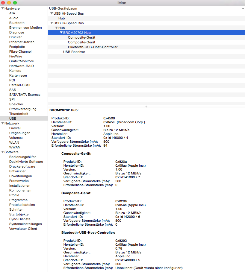

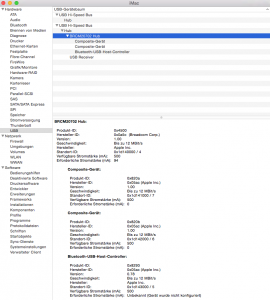

VirusX Posted April 18, 2015 Share Posted April 18, 2015 That didn't help unfortunately. The computer turns back on 1 second after going to sleep but the monitor stays in standby. When I click/hit a button on the keyboard, the monitor turns back on.. I will be busy/not home for the next 2-3 weeks so I will look into it again later... quick follow-up from me. I have been MIA for the last weeks since I wasn't home with my hackintosh. But what I just found out: My computer will sleep with the bluetooth dongle plugged in IF I am more patient: I click on sleep --> computer goes to sleep (everything how it is supposed to be) BUT the computer turns back on after 3 seconds in stand-by. The monitor stays black (standby) though. If I press a button, the monitor turns back on. BUT if I don't do anything after the computer automatically woke up, the computer automatically goes back to sleep like half a minute later. I haven't figured out what exactly is happening but this where I am right now... Link to comment https://www.insanelymac.com/forum/topic/302410-patch-enabling-handoff-for-non-apple-bt4-devices/page/5/#findComment-2129085 Share on other sites More sharing options...
