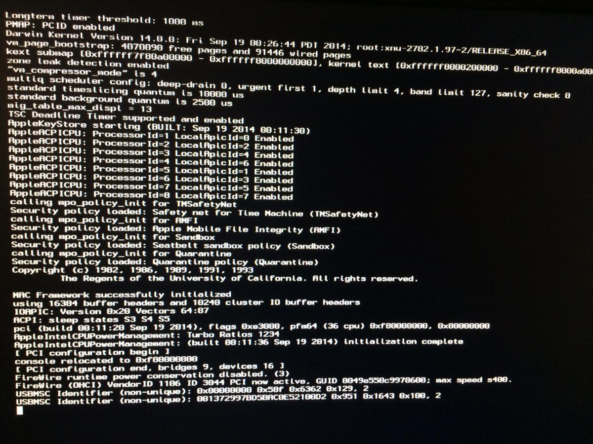

Andreweb83 Posted January 23, 2015 Share Posted January 23, 2015 (edited) Hi, I have created the pendrive but when I try to start it get stuck here: IT Salve, io ho creato la pendrive ma appena provo a farla partire rimane bloccata su una schermata kernel Edited January 23, 2015 by Micky1979 added translation as concorded Link to comment https://www.insanelymac.com/forum/topic/302220-pandoras-box-20-candidate-3-roll-out/page/9/#findComment-2105029 Share on other sites More sharing options...

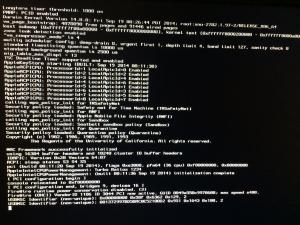

Andreweb83 Posted January 23, 2015 Share Posted January 23, 2015 (edited) Here is the screen shot IT Ecco lo screen shot Edited January 23, 2015 by Micky1979 added translation as concorded Link to comment https://www.insanelymac.com/forum/topic/302220-pandoras-box-20-candidate-3-roll-out/page/9/#findComment-2105078 Share on other sites More sharing options...
Micky1979 Posted January 23, 2015 Author Share Posted January 23, 2015 Sorry I was thinking that you had problem creating the installer, but you already got it succesfully.. Can you try to type GraphicsEnabler=No at boot time? Scusa avevo capito avessi problemi creando l'installer, invece quello è ok. Hai provato con GraphicsEnabler=No al boot? Link to comment https://www.insanelymac.com/forum/topic/302220-pandoras-box-20-candidate-3-roll-out/page/9/#findComment-2105081 Share on other sites More sharing options...
Andreweb83 Posted January 23, 2015 Share Posted January 23, 2015 (edited) yes, but nothing changes I would not like that I have created a bad USB stick ... the hardware is the same identical signature, I did not change anything! IT si, ma non cambia nulla non vorrei aver creato male la pendrive... l'hardware è lo stesso identico in firma, non ho cambiato nulla! Edited January 23, 2015 by Micky1979 added translation as concorded Link to comment https://www.insanelymac.com/forum/topic/302220-pandoras-box-20-candidate-3-roll-out/page/9/#findComment-2105082 Share on other sites More sharing options...
Micky1979 Posted January 23, 2015 Author Share Posted January 23, 2015 From the pict I only see that you have more than one USB devices, but this is fine. Tried with -x? Dalla foto sembra tutto ok, provato con -x? try also GraphicsEnabler=No VBIOS=Yes -x Link to comment https://www.insanelymac.com/forum/topic/302220-pandoras-box-20-candidate-3-roll-out/page/9/#findComment-2105083 Share on other sites More sharing options...
Andreweb83 Posted January 23, 2015 Share Posted January 23, 2015 (edited) ok it started with -x ... only DVI ports is working, no hdmi nor vga ... in the meantime I try to install IT con -x è partito... mi va solo su DVI però, ne con hdmi ne vga... intanto installo e vediamo se va a buon fine Edited January 23, 2015 by Micky1979 added translation as concorded Link to comment https://www.insanelymac.com/forum/topic/302220-pandoras-box-20-candidate-3-roll-out/page/9/#findComment-2105084 Share on other sites More sharing options...
Micky1979 Posted January 23, 2015 Author Share Posted January 23, 2015 con -x è partito... mi va solo su DVI però, ne con hdmi ne vga... intanto installo e vediamo se va a buon fine Ok you need to play with the framebuffer, example: IT Devi giocare con le impostazioni seguenti: <?xml version="1.0" encoding="UTF-8"?> <!DOCTYPE plist PUBLIC "-//Apple//DTD PLIST 1.0//EN" "http://www.apple.com/DTDs/PropertyList-1.0.dtd"> <plist version="1.0"> <dict> <key>AtiConfig</key> <string>Vervet</string> <key>AtiPorts</key> <string>3</string> <key>GraphicsEnabler</key> <string>No</string> <key>UseAtiROM</key> (questa la devi avere o trovare su techpowerup) <string>Yes</string> </dict> </plist> Link to comment https://www.insanelymac.com/forum/topic/302220-pandoras-box-20-candidate-3-roll-out/page/9/#findComment-2105087 Share on other sites More sharing options...
