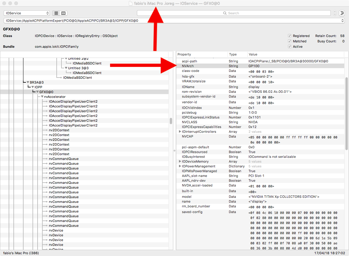

NVARCH =GP100  value(where come from?)

	NVArch:					GP100

my GFX chipset is GP102
https://videocardz.net/gpu/nvidia-gp102/

1 hour ago, vector sigma said:
Hi fabiosun, GP100 comes from your ioreg (is your ioreg):
.. but don't tell me why.
Ok
Maybe I know why
I thought you read data directly from GFX instead of using ioreg which is probably wrong due data passed by Nvidia driver..which supports GP102 but maybe named it GP100
Thank you for your answer and efforts
