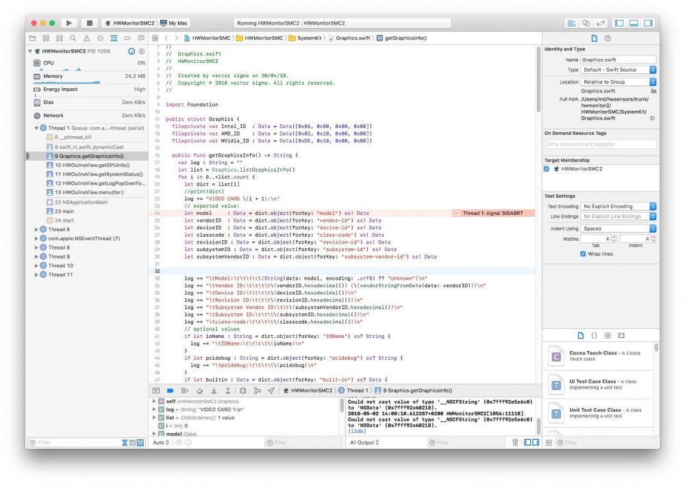

Taken from edk2, I'm making this to work with:
struct EDID_BLOCK {
    var Header                        : [UInt8] = [UInt8](repeating: 0, count: 8) //EDID header "00 FF FF FF FF FF FF 00"
    var ManufactureName               : UInt16  = 0                               //EISA 3-character ID
    var ProductCode                   : UInt16  = 0                               //Vendor assigned code
    var SerialNumber                  : UInt32  = 0                               //32-bit serial number
    var WeekOfManufacture             : UInt8   = 0                               //Week number
    var YearOfManufacture             : UInt8   = 0                               //Year
    var EdidVersion                   : UInt8   = 0                               //EDID Structure Version
    var EdidRevision                  : UInt8   = 0                               //EDID Structure Revision
    var VideoInputDefinition          : UInt8   = 0
    var MaxHorizontalImageSize        : UInt8   = 0                               //cm
    var MaxVerticalImageSize          : UInt8   = 0                               //cm
    var DisplayTransferCharacteristic : UInt8   = 0
    var FeatureSupport                : UInt8   = 0
    var RedGreenLowBits               : UInt8   = 0                               //Rx1 Rx0 Ry1 Ry0 Gx1 Gx0 Gy1Gy0
    var BlueWhiteLowBits              : UInt8   = 0                               //Bx1 Bx0 By1 By0 Wx1 Wx0 Wy1 Wy0
    var RedX                          : UInt8   = 0                               //Red-x Bits 9 - 2
    var RedY                          : UInt8   = 0                               //Red-y Bits 9 - 2
    var GreenX                        : UInt8   = 0                               //Green-x Bits 9 - 2
    var GreenY                        : UInt8   = 0                               //Green-y Bits 9 - 2
    var BlueX                         : UInt8   = 0                               //Blue-x Bits 9 - 2
    var BlueY                         : UInt8   = 0                               //Blue-y Bits 9 - 2
    var WhiteX                        : UInt8   = 0                               //White-x Bits 9 - 2
    var WhiteY                        : UInt8   = 0                               //White-x Bits 9 - 2
    var EstablishedTimings            : [UInt8] = [UInt8](repeating: 0, count: 3)
    var StandardTimingIdentification  : [UInt8] = [UInt8](repeating: 0, count: 16)
    var DetailedTimingDescriptions    : [UInt8] = [UInt8](repeating: 0, count: 72)
    var ExtensionFlag                 : UInt8   = 0                               //Number of (optional) 128-byte EDID extension blocks to follow
    var Checksum                      : UInt8   = 0
  typealias EDID = EDID_BLOCK
...let you know

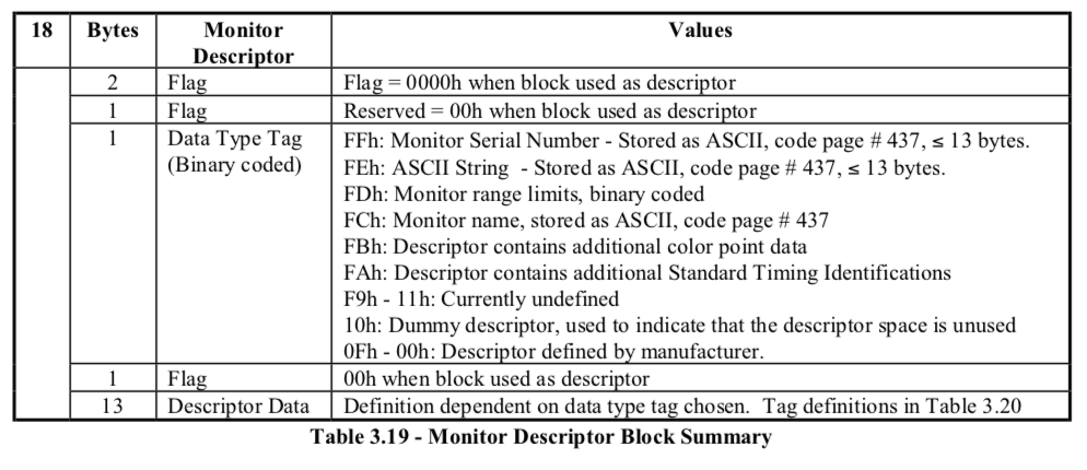

EDK2 is not right.
DetailedTimingDescriptions = 4 * 18 - four structures size 18
Full description in http://read.pudn.com/downloads110/ebook/456020/E-EDID Standard.pdf

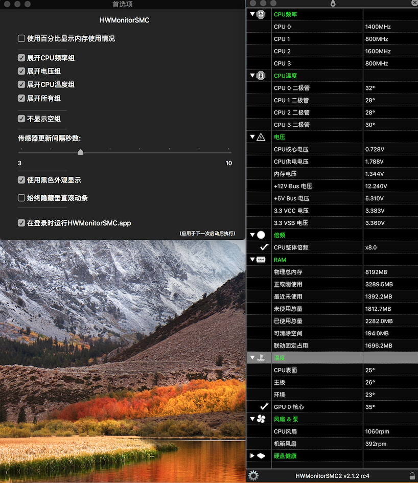

HWMonitor2 v2.1.0rc3:
Spoiler
HWMonitorSMC2 v2.1.0 rc3
MACHINE STATUS:
   CPU:
    Name: Intel(R) Core(TM) i7-6700K CPU @ 4.00GHz
    Vendor: GenuineIntel
    Physical cores: 4
    Logical cores: 8
    Family: 6
    Model: 0x5E
    Ext Model: 0x5
    Ext Family: 0
    Stepping: 3
    Signature: 0x506E3
    Brand: 0
    Features:  FPU VME DE PSE TSC MSR PAE MCE
                    CX8 APIC SEP MTRR PGE MCA CMOV PAT
                    PSE36 CLFSH DS ACPI MMX FXSR SSE SSE2
                    SS HTT TM PBE SSE3 PCLMULQDQ DTES64 MON
                    DSCPL VMX EST TM2 SSSE3 FMA CX16 TPR
                    PDCM SSE4.1 SSE4.2 x2APIC MOVBE POPCNT AES PCID
                    XSAVE OSXSAVE SEGLIM64 TSCTMR AVX1.0 RDRAND F16C
    Ext Features:  SYSCALL XD 1GBPAGE EM64T LAHF LZCNT PREFETCHW RDTSCP
                          TSCI
    Microcode version: 194
    Thermal sensors: 1
    Thermal invariant APIC timer: 1
    System: 7%
    User: 6%
    Idle: 86%
    Nice: 0%
   MEMORY:
    Physical size: 32.0GB
    Free: 27.96GB
    Wired: 2.06GB
    Active: 1.72GB
    Inactive: 256MB
    Compressed: 0MB
   SYSTEM:
    Model: iMac18,3
    Sys name: Darwin
    Node name: confidential
    Release: 17.5.0
    Version: Darwin Kernel Version 17.5.0: Fri Apr 13 19:32:32 PDT 2018; root:xnu-4570.51.2~1/RELEASE_X86_64
    Machine: x86_64
    Uptime: 0d 0h 1m 38s
    Processes: 262
    Threads: 916
    Load Average: [1.93, 1.01, 0.42]
    Mach Factor: [7.7389999999999999, 6.8650000000000002, 6.141]
   POWER:
    CPU Speed limit: 100.0%
    CPUs available: 8
    Scheduler limit: 100.0%
    Thermal level: Not Published
   SCREEN 0:
    Framebuffer: 0x1B5DD114
    Depth bits Per Pixel: 24
    Depth bits Per Sample: 8
    Depth is Planar: false
    Frame: (0.0, 0.0, 3840.0, 1600.0)
    Visible Frame: (0.0, 80.0, 3840.0, 1498.0)
    Depth backing Scale Factor: 1.0
    Name: LG ULTRAWIDE
    Vendor Id: 0x1E6D (7789)
    Product Id: 0x76FC (30460)
    Serial Number: 224789
    Year Of Manufacture: 2017
    Week of Manufacture: 9
    Blue Point X: 0.150390625
    Blue Point Y: 0.0595703125
    Green Point Y: 0.306640625
    Green Point Y: 0.630859375
    Red Point X: 0.6513671875
    Red Point Y: 0.33203125
    White Point X: 0.3134765625
    White Point Y: 0.3291015625
    White Gamma: 2.20000004768372
    Brightness Affects Gamma: true
    Horizontal Image Size: 870
    Vertical Image Size: 370
    Is Digital: true
    Is HDMI Sink: false
    EDID data:
    0x00, 0xFF, 0xFF, 0xFF, 0xFF, 0xFF, 0xFF, 0x00,
    0x1E, 0x6D, 0xFC, 0x76, 0x15, 0x6E, 0x03, 0x00,
    0x09, 0x1B, 0x01, 0x04, 0xB5, 0x57, 0x25, 0x78,
    0x9F, 0xCA, 0x95, 0xA6, 0x55, 0x4E, 0xA1, 0x26,
    0x0F, 0x50, 0x54, 0x04, 0x63, 0x80, 0x01, 0x01,
72 bytes looks just the same to me, Ok just define one additional struct for all the four blocks (or an array of structs). edk2 only parse the "Standard Timing Identification"  maybe for a good reason for their purpose.

Hi @Slice, I need some info. I can easily found info about graphics card in the IOPCIDevice by searching for the "model" entry.. only this looks fragile.
Can I assume that "graphic-options" is always present for all the video cards??
P.S. last night I've committed our EDID parser..
EDIT
maybe the class code is better, here is <00000300> for both integrated and discrete :)
Edited by vector sigma

6 hours ago, maoyeye said:
Localizable.strings
zh-Hans.lproj
Thanks!!
 But you should use a text editor to do that not a Plist Editor! I've corrected the file with a normal encoding and it becomes like that now:

9 minutes ago, maoyeye said:
NO
Thanks. below the new app with semplified Chinese :D.
Guys, this version: HWSensors-3_r133.dmg is able to show detailed GPU/IGPU informations (on right click), more last night I've also committed a new EDID parser , please report back to confirm no bugs are present (or to be fixed :rofl:)
Quote

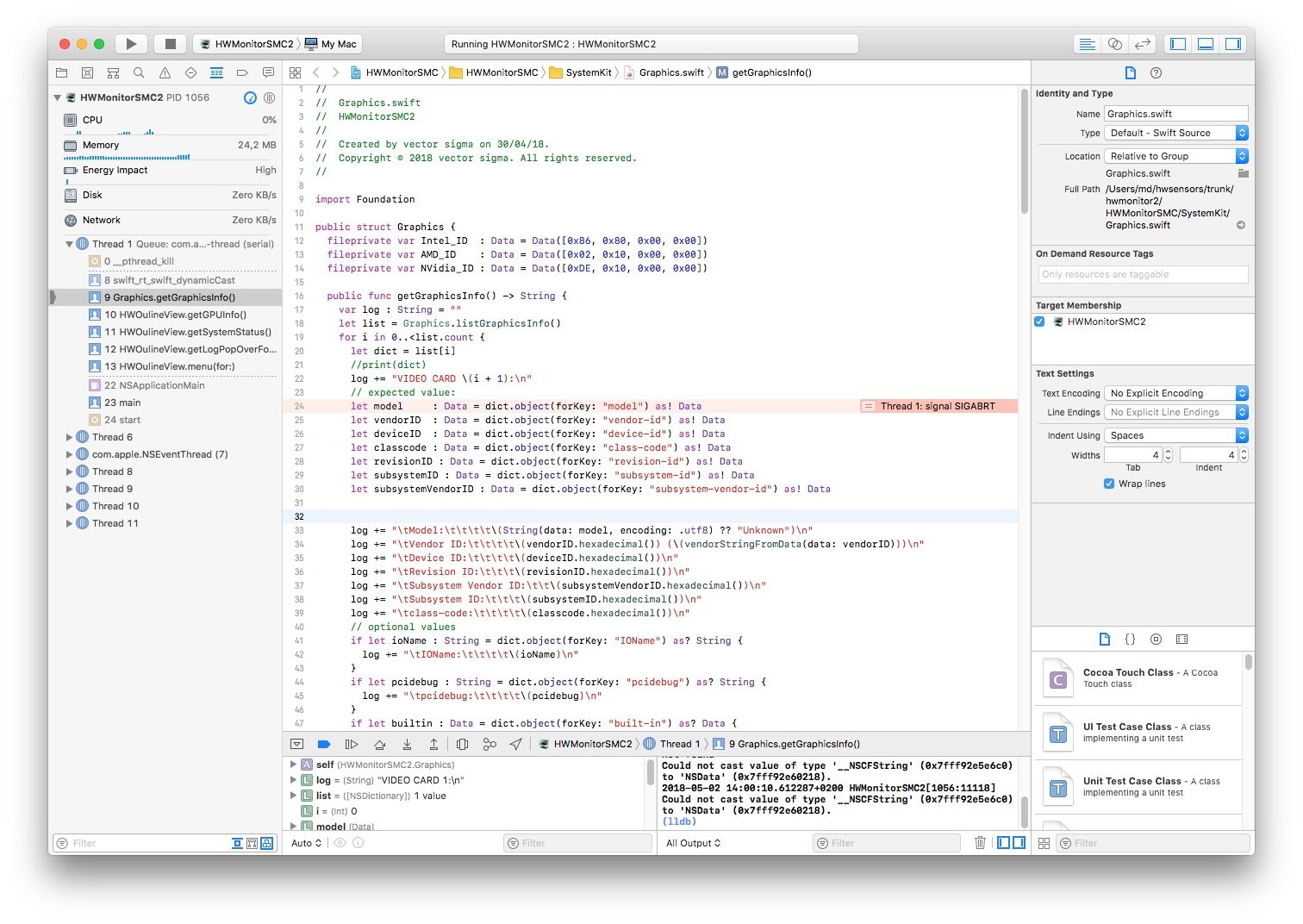

Sorry, maybe it is just me or there is still a bug:
if i rightclick into VOLTAGE, TEMPERATURE, FANS OR PUMPS and MEDIAHEALTH, the App quits normally (like it was receiving "Command-Q").
On all other panes i get the expanded infos like CPU-details, RAM-details or MEDIA-details etc.
The app doesn't quit unexpected - no, it just quits like it does when pressing "Command-Q". With r129 i didn't had these behavior. Anyone else did recognize this with r133 ?
Edited by Mork vom Ork
Don't panic Lol, there's a lot of new code where I kept fore sure that some keys are present, may be not. Have you Xcode 9.3 to build the project?
10 hours ago, Mork vom Ork said:
I do
Ok. Please follow these instruction (and sorry if are obvious to you)
1) Ensure the command line tools are those coming with Xcode 9.3 in Preferences -> Locations-> "Xcode 9.3 (9E145)"
2) cd into Home:
cd $HOME
checkout the latest rev:
svn checkout https://svn.code.sf.net/p/hwsensors/hwsensors3/code3/ hwsensors3
3) Now go in your Home folder and navigate in ~/hwsensors3/trunk/hwmonitor2 and open HWMonitorSMC.xcodeproj with Xcode 9.3
4) Press play and the app should compile and run. Now right click on the problematic row and you should be able to see where the problem is, marked with a red line. Please post a picture.
I'm working right now so I'll see the report in not less then 4hours (in the case you'll do that before I'm at Home). Thanks!
ok, so here is the requested screenshot of where it hangs, when rightclicking (for example) on the FAN AND PUMPS pane:
see attached screenshot:
1869771600_Bildschirmfoto2018-05-02um14_02_09.thumb.jpg.e2d11d6aea649d6992c0fb9ef6d45afc.jpg
just a note: i do NOT run any LILU/WhatEverGreen kext to get my Sapphire RX480 working properly. Just SSDT for it with framebuffer- and AGDC-patch
Hello vector sigma
test version r133 right key no GPU information
