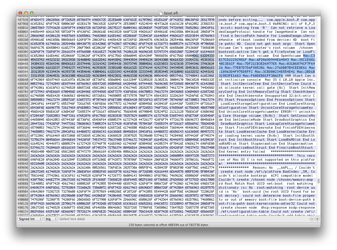

boot.efi checks the board-id and sets var "BlackMode" to 1 when it finds one of these:
Mac-C3EC7CD22292981F = MacBookPro10,1
Mac-AFD8A9D944EA4843 = MacBookPro10,2
Mac-35C1E88140C3E6CF = MacBookAir6,1
Mac-7DF21CB3ED6977E5 = MacBookAir6,2
Mac-031B6874CF7F642A = iMac14,1
Mac-77EB7D7DAF985301 = iMac14,3
Mac-27ADBB7B4CEE8E61 = iMac14,2
Mac-189A3D4F975D5FFC = MacBookPro11,1
Mac-3CBD00234E554E41 = MacBookPro11,2
Mac-2BD1B31983FE1663 = MacBookPro11,3
Mac-F60DEB81FF30ACF6 = MacPro6,1
There's also this:
bootArgs->flags |= kBootArgsFlagBlack (EFI var 'BlackMode')
But I have MacbookAir5,2 for my SMBios, and still get black background and white progress bar. It may means something else affect the boot screen?

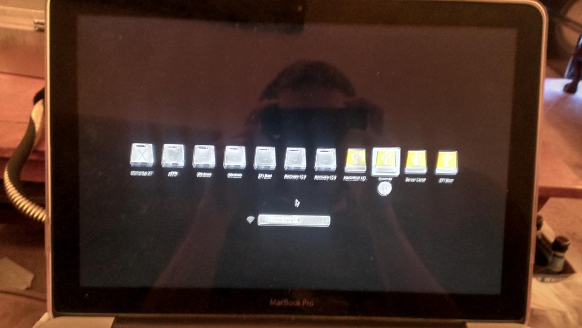

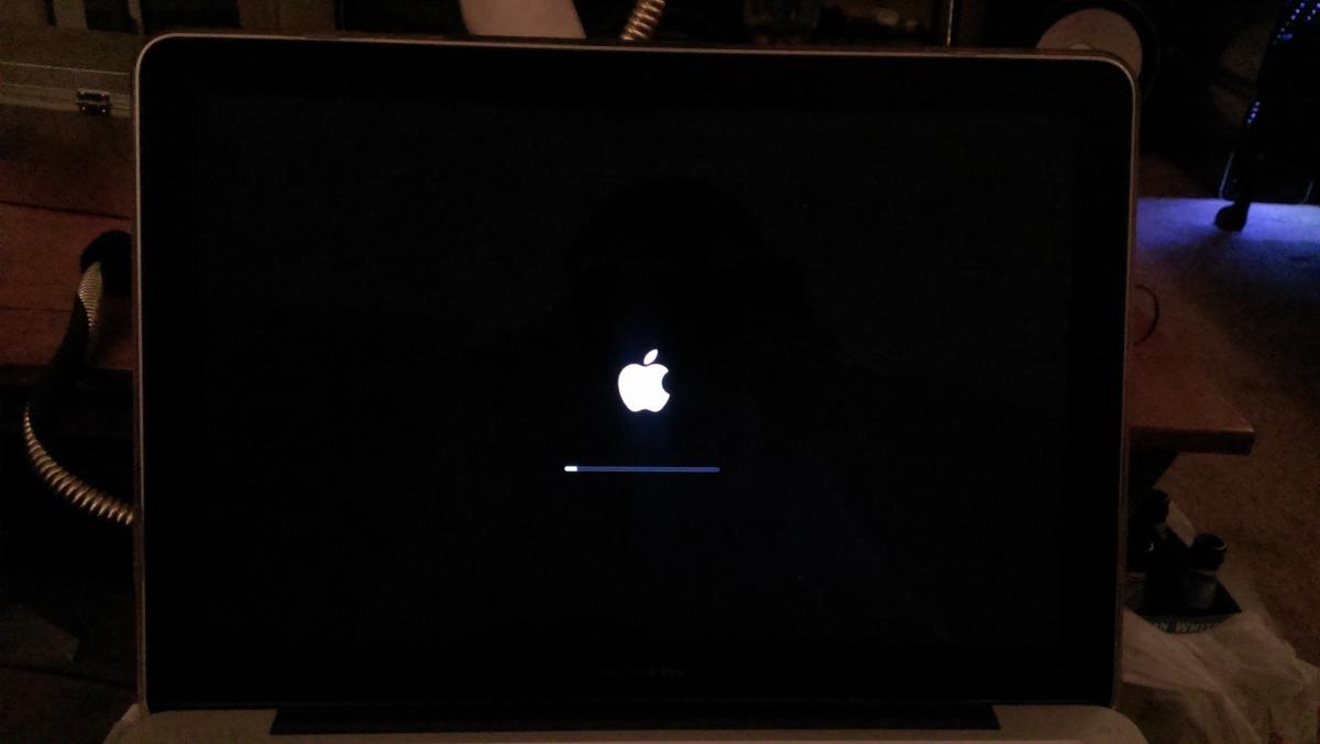

I don't know if this is useful for you guys at all, but I'm running clover on a real 2011 mbp. Booting it via clover I have the full boot sequence with the white boot screen + gray apple logo.
I tried using the macbookpro10,1 board id but I still get the white screen.
Edit: ooh! Here's something really interesting. Yosemite got confused about me using the mbp10,1 board id and refused to boot all the way. So of course, I rebooted and held down the option key so I could boot without clover and fix what I had just changed. I was greeted by a black background at the partition chooser screen, and Yosemite then booted with the black screen and white logo despite the fact that it knew I was on a mbp8,1. Sorry, I know this isn't exactly relevant, I was actually hoping I would be able to replicate the issue you guys are having (which I am also having on my X202E) on a real Mac running Clover. Anyway here's some photos of it, as well as a DarwinDumper from right after it happened in case it's useful.

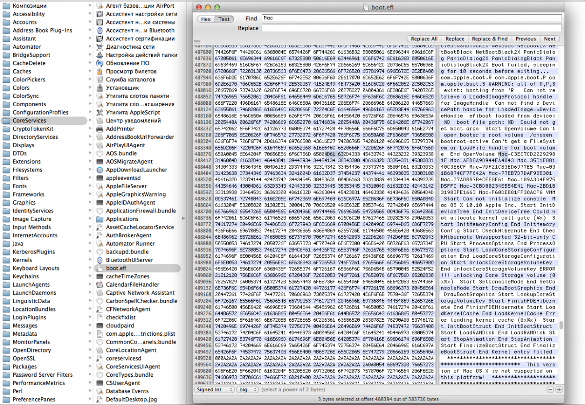

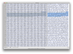

I've got black boot screen on my MM 2012, just by replacing in boot.efi MP 6.1 board id on my. BTW i don't have kBootArgsFlagBlack var
how do you edit boot.efi? I'm looking at it with Hex Fiend but I don't see anything like Board ID's that I could change.

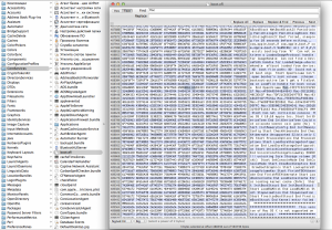

@VanillaCracker are you sure it's CoreServices because I can't find the board id section in that one, only the i386 one. I edited the i386 one but it didn't make a difference. Maybe I need to reboot a few more times.
Yep. i386 it's a path for old firmwares
You see. Just what I said a few posts back: boot.efi checks the board-id, and now you have what you want. by the way. The kernel flag kBootArgsFlagBlack represents a value of 4 and is used to OR the flags value, and to check if BlackMode is active.
