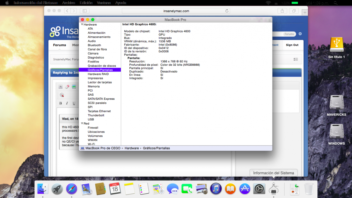

CEGOCAP Posted June 18, 2014 Share Posted June 18, 2014 this HD 4600 graphics card has 2 device id's. 0x04128086 for desktop PC and 0x04168086 for laptops, based on processors inside. the first device id is present inside both azul framebuffer and appleintelhd5000graphics kext. I also installed DP2 but no QE/CI yet. To enable QE i have to inject a fake device id 0x04128086 using clover to get my card detected. This is because I have a mobile processor with 0x04168086 intel graphics chipset. injected fake device id the resolution its fine without modifying kexts but no qe/ci 1 Link to comment https://www.insanelymac.com/forum/topic/298591-intel-hd-4600-qeci-yosemite/page/3/#findComment-2031728 Share on other sites More sharing options...

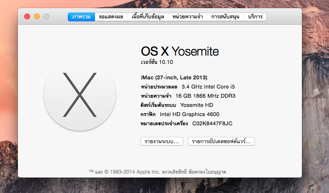

naiclub Posted June 19, 2014 Share Posted June 19, 2014 Work HD4600 dp2 Link to comment https://www.insanelymac.com/forum/topic/298591-intel-hd-4600-qeci-yosemite/page/3/#findComment-2031918 Share on other sites More sharing options...
warlikewings Posted June 19, 2014 Share Posted June 19, 2014 Desktop version or mobile version? Link to comment https://www.insanelymac.com/forum/topic/298591-intel-hd-4600-qeci-yosemite/page/3/#findComment-2031925 Share on other sites More sharing options...
naiclub Posted June 19, 2014 Share Posted June 19, 2014 Desktop version or mobile version? Desktop version Link to comment https://www.insanelymac.com/forum/topic/298591-intel-hd-4600-qeci-yosemite/page/3/#findComment-2031929 Share on other sites More sharing options...
warlikewings Posted June 19, 2014 Share Posted June 19, 2014 Ah. Yeah, it's the mobiles that aren't working just yet... Link to comment https://www.insanelymac.com/forum/topic/298591-intel-hd-4600-qeci-yosemite/page/3/#findComment-2031944 Share on other sites More sharing options...
Grzesiek13 Posted June 19, 2014 Share Posted June 19, 2014 Work HD4600 dp2 จับภาพหน้าจอ 2557-06-19 เวลา 10.59.17.png How did you do this? I get no signal every time i want to enable QE/CI with Clover :/ 1 Link to comment https://www.insanelymac.com/forum/topic/298591-intel-hd-4600-qeci-yosemite/page/3/#findComment-2032071 Share on other sites More sharing options...

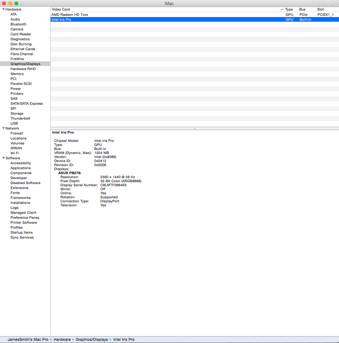

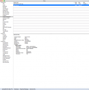

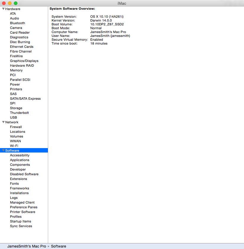

jsl Posted June 21, 2014 Share Posted June 21, 2014 Both Intel HD4600 and AMD 7950 display cards are working in 10.10 DP2 now. Just using previous DSDT.aml and SSDT.aml in Mavericks in org.chameleon.Boot.plist. org.chameleon.Boot.plist.zip Link to comment https://www.insanelymac.com/forum/topic/298591-intel-hd-4600-qeci-yosemite/page/3/#findComment-2032664 Share on other sites More sharing options...
wusa Posted June 21, 2014 Author Share Posted June 21, 2014 Both Intel HD4600 and AMD 7950 display cards are working in 10.10 DP2 now. Just using previous DSDT.aml and SSDT.aml in Mavericks in org.chameleon.Boot.plist. Your HD 4600 are working because you are using the Desktop version. Desktop version and mobile version have different IDs. Desktop: 0x04128086, Mobile: 0x04168086. In AppleIntelHD5000Graphics.kext's and AppleIntelFramebufferAzul.kext's plists have only device IDs for Desktop version of HD 4600. 1 Link to comment https://www.insanelymac.com/forum/topic/298591-intel-hd-4600-qeci-yosemite/page/3/#findComment-2032714 Share on other sites More sharing options...
