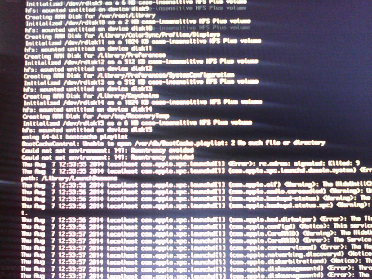

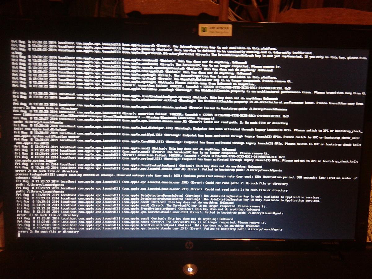

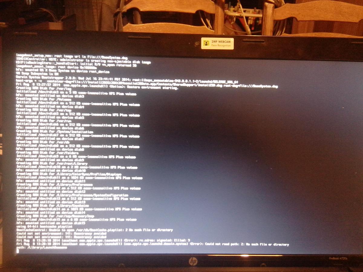

Lieutenant commander Data Posted August 7, 2014 Share Posted August 7, 2014 Hello everyone i have a HP ProBook 4720s laptop. i used method described at beggining of topic. and i copied files which were located on USB install drive to HDD partition using restore function in disk utility in mavericks because booting directly from USB was not successful. now i can get mac os utilities screen but touchpad and keyboard are not working, also i get a bunch of errors and warnings during boot in verbose mode. EDIT: added two more pictures Link to comment https://www.insanelymac.com/forum/topic/298521-easy-yosemite-1010-final-usb-installer-updated-10162014/page/7/#findComment-2049457 Share on other sites More sharing options...
aww Posted August 8, 2014 Share Posted August 8, 2014 re:Lieutenant commander Data error messages ok, unsigned kexts were forced to load. Try any versions of voodooPS2controller kext, keyboard will work, need to test different version of PS2 controller to make touch pad work. Copy VoodooPS2Controller kext to SLE, boot to single user mode to fix permission and ownership and reboot will work. 1 Link to comment https://www.insanelymac.com/forum/topic/298521-easy-yosemite-1010-final-usb-installer-updated-10162014/page/7/#findComment-2049850 Share on other sites More sharing options...

Lieutenant commander Data Posted August 9, 2014 Share Posted August 9, 2014 re:Lieutenant commander Data error messages ok, unsigned kexts were forced to load. Try any versions of voodooPS2controller kext, keyboard will work, need to test different version of PS2 controller to make touch pad work. Copy VoodooPS2Controller kext to SLE, boot to single user mode to fix permission and ownership and reboot will work. hello. i think i SOLVED THE PROBLEM!!!! ))) i downloadeded latest copy of fakesmc for yosemite, then downloaded synaptics ps2 trackpad kext and then all of this copied to install partition in EFI/CLOVER/kexts/10.10 (as described in this topic) . i think that clover automaticly injects these kexts into system. i was able to run installation and install yosemite but now clover can t see yosemite partition. i shutdown computer and went to a birthday party ) logically, i think that solution is to install clover in mavericks to yosemite partition and use mentioned kexts. thank you for assistance. God bless you!!! EDIT: these new two picures i added were been taken before than i used the solution above. Link to comment https://www.insanelymac.com/forum/topic/298521-easy-yosemite-1010-final-usb-installer-updated-10162014/page/7/#findComment-2050132 Share on other sites More sharing options...

Lieutenant commander Data Posted August 11, 2014 Share Posted August 11, 2014 i ve MADE IT!! )) when i ran the install process and after the process ended i shutdowned the computer. then i booted again from install drive and the instalation process continued. after install was finished, in mavericks i installed clover on EFI system partition and copied kexts in EFI/CLOVER/kexts/10.10 folder on efi system partition. then i rebooted computer and after entered into yosemite!! i used Clover_v2k_r2780_Special Edition_Yosemite Beta thank you guys!! sorry for my bad english. Link to comment https://www.insanelymac.com/forum/topic/298521-easy-yosemite-1010-final-usb-installer-updated-10162014/page/7/#findComment-2050634 Share on other sites More sharing options...
