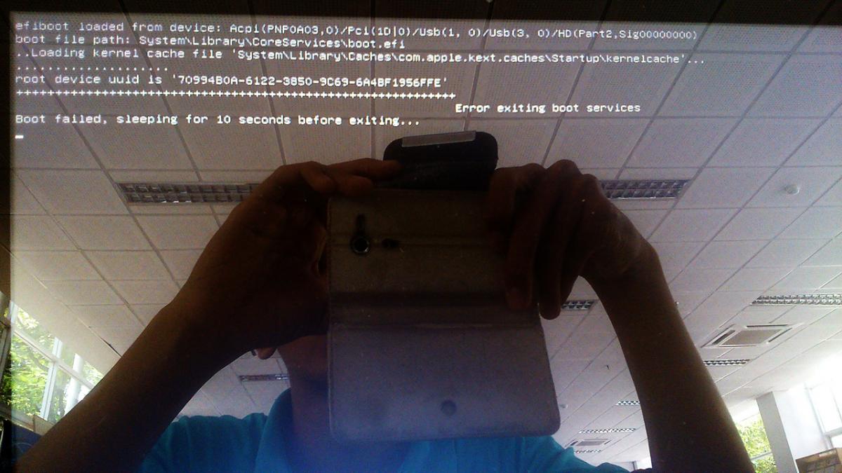

TheSuitIsNotBlack Posted March 14, 2015 Share Posted March 14, 2015 I followed the instructions for yosemite installation via clover, used choice #2 to manually create the installer, and was very careful to choose the proper config options, but and I am running into a problem. When I boot from the USB, it leads me to a black screen with a circle/slash icon in the middle. Also, it doesn't say “Boot OS X Install from Install OS X Yosemite” as the instructions mention, but rather it says "Boot Mac OS X from OS X Base System". Is it supposed to say that? Here's my config.plist https://www.dropbox.com/s/oo8alcur2vw4zxi/config.plist?dl=0 It seems to get stuck at the "Missing Bluetooth Controller Transport!" I don't have any bluetooth devices hooked up, nor did I choose any bluetooth settings from the vietnam tool. Link to comment Share on other sites More sharing options...

TheSuitIsNotBlack Posted March 15, 2015 Share Posted March 15, 2015 This simply means the installer couldn't find your USB Volume. If you have USB3.0 add GenericUSBXHCI.kext in clover's kexts folder, you should get USB working, after Install, make a DSDT and apply the propper USB3.0 Patch and remove the kext from earlier. This kext may give you issues with sleep and wake, and may have some lags, as it can perform better than the patch, then here you must configure the patch manually, and you really must remove that kext. Only in one condition not to remove that kext: if you have a USB3.0 controller other than Intel. I'm using USB 2.0 hello should not inject the nvidia ... and join this in boot arguments -gux_defer_usb2 -gux_no_idle good hack I removed graphics injection and used those boot arguments, but still have the same issue. Link to comment Share on other sites More sharing options...
TheSuitIsNotBlack Posted March 15, 2015 Share Posted March 15, 2015 Ok, I completely removed my graphics card altogether, reset the BIOS CMOS to factory default, removed everything other than the keyboard and the hard drive, started fresh with a new clover usb setup, and now it's giving me a new error: "Still waiting for root device". I followed the troubleshooting guide in this thread, installed the 'waiting for root device' patch from vietnam tool, and added the GenericUSBXHCI.kext to the kexts folder. Still have the error. I'm at a loss. I can't think of anything else to do. Link to comment Share on other sites More sharing options...
anonymousnbs Posted March 16, 2015 Share Posted March 16, 2015 Ok, I completely removed my graphics card altogether, reset the BIOS CMOS to factory default, removed everything other than the keyboard and the hard drive, started fresh with a new clover usb setup, and now it's giving me a new error: "Still waiting for root device". I followed the troubleshooting guide in this thread, installed the 'waiting for root device' patch from vietnam tool, and added the GenericUSBXHCI.kext to the kexts folder. Still have the error. I'm at a loss. I can't think of anything else to do. u have unplug usb 3.0 and plug usb 2.0 and try it Link to comment Share on other sites More sharing options...
vusun123 Posted March 16, 2015 Share Posted March 16, 2015 Ok, I completely removed my graphics card altogether, reset the BIOS CMOS to factory default, removed everything other than the keyboard and the hard drive, started fresh with a new clover usb setup, and now it's giving me a new error: "Still waiting for root device". I followed the troubleshooting guide in this thread, installed the 'waiting for root device' patch from vietnam tool, and added the GenericUSBXHCI.kext to the kexts folder. Still have the error. I'm at a loss. I can't think of anything else to do. HVT's output config.plist has DropOEM=True by default, and that is the main reason it caused " still waiting for root devices " on 9 series boards. Please set it to False Link to comment Share on other sites More sharing options...

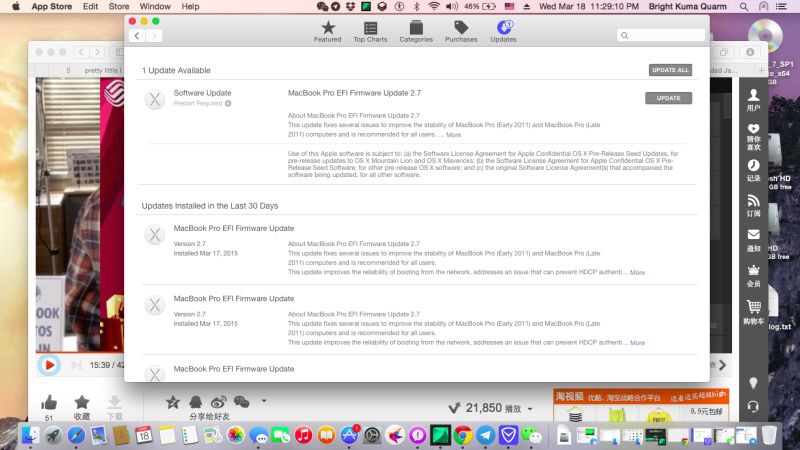

teddybearapple Posted March 18, 2015 Share Posted March 18, 2015 Has any of you seen such update. If yes what is that? Or something to do with my clover EFI boot loader? Link to comment Share on other sites More sharing options...
midi-sama Posted March 18, 2015 Share Posted March 18, 2015 Dont do it!!!!! It may change the boot order in UEFI and {censored} up your firmware!!! Dont do it!!!!! It may change the boot order in UEFI and {censored} up your firmware!!! 1 Link to comment Share on other sites More sharing options...
teddybearapple Posted March 18, 2015 Share Posted March 18, 2015 Dont do it!!!!! It may change the boot order in UEFI and {censored} up your firmware!!! Dont do it!!!!! It may change the boot order in UEFI and {censored} up your firmware!!! In fact, I did it the very first time I saw it and yes it messed up my boot order I was so lucky that I always keep my EFI config.plist on my usb as well as my usb installer. I am not going to update the hell of it again. Any idea where from that update? Link to comment Share on other sites More sharing options...
midi-sama Posted March 18, 2015 Share Posted March 18, 2015 Dude, it has nothing to so with clover, but your uefi firmware! And here where stuff get problematic! Dude, it has nothing to so with clover, but your uefi firmware! And here where stuff get problematic! Link to comment Share on other sites More sharing options...
TheSuitIsNotBlack Posted March 19, 2015 Share Posted March 19, 2015 Dude, it has nothing to so with clover, but your uefi firmware! And here where stuff get problematic! Dude, it has nothing to so with clover, but your uefi firmware! And here where stuff get problematic! Who are you responding to? Me? I don't know what you're talking about. Link to comment Share on other sites More sharing options...
midi-sama Posted March 19, 2015 Share Posted March 19, 2015 If you read the last 5 posts you wiil understand Link to comment Share on other sites More sharing options...
