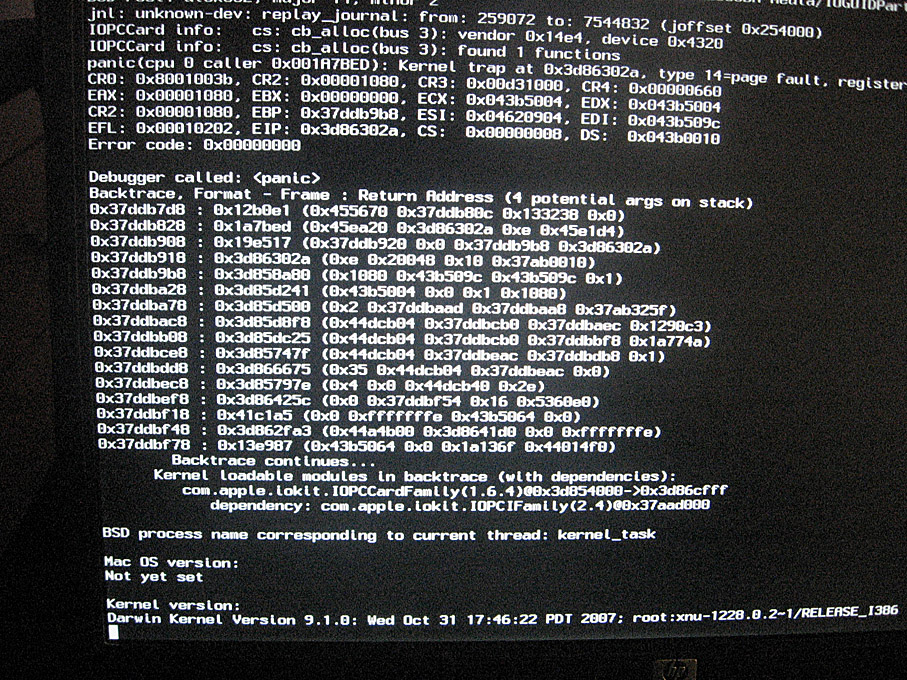

Hawie Posted December 31, 2007 Share Posted December 31, 2007 Leopard 10.5.1 come with IOPCCardFamily 1.6.4. include 104c:8039 id. but IOPCCardBridge::start failed. The attached file here is 1.6.2, and does kernel panic for me. any 1.6.4 fixed version exists? or any details to DIY Info.plist? Help... Link to comment https://www.insanelymac.com/forum/topic/29583-cardbuspcmcia-controller-id-104c8039-texas-instruments-pcixx12/page/12/#findComment-559423 Share on other sites More sharing options...
