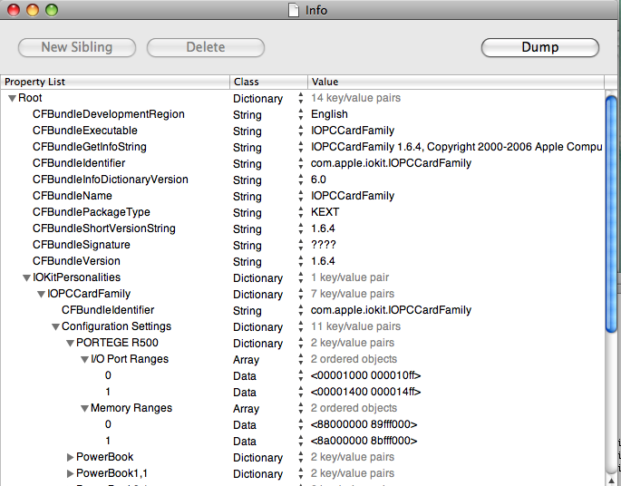

kizwan Posted January 8, 2008 Share Posted January 8, 2008 Hi guys, I have updated another revised of IOPCCardFamily. In this version, you do not have to edit the info.plist to match your machine. It is working on my notebook and I hope it will be helpful for those who don't how to change the info.plist. In addition, I also include the IOPCIFamily in case that some need it. (Both of two files are compiled from the original Leopard source code.) How to use? Backup your original IOPCCardFamily driver (and IOPCIFamily driver) Replace your IOPCCardFamily driver with the attached one that contains all necessary modifications Reboot As root, type "dmesg | grep PC"; you should see something about TI xx12 being found Welcome to try it and let me know the result. Don't forget to backup the old files before trying it. Chun-Nan Hi Chun-Nan, My CardBus adapter working after using rev. 1. Didn't try rev. 2. I tried rev. 3 and so far my CardBus adapter recognized & working perfectly. I don't have to edit Info.plist for I/O & Memory ranges with rev. 3. I also tried your IOPCIFamily kext file just in case it will detect my PCI-express bus properly. Still cannot recognized my on board atheros. But don't worry, this is known problem for Acer laptop. Now I have Linksys WPC54G working as AirPort!! Thank you so much for your effort. :censored2: Link to comment https://www.insanelymac.com/forum/topic/29583-cardbuspcmcia-controller-id-104c8039-texas-instruments-pcixx12/page/14/#findComment-570524 Share on other sites More sharing options...

fingerr Posted January 8, 2008 Share Posted January 8, 2008 Hi Chun-Nan, I've found way to get it recognized (later I'll try to attach some PCMCIA device). As I wrote you in PM I've used files from http://forum.insanelymac.com/index.php?sho...2&hl=pcmcia. The steps where (I hope I remeber all of them in proper order): 1. Replaced following kexts with ones from 1051_AR5001_USBHSpeed.zip : AppleACPIPlatform AppleAPIC IOACPIFamily IOPCCARDFamily IOPCIFamily IOUSBFamily 2. Edited IOPCCardFamily Info.plist to mach my I/O and Memory Window 3. Replaced IOPCCardFamily inside IOPCCardFamily/Contents/MacOX with the one from IOPCCardFamily_debug.zip 4. Rebooted and got it recognized! Here is the dmesg output after reboot: IOPCCard info: Mac OS X PCMCIA Card Services 3.1.22 IOPCCard info: options: [pci] [cardbus] [pnp] IOPCCard debug: IOPCCardBridge::probe IOPCCard debug: IOPCCardBridge::start IOPCCard debug: IOPCCardBridge::configure IOPCCard debug: adding bridge mem space 0x88000000-0x8bfff000 IOPCCard debug: cs: CardServices(AdjustResourceInfo, 0x0x12345678, 0x0x34923ce4) IOPCCard debug: adding bridge mem space 0x8c000000-0x8ffff000 IOPCCard debug: cs: CardServices(AdjustResourceInfo, 0x0x12345678, 0x0x34923ce4) IOPCCard debug: adding bridge io space 0x6000-0x60ff IOPCCard debug: cs: CardServices(AdjustResourceInfo, 0x0x12345678, 0x0x34923ce4) IOPCCard debug: adding bridge io space 0x6400-0x64ff IOPCCard debug: cs: CardServices(AdjustResourceInfo, 0x0x12345678, 0x0x34923ce4) IOPCCard debug: cs: CardServices(GetCardServicesInfo, 0x0x34923d38, 0x0) IOPCCard debug: i82365.c 1.326 2000/10/02 20:27:49 (David Hinds) IOPCCard info: Intel PCIC probe: IOPCCard info: TI XX12 rev 00 PCI-to-CardBus phys mem 0xf0906000 virt mem 0x351da000IOPCCard debug: IOPCCardBridge::setPowerState state=2 IOPCCard info: host opts [0]: [pci only] [pci irq 18] [lat 64/176] [bus 8/8] IOPCCard info: PCI card interrupts, PCI status changes IOPCCard debug: cs: register_ss_entry(0-1, 0x0x350f2dff) IOPCCard debug: ds.c 1.104 2000/01/11 01:18:02 (David Hinds) IOPCCard debug: cs: CardServices(GetCardServicesInfo, 0x0x34923d44, 0x0) IOPCCard debug: cs: CardServices(BindDevice, 0x0x34923d3c, 0x0) IOPCCard debug: init_waitqueue_head stubbed out! IOPCCard debug: cs: bind_device(): client 0x0x47bbd04, sock 0, dev Driver Services IOPCCard debug: cs: CardServices(RegisterClient, 0x0x4681588, 0x0x34923cfc) IOPCCard debug: i82365: GetStatus(0) = 0x30 IOPCCard debug: cs: register_client(): client 0x0x47bbd04, sock 0, dev Driver Services IOPCCard debug: IOPCCardBridge::setBridgePowerState state=2 Unfortunately I've lost my Broadcom WiFi (which is more important for me than PCMCIA) Maybe this will guide you to solution to get it working under Leopard's kexts? In my humble opinion IOPCIFamily.kext can be the 'source of evil' Regards, Mariusz. Link to comment https://www.insanelymac.com/forum/topic/29583-cardbuspcmcia-controller-id-104c8039-texas-instruments-pcixx12/page/14/#findComment-570918 Share on other sites More sharing options...

djmastera2000 Posted January 8, 2008 Share Posted January 8, 2008 I tested it, v3 from Chan-Nun(Great work mate!!!) and IOPCIFamily above, and Voila: PCMCIA Chipset recognized by MACOSX...with all vanilla kext, booting ok but: Airport not ok, USB patrially ok, Firewire not ok, some components not ok, and my PCMCIA device not ok/not recognized (3G PCMCIA Modem)...i think with this IOPCIFamily some HW IDs are gone lol So, Chun-Nun, are you able to compile an new one with our IDs/Memory ranges please(you have my data )? Link to comment https://www.insanelymac.com/forum/topic/29583-cardbuspcmcia-controller-id-104c8039-texas-instruments-pcixx12/page/14/#findComment-571249 Share on other sites More sharing options...
~Eureka Posted January 8, 2008 Share Posted January 8, 2008 I suspect apple removed our ven/dev ids from Leopards IOPCIFamily (they have done this before in other kexts), but I don't know how to add it to IOPCIFamily, I' not a developer. Chun-Nan is our hope p.s.I suggest you to use AppleACPIPlatform AppleAPIC IOACPIFamily IOUSBFamily from 1051_AR5001_USBHSpeed.zip. When I've restored vanilla ones system was booting very slow so I've done hard reset.Good Luck!Regards,Mariusz.Hi Mariusz,You meant when you restored all the files you changed according to 1051_AR5001_USBHSpeed.zip, your pccard works but your Broadcom WiFi doesn't?If so, have you edited any those files to make your Broadcom WiFi work? If you have, can you let me know which files you have edited to make your WiFi work?Chun-NanBTW, what kind of interface does your Broadcom WiFi have? USB, built-in?Hi Chun-Nan,your 3rd rev works out-of-the-box on an Acer Travelmate 5720G with Kaly 10.5.1! I could test it with Exsys 1394 cardbus and attached DVD-drive. To sad that my Atheros 5001 wireless card (VEN=168C DEV=0013) was only recognized as an ethernet card, instead of an airport device. No idea if this depends on the PCIxx12 driver or something else.Great job, well done! Thanks,LowTechHi LowTech,If you pccard works after using the rev3 file, you still have to edit the info.plist under IO80211Family.kext to have your Atheros 5001 recognized. The rev3 file only makes the pccard slot recognized and started.Chun-NanHi Chun-Nan,One more little thing - my machine just refuses to boot if I enable Firewire ports in BIOS. When I boot with -v option, it freeses after those lines printed:IOPCCard info: Intel PCIC probe: TI XX12 rev 00AppleIntelPIIXPATA: Secondary PCI IDE channel is disabledIf I disable 1394, it boots up and works fine.Not a big deal for me but just in case Hi Jave Duke,I am not sure if the firewire has anything to do with IOPCCardFamily. It seems that your pccard started correctly. Maybe you can try the kext with "debug info" to get more information and make sure the pccard started correctly or not.Chun-Nan Link to comment https://www.insanelymac.com/forum/topic/29583-cardbuspcmcia-controller-id-104c8039-texas-instruments-pcixx12/page/14/#findComment-571569 Share on other sites More sharing options...
djmastera2000 Posted January 8, 2008 Share Posted January 8, 2008 ... Jave Duke,I am not sure if the firewire has anything to do with IOPCCardFamily. ... Sure, is a PCI component too... Plz take a look at my test above... Therefore we need to compile genuine IOPCIFamily.kext with our dev ids/memory ranges/... Link to comment https://www.insanelymac.com/forum/topic/29583-cardbuspcmcia-controller-id-104c8039-texas-instruments-pcixx12/page/14/#findComment-571690 Share on other sites More sharing options...
Zaxboi Posted January 8, 2008 Share Posted January 8, 2008 Hey there, yeah I have been through all of this almost 2 weeks ago and got the STOCK IOPCCardFamily going on my ACER 3680 (TI xx12) on iATKOS v1.0i with loads of effort (and some advice from kizwan and solu). The magic there was to use the 10.4.4 IOPCIFamily kext and then to find the correct model# and code into the plist of the stock IOPCCardFamily with the right I/O ranges and it came up. I will try Chun Nan's work maybe this weekend but I had it working using an NETGEAR WG311T WiFi card and got Airport going! The last bit of magic to make Airport recognize the Atheros chip on that card was to use a ?somewhat cooked? IO80211Family kext from someone, just get the attached file and install with the Atheros card you have and it should work just fine as it does for me (Airport sees it and comes up fine). Now, If we could ONLY get the damn mini-PCIe card devices to work so onboard WiFi is enabled so we don't have to use the PCCard cage... I've tried both the stock Atheros card that came with the laptop and a Broadcom 94311 card I got (both with pin#20 taped over) and all I get is kernel panics when the driver loads when using the 10.4.4 IOPCIFamily (required to make the stock IOPCCardFamily see the TI xx12 chip). IO80211Family.kext.zip Link to comment https://www.insanelymac.com/forum/topic/29583-cardbuspcmcia-controller-id-104c8039-texas-instruments-pcixx12/page/14/#findComment-571774 Share on other sites More sharing options...
